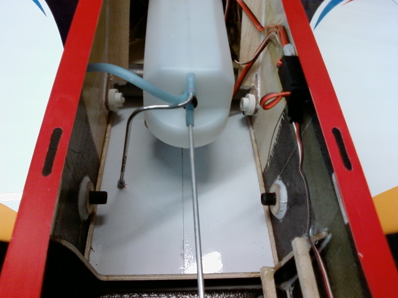

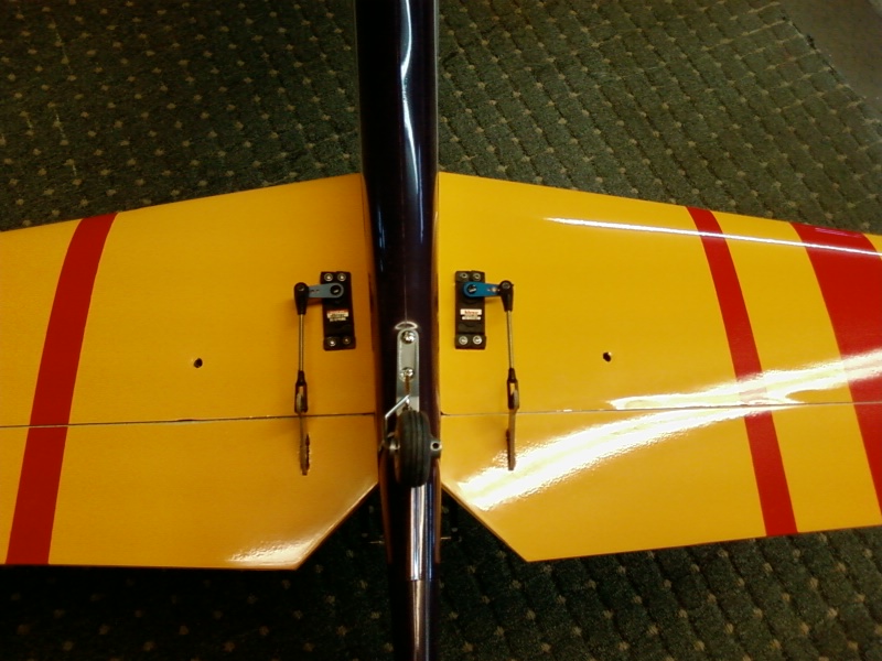

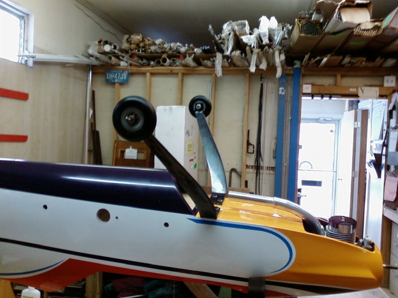

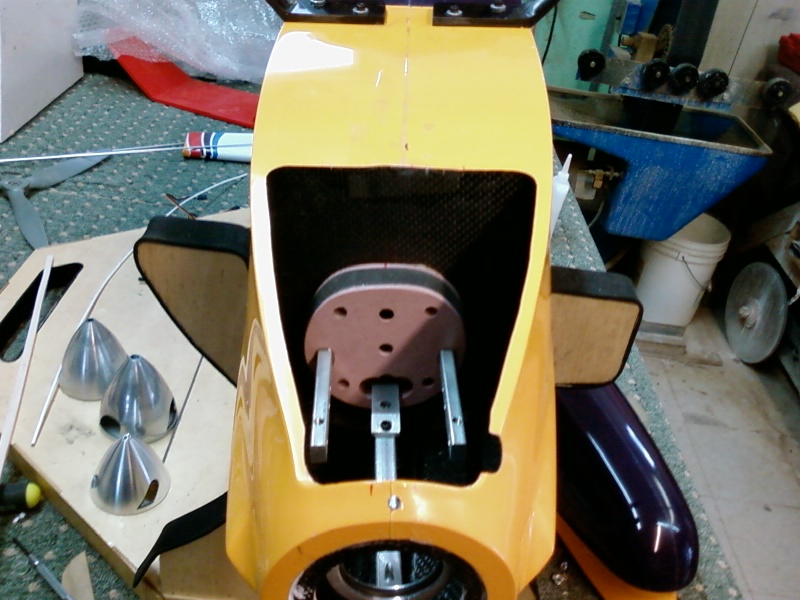

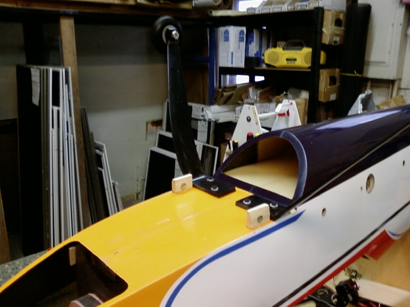

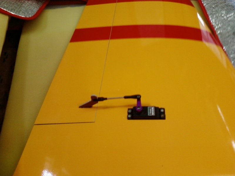

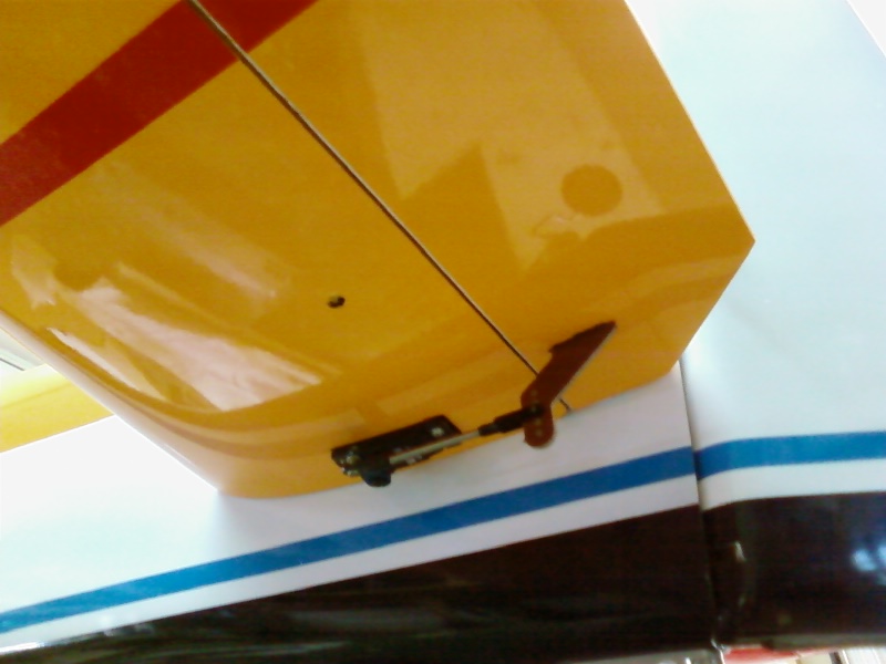

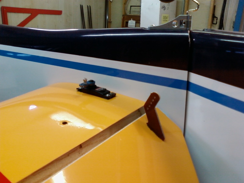

Well I have my integral about 3/4 finished.

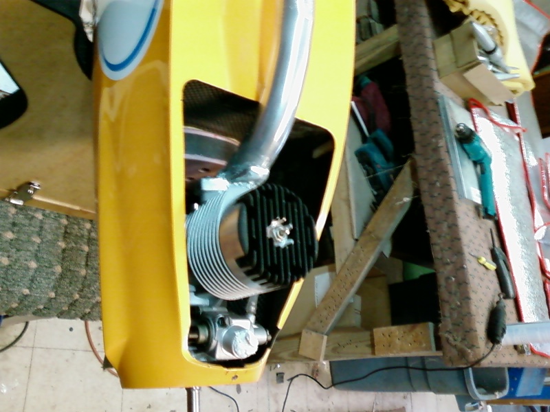

If there is anyone planning on using an OS 1.40RX be prepared to either have a custom header made. The firewall is much higher then any other Pattern ship I have seen.
There are a few things with rudder and stab I am not real happy with but did over come one of them.
When I had the Stab halves installed I noticed some slop at the wing tube in the stab halves and through the fuse. There was just a slight amount of play but completly unacceptable. I think the stab tube is slightly undersized. I ended up epoxying the stab halves to the wing tube and through the fuse. I have no reason to remove the stab. It is now solid.
I am not happy with the amount of throw that the hinging system allows for the rudder. I am only able to get 25 degrees each side of center. It seems like the hinges hit the inside of the rudder. I am afraid to remove any material from that area for fear of weakening the hinging system. Anyone have any thoughts for that one?

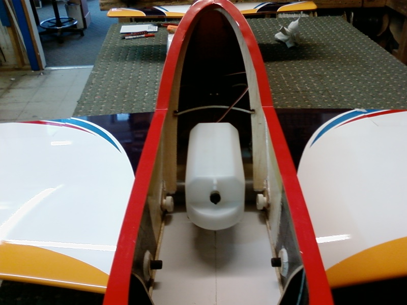

The main wing mounting system is okay but the fuel tank makes getting those nylon thumb screws on a real pain. Any ideas how we can eliminate them for a more favorable setup?
Other then that she seems to be a fine airplane. I hope she flies as good as she looks.
Carl

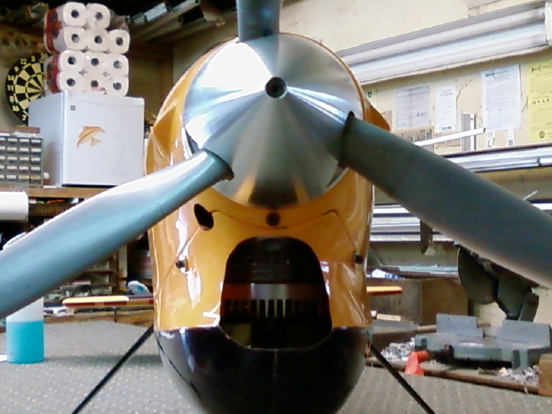

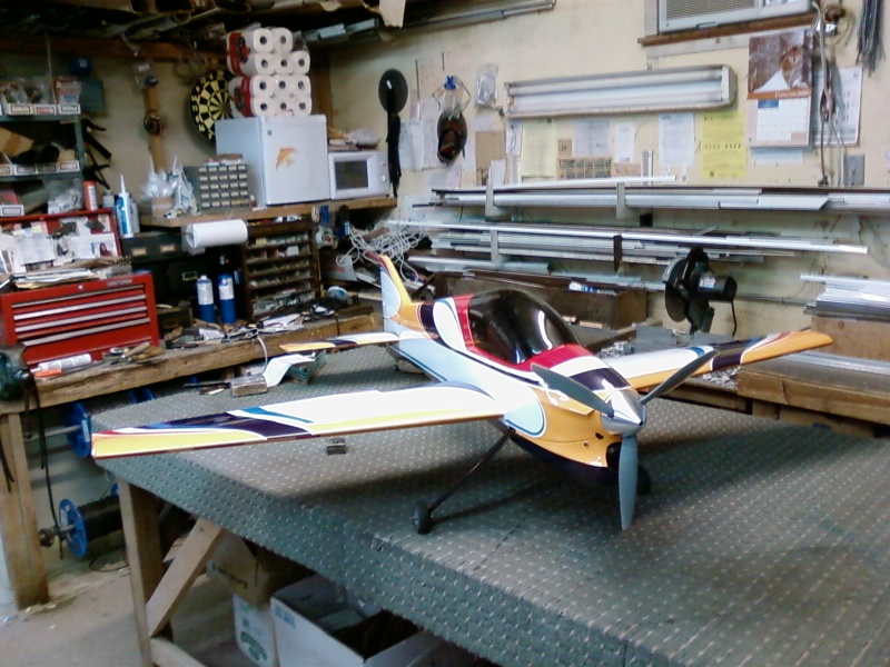

In case anyone is iterested, I have finished my integral all but some fuel lines. The final weight of the plane came in at 9lbs 10oz
I am using an OS 1.40 for power and an older style Long and thin ES Carbon Fiber Pipe. I used this pipe mainly for the thin diameter. The pipe tunnel on the integral is a bit small. I mounted the engine using a Hyde soft mount with built in nose ring. Tru Turn 3 1/4" 3-blade spinner APC 15.75 x 10 3-blade prop, Bolly Carbon Fiber landing gear and dubro 3 1/4 diamond lite wheels. I did not install the wheel pants. They never seem to last long enough for the effort of installing them. I set the CG at 7 1/2 inches as a starting point. I thought 8" was a little on the tail heavy side. I did some figuring to get the approx. wing cord and worked from there. Some of my friends suggested some other formulas for fiding the CG and that moved that figure further forward. So with Jason having a plane that flies at 205mm (8") i thought it safe to set CG at 7 1/2" at the fuse back from the leading edge. With that CG I have the receiver and battery mounted just in front of the rudder servo.
I will post some pics if anyone would like to see. (if I can figure how to do that)
Carl

Carl,
Plane looks great. The CG has been moved back from where I started (180mm) cause I felt it was very nose heavy. The current CG isn't tail heavy that I can tell, still needs down on inverted and 45's.

Thanks Jason.
I am playing it safe with the CG I will start at 7 1/2" (190mm)
I would rather be nose heavy the first couple flights.
I am waiting on a Carbon Fiber canopy, Karl Mueller header and Aeroslave pipe. After that is installed the plane should weigh in at 9 1/2 lb It weighs in now with the stock canopy and a header I fabricated myself with an ES composite pipe at a 9 lb 14 oz. I am very pleased with the overall quality of the model.
Feel free to use my pictures on your site or the composite arf site.
Carl

CHV69
why do you use 3 blade prop on the RX ?
JAS
what is the HATORI Header(822 or 823) you hav used ys 160 dz on Integral ?

It improves down line braking and is much quieter than a 2 blade. It also gives a smoother transition from slow to fast. It helps with a touchy throttle. Gives you the feel of only 3 speeds. slow medium and fast.
It is an APC 15.75 x 13 repitched to a 15.75 x 10 I turn about 8100 - 8300 RPM.

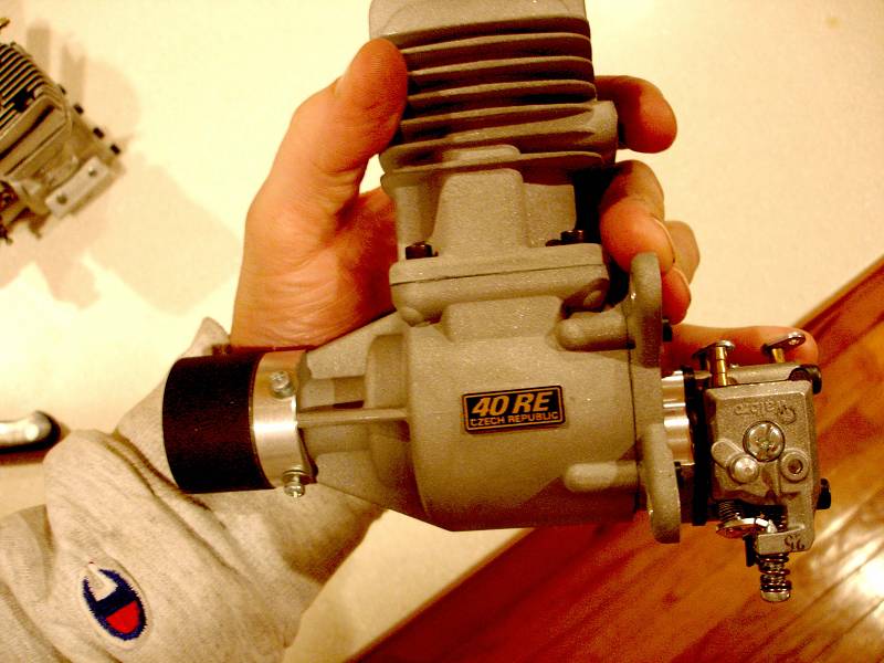

JAS, any news about the big OS? I saw somewhere (probably a Japanese website) a new incarnation of the engine with an airbox (ala YS120AC) Is it still EFI?

RE: Composite-ARF Integral, kinda build thread
My ZDZ 40 was going into a different airframe but this Integral looks tempting. Are the primed Integrals still a option for bying? Also the website states that the Integral is no longer in production. Is this true? Anyone know the status of this?
