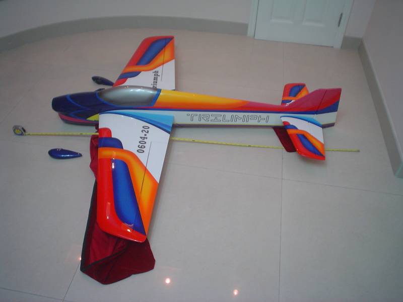

Hi all
I'm setting up a new pattern plane for the teenagers to get some competition experience on the larger models.
It is a 1.7m wing span & 1.7m length all up weight will be around 4.2kg (9.5 lbs). and I want to give it my best shot at making it comply with the FAI requirements (Noise, weight etc).
I'm powering this one with a Saito 1.80 that I have spare. (Do you think it wil have enough power)

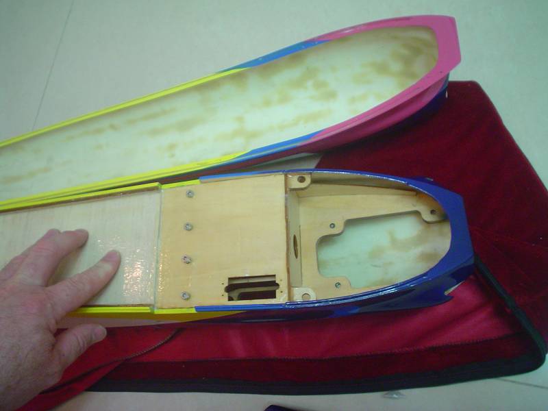

G'day Rendegade
It is made by a company here in Tianjin (T-Zone Models) they don't have an english language website (yet). The owner of the company is a pretty high level pattern flier over here who I fly with on a regular basis. His main business is using a laser cutter to make foamies and kits for others but he also develops his own F3a planes - he makes 5 per month in either electric or Fuel versions (Slightly different layout in the nose. Apart from the laser cutting, these are all hand made - including sanding off the Char from the cutting process prior to them being glued!
When I come back to Perth at Xmas time I'll be bringing this one with me (Still have to get a box made for transporting it from here - otherwise I'd bring it back if I come back next week) - I'll bring it over to show you. When I get the box made for transport - I'll be able to bring some back with me each trip back (as my second suitcase) the cost is around A$850
Vince
I probably will end up buying another YS (I just can't help myself sometimes). My other ones are tied up in my Oxalys & my Precedent so I don't want to remove them. I also don't really want the teenagers flying them just yet (huge difference in cost if they dumb thumb it in the "self imposed" pressure of the competition arena). I was just hoping to get it going with the Saito & pump configuration - you know how it goes - got a new airframe, just gotta get it airborne (please Dad!!!)
