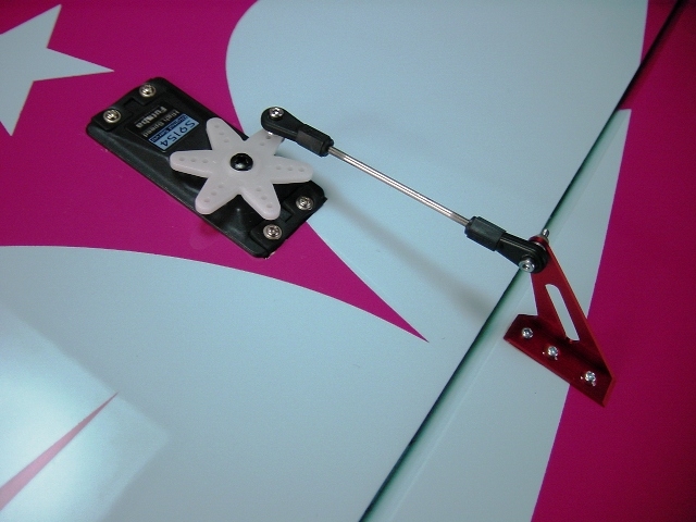

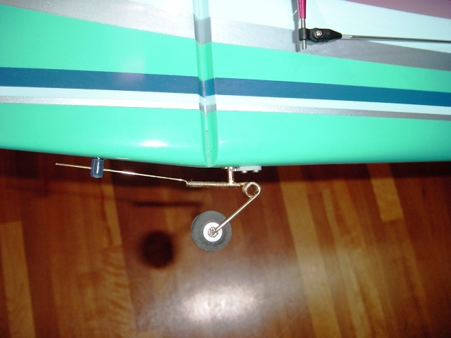

The build begins with a specific goal: re-create the installation "themes" in these pictures:

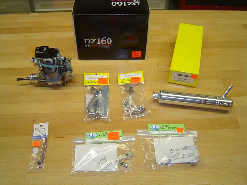

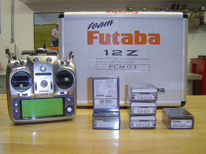

Components and parts selections: The next series of photos are some the components that have been selected.
Radio equipment: All Futaba components
Transmitter: 12Z
Receiver: 5014 DPS
Throttle: 9650
Ailerons: 9154 aileron servo (wedge shape)
Elevator: 9151
Rudder: 9155

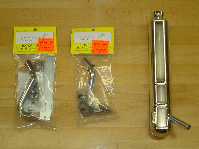

Engine components:
Engine: YS 1.60/1.70 DZ
Header: Hatori #822 (15 degree or 24 degree rise?) or #823 (10 degree rise?)
Pipe: Hatori #821 (comes with very nice mount although I am not using)
Pipe mount: Ishioka special (Central # 166 311 $39.87)
Header support: Ishioka special (Central #105 126 $32.95)
Needle valve extension: IM Products #05102 (Central # 166 028 $3.95)
Fuel tank: K& S 600 cc # 981-2300 special (Oxai-USA, I was afraid to ask the price?)
Fuel fittings: Tettra #4225 color tilted outlet nipple red/blue anodized aluminum (Central # 166 289)
Fuel dot: Tettra #?
Fuel line: Prather medium
Some of these parts are available at a number of quality shops around the world...(I generally just call Mandy at Central Hobbies, she knows the cool parts...)

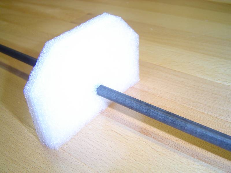

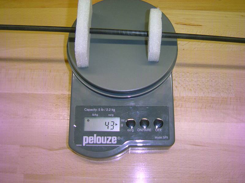

How to access the glow plug in a fully enclosed motor installation?
MK of Japan has a system which uses a fuselage mounted female plug, glow plug attachment clip and male plug for the power source. Here are a few tricks Dave Guerin showed me to mount this little gem for trouble free use: It will break...so I replace the ground wire with a RC car silicone wire. The ground simply connects to one of the engine bolts. The glow plug wire will probably fail at the glow plug clip/wire joint. You can add a piece of heat shrink tubing or just replace it with a Tettra remote glow wire and clip (about $6.00 at Central Hobbies). The plastic mounting ears are prone to cracking...later I show how that is fixed as well.
Yes, it does weigh about an ounce, basically have to replace some of the key components, requires additional time to install (less than an hour) but it is very clean and cool when your done.
I use a lithium powered glow igniter which I installed SERMOS plugs to use several different glow plug clips.

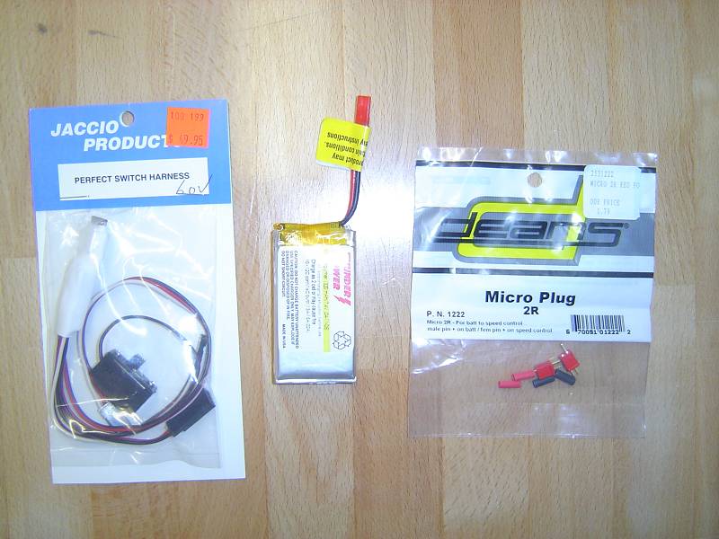

What power source?
I have never been an "early adopter" of battery systems. Many pilots have had and are having success using the lipo batteries to power the airborne electronics. Yes, there can be very little weight savings when one considers the voltage regulator, the extra charging equipment and fire...
I will use a 1320 mah Thunder Power two cell pack, Deans mini plugs connected to a Jaccio 6.0 volt default "on" safety switch. If the switch breaks, the system will be "on". I have a couple of the batteries so that after I fly 5 - 6 flights, I simply replace it and charge outside the model.
Dave Lockhart (fantastic precision pilot and ambassador) uses a redundant system of dual 450 mah (?) lipo packs, regulators and switches. This provides an additional layer of protection and complexity because you really need to monitor the voltage of EACH pack.

I would like to know how you plan to set up your elevator linkage. The first set of photos looks like they used a metal rod y adapter or something...

Regarding fuel proofing engine compartment, where to buy motor mount and the elevator system:
The Oxai-Models, I believe, are painted with an epoxy paint. The Zeque has a carbon fiber belly pan with what looks like a complete carbon fiber engine compartment. It appears to be finsished with clear...I will use Z-poxy finishing system to coat all of the little areas like the holes for the fuel lines...
Fuel brands, fuel proofing and protecting your model's finish. I am not a chemist yet I have found that some model fuels seem to also double as a paint remover! I will be flying Cool Power 30% Heli this year based on my ability to buy a gallon or two locally if I run out AND it has proven to be a little easier on painted finishes.
Central Hobbies or YS Performance Parts and Service (Rich Verano) carry the mounts. (I imagine others do also.)
The elevator push rod...procrastination...there is no other control system element that drives me crazier than the elevator system! My last (3) F3A models have all used dual Futaba 9650 elevator servos mounted in the tail. The Focus II I am doing for FLY RC Magazine uses my new system of "supports" using the conventional arrow shaft captured in the tail and "Y" ends. I used a dense, slippery foam packing material about 3/8" thick mounted in (2) places against bulkheads (See attached photos.)
Chip Hyde used (2) 3/16" carbon rods to each elevator half, driven by dual Futaba 9650's mounted in the cockpit area in his Scandalous. I am going to this set-up, vs. the 9650's in the tail, in MY Scandalous in my weight reduction process and CG change.
Troy Newman (Mr. DEPS, Dual Elevator Pushrod System) does a fabulous job with the Central Hobbies DEPS system. I flew with Troy before last years NATS and admired the contol system installations. Troy's systems may be as flight tested as any due to his practice regimen (Very nice way of saying that he flies A LOT).
Mr. Suzuki's Zeque uses a standard "Y" with the exits capturing each pushrod in a nylon sleeve (I assume to reduce play). The fuselage has a number of formers in which to attach supports.
I have not decided. Troy said that he would install the DEPS system if I brought it to Phoenix. I have purchased the parts for the DEPS.

I was trying to find some of the more obscure parts that you have, specifically the IM Products needle valve extension and the Nishioka pipe mount, and could not find them on the website, nor in their 2007 catalog. Will I just have to call and order those parts using the part numbers, or are there plans to advertise those? I can't wait to see the build come to fruition.
Also, did you buy that foam from a supplier, or did it come as packaging material? Dave has been racking his brain to find a source for it.
