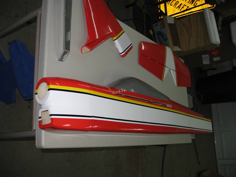

Hello Folks,
This is the Focus Sport build thread I promised.
The idea behind this thread is to help guys produce a competitive pattern plane that is a sport flyers airplane. This isn't a plane that doubles as a 3D machine. Instead its a full concept Pattern model in a Sport package. I'm building this model to make it capable of flying precision and to be an everyday sport plane that will give any level flyer that locked on feel of a pattern plane.
I have flown one of these models as was impressed with its flying. So I decided to build one for myself and to help others get their working and flying as good as the one I flew.
I received the Kit on Saturday and it arrived to my surprise. I kinda like FedEx Ground delivery on Saturday.
In any case. Here is the start of the thread. As promised I would be a few days getting into it but right now I'm pretty busy with other things at the moment. The project might get little slow start this weekend and into next week but after that I expect to flying it within a couple of weeks.
I'm in the process of checking things out and decisions on servos, linkages, and other options. The kit does include some hardware like control horns, wheels, and so on....but there are lots of options from the standard setup to the expert setup.
My goal is to accommodate lots of options for everyone.
I'm looking to do a build in 3 levels. Basically I'm going to go through multiple servo options, linkage options, and equipment choices in this model. Basically it will be a GOOD, BETTER, and EXPERT setups guides. This will let you choose the best one for yourself.
The idea is to promote pattern with a pattern based sport model that flies like a pattern plane. In the end I fully expect to be able to fly all aspects of AMA pattern.
If you all want to build along I'm going to be starting the build right here on RCU and tracking the changes everyday that I make to the model. So get yours on order and you can catch up next week when the kit arrives.
I opened the box and this is what I saw. I'm very pleased with the product. The parts are fairly light. They are built durable and the wood selection looks strong and nice. The cover work is excellent and covering is true Ultracote. I will have the Hangar 9 parts numbers for the covering. Bad Brad is doing the graphics package. The radio gear is going to be JR X9303 2.4ghz system.
We are going to take this build to a new level of detail. We are going to get it done, fly it, trim it and compete with the model. All of this will be done to promote aerobatics, and pattern flying. I will treat this model like a new top of the line pattern model when trimming, when testing and when competition comes around. Basically this plane should be able to help anybody fly better aerobatics. That is the Goal.
Ok here are a couple photos and we will get into the details as I have time to work on it.

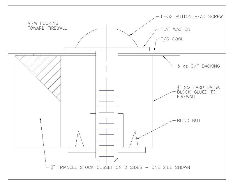

My question about using a Hyde mount on an ARF like this is; since you need to attach the nose ring to a removeable cowl, how do you plan to attach the cowl to the fiselage. This isn't much of an issue with a hard mount, because the cowl doesn't tranfer much stress to the fuselage. I would imangine that the nose ring will put enough stress on the cowl, that the attacement to the fuselage will have to be beefed up. I'll be very interested to see how you address this. I don't think Hyde makes an ARI mount in the .110 size.
I sketched up someting that might work. It may be a little heavy, let me know what you think. You can get button head cap screws from McMaster Carr.

The Hyde mount being used does NOT require a nose ring.
HCMYS110A----available at Central and it is the same mount/engine combination designer Dave Guerin used for the original.
A number of Merle's mounts do use a nose ring but this is not one of them.
