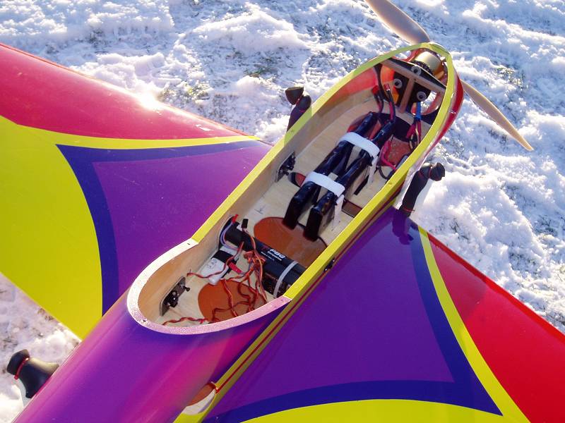

The model is my own design, with a molded fuselage. This was originally made solely for electrics, but I think a ZDZ will also fit. Access to the engine will be a little unusual, as the canopy extends right forward to the spinner. (This, in my opinion, is ideal for electrics, where you have full access to "everything" from the top.
Pictures taken last winter of electric prototype No. 1. Yippeee, that white stuff is coming soon....[&o]
Magne

Very innovative! Good thinking.
Living in Norway, I'm sure you have flown airplanes with skis. Last winter I flew a small model (Fliton Extra)with a .91 4-stroke with skis and was delighted with the experience. I can't wait for snow this year. Soon I will have a 98-inch wingspan Super Decathlon and it will have skis for winter flying. I will use a 46cc Brillelli gas engine it it. 'Ground" handling with skis is excellent!
