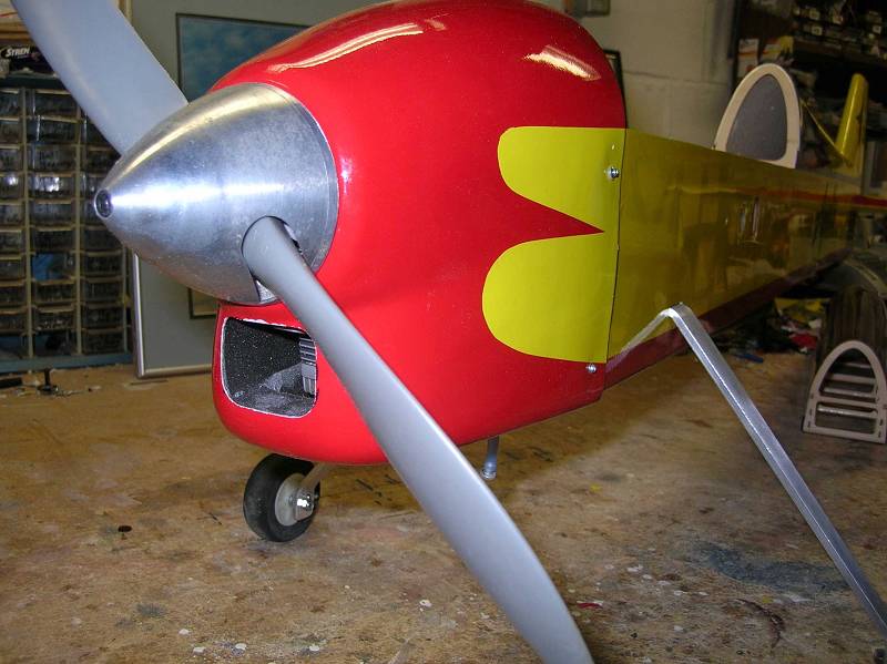

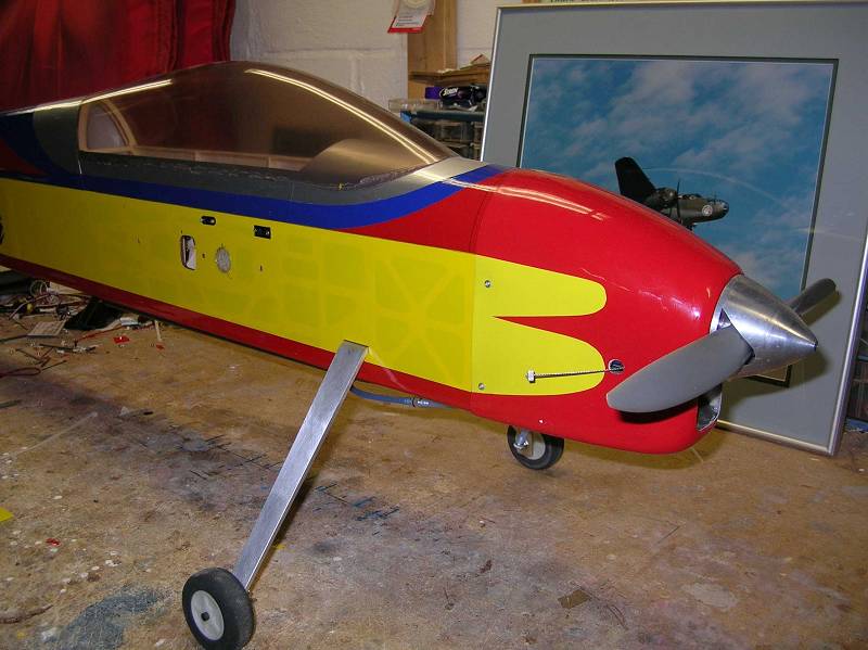

I have nearly finished mine,John arranged to have it shipped to me direct from the factory as I am in New Zealand.,I am waiting for the header from Karl Mueller before I can finish it.
In case anyone was wondering the motor mounts inverted and the header snakes around the head and down to the pipe tunnel.
I put it together without instuctions with no problems apart from a few e mails and phone calls to John,by the way his customer service can only be described as fantastic and all delivered with a smile !!!!!!!
Ill update this as things progress.

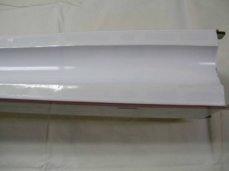

Old 08-20-2008, 07:10 PM
NJRCFLYER2
My Feedback: (42)
Join Date: Jul 2004
Location: Randolph, NJ
Posts: 878
Default RE: *Aquila by Northeast Aerodynamics*
I am planning on running the OS 120AX so any pics of the gear and exhaust setup would be great.

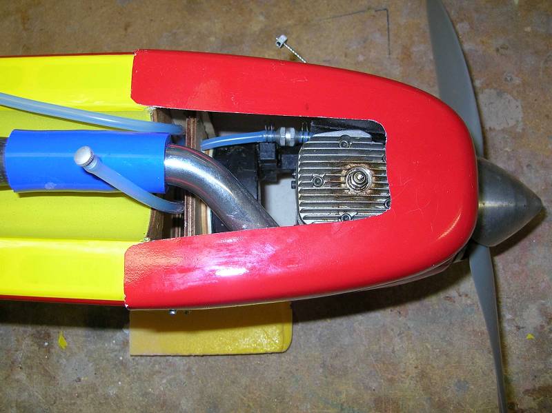

I have pictures from the prototype, but it was quite a bit different than the production model is for stuff like mounting a pipe. John's original design had no pipe tunnel, so after I had done a lot of test flying with just a muffler, I hacked out a pipe tunnel opening and laid it in with 3/32" balsa. Things that are now right in the production model were in the way for the tunnel in the prototype, such as the landing gear mount. The production model is really nicely done in this regard. The pipe tunnel is already complete with a fiberglass inset, which on the ARF version is covered at the factory with Monokote (in case you're just using a muffler). If you want to use a pipe, slice off the covering and voila, you're set to go.
This picture is from the pre-production Aquila I received in Feb 08, which was produced to verify the production setup for John. They got it mostly right, but it wasn't quite up to standards, so he had another one done, which proved out. This process has taken longer for him to get the Aquila to market, but it will be worth the delay. Do it right, or don't do it!
Old 08-20-2008, 07:34 PM
NJRCFLYER2
My Feedback: (42)
Join Date: Jul 2004
Posts: 878
I forgot, I had a few more pics of the pre-production pipe tunnel:
ID:	1015719   Click image for larger version
ID:	1015720   Click image for larger version
ID:	1015721   Click image for larger version
ID:	1015722   Click image for larger version
Old 08-20-2008, 08:44 PM
Zippi
My Feedback: (10)
Zippi's Avatar
Join Date: Jun 2004
Location: Evansville, IN
Posts: 4,977
NJRCFLYER2,
Thanks for the pics. Can you explain a little about the "floating firewall".

Zippi ,the fit and finish are exemplary ,I had the whole model together ie wings and tails attached etc within an hour of its arrival,alignment perfect.
I am using an OS 120 AX in mine, with an ES Composites 120 AX pipe.
If you have put a few ARFs together you wont have any problems.
Old 08-20-2008, 09:00 PM
NJRCFLYER2
My Feedback: (42)
Join Date: Jul 2004
Posts: 878
You can slide it into the correct position to match your engine & mount to the length of the cowl, then just glue it in place. It's a very snug fit with the fuselage frame as you slide it into position, so it's not going to be easily knocked out of position as you work with it.

Some engine box pics:
ID:	1015806   Click image for larger version
ID:	1015807   Click image for larger version
ID:	1015808   Click image for larger version

NJRCFLYER2,
Pics show it all. I get the concept now. Very nice way of setting up the engine to cowl clearance for the backplate. I have put a plane or two together over the past 20+ years. Can you direct me to the web site that has the header and pipe setup your going to use?

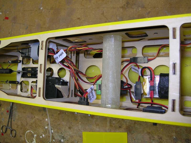

Radio installation & tank. The factory setup for the elevator servo mount was not used, in order to avoid any side to side pushrod movement.
