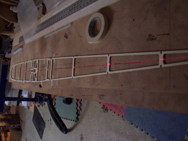

can you give me some details of your laser alignment tool? I want one of those!..

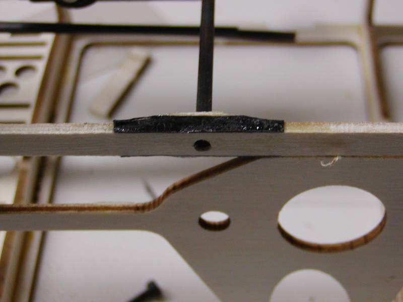

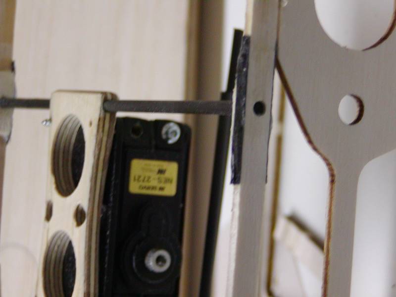

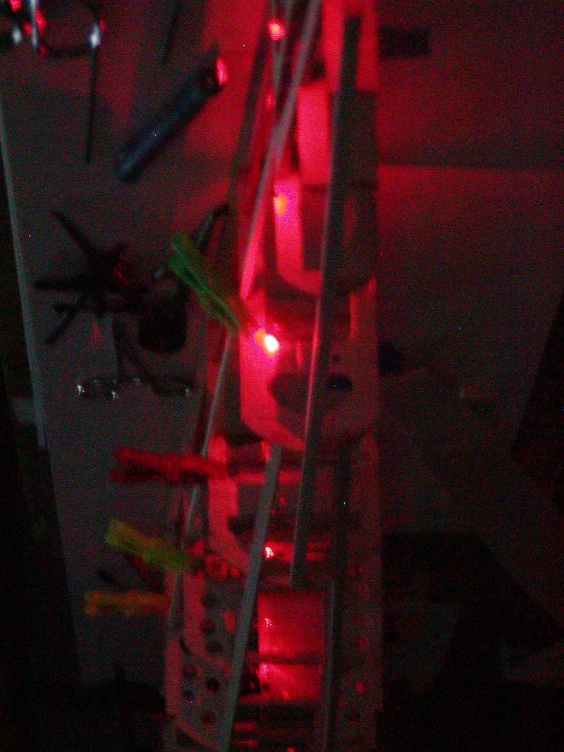

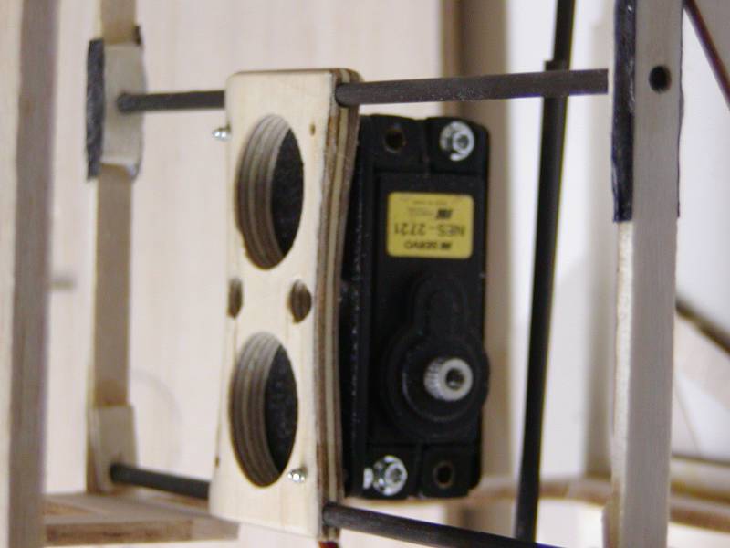

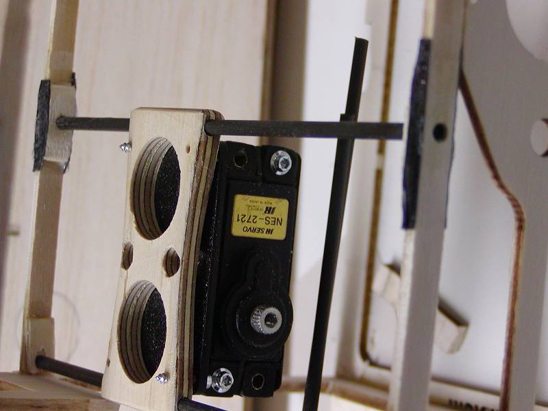

OK , I doubled the support at the hole and added carbon fiber.
I also used a laser to set up the DEPS system. The carbon rod falls through the tube under its own weight. Little friction.
Picture is not so good....

Tuny, Gregg, sorry I did not reply to your questions....just been in a rush all the time when posting I guess.
Tuny,
The laser tool is something I bought from Home Depot years ago that is a rather cheap laser with a magnetic base. I set it up on a steel block at the end of the work table looking a bit downward toward the front of the fuse. The laser lens can be rotated 90 degrees to show a horizontal line as well. Works great as a sight line tool for measuring and former alignment. I should probably replace it with something newer...just in case I need to hang a picture or something... http://www.homedepot.com/webapp/wcs/...ctId=100375599

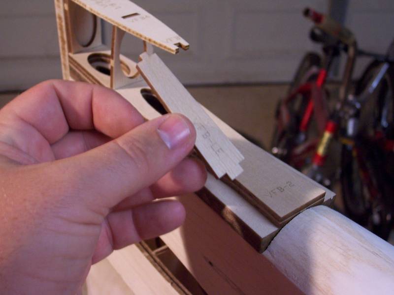

Front deck.....
First pic shows a dry fit...former against canopy is not seated just right...needed adjustment.

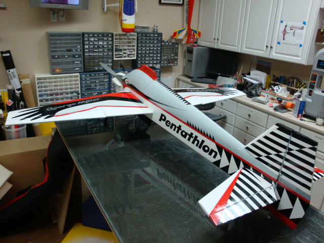

Here are some pictures:

OK, Guys here are the first assembled pictures of the Pileated Pentathlon:
ID:	1146433   Click image for larger version
ID:	1146434   Click image for larger version
