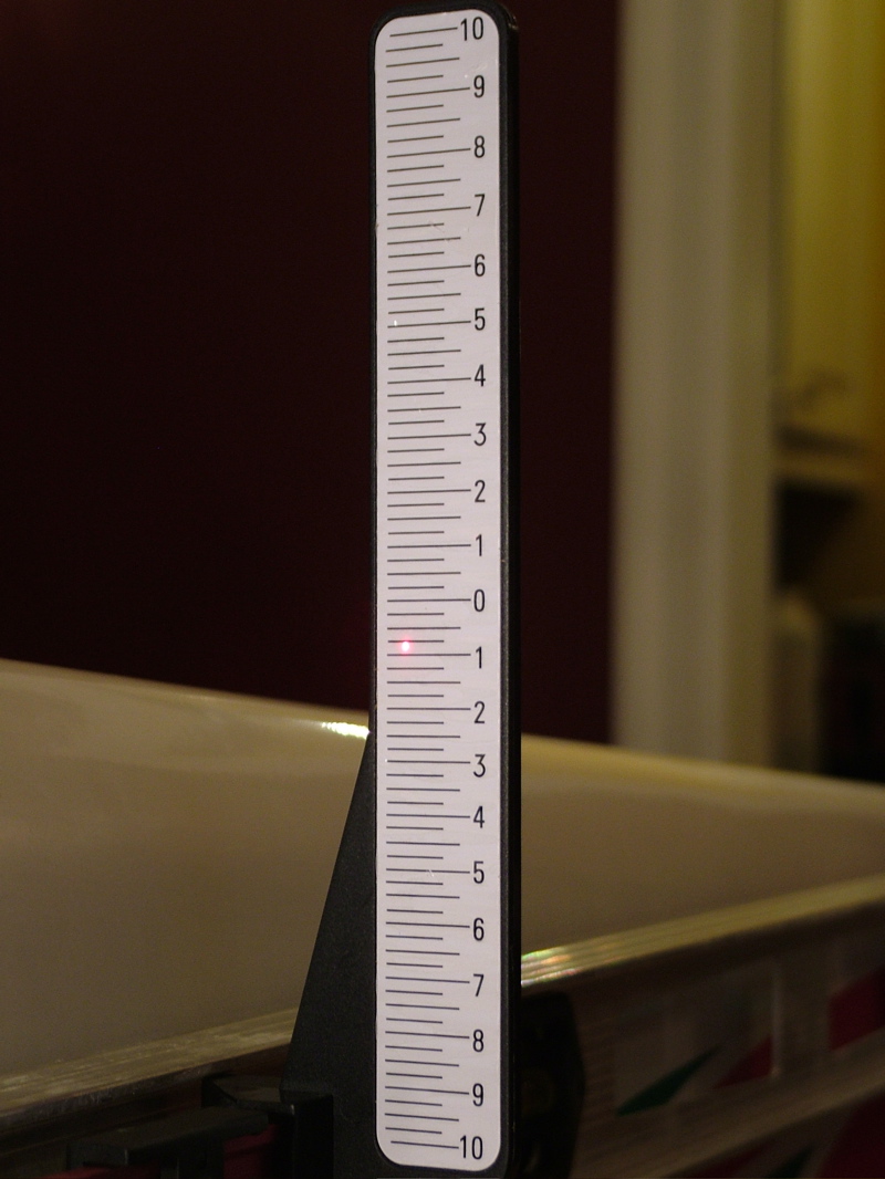

Hi
I just test flew my Wind 110 today and to get her to fly I had to put in a surprising amount of up elevator trim( about 1/8th of an inch). My CG is towards the back of the recommended range,and she doesnt feel nose heavy. Didnt do much Aeorbatics as I was being kind to my brand new packs and I didnt fly her inverted to see how much down elevator she would require but judging by the elevator I am think it will need a bucket. ( I prefer just gentle pressure myself)
Has anyone else hit the same problem and if so what did they do to cure it. I am thinking I need to reduce the amount of Down thrust.

I agree, sounds more like a wing/stab incidence issue. Downthrust doesn't have that much effect at cruise speeds. It will induce minor pitch changes with throttle changes but probably wouldn't be the primary cause of your elev trim issue.

Hi
Unfortuntaley the Wing and the Stab incidence is set and I cant change it. Both the Wing and the Stab plug into recessed area of the Fuse and even minor changes would involve alot of hacking. Which I dont want to do unless I know for sure I am on the right track.

mikehannah , me too have the same probleum ..... the elevator is up by 2mm , as you can see clearly at the tip !
Just got my Hanger9 digital incedent meter will check it out . . . .!!

I'm not too familiar with the slightly smaller pattern planes, but am I right in thinking that it's a Sebart ARF?
Just asking, because from what you're saying, it does sound like an issue with (probably) too little positive incidence on the wing,relative to the tail.
A club colleague,who is thorough in such things, has/had(not sure which) one of the smaller Sebart Angel S models (S50?),which initially needed a lot of up elevator trim to fly level,and,although I don't recall the numbers, it had negative wing incidence as assembled out of the box.
He did actually hack it about,to get some positive onto the wing-and of course the need for up elevator trim went away.

F3a ... There were some guys who complained about the Angel with insufficient incidence on the wing. Remembered that one. It was on RCU too I believe. Guess just have to check the amount of decalage on the Wind S.

I was one of the guys that worked on the incidence problem with the Angel 50. I built two planes and corrected the incidence to 0/0 on the second plane, but could not discern any change in flight characteristics between the two setups. In fact when I let a "pro" fly both, he felt that the original unadjusted wing setup may have had a slight edge. All that is to say: Would you consider flying it a few dozen times and then reporting back on how it trims out as is? I'm dyin' to hear more about this plane! Also, do you have any pictures of how far out the elevator is trimmed for level flight?

Some other tests to do:
Fly straight and level and pull into a vertical up line. See if the model pulls to belly, canopy, or flies straight up. This is another test for thrust angle. Pulling to the belly would indicate too much down thrust.
Power-Off vertical dive. Again, note if model pulls to belly, canopy, or falls straight down. This is a test for the incidence. If the model pulls to canopy, it shows a need for in increase in wing or stab incidence.
Knife Edge flight: Another test for incidence. If the model pitches to the canopy, it displays a need for an increase of wing or stab incidence.
