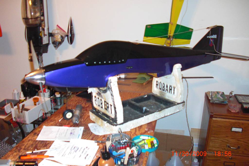

On a high-wing design with a flat-bottom airfoil? On a motor glider, some of which have 10 degrees down thrust?
Try 0-0-0 on the one pictured below - my aerial camera platform - and you will not get off the ground!
The motor thrust is set at 2.5 degrees of right thrust and 4.5 degrees of UP thrust, about -1 deg on the stab. It flies as if the motor were in the nose.
