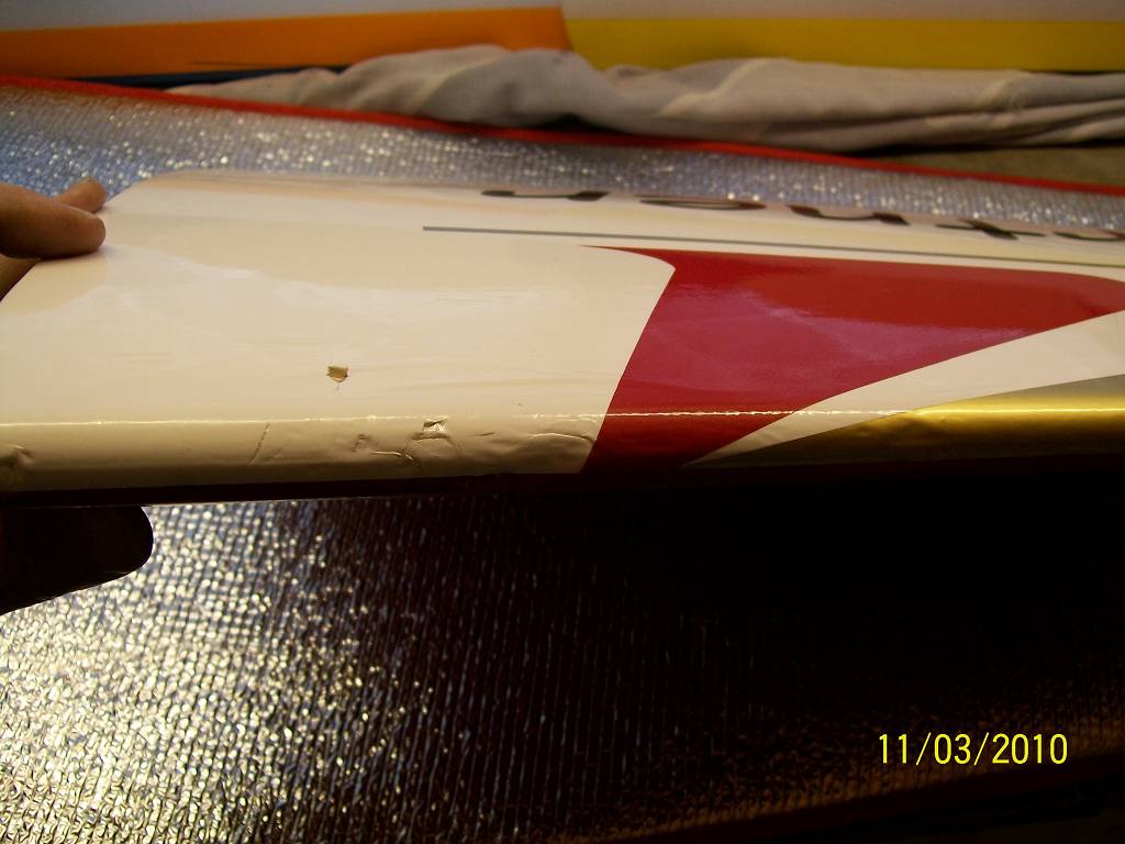

Last Sunday was a great and yet not so great day of flying for a really good friend of mine in our club (Howard Murphy). Howard is our flying site manager and it has to be said that he puts and enormous amount of time and hard work in to keeping our flying site in the glorious condition we all enjoy.
A couple of month's ago Howard lost his CARF Impact on a take off, the cause was a little embarassing so we'll leave that there but this meant a search for a new airframe ensued and was found quite quickly through another well known forum which I care not to mention and purchased from a fellow F3a guy for a very reasonable price.
Howard has taken his time to rig out his newest aquisition namely a PL "Partner" and in usual "H" style, applied himself to ensuring that everything was in great shape ready for it's first flight. Well that first flight took place last Sunday and after an uncertain take off by "H" the Partner soon settled in to a really graceful looking few circuits. The responses were a little lively in FM.0 so he sitched in to FM.1 which I had set with less movements and different expo's, using 20% less on all surfaces, this he said felt much better but still wanted a few tweaks so "H" landed the model.
An hour or so later, after some tweaking of the flight modes "H" took the Partner back up for another flight to assess the changes we had made, at this time the sun had moved around and was now lower due to the time of day, this made "H" feel uncomfortable flying the model due to silloueting so decided to land the model, on the approach which was dictated by the wind direction, there is a tree which is difficult to gauge in the best light let alone nearing late afternoon, we were both convinced that the model was airside of the tree but we were both wrong [&o] the model was just the other side from us and subsequently clipped the branches making a really sickening crunch as it did so. The model struck quite a few branches and was tumbling down through them as it finally rested about half way up the tree. Anyone who has witnessed this sickening luck will know how it made us both feel, especially after "H" losing his trusted Impact only weeks before.
So the low head walk over to the incident site started and "H" was obviously down in the dumps at the thought of losing his new model and I have to admit the sickening crunch made me think that it was a "bin job", but not quite so........................
Upon viewing the model from the ground up, the fuse was undamaged (albeit a few minor scratches) but the left wing panel had a chunk missing and the left stab was pushed back (bent stab joiner) also a few minor flying surface dents and scratches were evident but nothing that couldn't be sorted (according to me anyway) but "H" wasn't convinced.
We retreaved the model and returned to our clubhouse to de-rig and assess the full extent of the damage, as thought, no major damage at all to the fuse, not even the prop was damaged!
As "H" has very little repair experience coupled with the lack of a suitable shop to work in, I offered to do the repairs for him and decided this might be a good "repair thread" for those who may have faced this situation themselves but didn't know where to start with the repair, please don't get me wrong, I'm not pro at this kinda stuff but have carried out this kind of repair before for myself [].
So, I'll let the pics tell the story as best they can, anyone want any other details just chime in and I'll do my best to reply.

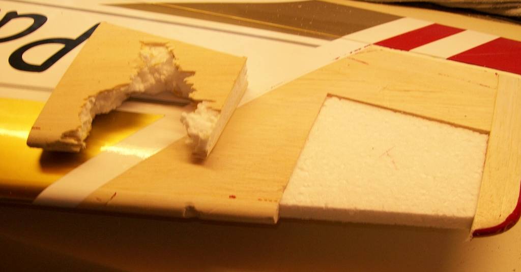

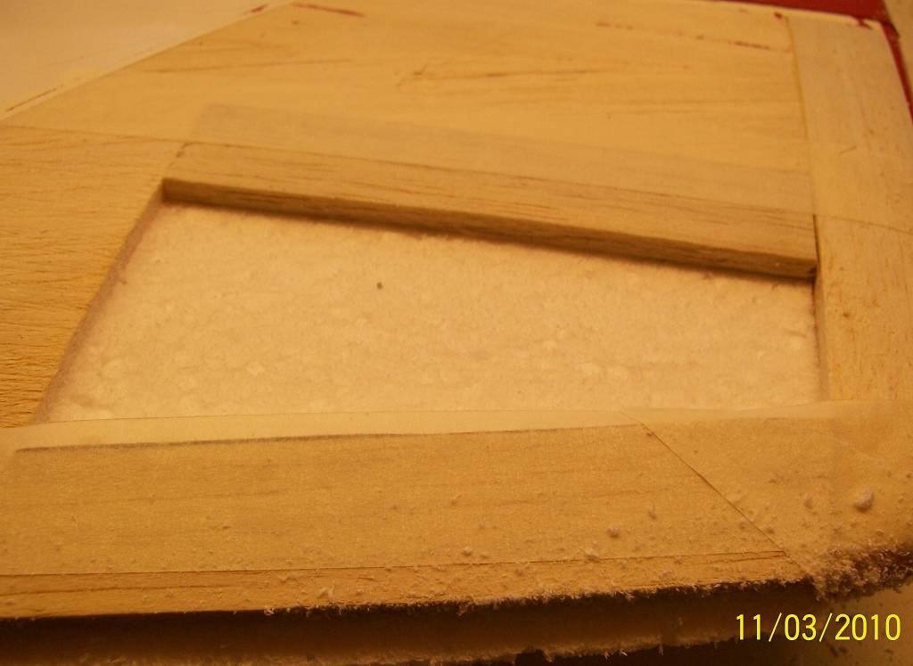

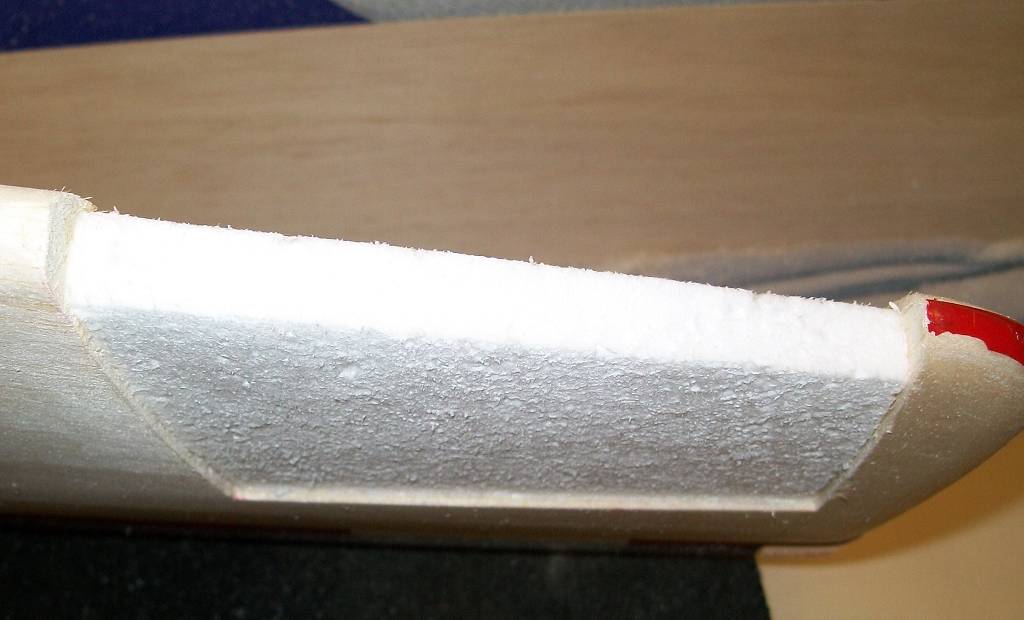

So, with the marking out and removal of the damaged area completed it's time to mark up some old styrofoam I had laying around which is really quite light. No rocket science applied here, just a good square edge and a bread knife will do nicely, keep the knife nice and square to the foam edge tho, it really is easy and much less fuss than getting the hot bow out for such a small task!

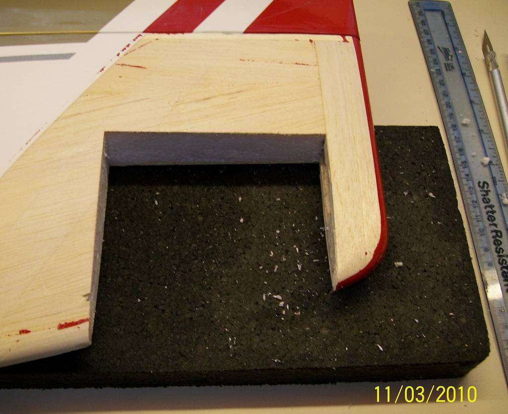

A nice snug fit on the 3 faces of the new plug of foam and oversized in depth, were ready to do some sanding!

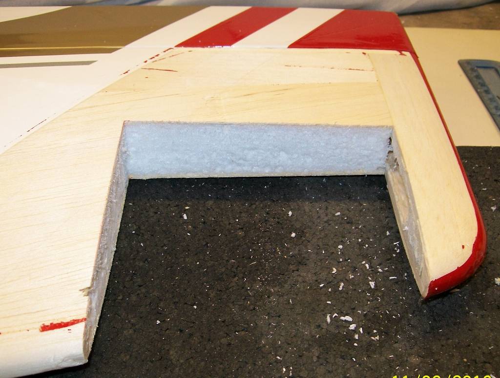

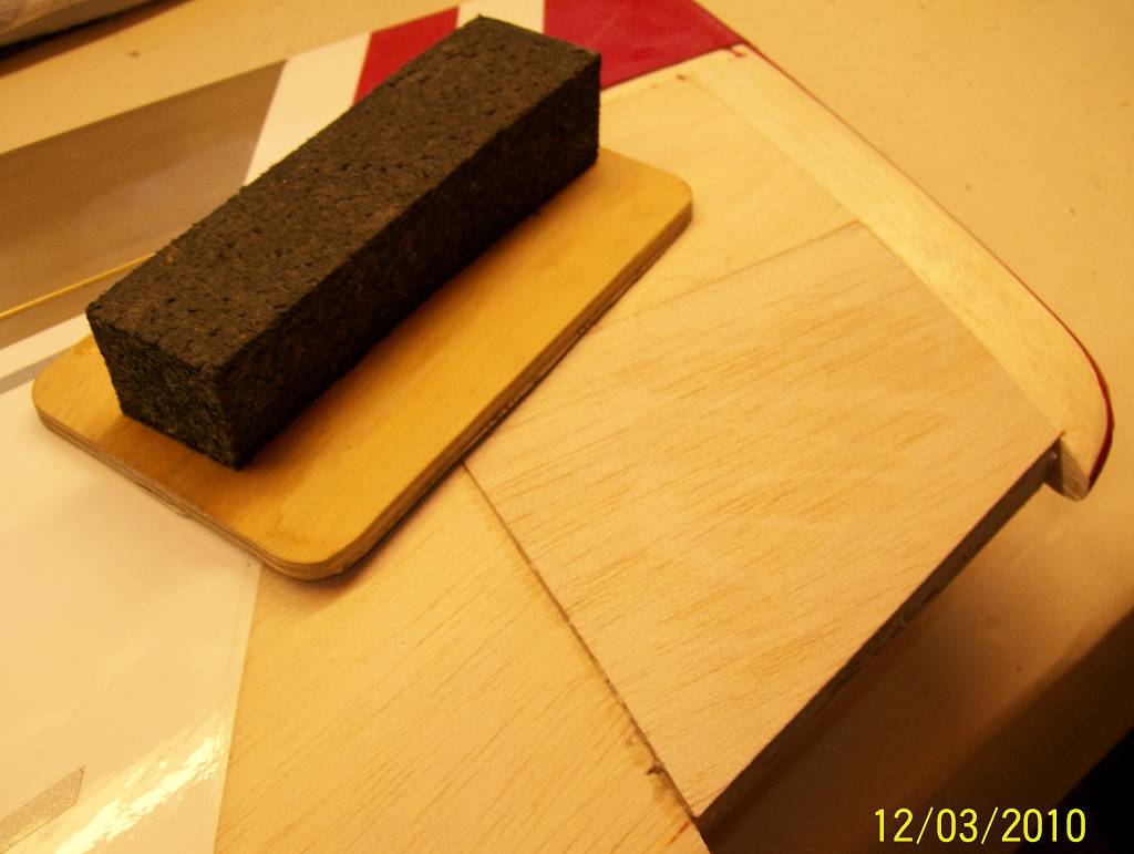

with the edges of the repair area protected with some masking tape I sanded the foam plug flush to both sides then fitted a couple of 3/32" balsa strips to one side, this pushes the plug proud to one side, I then sanded the exposed side again flush to the wing surface.

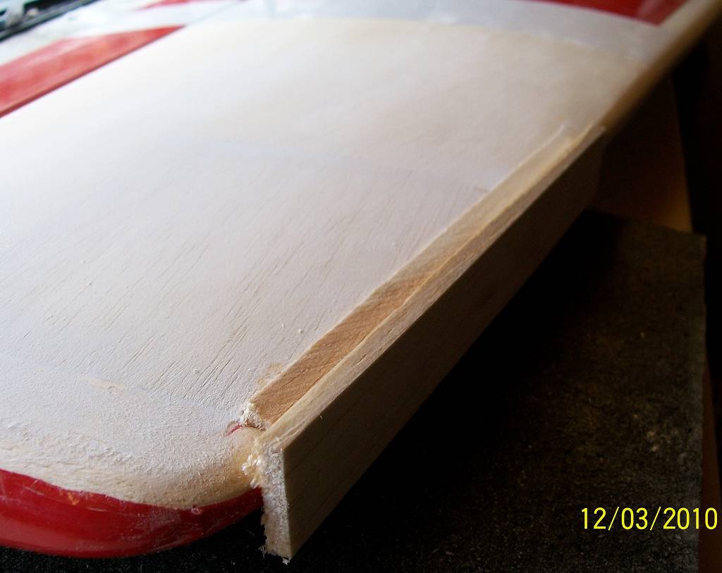

now we have a new foam plug ready to glue in that is recessed to take the new balsa sheet faces which will be 1/8" each so there will be a small amount of surface each side to sand flush with the wing when inserted, that's today's job!

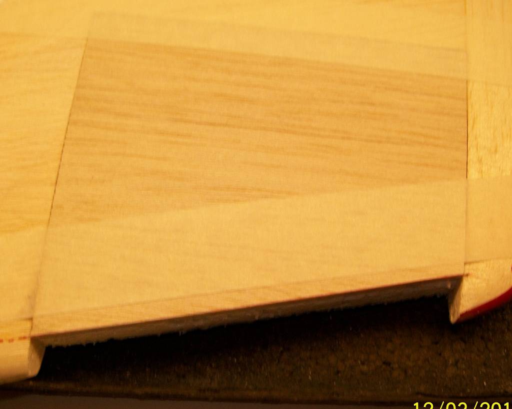

Anyway's, on with the show. Here's where I'm at right now after around 3 1/2 hrs of playing in my pen :
I started by making the balsa blanking sheets, I laid these in to the wing skins and marked off the leading edge of the foam blank then cut the leading edge of the new sheeting back.

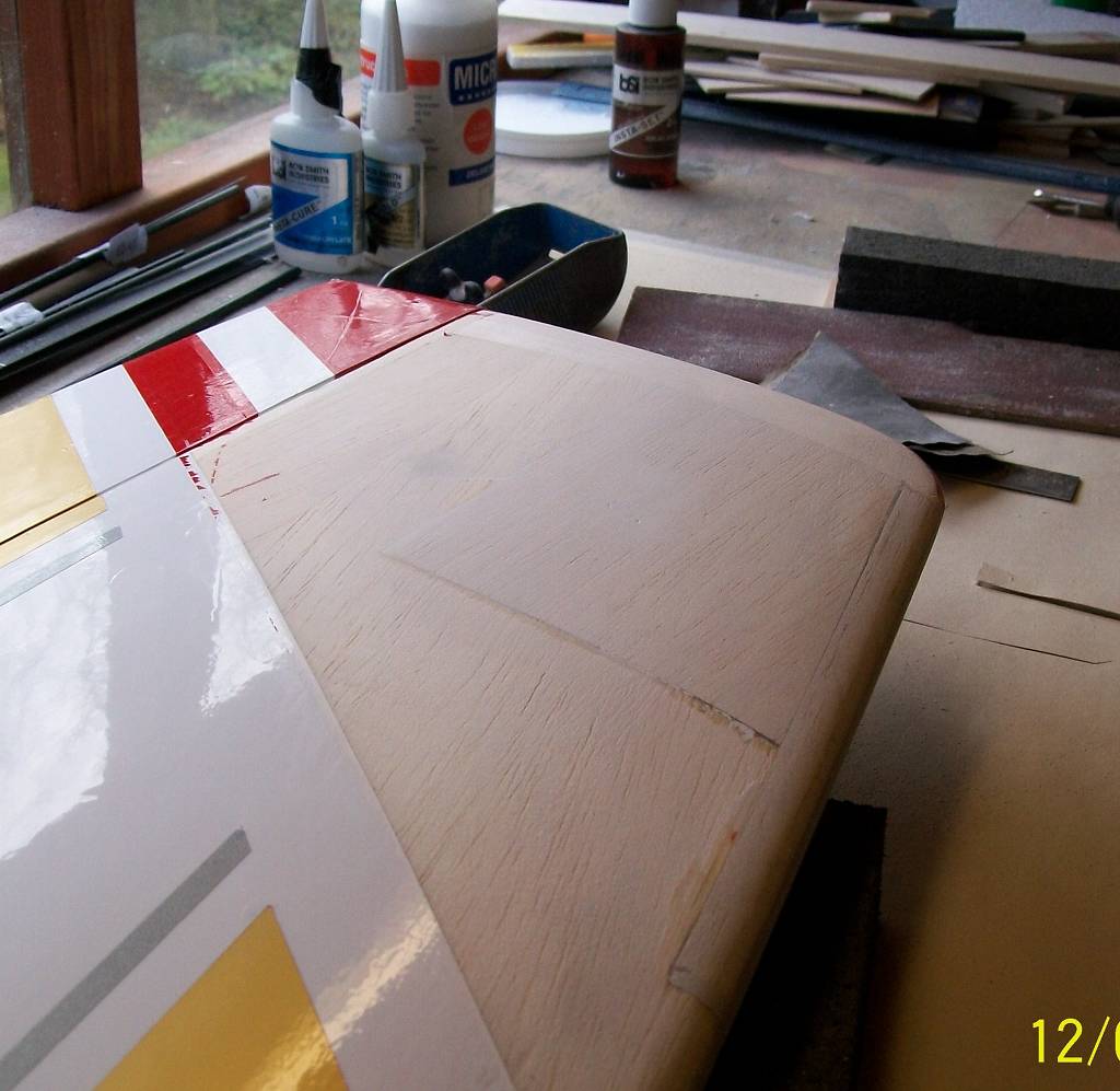

next up was repeating the process for both sides and finally getting the new skins glued in. I used Bob Smith's "Foam Safe" CA and Kicker for this, speed and weight control being the two critical issues for me here, I'd like to see this model go again this coming Sunday!

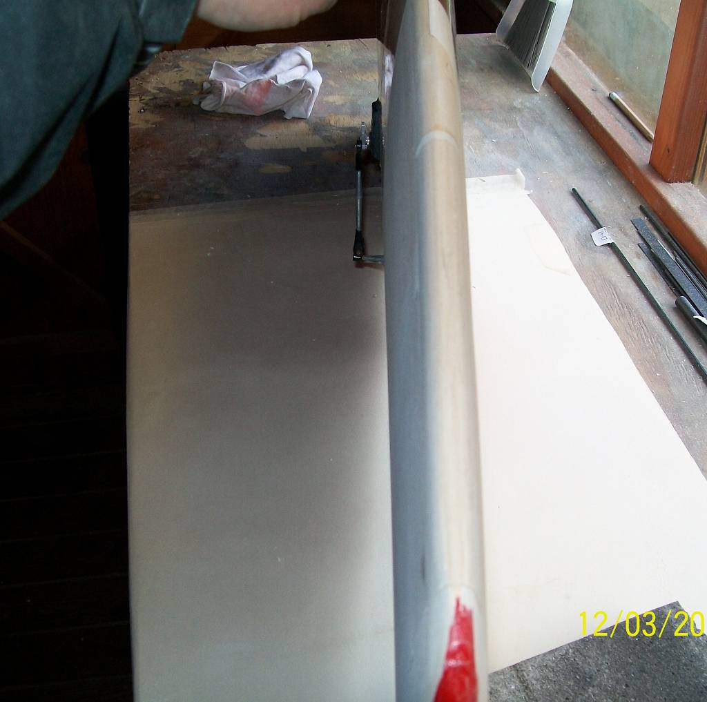

and after around 3/4 hr I was ready for a quick sand and start to replace the leading edge. I cut back beyond the repair skin seams with the original wing skins by around 4" and added a complete new section of L/E. I also cross cut a small section where the new met the old and inserted a cross grain piece, this is so that when I carried out the final sand of the new L/E section it would sand back slower to avoid over sanding in to the original section and creating a dip, in practice I'm glad I did as the L/E of this wing is very soft!

and on the final stage now of block planing and a final sand. A little fine surface filler and another finishing sand and were almost done!

thought I'd spend a little time filling out the small dents to the L/E near the root, a little cosmetic surgery is all that's needed here, the 300ft finish I call it
