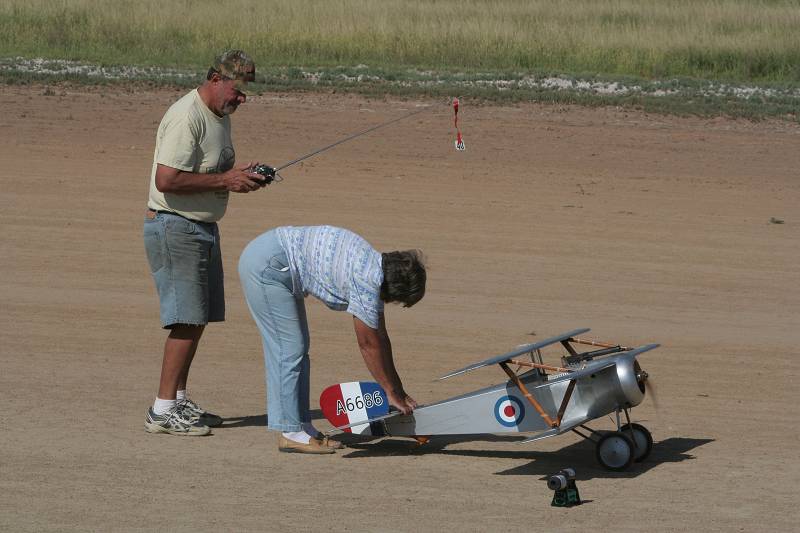

I have an uncontrolable WW1 triplane. Due to the scale landing gear which is well in front of the ballance point, I can't control takeoffs. I would like to install a gyro on the rudder for ground handleing.
Will the GY401 work for this application? Also, can I use a non digitial servo with the GY401. I have a 9202 installed.
After the airplane takes off, I have no further use for the gyro. Can I some how shut it off after take off?
I called Futaba tech support and they said "get a GY611". I don't want to spend $370 if the GY401 will work.
I have never used a gyro and have six other WW1 tail draggers that I have no problems with on take offs. Any help is appriciated.

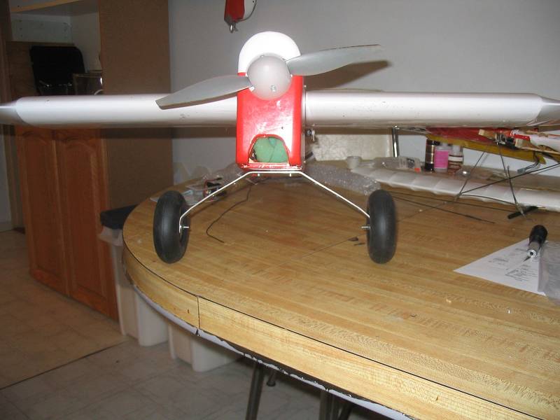

I have a plane called a NewBee which I had trouble on takeoffs. I installed a GWS PG-03. Very cheap. It works great my plane go straight do the field now. I can't shut the gyro off but I thinks help the plane fly. I don't do any fancy flying so the gryo never gets in my way.
ORIGINAL: jjmretired

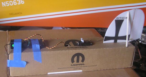

How I learned to do this was I built a small rudder and horizontal stab on a piece of 1/4" plywood and experimented. Before you fly make sure that Switch E turns off the gyro and turn the plane to ensure rudder only moves when commanded by the transmitter and centers when you are hands off. When the switch is on make sure the rudder turns in the direction of the turn (or more accurately a left turn generates a right turn rudder position). Also, with switch E on, the rudder will not go back to neutral until the plane returns to the start position or you move the rudder back to neutral with the transmitter.
Works great and you don't need the S9254 expensive servo on an airplane. In fact you can use a non-digital servo but remember to switch DS (digital servo) off on the Gyro or, according to the manual, you will ruin your non-digital servo.

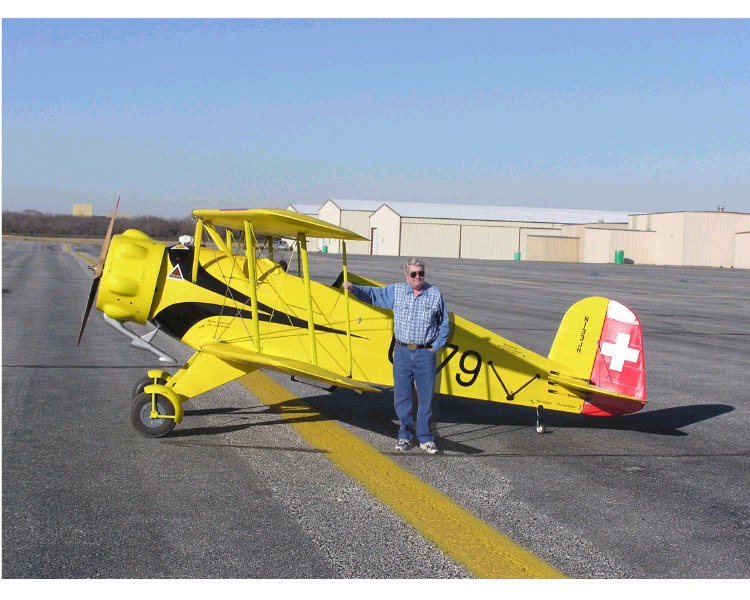

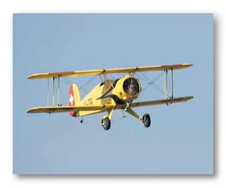

Wow Hank! This is an extremely timely post. A good friend (Gremlin Castle on RCU) bought a GY401 this week for use on his big DC-3. I ordered one for use on my 1/3 scale Bucker Jungmeister. As you probably know there is very little information out there on airplanes in comparison to helicopters.
I probably have at least 60 flights on my Jungie but I've always toyed with the idea of installing a rudder gyro in it because like jjmretired's plane the gear is really forward and any amount of cross wind (common here in Texas) wants to make it weather vane pretty strongly. Of course adding the right amount of rudder is the key. I often get too much or too little. I don't have this problem with the other gassers that I fly. I am using a single Hitec HS-635HB in pull-pull on the rudder.
You said: "Then, turn off HH mode by switching switch E. Carry the plane to the flight line and, when it's lined up with the runway heading you want, switch back to HH mode and wait 3-4 seconds while the gyro initializes. Then move the rudder stick back and forth a couple of times and then center it. Don't forget this last step or the rudder may have an offset."
It is not really practical for me to carry a 27# plane out to the runway with the engine running and place it in position for takeoff. It would seem to me that once you initialized the gyro in AVCS mode you could taxi out, using the rudder stick, and line up with the direction that you expected the AVCS to hold without waiting the 3-4 seconds and moving the rudder stick back and forth. Am I wrong in understanding that the AVCS constantly updates the desired direction as the rudder comes back to neutral?
You said: "After takeoff (or if you get into trouble) turn switch E off and you are back to regular rudder control.
What I use the gyro for is on rudder for 3d Hovering and torque rolls. I take off in with switch E off and turn it on in flight when I'm ready for some 3D. Then I move the rudder back and forth a couple of times before going vertical and center the aircraft."
Do you take off with the AVCS on or off? These two statements seem to conflict. Are you saying that the gyro has to be initialized before you pull up into a hover? Does the gyro have to go through an initialization process every time you move the switch from normal to AVCS? I thought that I understood that the initialization only took place one time during a flight when the receiver was turned on after the transmitter had been turned on with the switch in the AVCS mode. Right/wrong?
At this point my only intention in using the AVCS is for takeoff.
Thanks a lot for your help Hank, I'm in the learning mode at this time.

I will be using a Hitec HS-635HB analog servo. Seems like this gyro will do just what I want. I do have a cheap junker that I can fly it in before I put it in the Jungie. However, I built a super cheap simulator that I can put it through it's paces on. Here is a photo.

Nice simulator. Looks like the one I built except mine had a ply bottom and balsa stab and rudder.
Let me know how it works out for you. It seems very few people are using gyros outside of the Heli crowd.

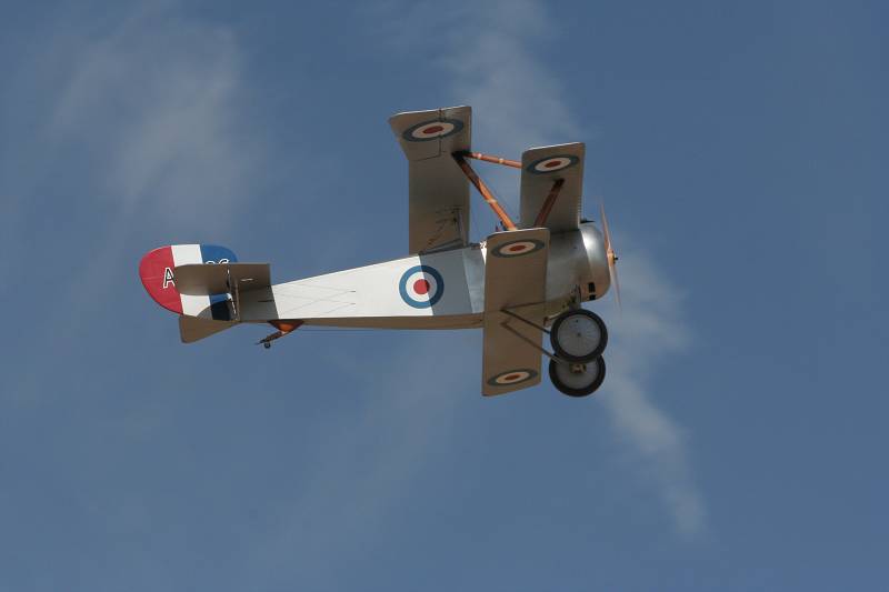

JR makes a gyro for airplanes with very good instructions. It can be used with Futaba and Airtronics. G500A. www.jrradios.com/ProdInfo/Files/JRG500Agyro.pdf I don't understand why Futaba does'nt at least give some instructions on airplane set up for their gyros. Attatched is my hard to taxi Nieuport Triplane. Jay

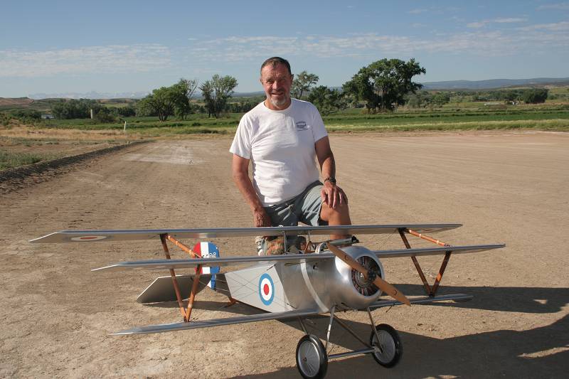

jjmretired, that is a great looking triplane. Needs a pilot though.
As you said Hank "It must be nice to be retired and get to fly when you want." You are so right. I retired at 57 in 1999 when the company made me a great offer that I couldn't refuse. I then went back to work for them as a Process Control Consultant for about 3 years and then really retired.
There is very little information on gyro setup for airplanes. There was a pretty good write up in the Futaba GYA350 manual that is here. http://manuals.hobbico.com/fut/gya350-manual.pdf Unfortunately Futaba discontinued the GYA350. It was in the same price range as the 401. In this manual it says to absolutely not use AVCS mode for takeoff. And I have read here and other places to use AVCS for takeoff. Hank I know that you takeoff with the AVCS (HH mode) off but have you ever made a takeoff with the AVCS (HH mode) on? How did it work?

The reason there is no pilot is his seat was taken by the gyro for the first flight. He now has his seat back and the gyro was moved forward. My wife holds the triplane, I rev the engine up, she turns loose and it's off the ground in 50' The gyro along with the prop blast on the rudder holds it straight as an arrow. Jay P.S. She's going to love this picture going on the internet.
