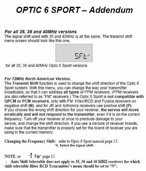

add addendum for Optic Sport Manual (also applies to Optic 6FM) = Set to Negative Shift for use with 35, 36 * 40 MHz receivers.
& copy from Eclipse Manual
{provide link and document as original URL down whilst original web page is being fully rebuilt}.
