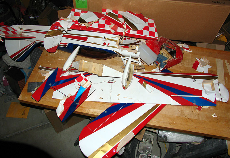

my biggest scare of all time was this morning and i really am glad no one got hurt. i also need to make a formal apology to anyone else who has had an issue with a Futaba 6014 2.4Ghz Rx shutting down from heat, and i can also say i now know how bad it feels.
i'm not going to bash Futaba, and i am going to keep on using all my Futaba gear, especially since i just bought the 12Z this year, but i am deeply dissapointed at losing one of my best airplanes in the learning process.
the Skybolt was in the air at the time, and after we collected all the scraps and set it in under the shade, the Rx after about 2-3 minutes cooling time, finally went from Red to Green and control of the servos was reinstated.
i guess it will also be best to send the Rx in and have it checked.

RE: Futaba 6014 heat failure (crash)
OK, the simple version (at least i hope)
the 6014 when first received was tested in my best test for temp issues...meaning that i let the airplane and radio sit in my Black Silverado for an hour on a 100 degree day.......never checked the actual temp of the Rx as i felt if it worked after being in a Black truck that long with ambient temp as it was, there definately would not be a temp issue with this Rx........test result was good.
the 6014 is then tested in a test bed, in this case a GP Big Stik. i range test with and without the engine running..........range check was well over 100 paces. 1 pace equals 3 feet in my stride.
then tested in the air minimum 3 flights......again all is good.
now the 6014 was mounted in my Skybolt. again same testing, and same test results........flown 2 weekends in a row. all flights were however done before 9AM.........our flying time rule has been removed so we can go out at 6AM now and fly. temps were much cooler.
the day this happened was getting near 95 degrees and it was well after 9AM.
the Rx was NOT mounted under a canopy.....look at the location again, the cockpit area is behind the Rx....the wood you see behind the Rx is the dash. the foam turtle deck is 1.5 below the Rx and would have been shaded by the upper wing. the Antennas were at right angles to each other before the crash.....i only undid the velcro to show that i did "Standoff's" as per Bills install guide....the plane came in and tagged the left wing tip first at impact knocking things towards that side and basically rearanged most of everything.
now of course i get the reply from Bill Baxter with the usual yada yada, and send everything in......i probably would, but i did some serious testing today and this is where the Red flag goes up.
my test was to put the onboard system in a shoe box, cut a 4" hole to allow warm/hot air to enter. i set this up on my bench and using a hair dryer (i don't believe in torturing equipment) i placed the dryer 3 feet from the box.............got everything going and played with the sticks til "ta da".....no response from the servos...........checked the temp of the Rx with my Eagle Tree V3 with temp sensor and temp was 102 degrees.
in disbelief i let things cool down and check again (actually 4 times) and each time the Rx stopped responding, the temp was around 102 + or - a couple degrees.
the 4th test was done with brand new servos so as to rule out a bad servo from the original flight system.
this Rx is not working once it gets past 102 degrees. this is definately a Futaba defect.
now sending it in bothers me as i am not sure i can trust Hobbico with the findings.
they already claimed that a plane that i own that flew apart couldn't have happened, and that no one has reported such failures, but the plane that i am talking about has been documnented by many users to have just the exact faults that i speak of. So, how do i go about trusting techs?
