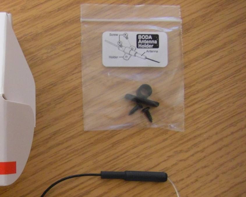

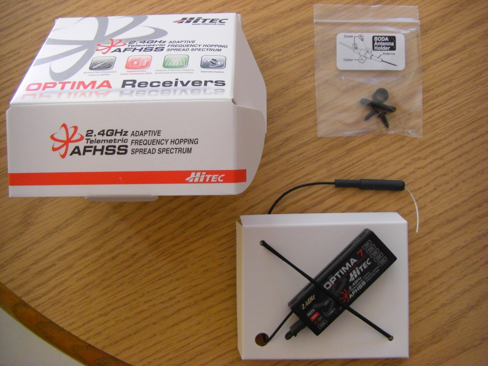

    I received my 2 RX's from Hitec yesterday, only taking a week from the time I mailed the coupon, EXCELLENT!!!
    These 2 RX's each came with a BODA antenna holder, which my A9 didn't include.
    MIKE or BRENDAN- Can we order these? Part # ?
    They look pretty useful, being made out of a very pliable material that would hold the antenna securely and provide excellent vibration dampening.

    Iā€™m looking into whether or not there is a part number for this item and if it can be purchased separately.

    What is a BODA antenna holder?

    A "thingy" that holds the antenna part of the coax. "Boosted Omni Directional Antenna".

    OldRookie- Look at the picture in Jai Williams post above (post #305). Upper right side of his picture.

    Hey Brendan
    Were the BODA holders supposed to be included with the receivers? I got two of the packs of 2.4G TX module with 2 x 7ch RX from Tower and they didn't have the holders in the box. If we could order them that would be good as they look pretty handy. I have four 7ch RX now and will be ordering more 7ch & 9ch RX so would be interested in getting some BODA holders.
    Cheers
    Da Orc

    I got my receivers on Monday and they weren't even in a box ,much less with a boda holder. Mine came in a small plastic bag folded over with a staple in it. They where then shipped in a bubble wrap envelope. I really feel cheated now. I was hoping for the wrap for the receiver and didn't get it either.
