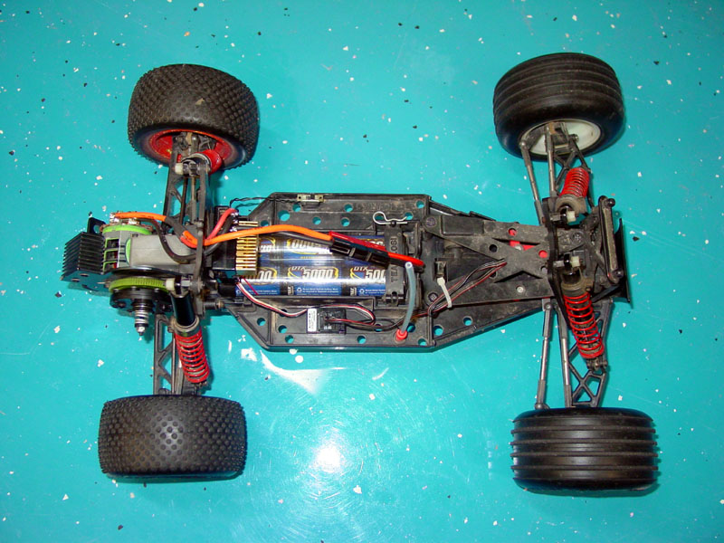

Here are some photos of the installation in the truck. Is there anything I am doing wrong in these photos?

Old 03-21-2010, 08:27 PM
coriolan
coriolan's Avatar
Join Date: Sep 2006
Location: Canada
Posts: 883
Gallery
My Gallery
Models
My Models
Ratings
My Feedback
Default RE: 2.4Ghz Range Sucks
That's a perfect position for the antenna, this is puzzling KO radio have very good reputation
