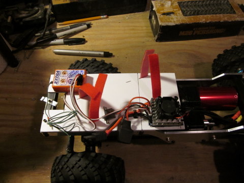

This is a build loosely based on a '42 Kenworth wrecker. I'm using a worminator chassis with outcry bushless motor and ESC. Tamiya King hauler cab and the rest is
scratch built including the boom and trunion/winch base. I've made much more progerss since this pic, but need to download and size them. More to come soon.

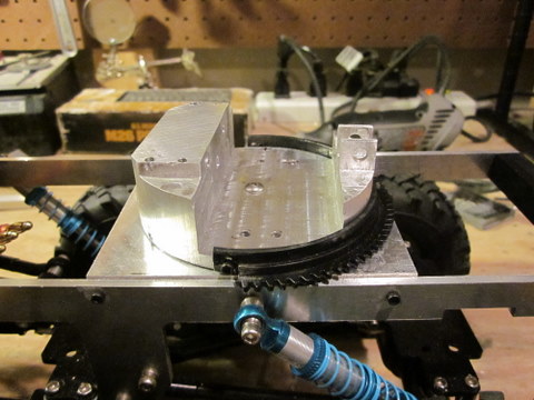

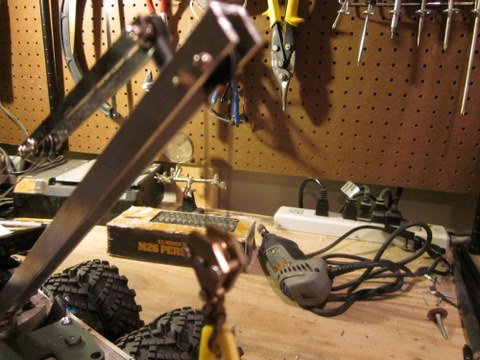

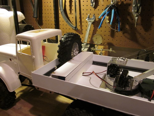

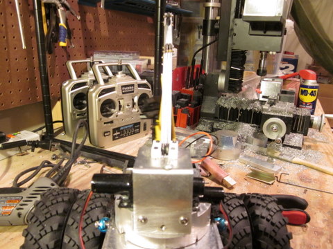

Update on the wrecker. These pics are of the the winch/trunion deck, electronics deck which will be hidden under the cab, and the winch's and boom with all lines installed.

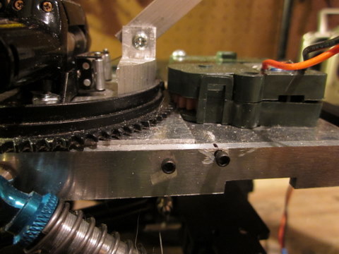

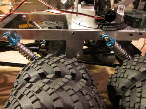

Couple more pics. In These you can see the tank turrrettraverse gearbox and turret ring used to rotate the boom. Also I had to make some new shock springs to hold up the weight of all the
new aluminum and lifting gear in addition to any load being lifted.

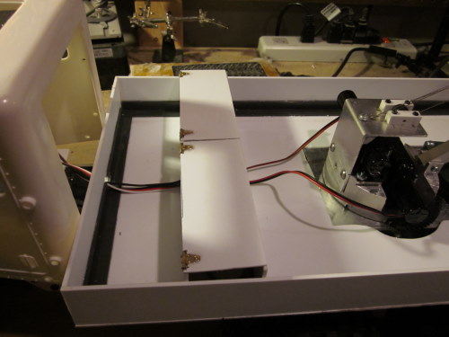

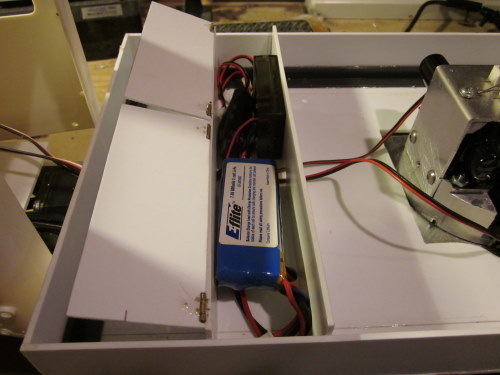

Some more progress. Rear deck and tool box to hide winch ESC's along with spare tire.

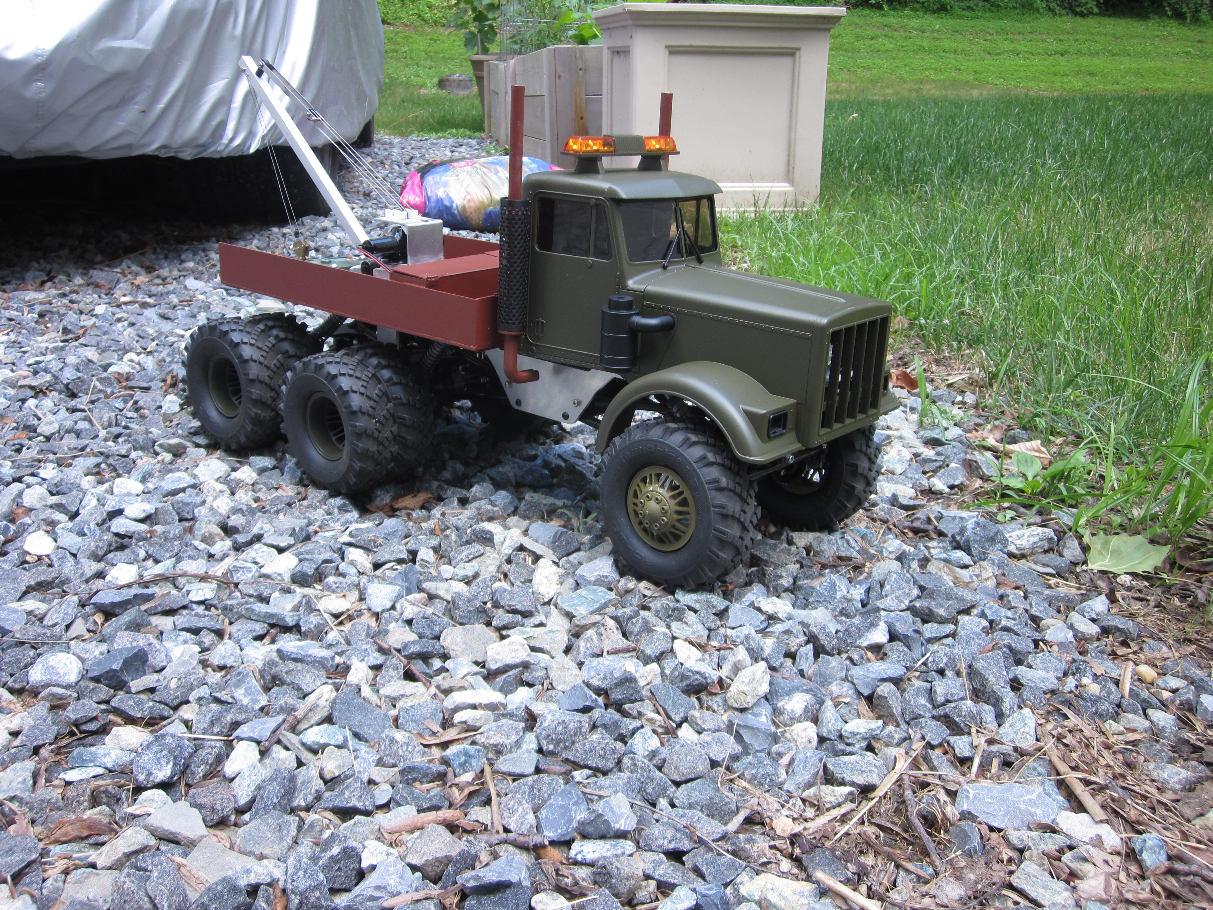

Got bored of this sucker staring at me from the shelf so I slapped on paint and some details of the cab. Looks cool but pretty much non practical as most r/c's don't have a neutral. Can still lift or pull a crawler out of trouble though. Light bar is pretty nice, only around $20 shipped and is plug and play to an open channel on your rx for on/off and switching between 4 sequences. Have mine on the gear channel.

Very nice, Benny. Where did you get the gearbox that rotates the boom?
Old 06-20-2017, 04:48 PM
TheBennyB
Join Date: Jul 2010
Location: West Grove, PA
Posts: 3,147
Had an extra laying around from a 1/16 Heng long tank.
Taigen Tanks Turret Rotation Unit (TAG120619) | eBay
And the ring.
Large HengLong 1/16 Tank Turret Rotation Steering Gear pinion 360 Degree | eBay
Old 06-21-2017, 05:22 PM

Posts: 712
It's a great looking truck Benny. awesome lights. they fit the truck well.

Looks good, you should make a tool box to cover the motor that runs the boom. It'll hide the power wires and protect the motor from dust and debris.
Old 06-22-2017, 04:23 PM
TheBennyB
Join Date: Jul 2010
Posts: 3,147
Yea, was thinking about that. Quick box out of styrene should do it, only issue may be the gearbox is spring loaded to make up for the not so perfect circle of aluminum I got to make the winch base. Suppose I could just double side tape it to the top of the gearbox so it can travel with it.
