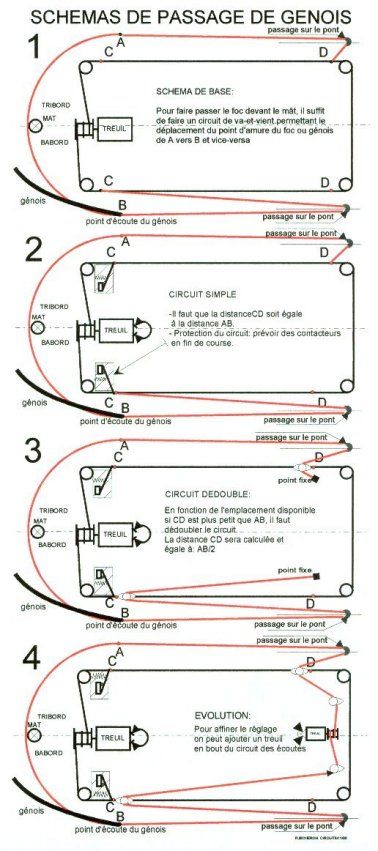

I have some files regarding overlapping jibs and genoas that I have collected in the resceach for the 1:24 Baltimore Clipper (Pride of Baltimore) that I will be building sometime. After the house renovations of course!!!!!
I cann't recall who send them to me, so I hope its is ok with them.

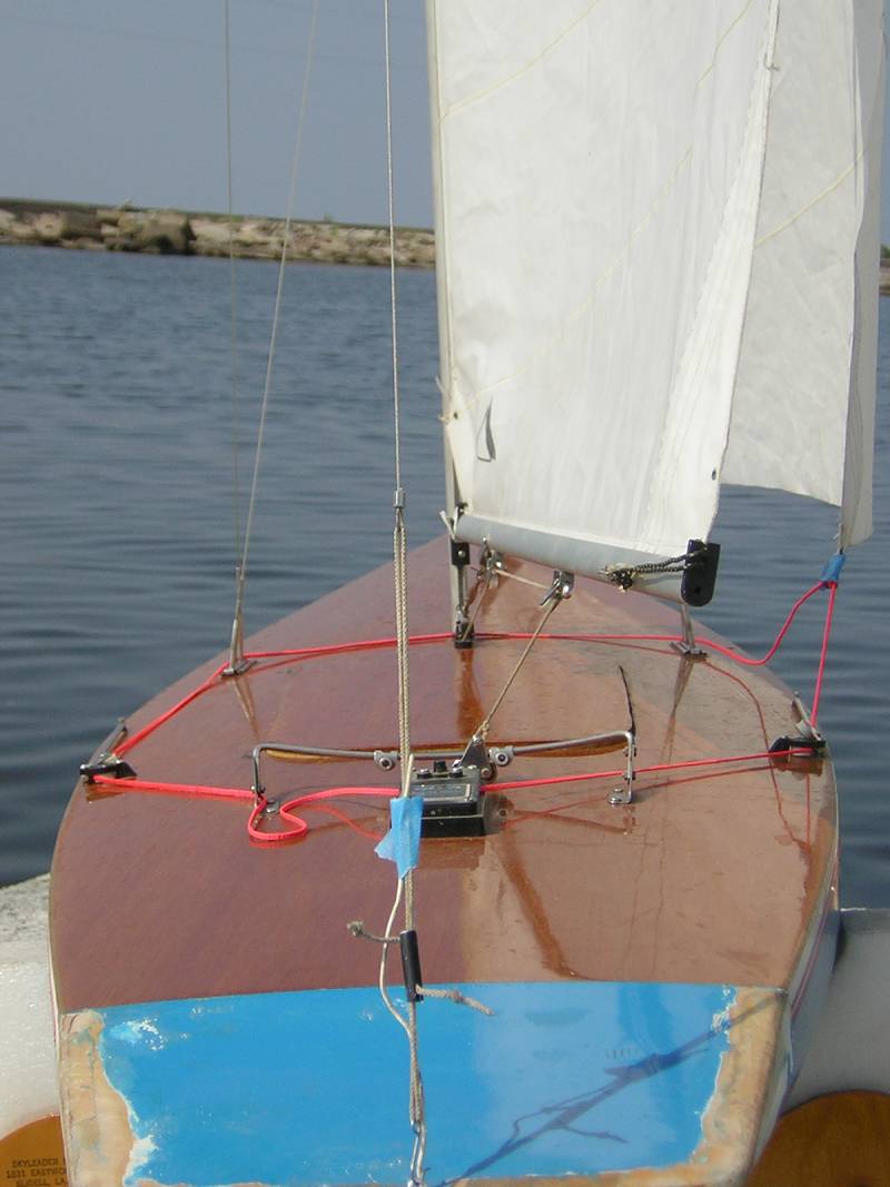

I have a Vortex 60 that has an genoa, mabey 130%? It is a fairly easy setup, but the servo is complicated. It is simply a continous jib sheet that goes to a free spinning, geared motor. Here is a link to a video clip and some pictures. The pink string is the continous jib sheet.
[link]http://www.clemson.edu/~elevert/images/reach.mov[/link]
[link]http://www.clemson.edu/~elevert/images/tack.mov[/link]

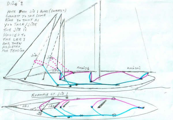

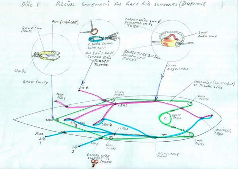

I'm building a scaled up version (1/20) of the Artesania Latina "Clara May" (1891 ketch) that has 4 jibs. While I've come up with a few ideas to tack and adjust the sails, none of them do the task as well as I'd like.
If anyone has a system for controlling and adjusting multiple jibs, I would be more than grateful for the advice.

To Guiri, Patmat & SloopJohnB.
Thanks for your feedback. I now have a better idea of what I'm doing and having set up a dummy rig using one of the setups from the dutch site referenced from http://www.modelboatmayhem.co.uk/Forum.htm, I am confident it will work well on the water - as suggested by Pat. Thats still at least a couple of months away.
Does anyone have a good idea for attaching the sheets to the clews to minimise the possibility of the clews snagging on the stays as the boat tacks.
Frank

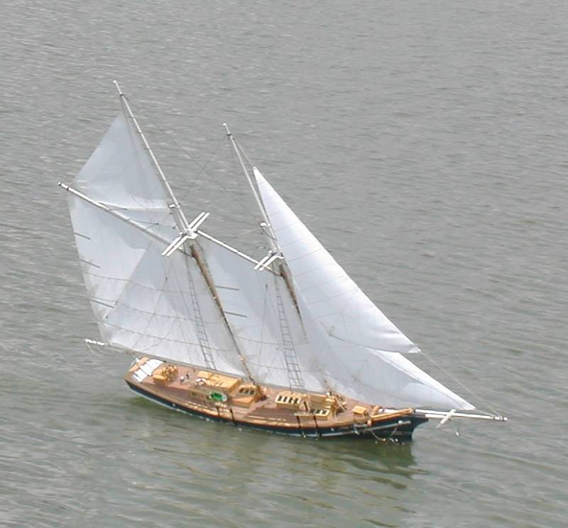

My schooner utilizes a set over lapping jibs. Unfortunately they can not be controlled separately. They all run off the same wench drum along with the main driver and fore gaff sails. One servo adjusts all five sails at once. If you have questions let me know. Oh the ships name is Prince de Neufchatel and is in another thread here....or go to www.princedeneufchatel.com for more info including a look inside the hull.
Robert
