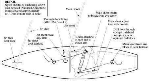

I am building a new sailboat. It is 44 inches long. I don't know how high the mast should be because it does not say on the plans.
What torque should the servos that control the two sails have (the front and the main sail)???

As shown in the picture, the control arm is mounted on the servo at it's center point. A line is attached to each 'end' of the arm, one running to the foresail, the other to the mainsail attachment points through a hole in the deck (it's all mounted inside/under the deck). At full travel in one direction the servo pulls the sail in 'tight' (straight fore/aft), at full travel in the other direction the sails are full 'out' (90 degrees with the centerline of the boat, maybe).
The amount of 'travel' depends on the length of the servo's control 'arm', where the lines are connected to the 'arm', and also where they are connected to the sail/boom. Need less 'travel' on one sail than the other? Move that line's attachment point closer to the 'arms' center (slightly). Need lots of 'travel'? Attach the line to the end of the 'arm'. Lots of variation available.
The 'biggy' is that the servo be strong enough overcome the pressure of the wind on the sail. The more area of the sail and strength of the wind, the larger the servo. The stiffness/strength of the servo arm should be such that it doesn't flex when in use (or at least not very much ).
From there, it's just a matter of adjusting everything to suit your boat. Good luck!

The torque rating needed from sail control servos depends very much on the sail area. As a guide, my Saphir, with 3,700 cm^2 sail area sails nicely in all but the strongest winds on about 12 kg/cm torque (a GWS S04 with 5xNiMh cells). The Hitec 815bb mentioned has about double that but weighs about 50% more than the GWS.

The GWS has one benefit - the price. Its only got a max movement of about 90ΒΊ, so I had to compensate with a longer arm than the standard one that came with the boat. The sail movement is also enlarged by anchoring a sheet at the stern, then forward to a pulley attached to the servo arm, back to the stern again where runs over another pulley and finally forward. The sheet is then divided in two: the first goes to the main sail and the second to the foresail.
One thing to make sure of is that your sail servo is very firmly fixed in the boat. The force of the sails will otherwise pull it out.

On a 34 cm boom (Measured from pivot point - boom itself is a little shorter) it's 22.5 cm from the swivel point. Make sure the foresail distance from the swivel point is the same as for the mainsail.
