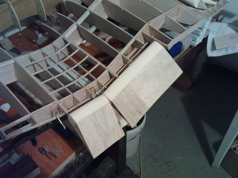

Hi all...
Since I'm new to forum it would be nice to present my build...
It's a Brian Taylor 1/6 F4U Corsair... I will try to make it as scale as possible for my abilities...
It is classic balsa + plywood build and it will be covered with 2 mm balsa sheets and finished in lightweight glass cloth + epoxy (or vinylester)...
Here are some pictures of my build along with YouTube video of working flaps...
[youtube]http://www.youtube.com/watch?v=heYTeDxE2Ko&feature=player_embedded[/youtube]
The video has a crapy quality because it was taken with mobile phone camera, but it shows flaps movement...

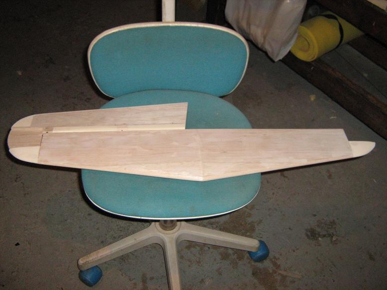

I managed to catch some spare time today and to do a bit on elevators...
One half is complete... As balsa is a bit expensive around here, I mainly use XPS for aestethic purposes (leading edges of elevators, rudder, etc.) with balsa on hinge points... Idrilled holes in elevator and tailplane and glued in pieces of brass tube with epoxy, for hinges... This elevator half and tailplane are sanded and ready for covering in glass cloth + epoxy...
here are some pictures...

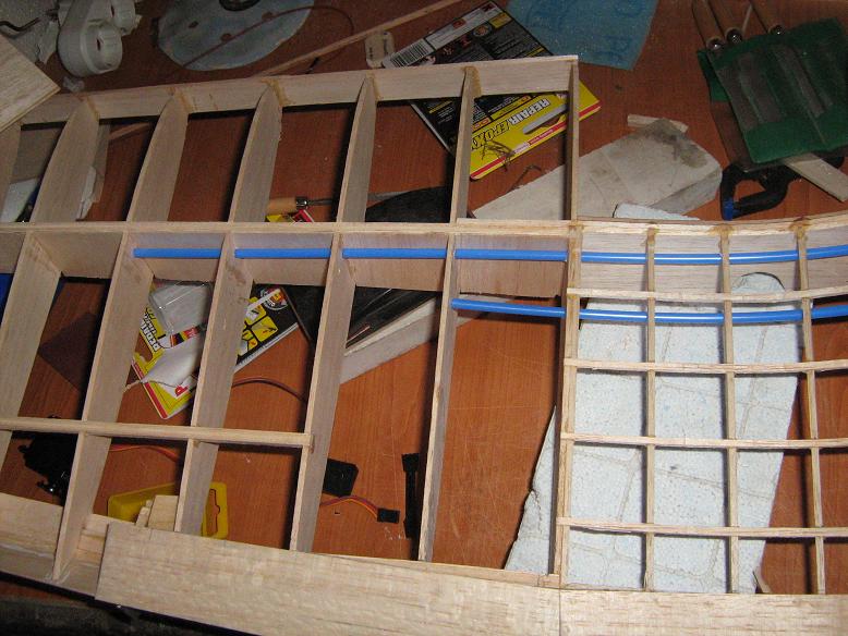

hi all, here Iam, returned from holidays and continuing with the build...
For last few days Iwas working on flap and aileron pushrods... I'm using Sullivan semiflexible for linking servos with bellcranks and 2 mm steel rod for connecting belcranks with ailerons and flaps... port side flaps and ailerons are connected with bellcranks but bellcranks are not conected with servos, so flaps are opereted by hand in video... it took me nearly 10 hours to get everything working as it works, but it stil needs some tweaking...
so, here is video and some pictures...

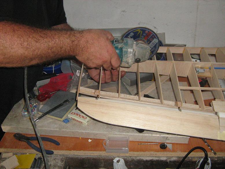

a few more pictures, just to show how my father cuts the channel in main spar for carbon fiber reinforcements...
he took the he initiative in cutting so I was just standing beside...

Wow, that's a serious cutting tool!

yep, he finished cutting in less than 5 minutes...
now, it was not all about cutting, I'm working on right wing half on flaps and aileron... I cut and drilled all the holes for pushrods and now I have to install belcranks and connect everything with servos... I will post some more pictures tomorrow...

Imade some changes and placed servos behind flaps. Now Ihave full movement as Iwanted.

I can't set my mind, so I would need your help.
As you can see on pictures, flap servos have been installed. I have to reinforce the ribs between which I have glued the servo holder. Is it enough to reinforce the ribs with glass cloth (80 or 100 g) and epoxy, or should I use carbon cloth, kevlar cloth, or maybe carbon-kevlar hybrid cloth?
I'm not smart enough.
