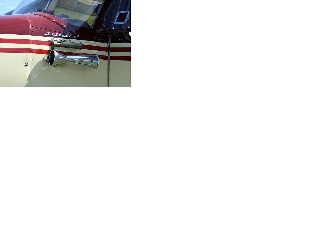

I am in need of two venturies. Does anyone make them or am I on my own? Here is a picture of the two that I need. I need 1 each of both styles.

I would think you need to make your own. I am sure someone has sold some but I have never seen any. Should not be too bad to make.

I have made several from sheet brass. .015 from the K&S display at the hardware store. Just lay out the pieces figuring the taper and diameters needed and solder it up after rolling the end pieces using a short piece of tube for the center. Might take a little trial and error using paper and trace it on to the sheet brass.
Here's one of then on the side of my N28, it was part of the Weyman exhauster that pressurized the fuel system.

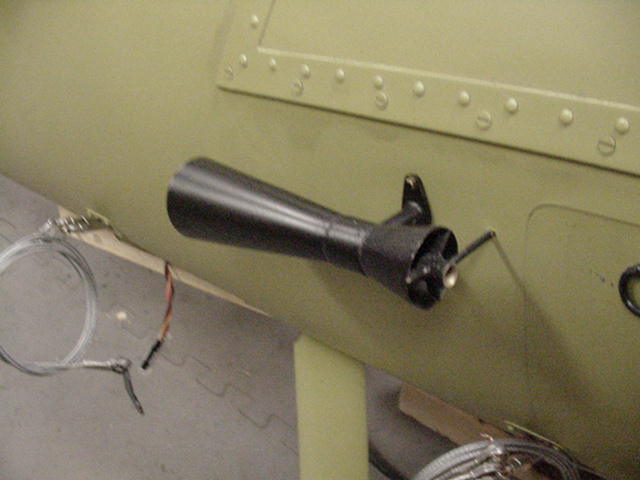

Heres that venturi, mostly I just wanted to see if the upload would work.
