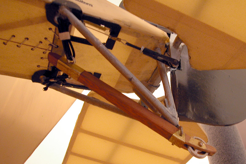

In the photo below you can see my EIII above a BUSA eindecker. I bought the BUSA eindecker kit, built the wing and then scratch-built the rest of the model based on scale drawings.

After 10 years of hanging on the ceiling it's plenty dirty! But seriously, at the time I was building this I was aware that many of the original EIII's had all sorts of assorted dirt and oil stains but just didn't have any idea how to simulate that on a model. BTW, I'll be bringing this model back with me to Japan and hope to get it flying again soon. And if that project goes well, I might think about building a set of scale, warping wings, since when I built the original model, I had that in mind and made allowances for it.
Note: In comparing the model with the 1/4 scale Proctor plans, I discovered that the BUSA eindecker isn't really 1/6 scale (which isn't really surprising since it's not really scale anyway). The wingspan is 60" while a 1/6 scale EIII would be 66 inches. So I guess that makes it more like 1/7 "scale" or thereabouts...which explains why the 1/6 scale WB Spandau didn't quite fit where it was supposed to fit.

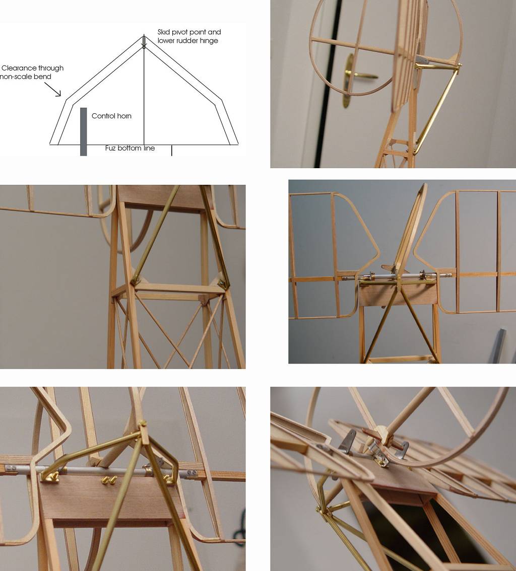

The BUSA eindeckers are hugely popular and probably account for 90% of all the "eindeckers" you're ever likely to see at the flying field. And not a one of them is scale...and no one seems to care. The reason? It's fun to fly (about the same as an Ugly Stik) and easy-peasy to build with just one wing. You could probably frame the entire stock kit in two days. For a lot of guys it'll be the only "WWI" model they ever build.
Let's take those one at a time. 1) The rudder: Do you want it to be a scale size and shape? Have you thought about how you will attach a full-flying rudder? 2) The full-flying elevator: Be aware that having a full-flying elevator where the LE goes down when the TE goes up, makes the model "twitchier" on the elevator. Also do you want the elevator to be a scale size? The BUSA stab/elevator is at least 10% if not 20% larger. 3) Scale tailskid (and support): Bear in mind that the bottom of the full-flying rudder is attached to the skid support. You'll probably have to do some custom silver soldering here. 4) The dummy engine: The BUSA cowl is completely out of scale. It's too long and too narrow. So if you're going to use a scale dummy you're going to have to find a more scale cowl. The long, narrow ABS cowl is a big part of what gives the BUSA eindecker its unscale "torpedo" appearance that's so immediately recognizable. And if you do decide to go with a scale-depth cowl, you'll need to built a recess into the firewall to allow proper engine placement. Anyway, look around for aluminum pots you can cut down. Also remember that, as I mentioned above, the BUSA eindecker is really closer to 1/7 scale, so keep that in mind as you're making a dummy.

The only things I want are: full flying rudder, full flying elevator, scale tailskid, and dummy engine.

The elavator: I don't mind it being more twitchy, I am more used to twitchy fast reacting planes; it should be scale shape and at least look right.
The tailskid: I guess it does not have to be completley scale, but look more scale than the stock.
I guess the "torpedo" like cowl is alright.

I'm finishing up the BUSA 1/6 N17 with fully flying rudder on pull pull. Not a big deal to build out. I read the bottom of the FF rudder is attached to the skid support. From the pic above I cannot tell if the pivot line is vertical or leaning forwward a bit. Either way it seems one would solder two small brass tubes vertically in two places. The skid touch point and the rear of fuse where it meets. Piano wire attached to rudder (L at top) slips in tubes with wheel collars..one below fuse (out of sight) and other top of skid, recessed effectively hidden. I was looking at the aerodrome versions today- EZ and undercambered wing version.
