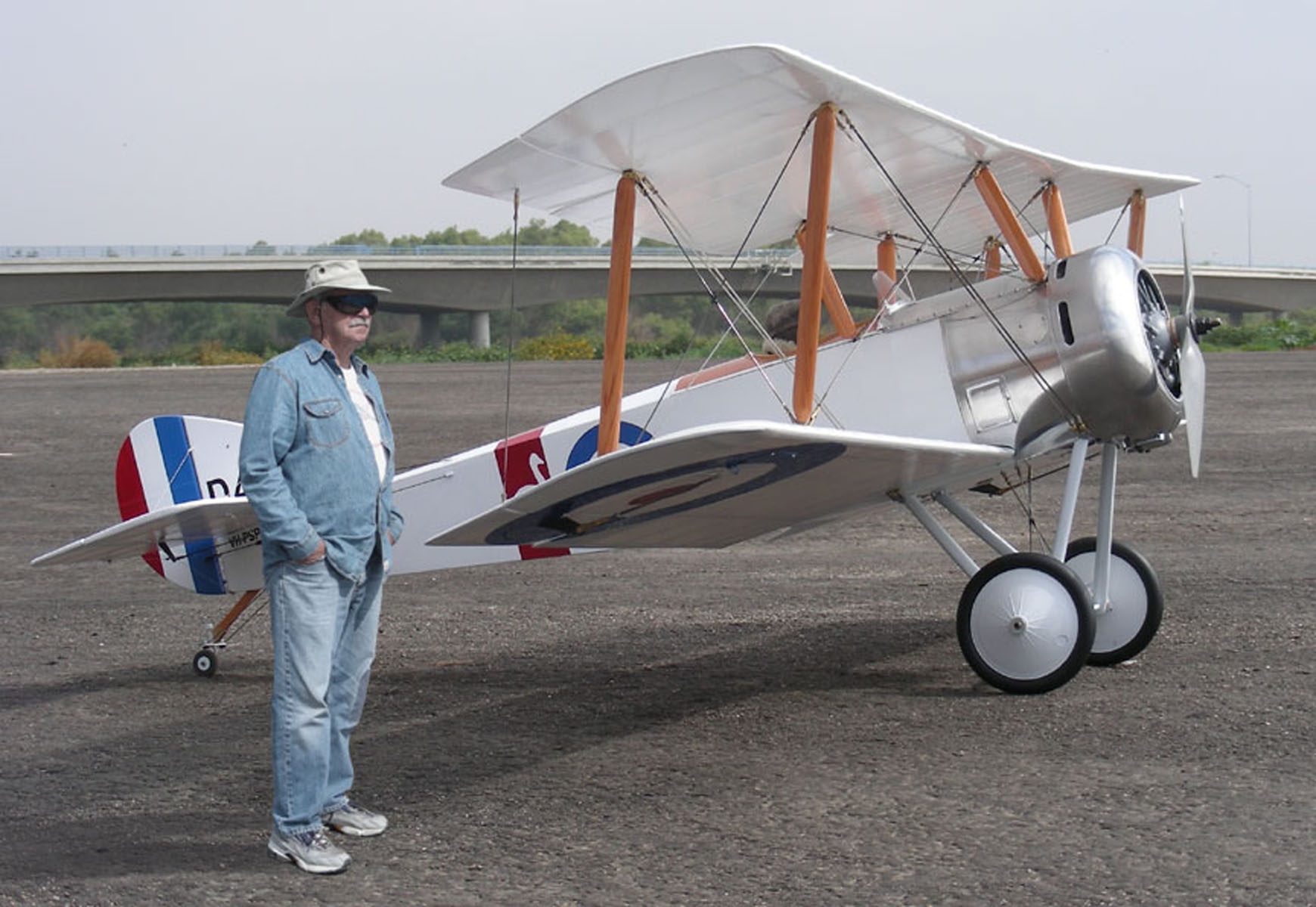

Here is the plane, with my good friend Jerry (composited in Photoshop).

Great Photo, the prop is the only immediate giveaway to it not being a 1-1 pik

....and the angles of the shadows.
