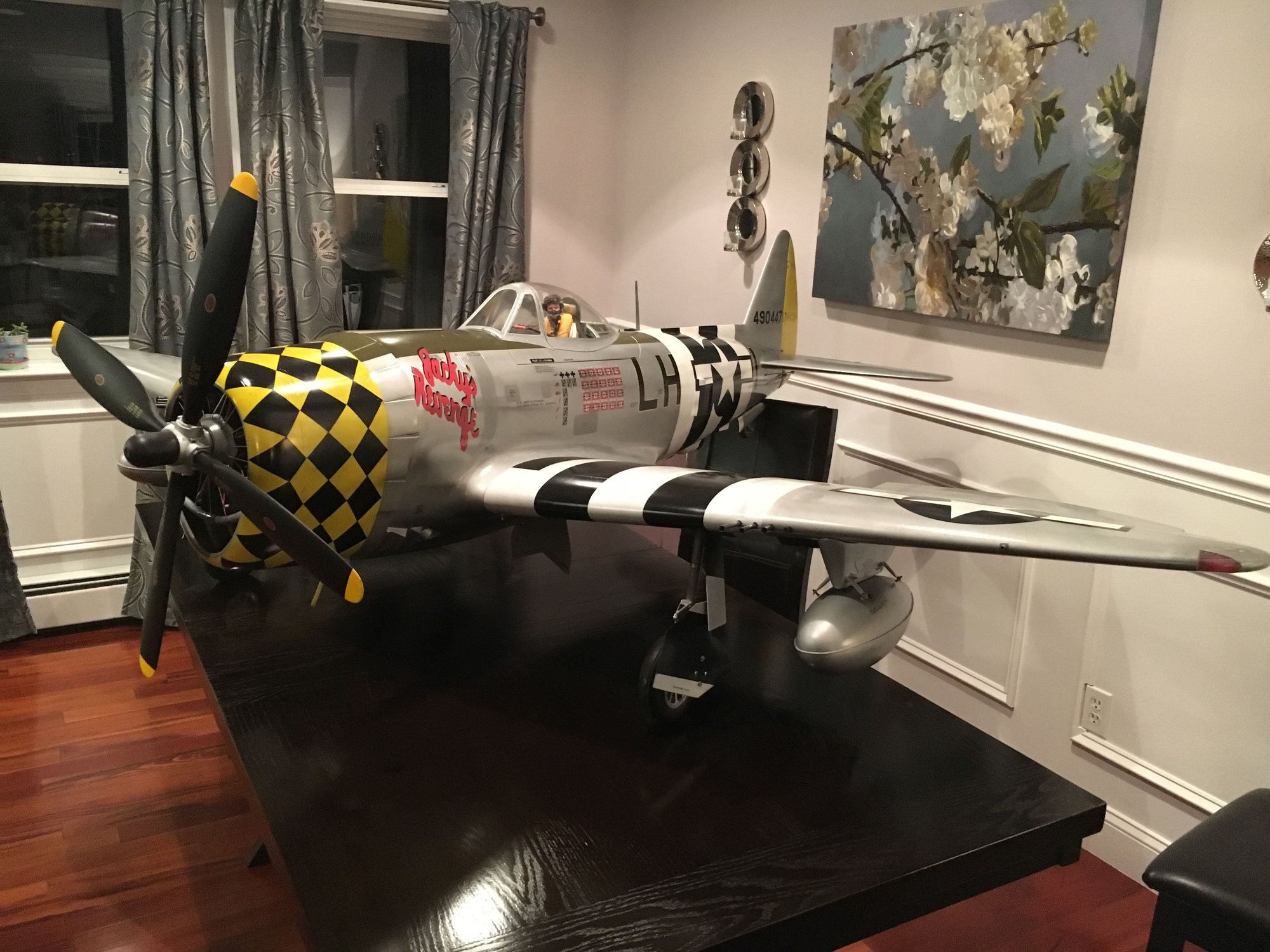

Originally Posted by kgbetal
Hi. Would like to know what type of servos people would recommend for the Ziroli P-47 1/5 scale. I am putting a DA 100 inline into her and will be doing a lot of scale detail.
Joel
On another note, I have 8611’s in my Robart/Ziroli Jug. I dont skimp on big builds.
