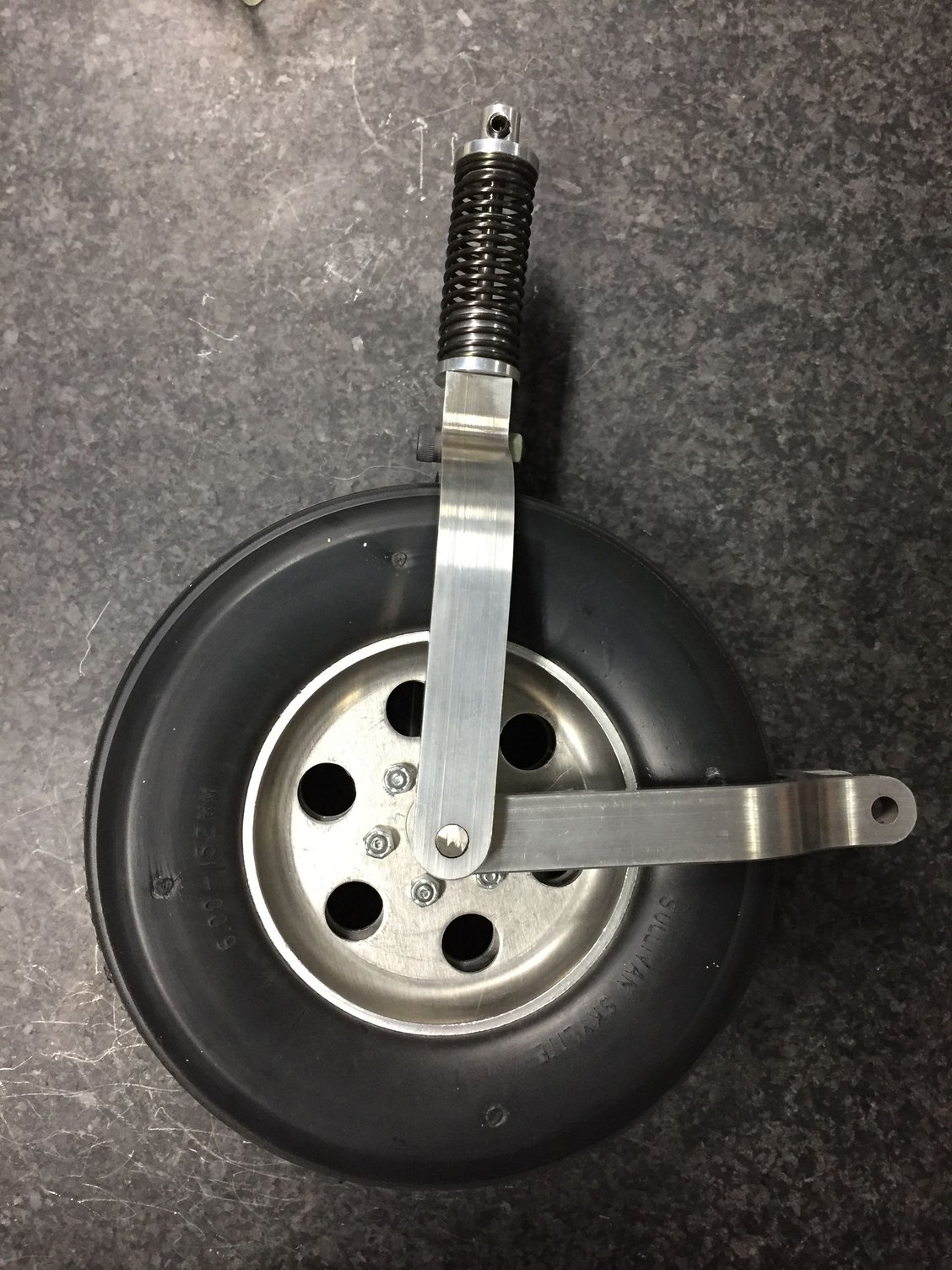

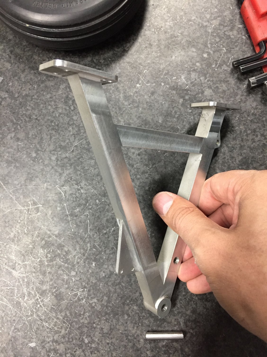

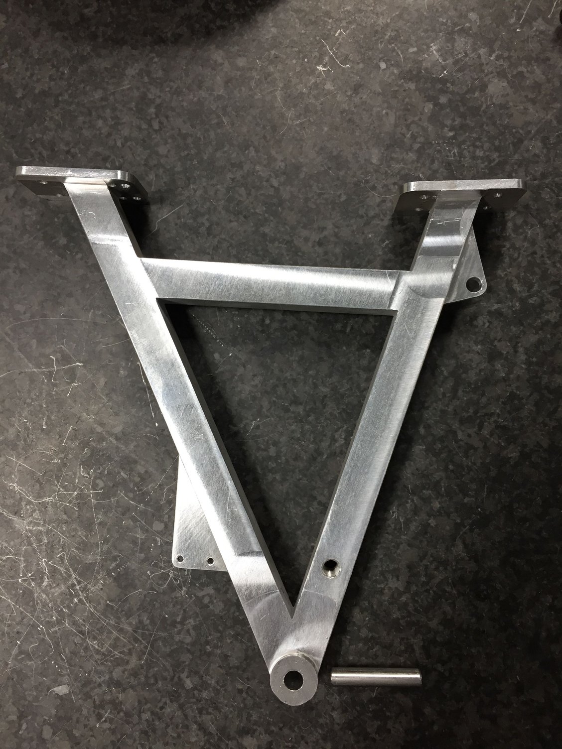

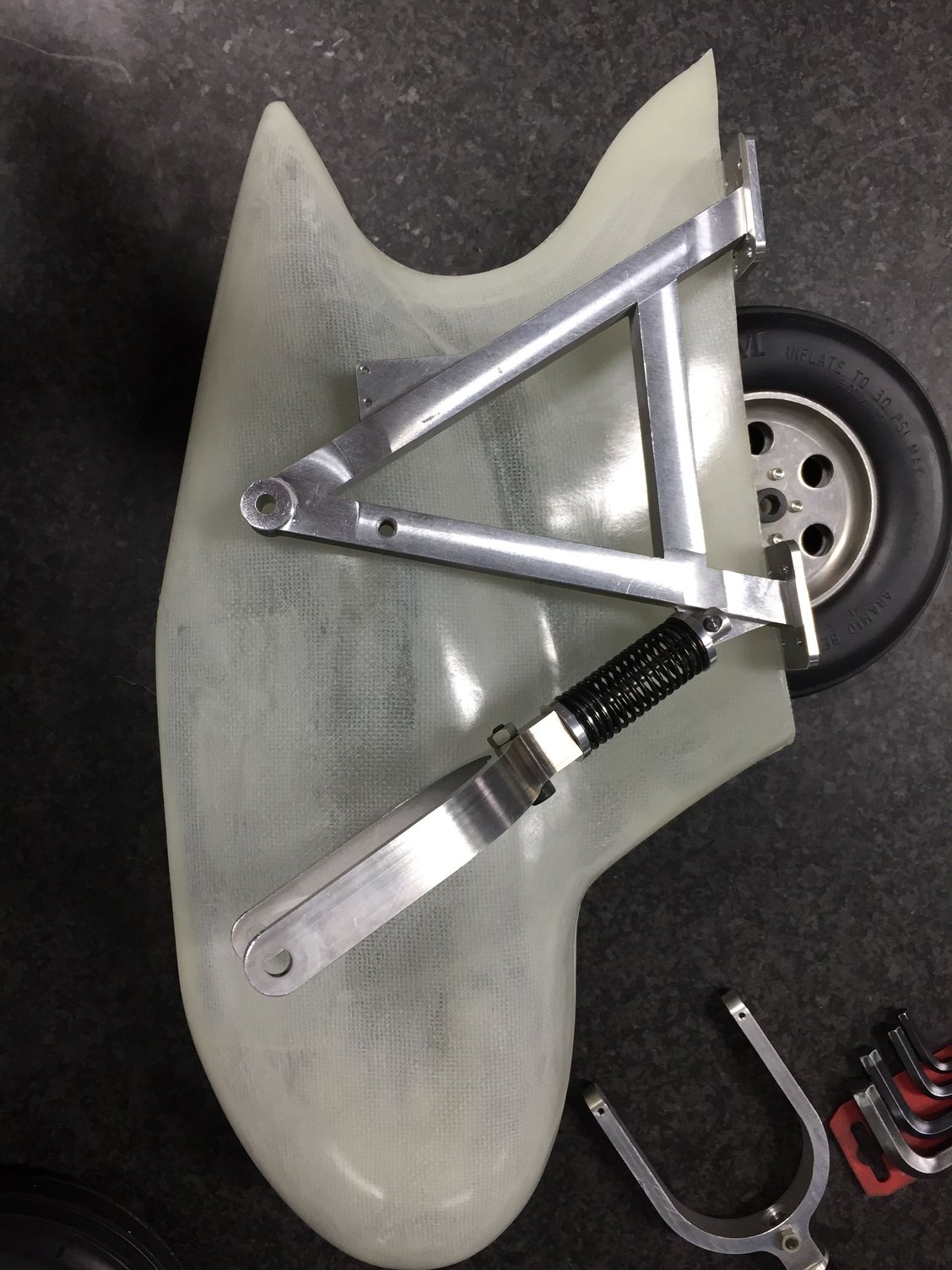

Default Landing gear done,,

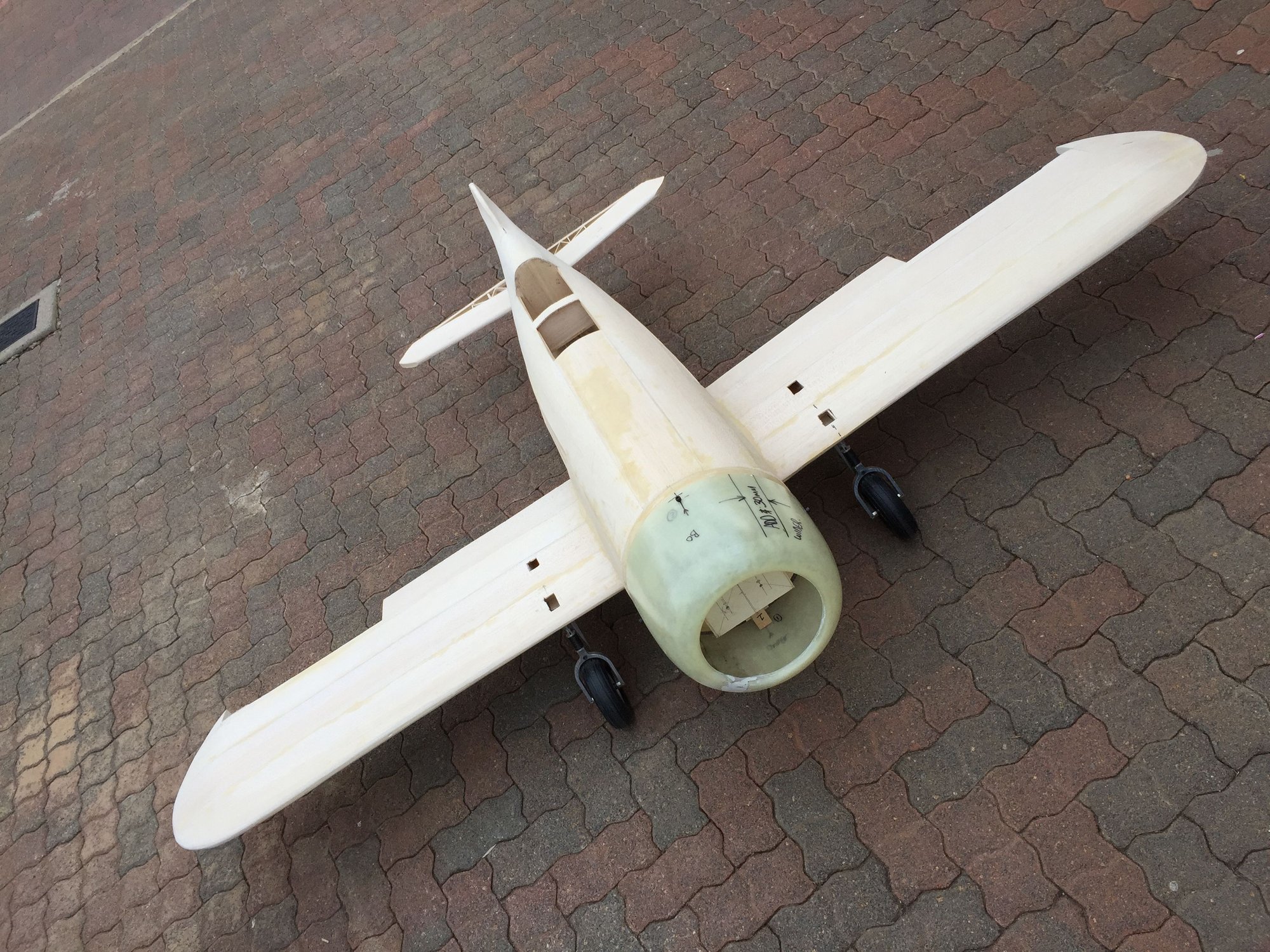

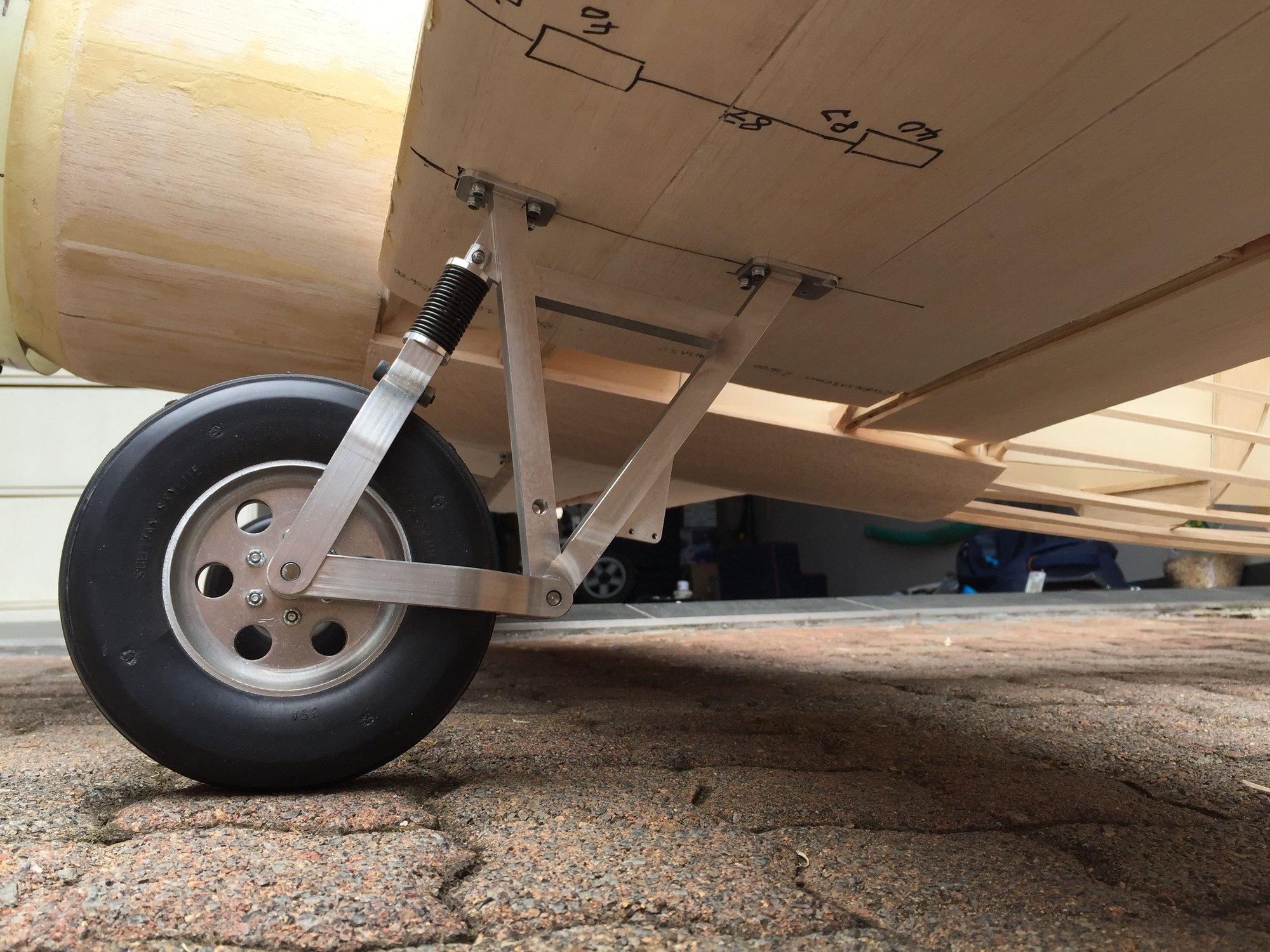

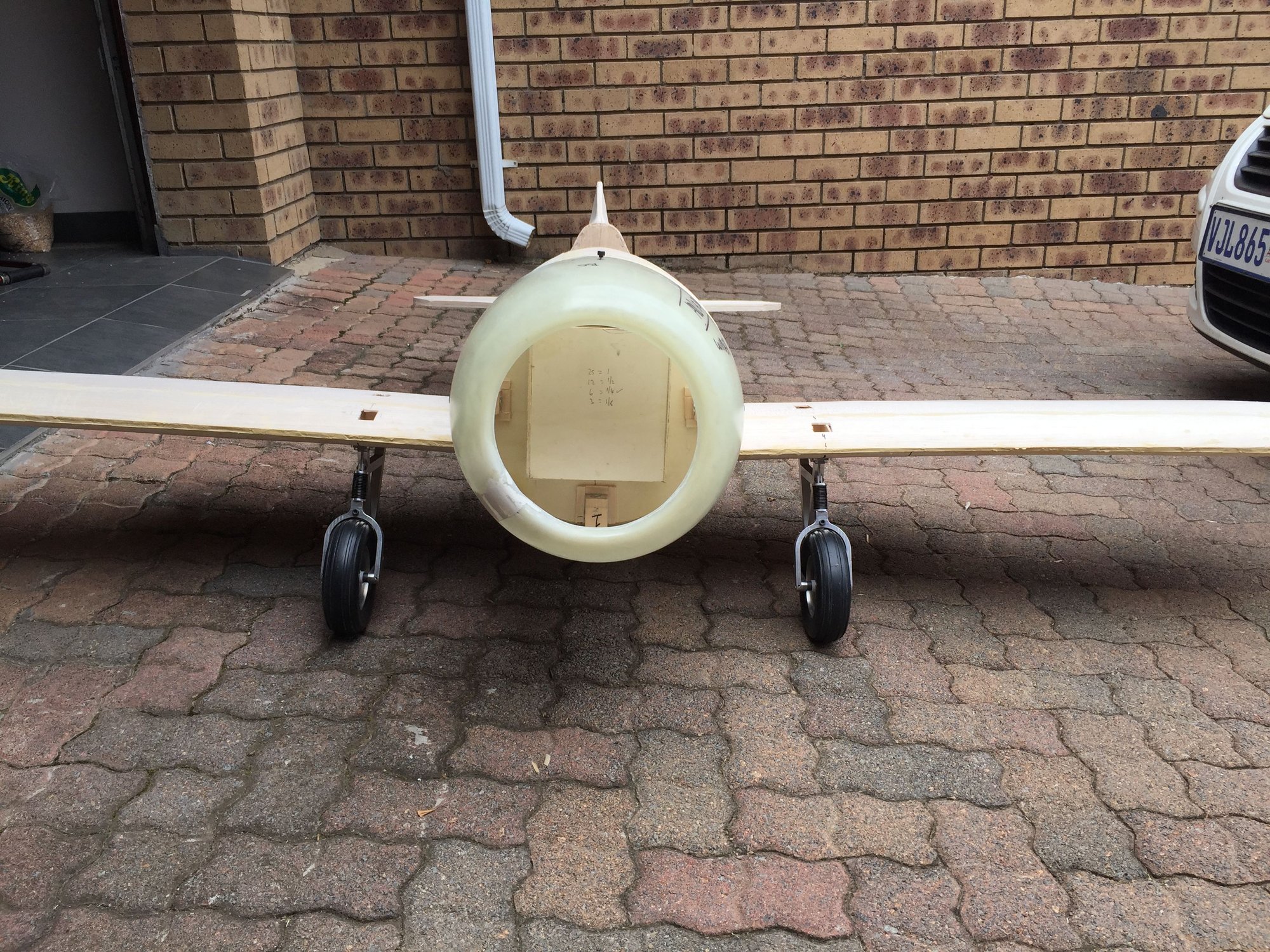

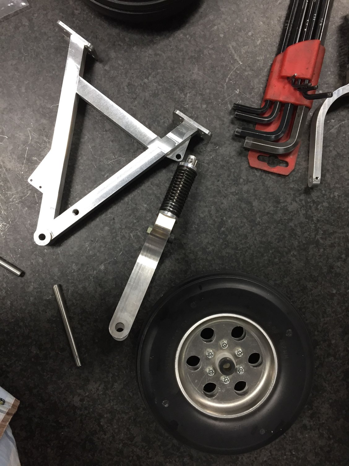

Default Progress update, gear installed

very cool, but once the plane is done and has the engine and everything else in it you are going to need stronger springs

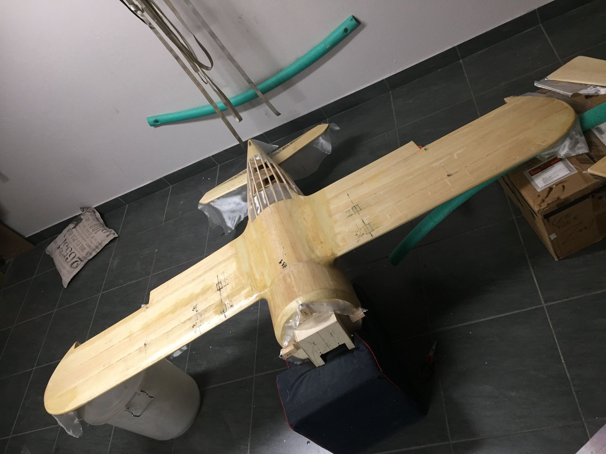

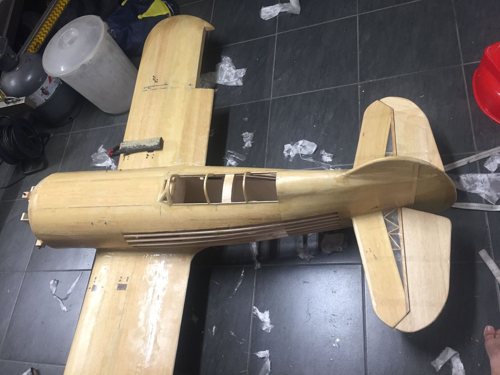

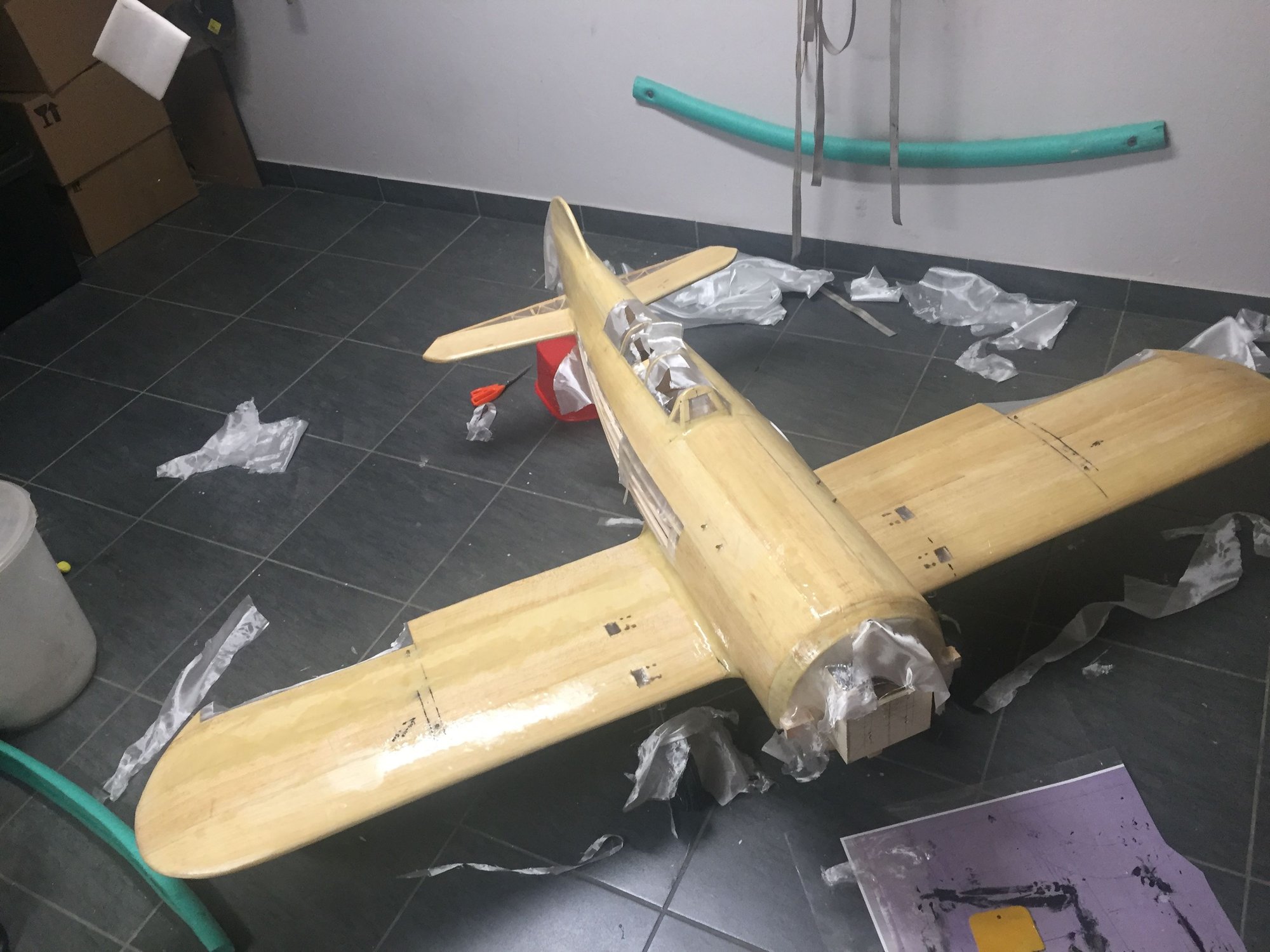

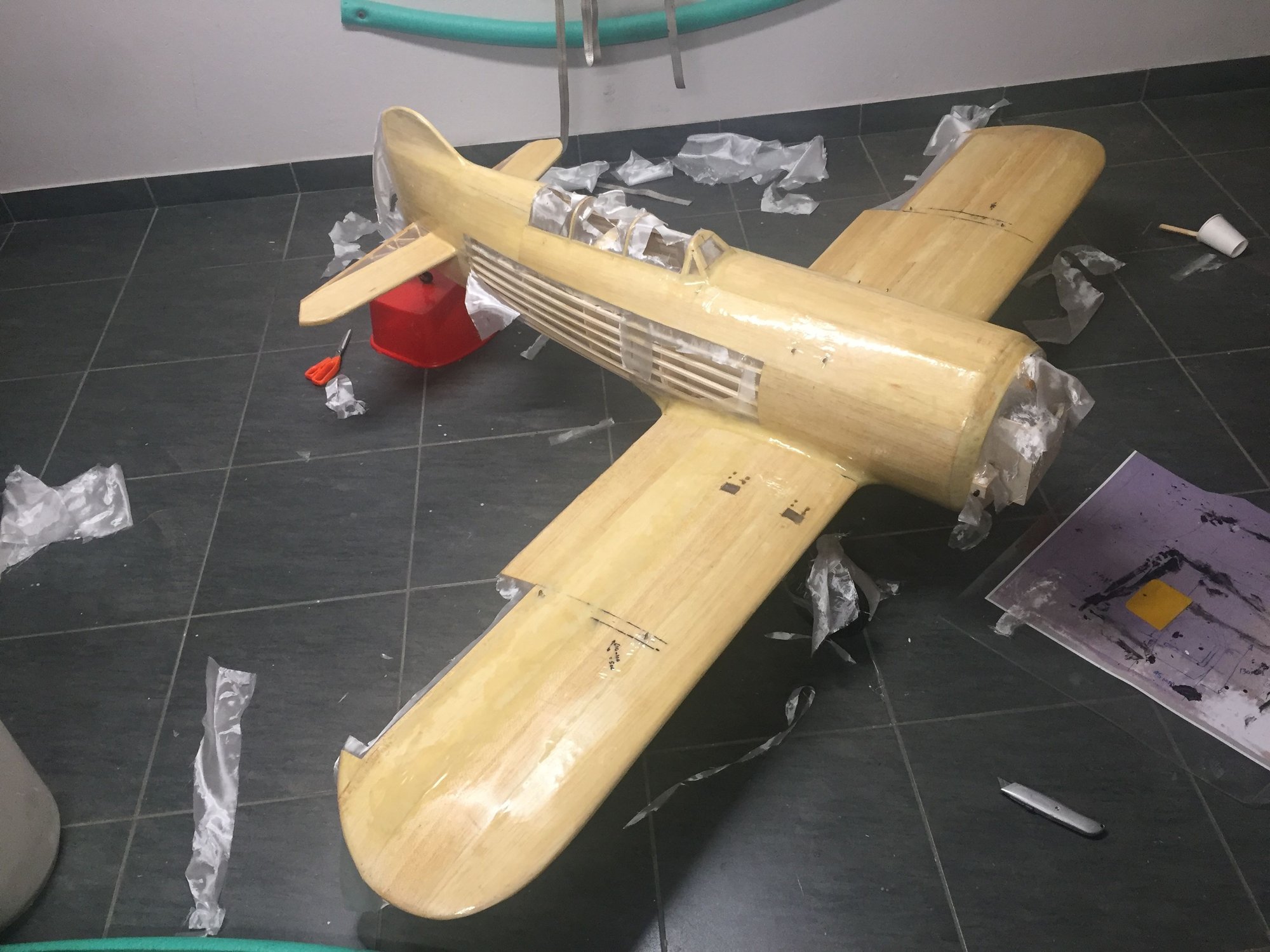

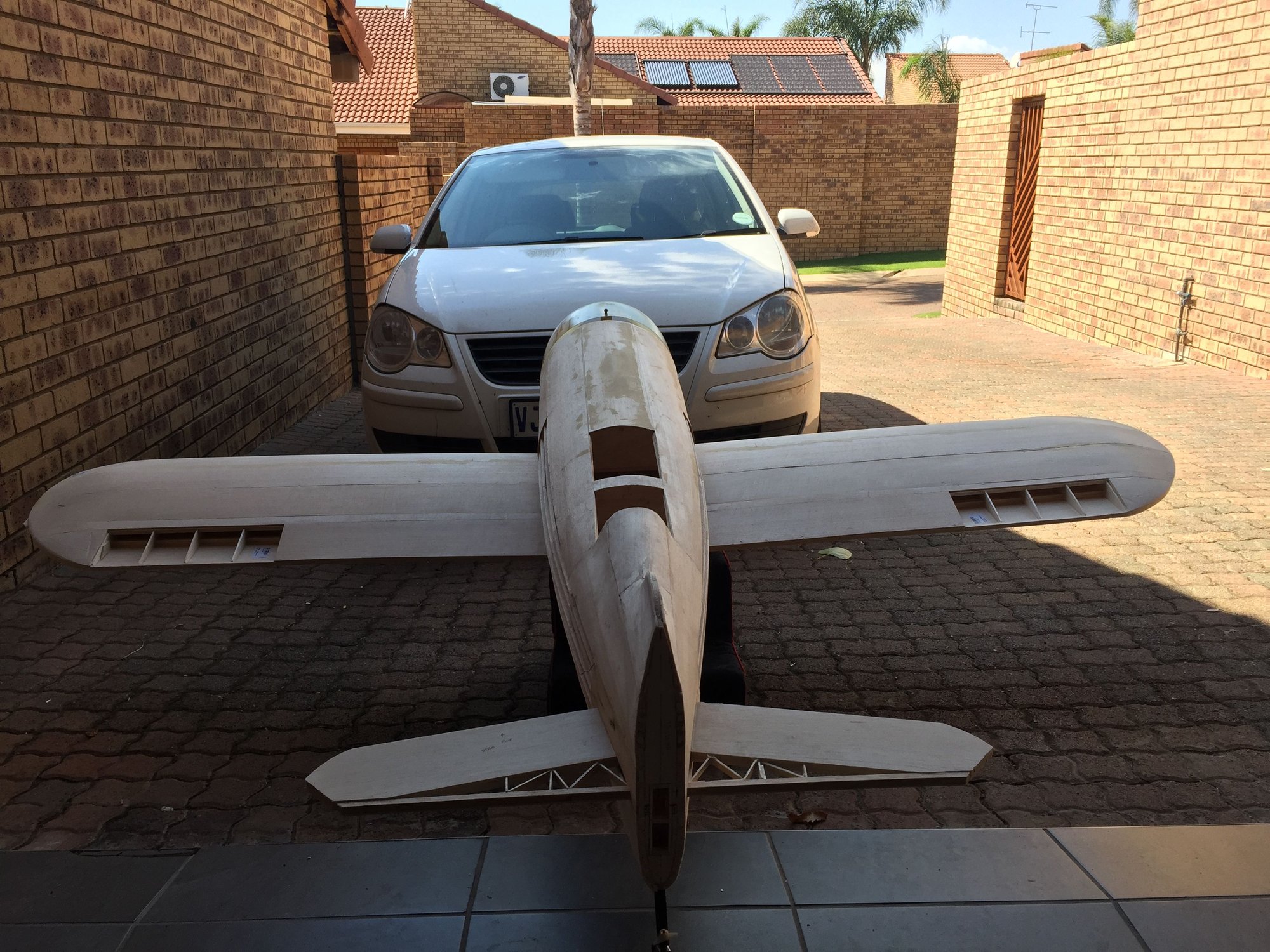

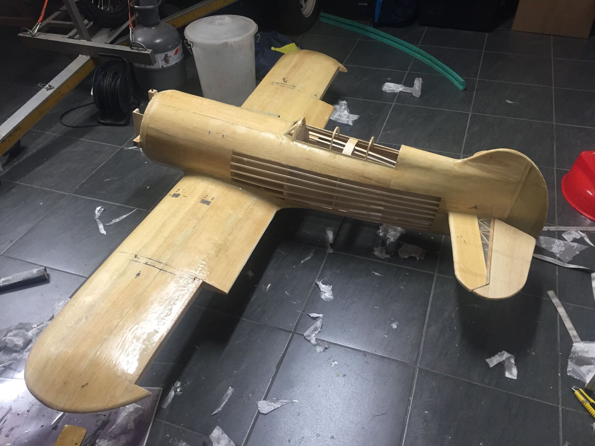

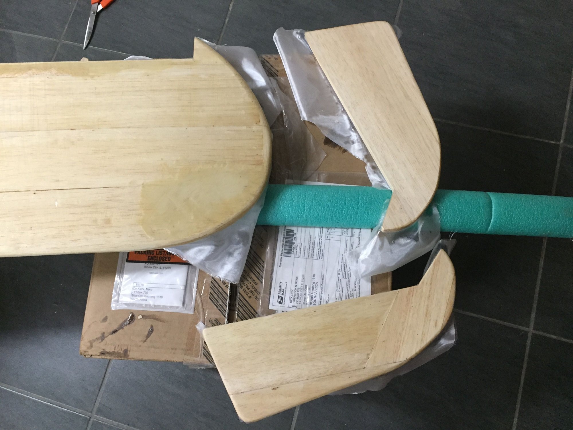

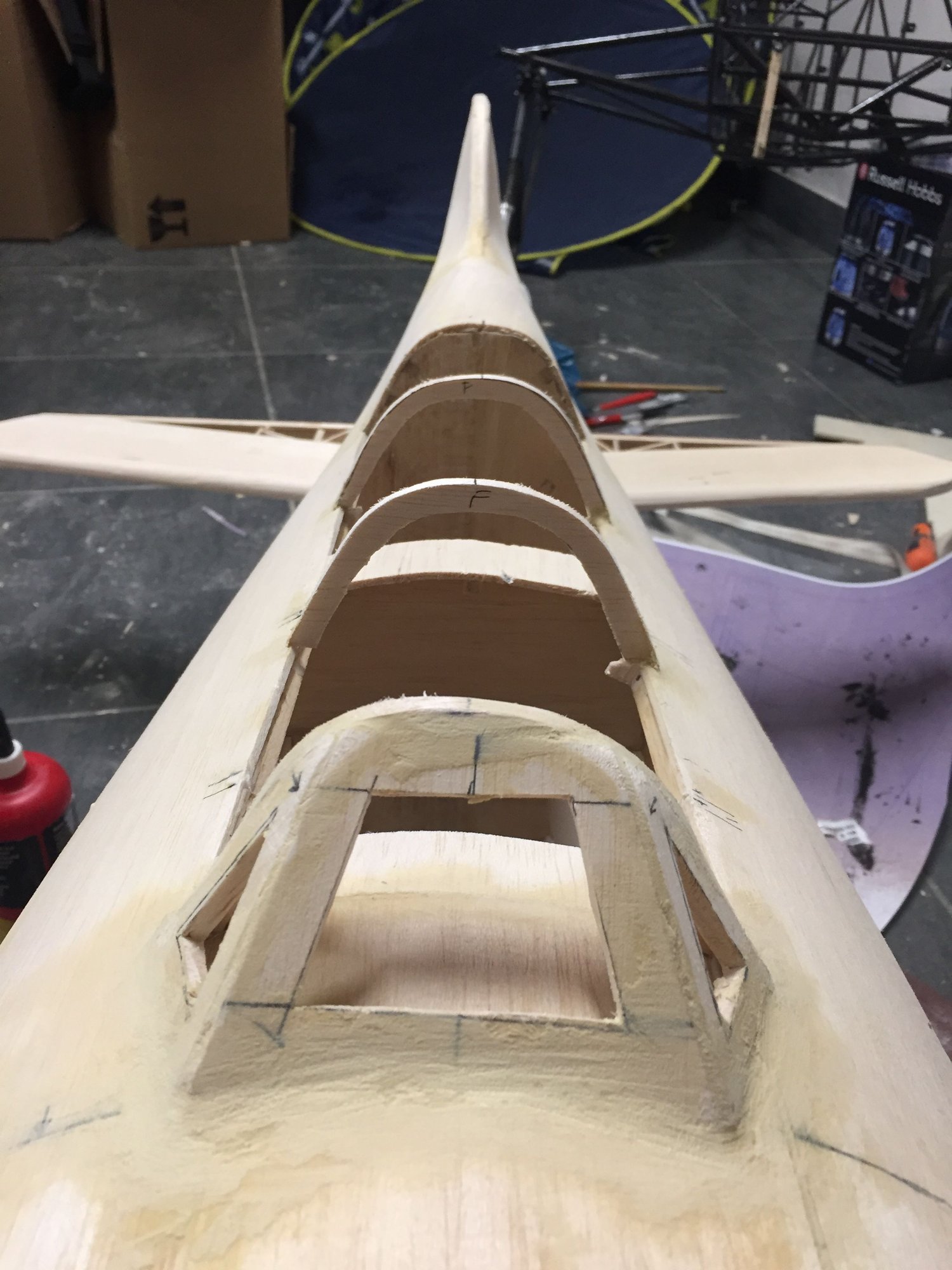

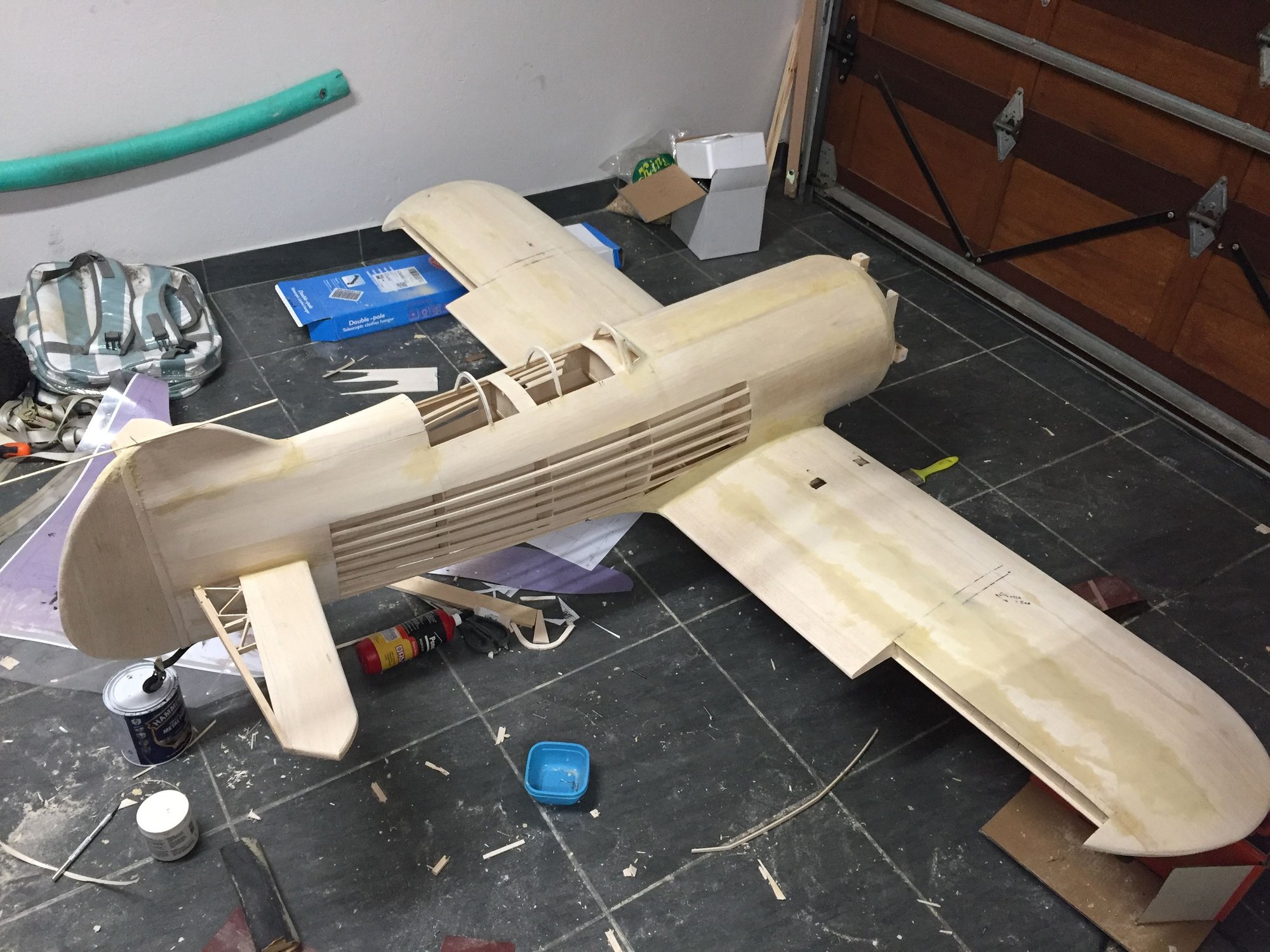

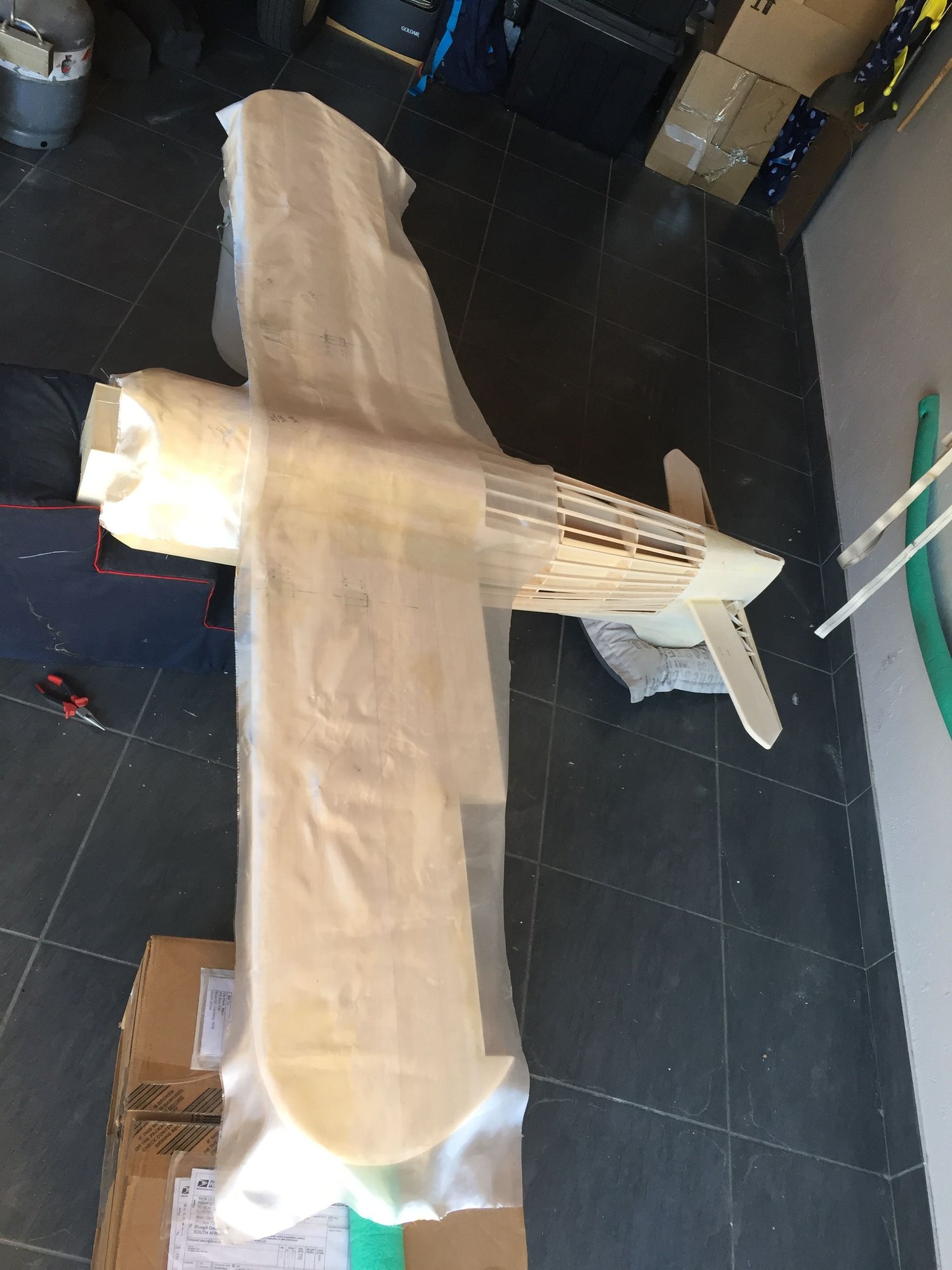

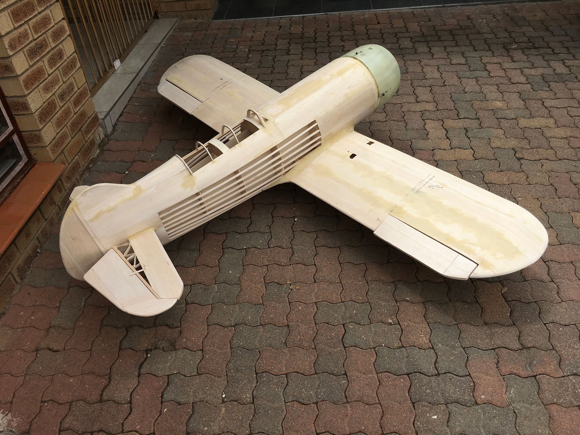

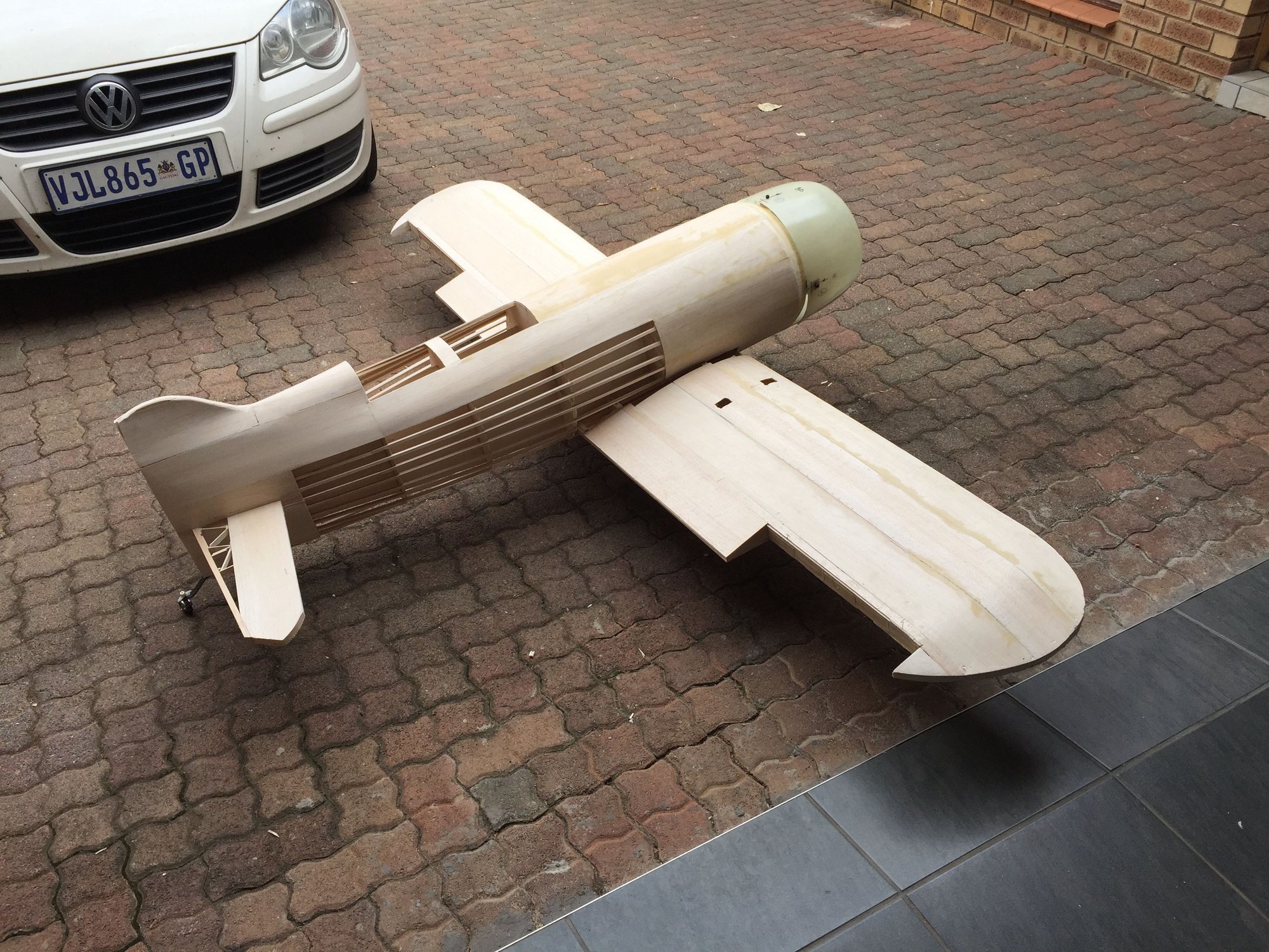

Hi guys, a few items outstanding-
started rudder and elevator, finishing stringers and we are almost done!

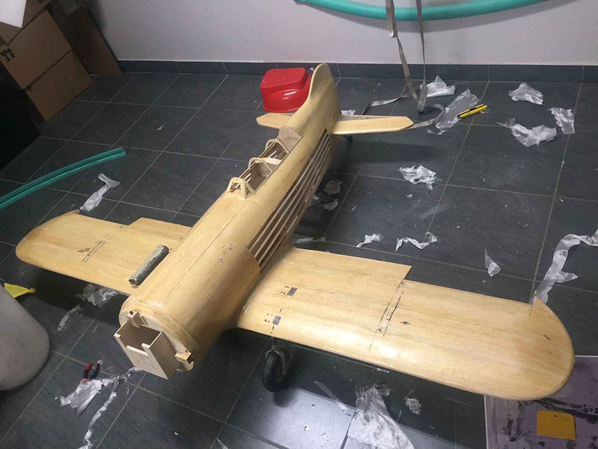

Default Update

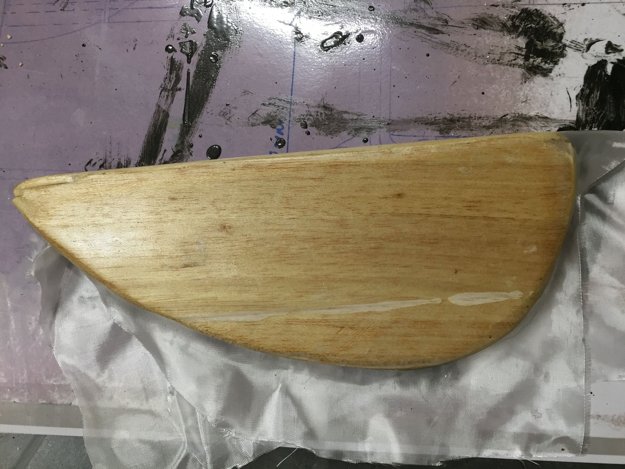

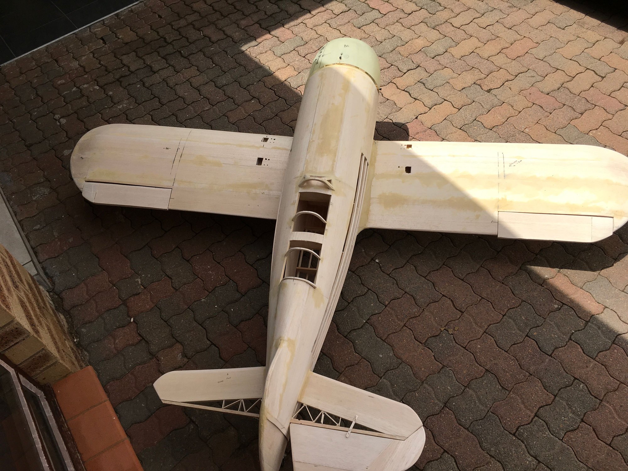

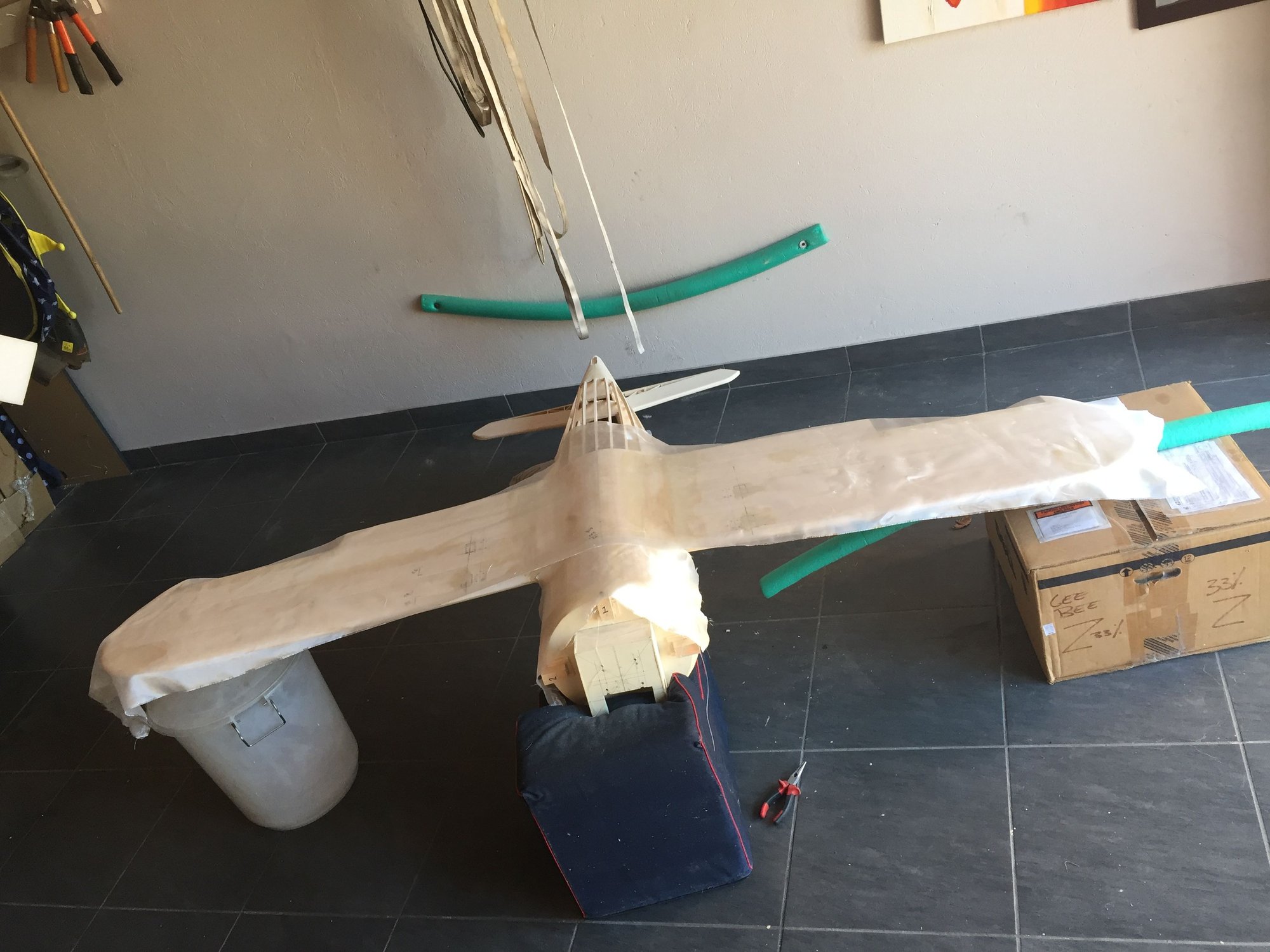

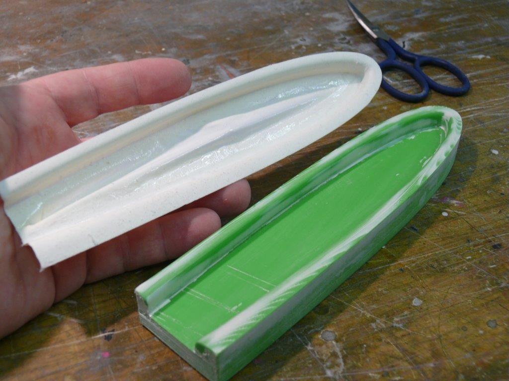

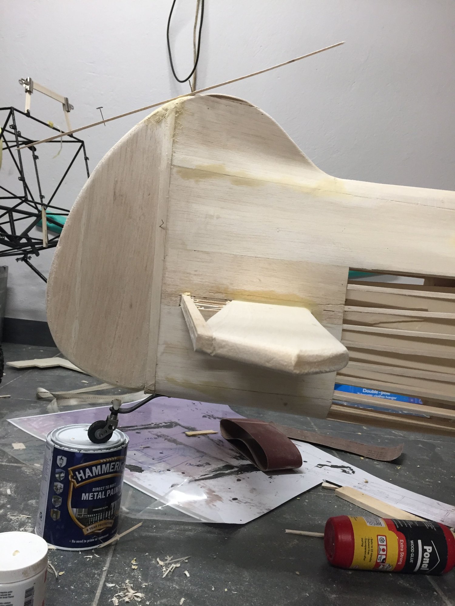

First attempt at trying fiberglass .. I think it came out ok, itís tricky to work with and you have to hurry.
tomorow Iíll be looking at smoothing the airframe
You mentioned having to hurry, what resin are you using? I often use Kwik-Poly which sets up super fast. I only mix up about 10 cc at a time but it wets out the lightweight fiberglass really well and sands within the hour so it is worth the hassle of mixing many small batches. Depending on what resin you use you may want to reduce the amount of catalyst slightly or work in a cooler envirionment.

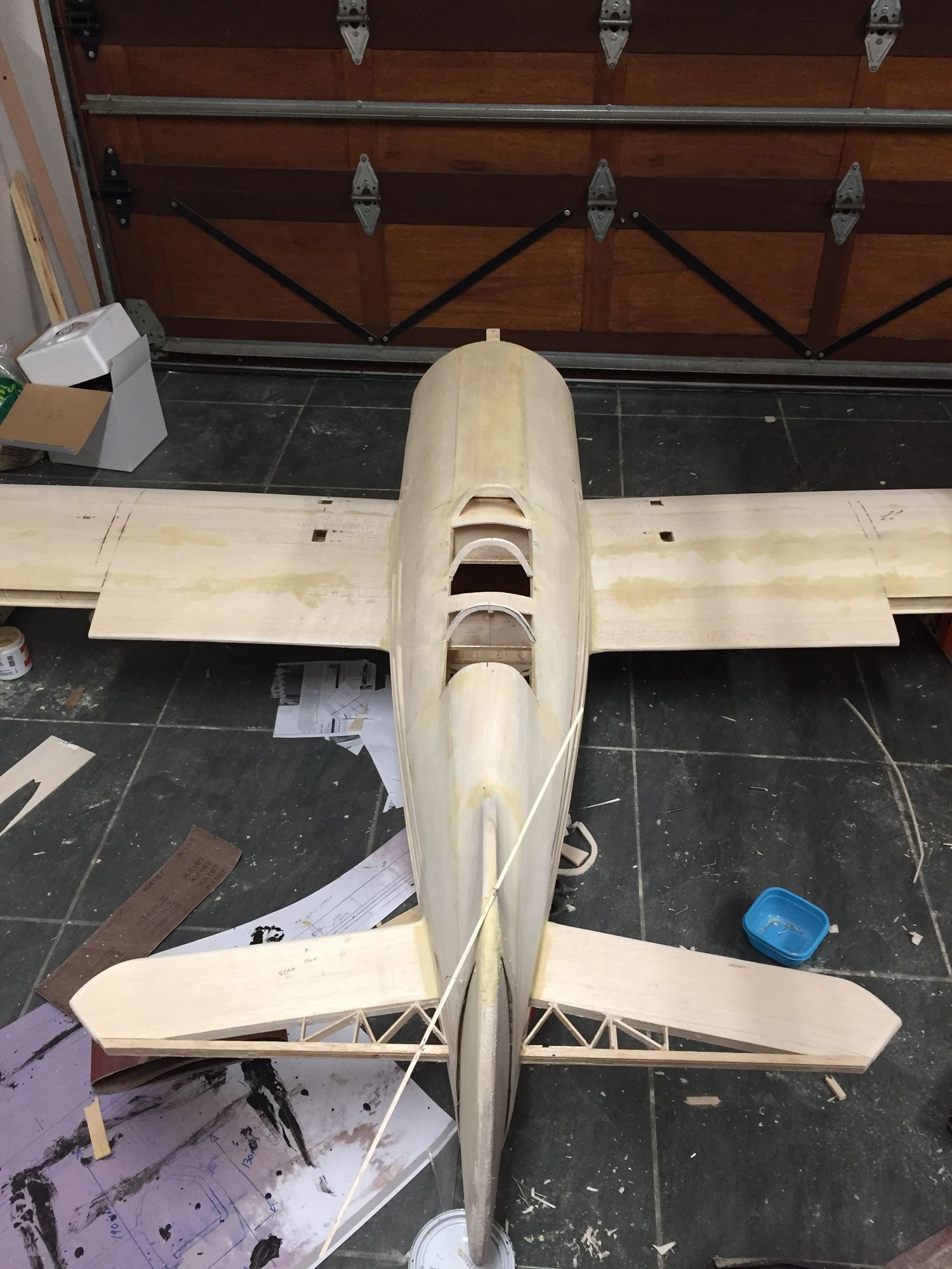

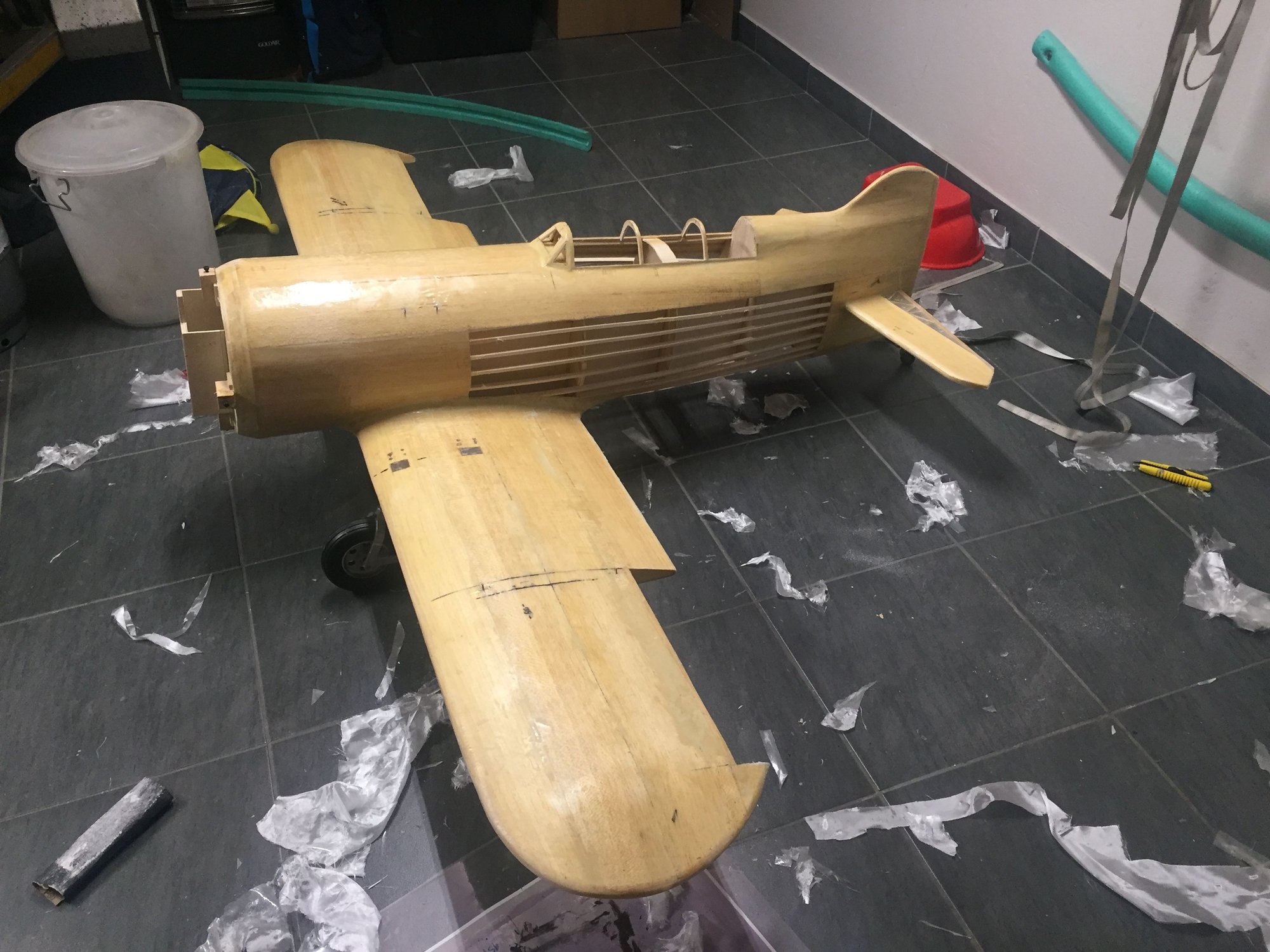

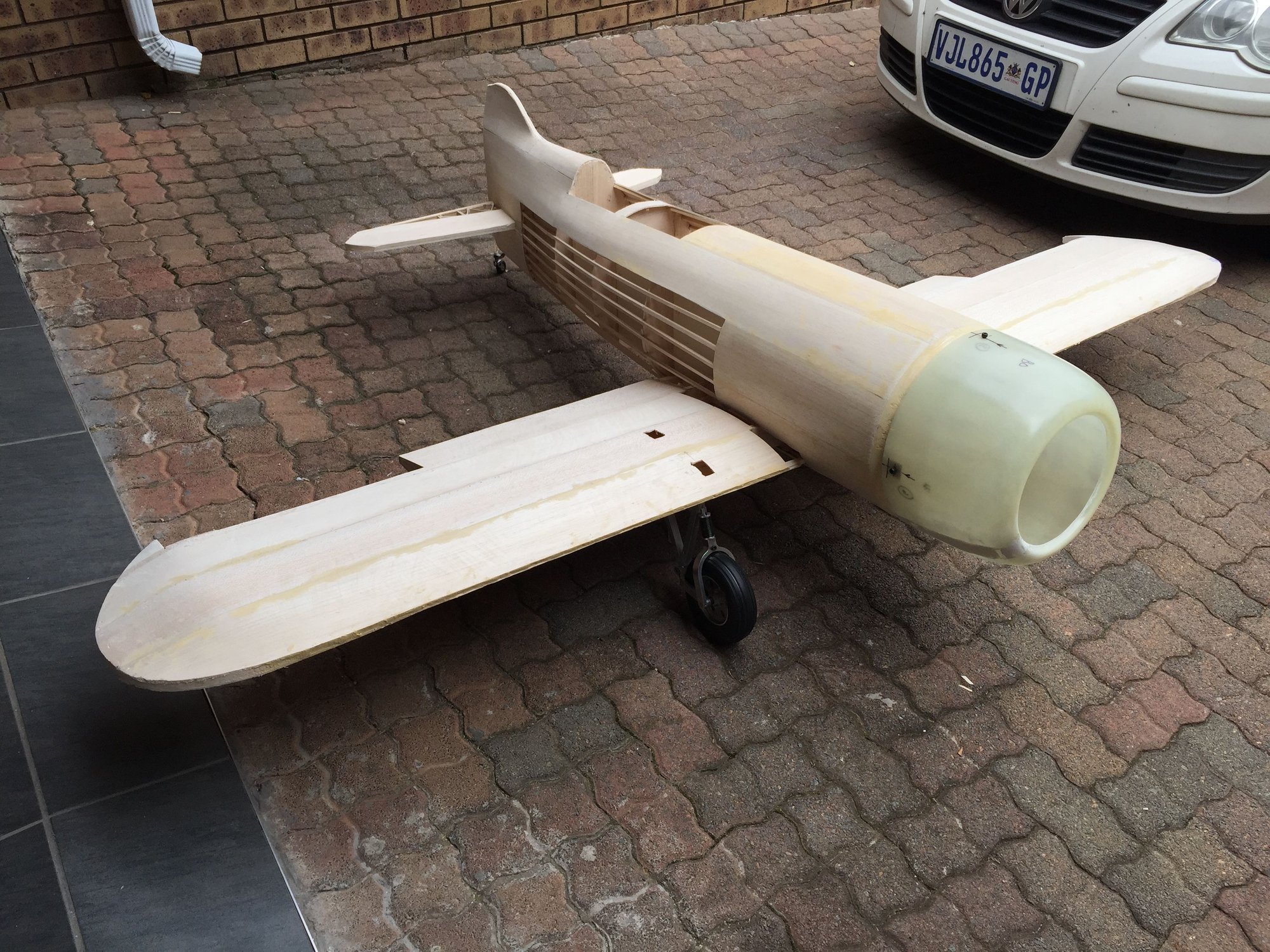

Glassing is done, little bit of work still on the ailerons , then smoothing the wings, should be done in the next 4-6 weeks.. painting

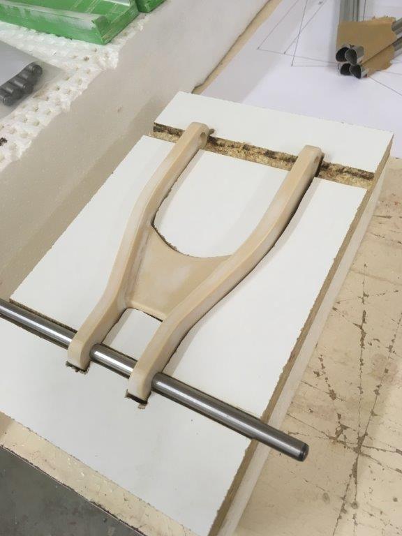

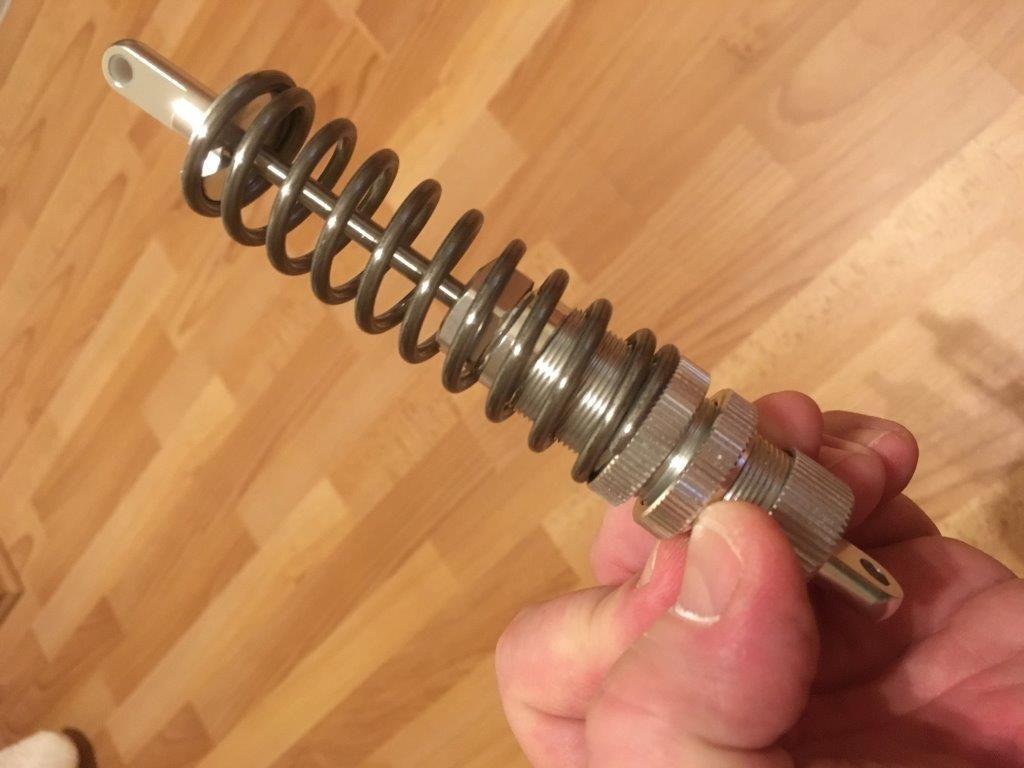

Ratings

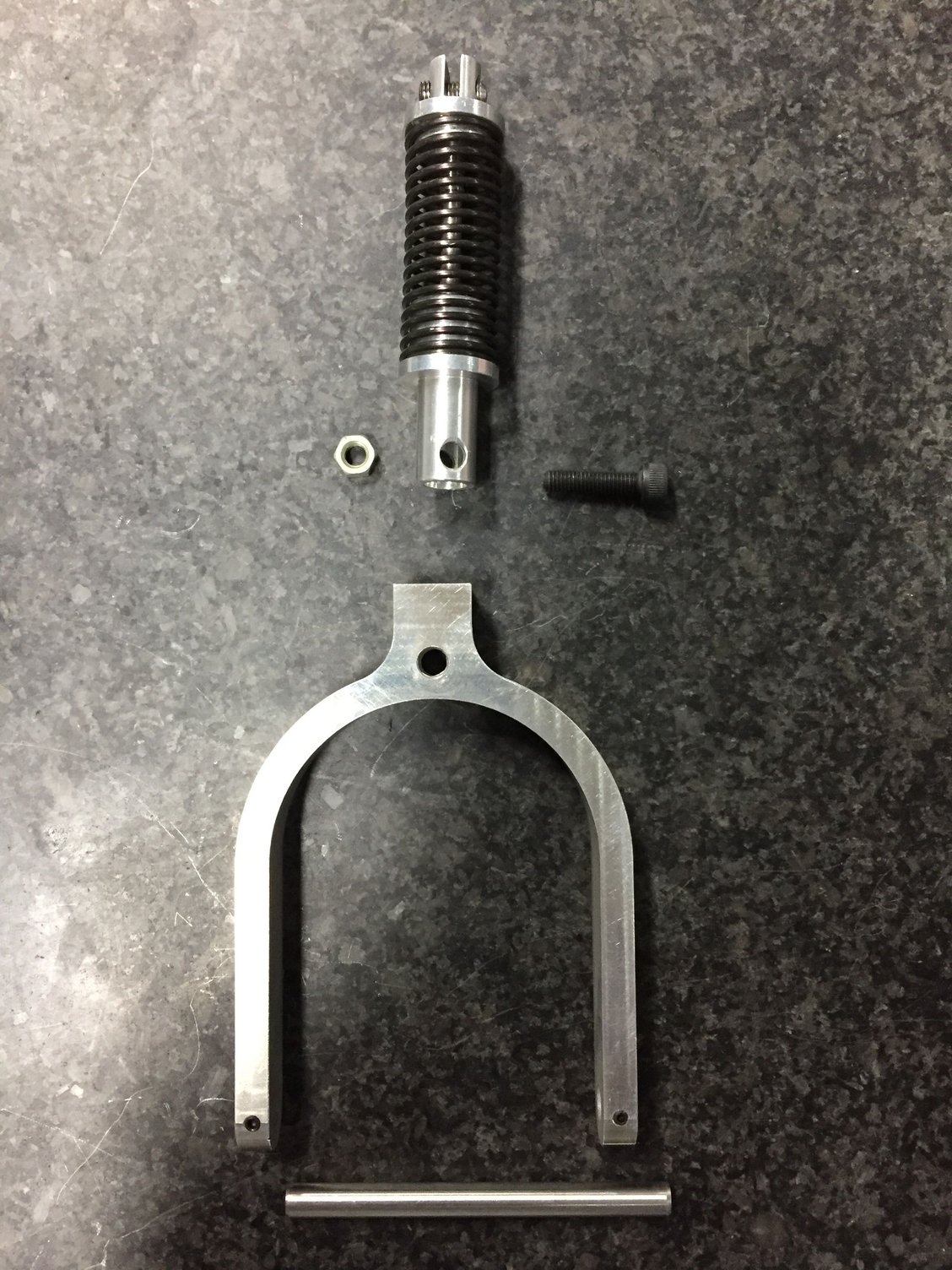

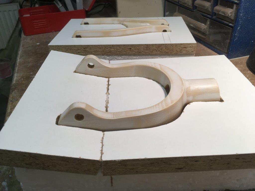

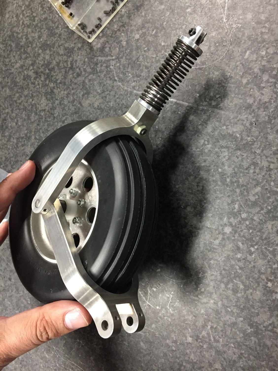

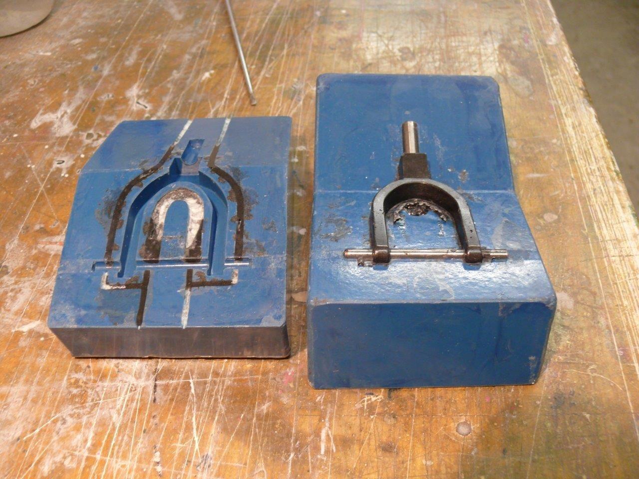

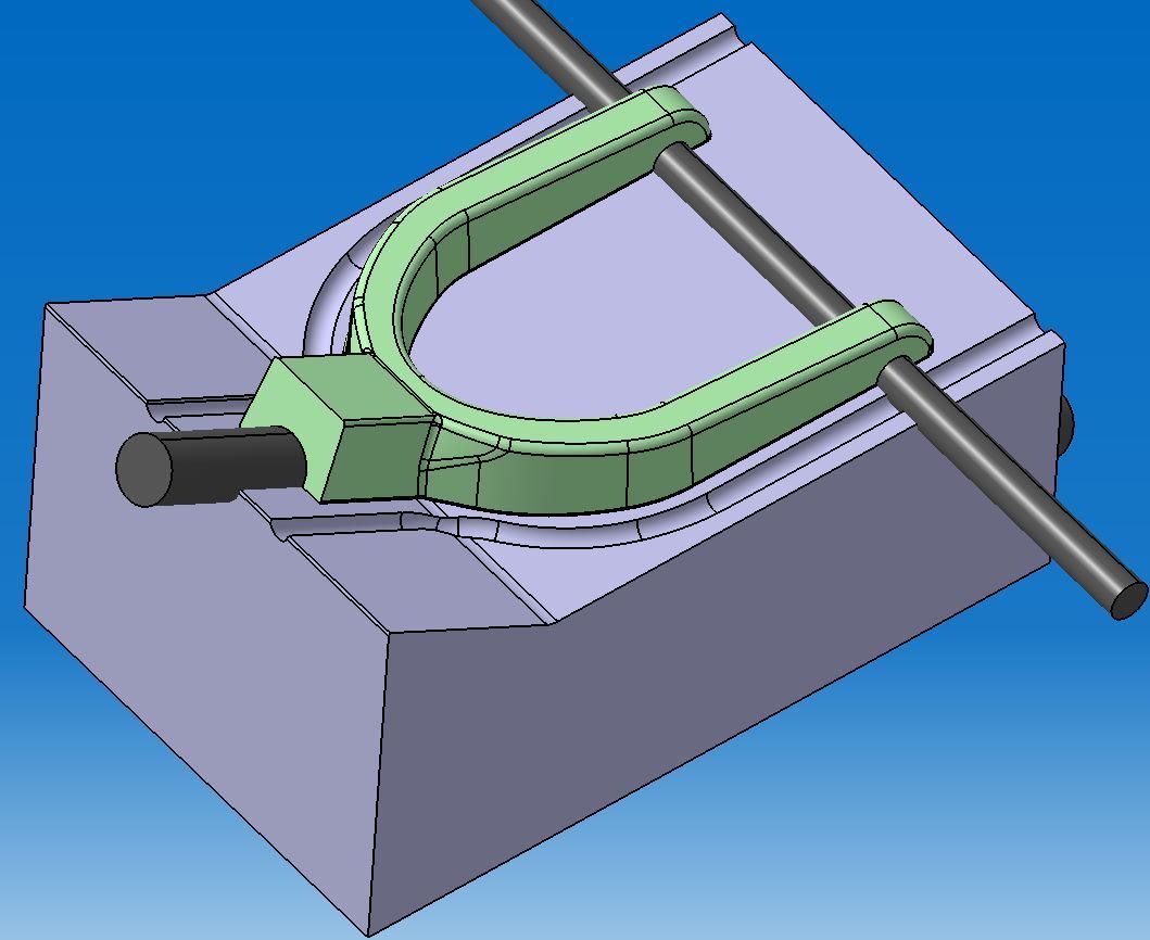

My Feedback

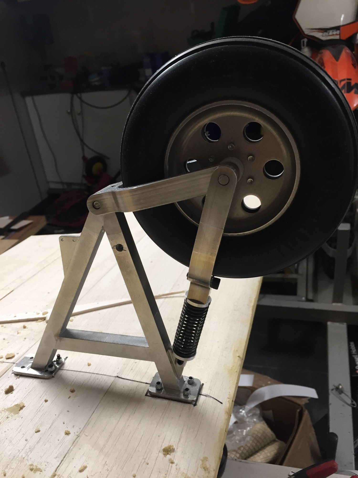

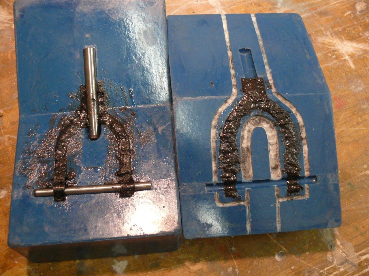

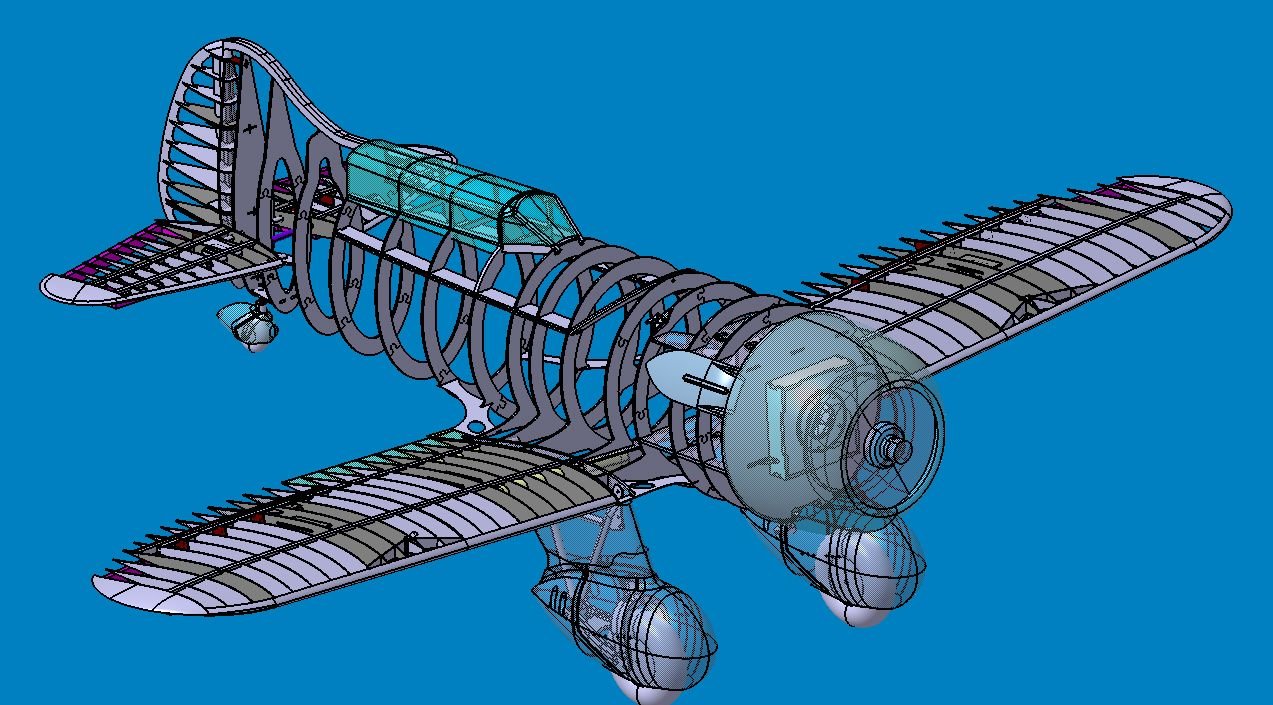

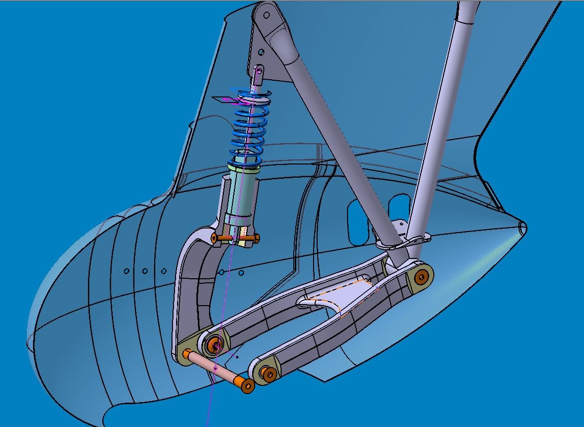

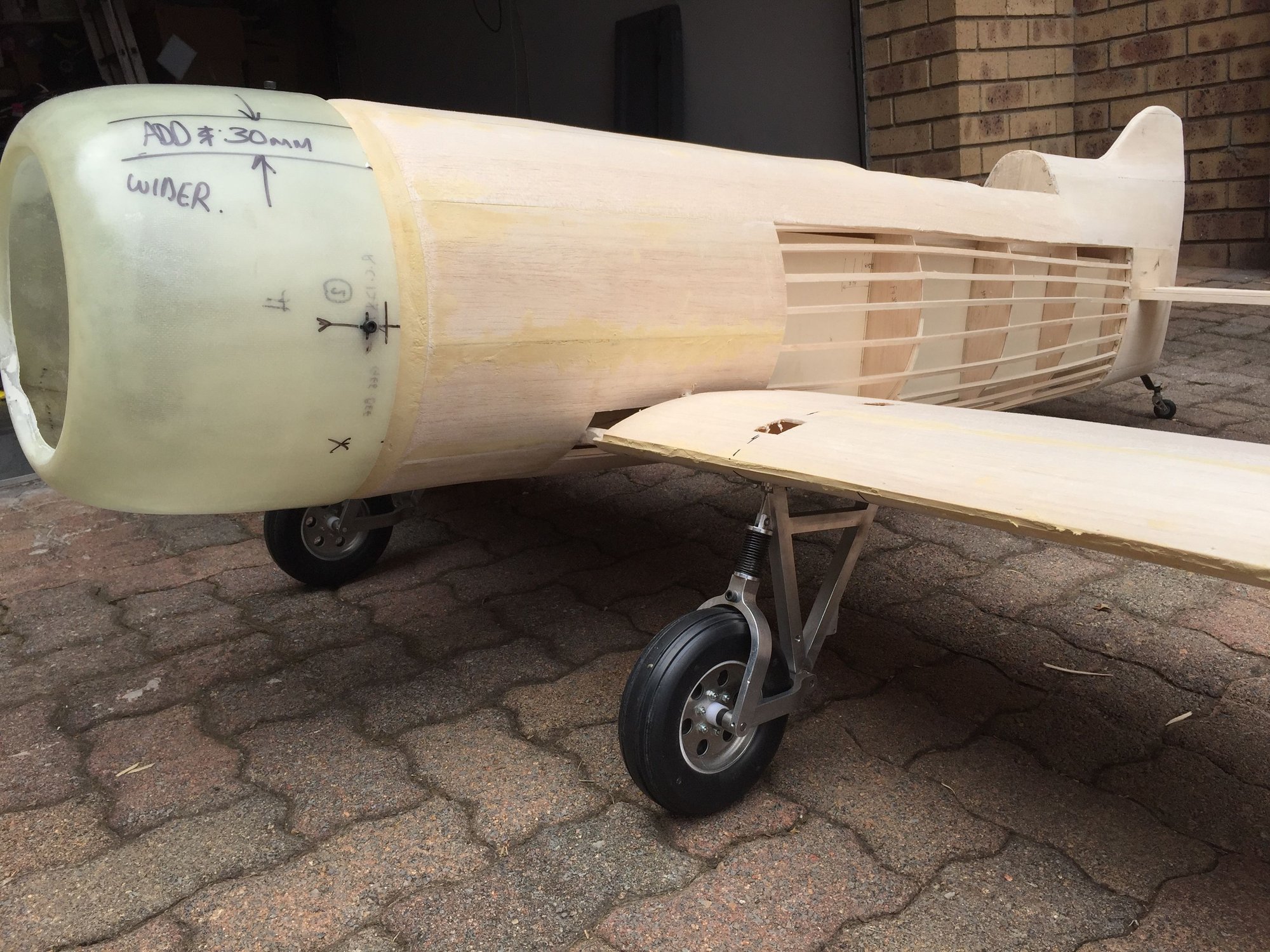

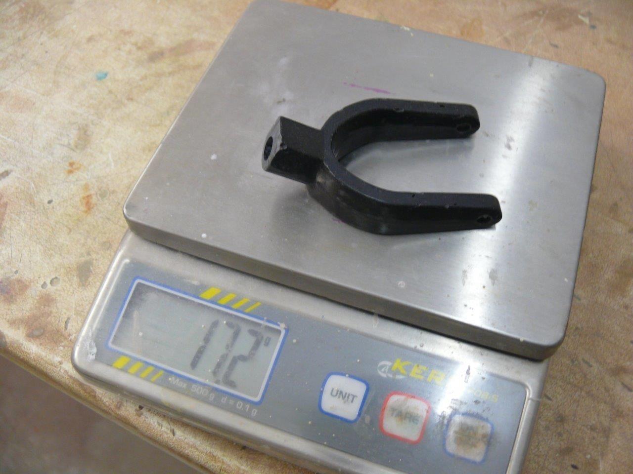

Some details, my QED has 100 inch of span, complete self made fully scale referred to original drawings, springs, damper, kinematics. Anything is done in CAD. i just started to build the fibre glass parts master moulds from foam and glass. The gear is a stainless steel tube design with damper from a Groeschl Car and Spring custommade. I first time tried to make parts from carbon "dust" and resin, even lighter than aluminum and much stronger, stole that Idea from Vitali Robertus of Rusjet, he made gear parts from fibre, very scale and super lightweight. My first part came off tool with 17,2gr not machined and aluminum would be 42gr machined, thats an argument to make the big gear parts like fork and trailiung arm in this desgin. Masterparts are printed and fillered and some din Bolts located for bore dia. cheers matze

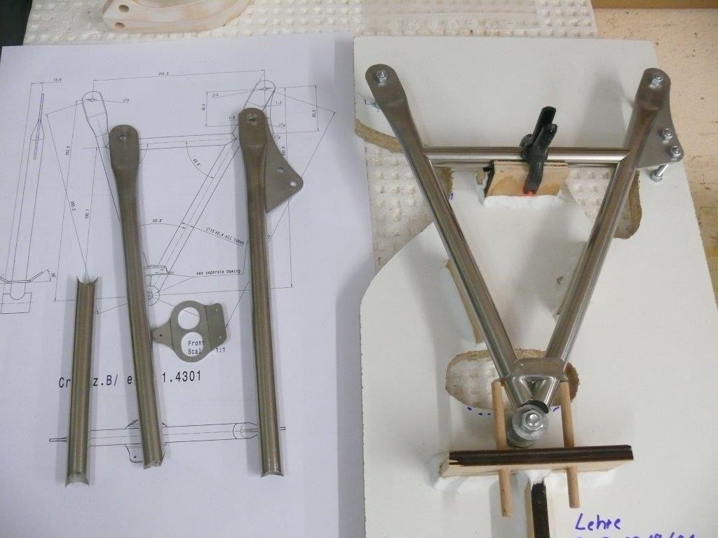

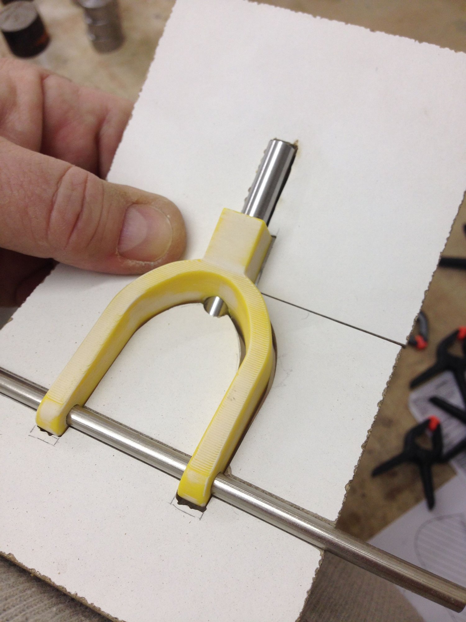

Build a special Jig to hard solder the gear later, the lower bushing is still missing...

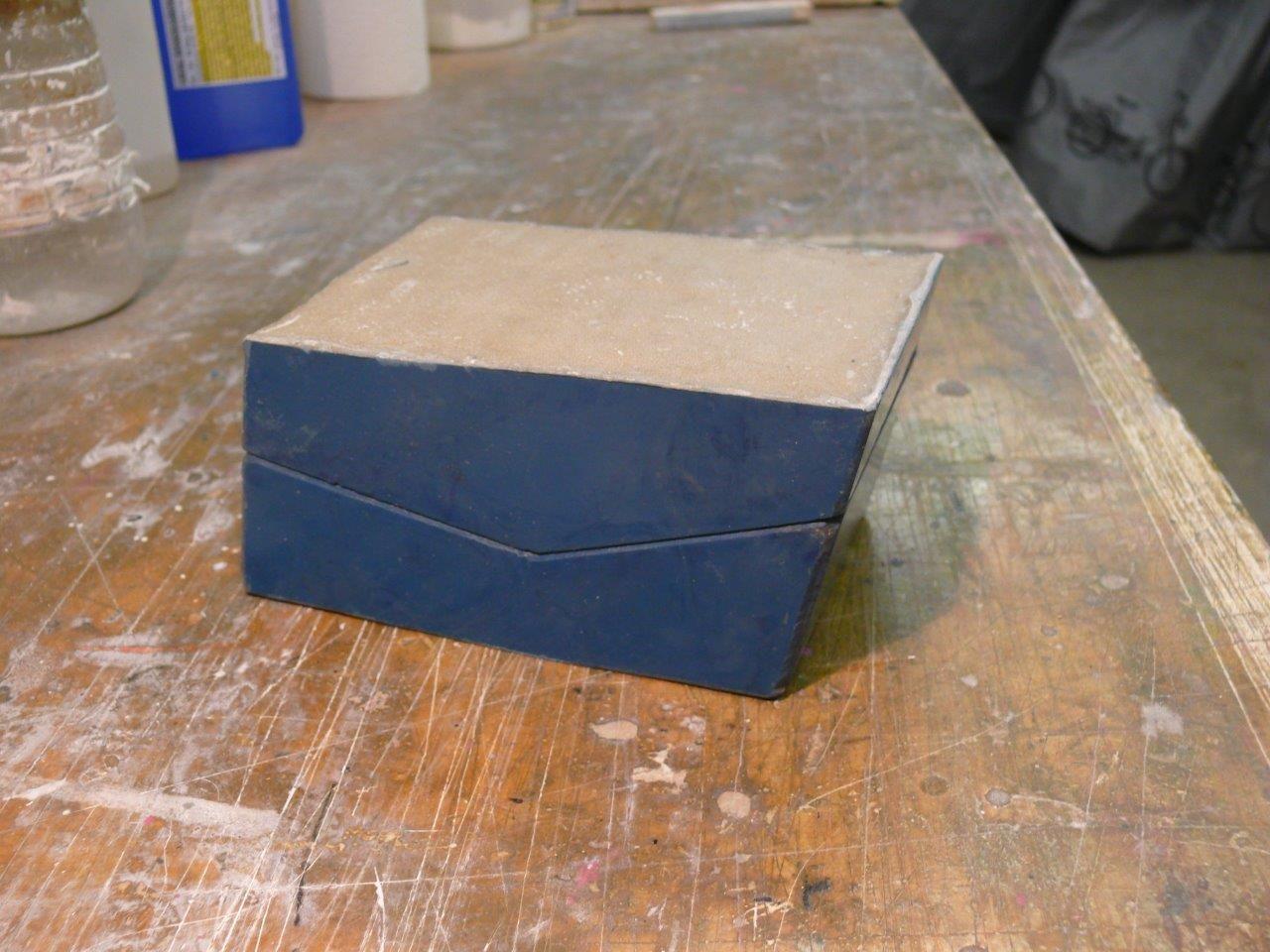

First fibre glass parts for elevator and gear cover made on printed and fillered moulds.

The gear in detail:
Next moulding parts:

And the real fibre glass parts after 1. filler apply:
