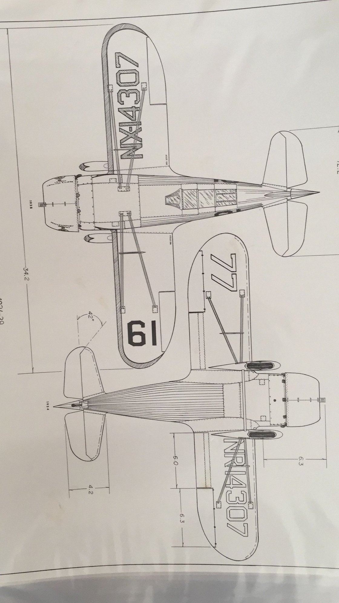

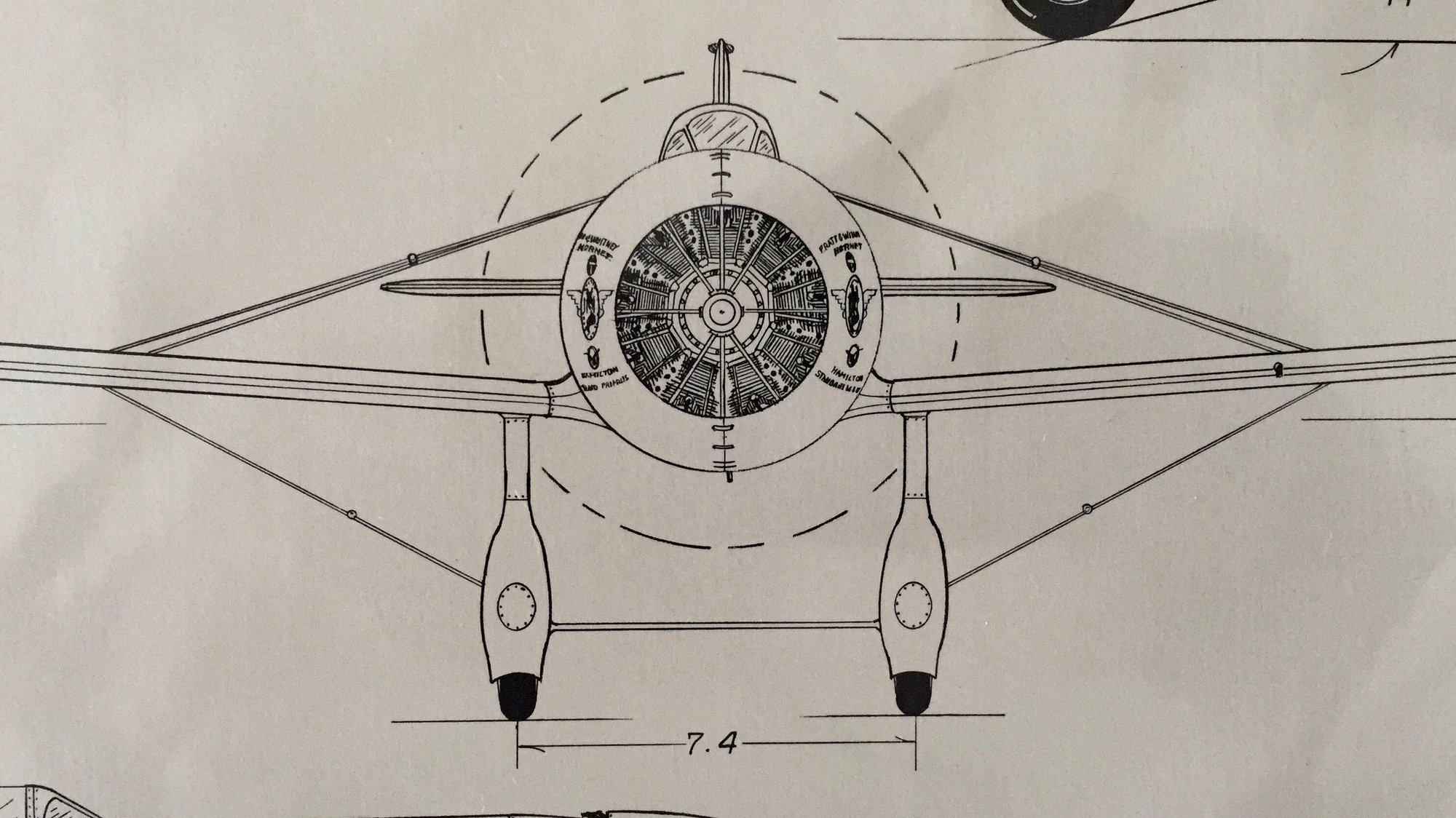

one of approx 20 plan sheets:

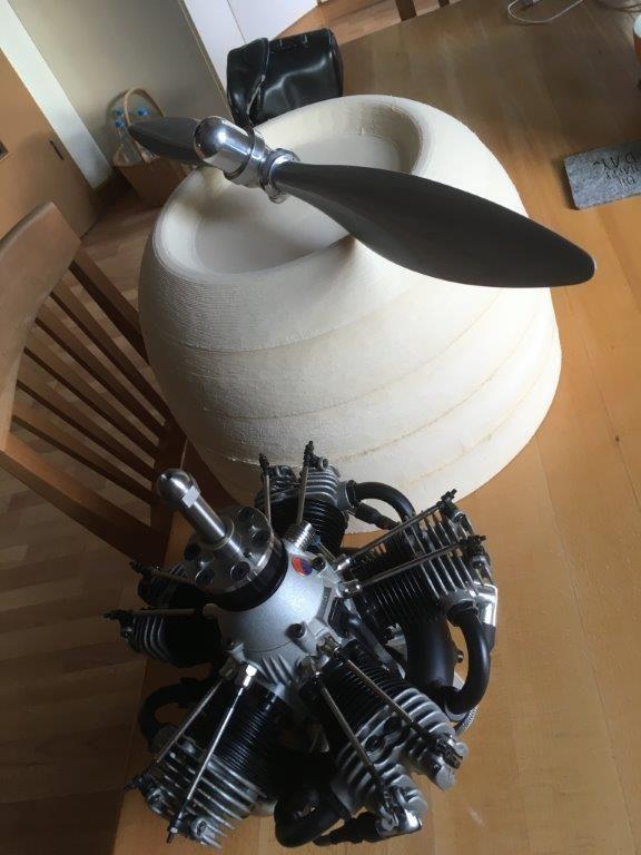

I have a Moki 5 cylinder with 150ccm for it and the plane with 100inch span was blown up so far due the 250ccm Moki 7 cyl does also fit inside, and the plan considder both enginge to be build in there a 2 diffrerent domes for it.
Here the foam master for the cowling and the Moki, I bought thin prop approx10-15 years agoe from a company in USA / could be Florida / but I cannot remember the hub and the blades are no longer made ;-(

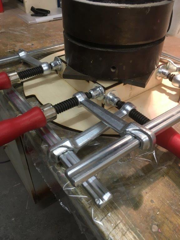

The last bushing was done ready for hard soldering now:
Test how parts fit together:
Adequate fit
Spar no 4 and 5 can be completed, 1,2 and 3have to come together in the complete asy

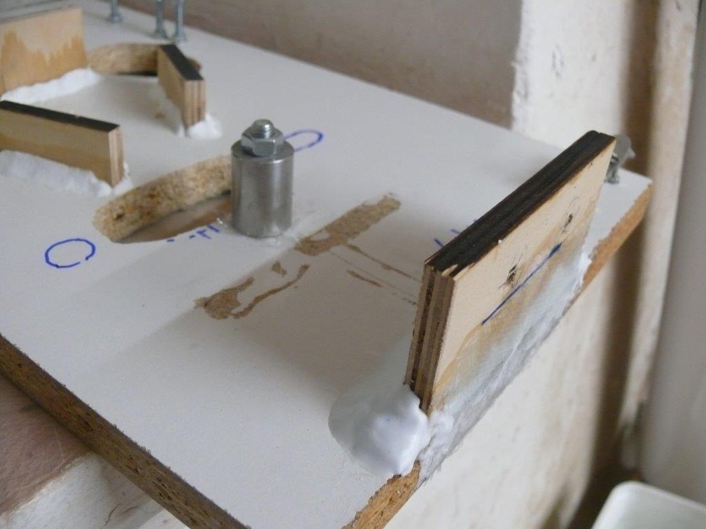

steped bolt was ready so the fork could be beded into the splitline
Rudder main construction easy to build in your hands with the help of 2 stringers:
Next spars glued together...
...and the blocks for Rudder upr and lwr side.
The gear jig neede rework, the bushing cam last and was0,5mm off the V-tubes and the massive part will have to heat up so the wood needs to clear off a bit... spoken to the Solder guy today.

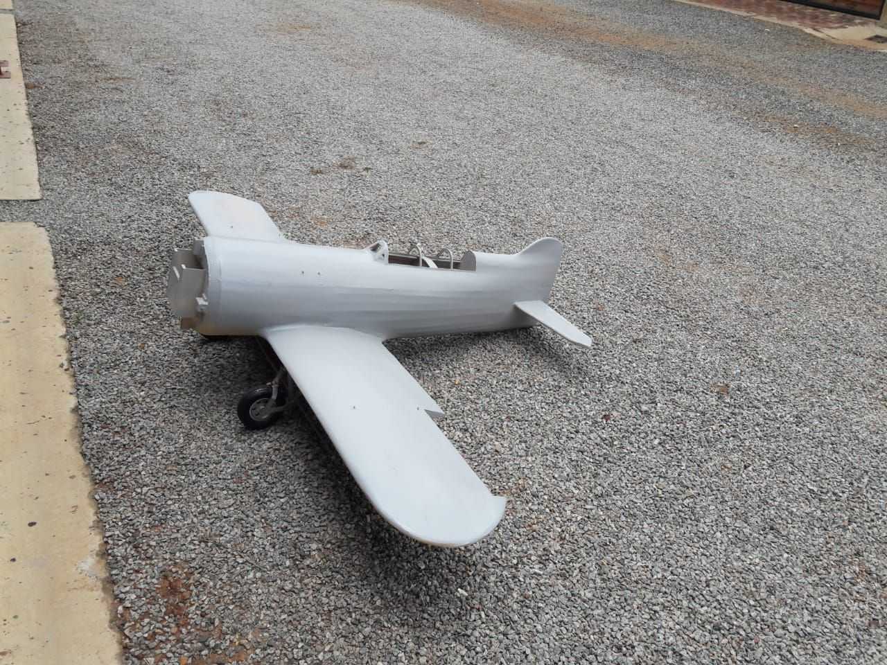

Default My QED painted
Painted

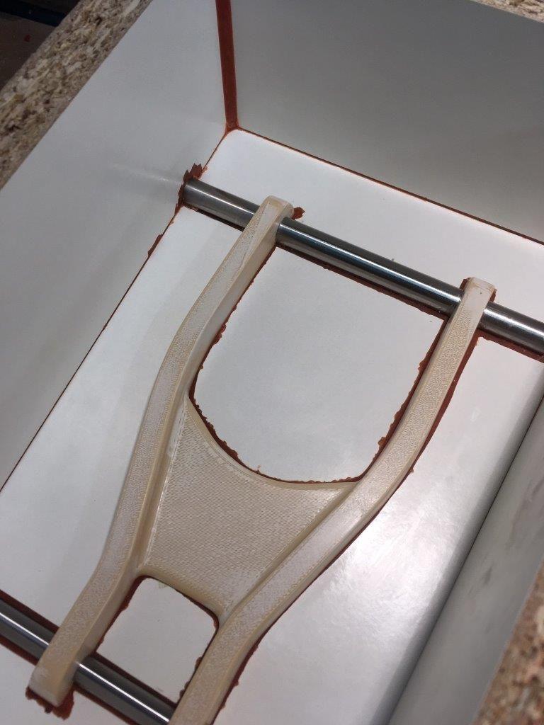

A friend made an analysation of the microstructur of fork and trailungarm, you can see the milled carbon fibres 0,2mm long mixed with the resin MGS L285 and H285 and it reminds me to the very hard steel structure called "Dendriten" shows where the strengs and stiffness comes from. all gear parts were placed in the ove 1h heat up hold for 3 hours at max 80° and then 1h cool down, the finger proved stiffnes raised incredible.
