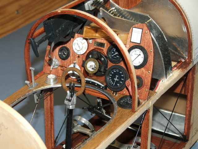

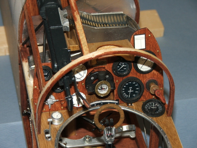

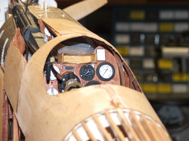

Well, I guess since I’m starting this thread with the plane half built, I should briefly cover what’s gone before.The plane is designed to be flown either as Control Line or R/C. I have been flying C/L for 23 years, and am just getting started in R/C.
Since I wanted a full cockpit, I started there and pretty much framed the plane around it. I used pictures from the Memorial Flight Association web site for most of the detail work. I compared them to pictures of other cockpits, and used what was common to all. I used Model Cad to draw the instruments, based on the pictures, and printed them with a high definition printer. The bezels are made from various pieces of tubing, ink pens, etc. The metal edge around the cockpit stiffener is a soft aluminum strip, with the “rivets” pressed in with an awl. The control yoke is brass rod with an aluminum top and ring, wrapped with rigging twine. The compass is shaped and hollowed out dowel rod. The inner ring is printed on photo paper, cut out and shaped. It’s held in place with a thin wire through the center. The ammo bin is made of aluminum. I added it because it can be seen through the window above the instrument panel. The bullet belt is from a GI Joe action figure.

You know I think you have done a super job! A question, what did you use to make your inclinenometer? I ended up casting mine with clear resin. I was just wondering what your's was made of..Thanks and Happy Thanksgiving.

rwright, Thanks.You know we're almost neighbors! Maybe we can get together some time
Hi Bob. Your inclineometer looks great! Mine was a lot smaller. I used the cap tubing you use for appling CA. I filled a peice with CA and injected an air bubble with an Insulin syringe.Used syringes are great for a lot of stuff. Like putting that perfect, tiny drop of glue exactly where you want it!

Ah Steve, good idea!.. Mine took some head scratching to come up with something that would look like glass. I even considered finding a glass blower to make me one. As it turned out I worked around it.

Bob, That's the part I find the most rewarding. It' one thing to build a kit, or use pllans where everything is already worked out. Don't get me wrong. I love to build,period. but figuring out how to make it all work is is a new challenge. I'm really enjoying this build. And having so many modelers here willing to help is the icing on the cake.

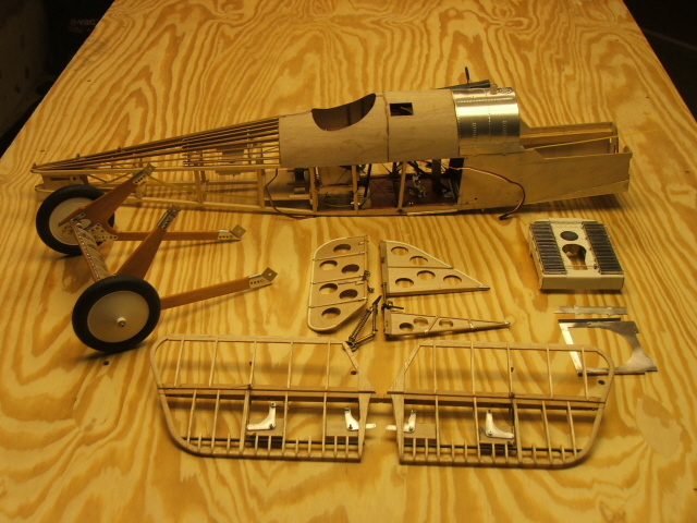

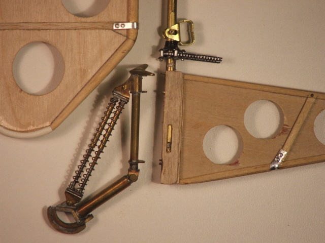

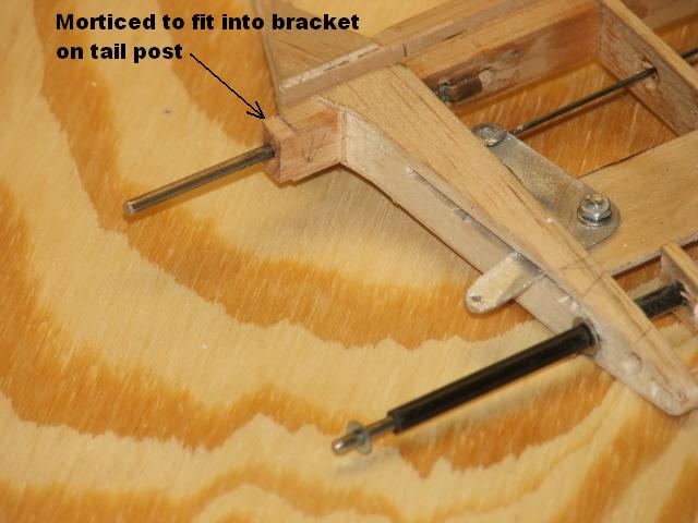

Here's a shot of what I have finished so far. the landing gear and tail section are ready to cover and paint.
I made the stab adjustable, like the full scale. The tail post has an outer tube and an inner rod. The inner rod ,on the full scale, is threaded with a sprocket and chain. The ends of the chain are connected to cables which wrap around a wheel just to the lower left side of the pilots seat. By turning the wheel, the sprocket would move the inner rod up or down as needed, so the pilot could adjust the trim for changing weight.(using fuel, dropping bombs, etc) The stab pivoted at the spar, with the trailing edge moving up or down. The rigging attached to the trailing edge is also attached to the inner rod, so it moves up and down with the trailing edge. Since I couldn't make a chain that small, I cheated. I put a 4-40 socket head bolt in the bottom of the post,held in place with small rings soldered above and below the head. The bolt is threaded into the inner rod. Turning the bolt moves the inner rod from 0 deg to + 5 deg. How's that for scale functionality?

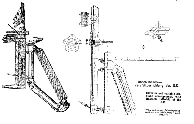

BTW, I see a bit of German on that drawing of the tailplane adjuster. Did an article on the SE5a appear in the old Flugsport magazine?

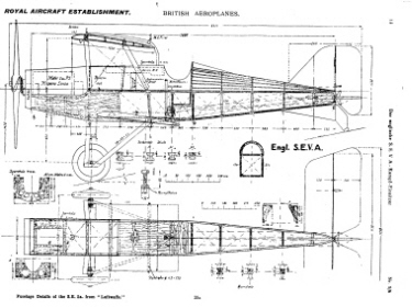

I found these drawings in Jane's all The World Aircraft years ago. They were printed in Luftwaffe Magazine in 1918. They captured an SE5a and published detailed drawings of the whole plane, complete with measurements. I can send you a copy if you like.

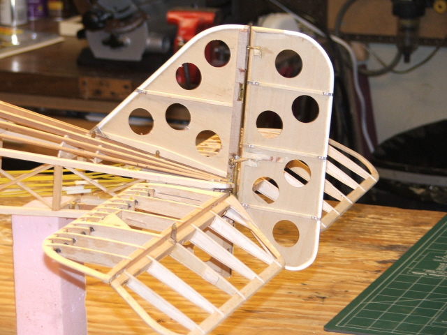

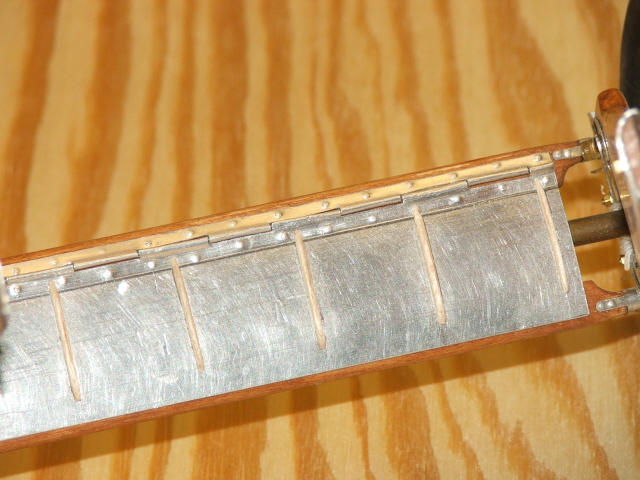

Here's the rest of the tial feathers. The front spar will pivot with a music wire through a carbon fiber bushing in the fuse. The trailing edge will be joined with music wire and will fit through the adjusting bracket on the tail post. Control for the elevators will be done with double control horns conected to a split push rod. The pictures are of the bottom, to show the scale conection points. Hinges are scale and are made of brass strips.

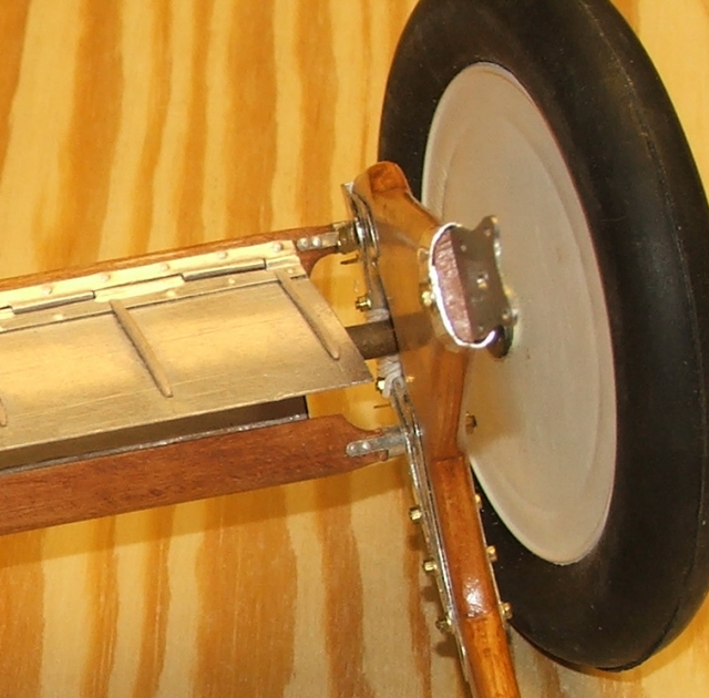

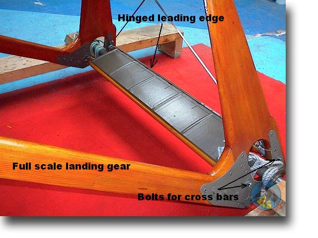

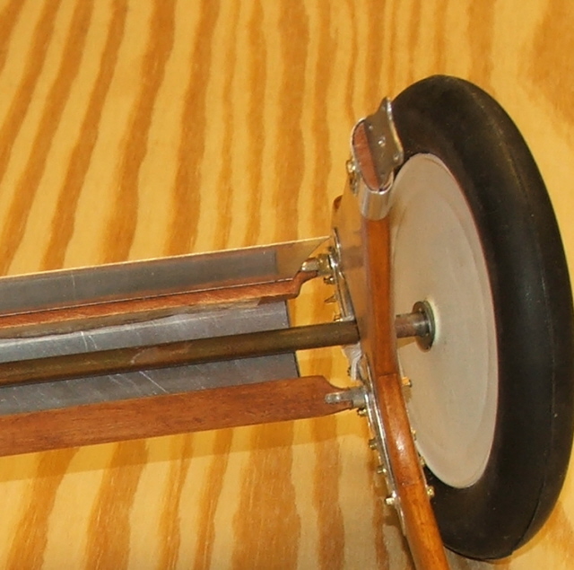

The landing gear is built the same way as the full scale. I used clear hickory, wrapped with aluminum, and riveted with brass tubing. The cross bars have 2-56 threaded rod epoxied into the ends, and bolt through the legs. The bottom fairing is solid and is attached to the front and rear cross bars. the top fairing is hinged along the leading edge, and is not attached to the rear bar. As the axle moves up, stretching the bungee cords, the top fairing moves up with it. Gravity and wind hold it in place when airborne. I made the top fairing/hinge by bending the aluminum around the wire hinge pin. I then marked both pieces and cut out alternate spaces with a dremel cutoff wheel. The bungee cord in the pictures will be replaced with a larger diameter cord, after painting.

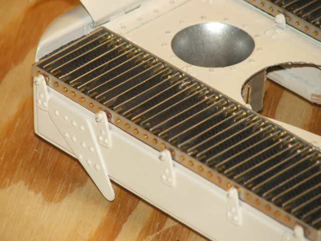

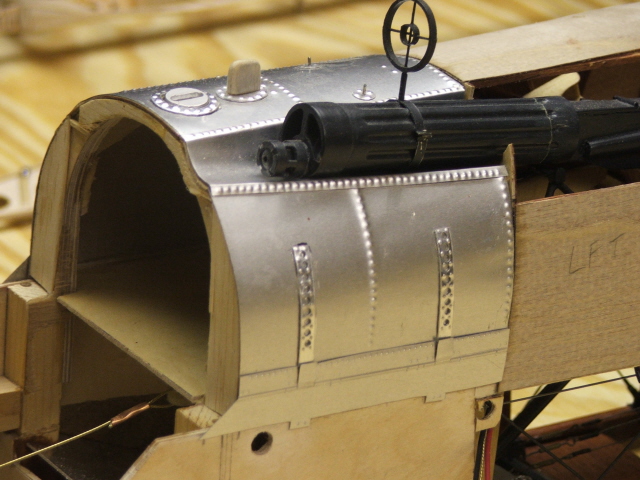

The radiator is made with a plywood back plate. On that i made two balsa boxes the shape of the cores. I put a slightly smaller piece of 1/64 ply on the sides to match th shape of the full size. I got some brass mesh foil at a craft store.and inset it into the boxes to complete the effect of leaded cores. The bottom and top are made of balsa. The center top cover is hinged aluminum,as on the full scale. It is held closed by the toe engine cowling. After shaping the cover, I cut out the center of the top balsa block and added the brass cap. The shutters are made of aluminum strips. I cut a notch in each end of each strip. then I made brass caps for the ends by cutting a slot in pieces of 1/16 tubing, and sliding them over the slots in the shutters. This forms a small cavity to recieve the brass pin which holds them in the aluminum frame.I put the shutter in place, fill the cavity with epoxy in a small syringe, and insert the brass pins.
The bracket on the sides are 1/64 Ply and the !QUOT!rivets!QUOT! are small pins. The velocity stack for the carb air intake is carved balsa. Total Pieces? 721!

Thanks Red. This plane is the most enjoyable build I've ever done. When I get the shop cleaned up a little, I'll shoot you a couple of pics.[:'(]
Abu, I'm really enjoying your build. Your attention to detailed building makes for a first class model, however much " scale detail" you decide to add. I know your planes don't fall out of the sky!
Sorry about the info overload. I just had to get caught up before I could move on. Things will move at a more normel pace (slooow) from here on.
The full scale SE5a used a pully system for the elevators. each elevator had it's own cables. If one got hit by a lucky shot, you still had enough control to get home. There is one pully in the stab, just behind the spar, and one in the fuse,also just behind the spar. So, the cable had to make two 90 deg bends. I tried several ways to duplicate this settup, but at this scale ,nothing worked free enough. More important for it to fly right than look right. with the wire rods on the bottom, I think I can make them look scale enough that no one will notice.
Steve

Steve, I really like your radiator treatment. That's one area where I didn't get as detailed as I could have (other areas too!) I've contemplated rebuilding it and adding more detail.. Not sure that's going to happen though but I did "borrow" your sketch if you don't mind.
