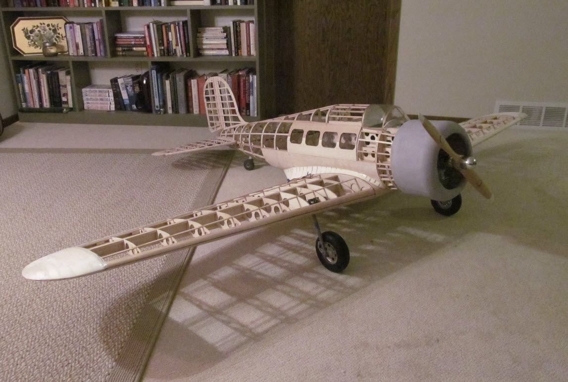

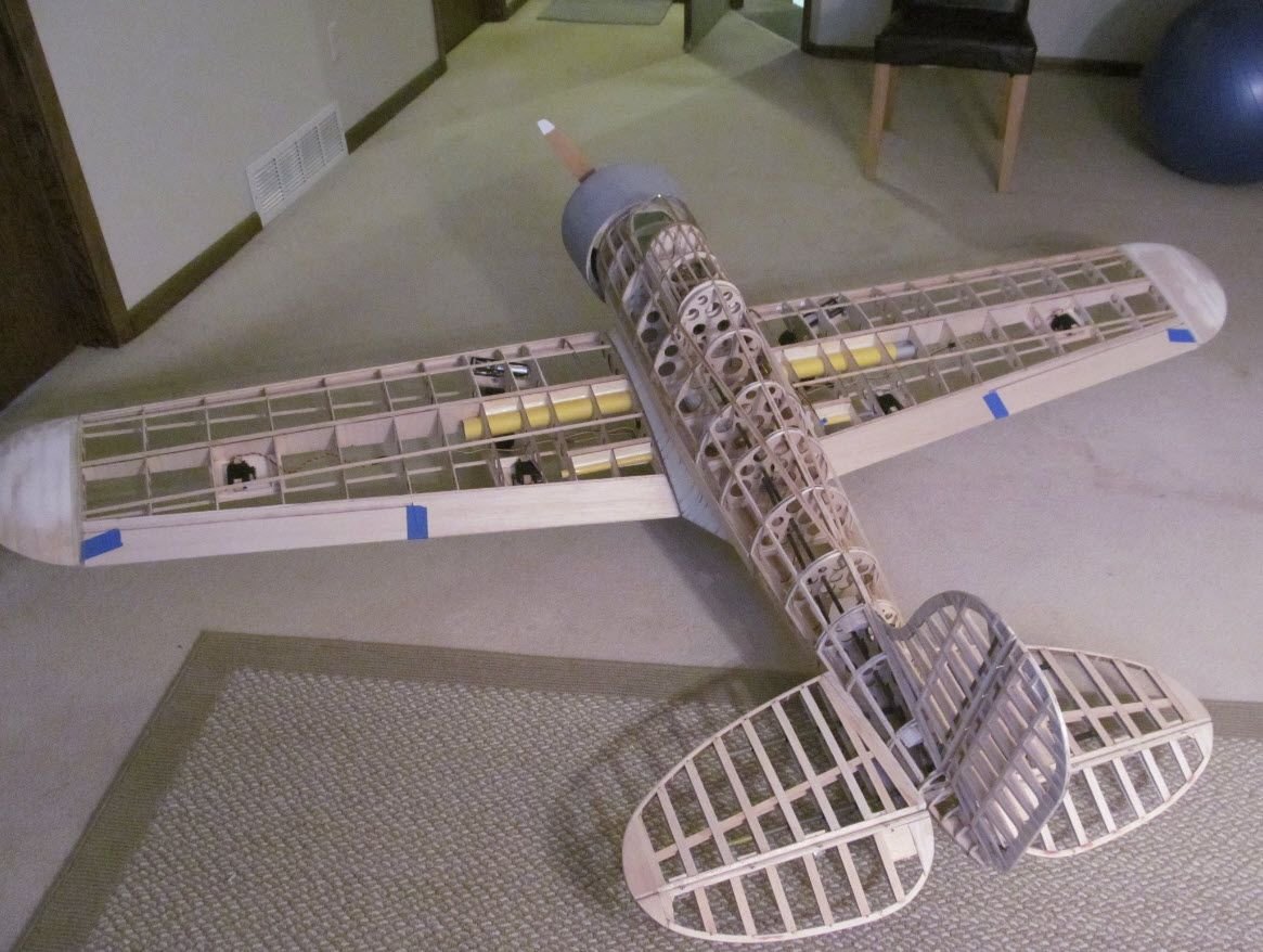

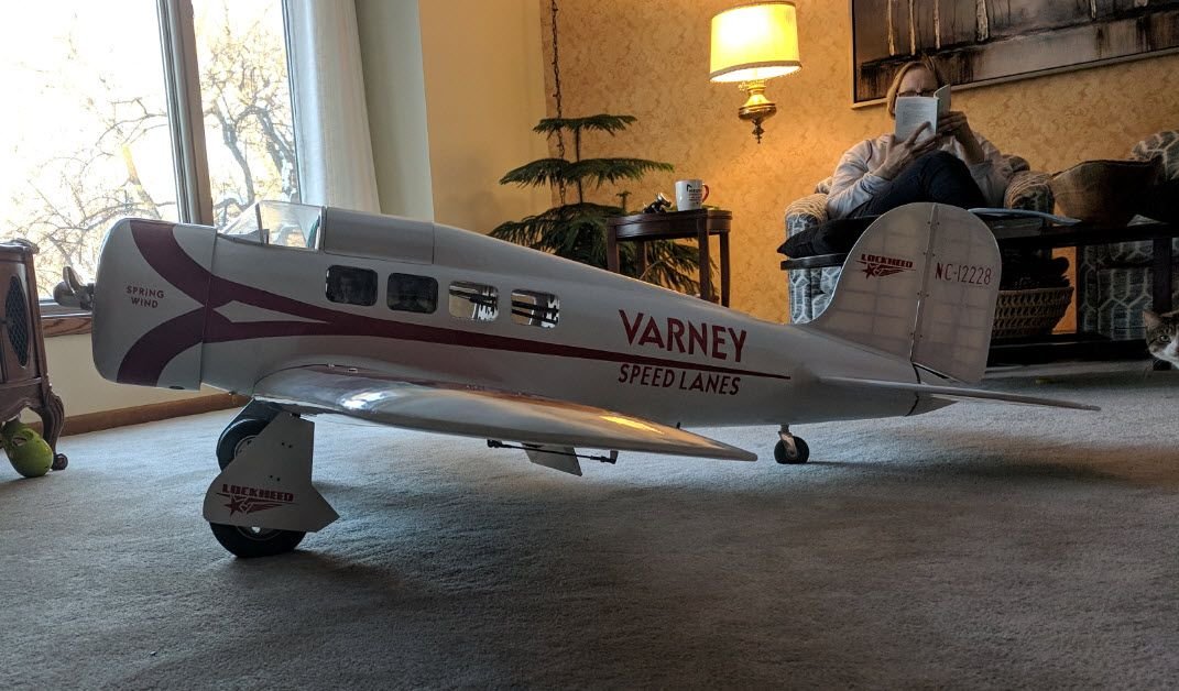

Seriously. I am stuck again. My wife has breast cancer and she is getting worse. So this project has been languishing. The entire structure, mechanics, air retracts, servos and linkages, hinges, engine, fuel plumbing, its all in and working. Basically it needs to be sheeted and finished. Still, that is a whole lot of work for those of you who know. I can get real picky when finishing.
I started this thread in 2007. I never would have guessed it would take this long. Life is just so full. I can respect guys like Dave Platte and others who churned out a dozen designs and kits in a dozen years in their prime.
In any case, Its a beauty for sure. Scale as well. Yehaw.

I have been picking away at the prints. There will be three sheets 34" x 72". There will also be over one hundred build photos, a bill of materials, and an instruction book.
This will be my contribution to RC. I will not be doing something like this again. I can really appreciate an ARF after all this. LOL

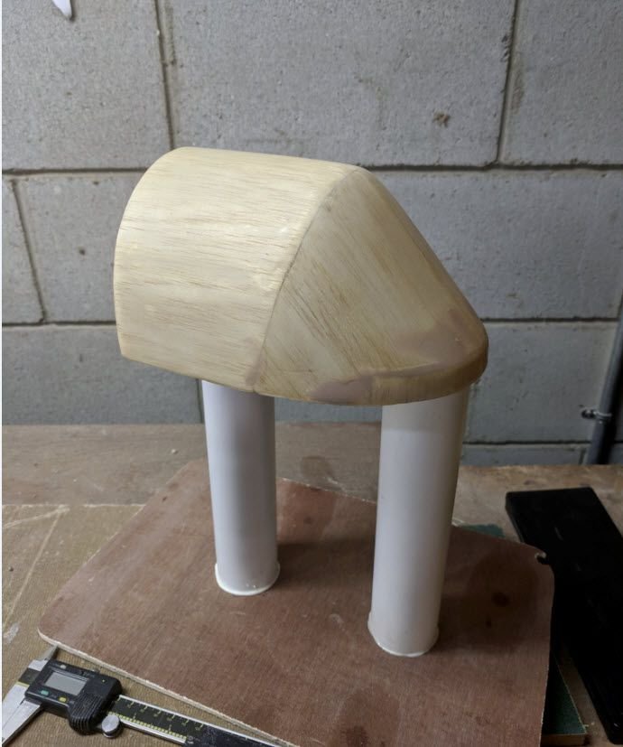

Did you make the windows, canopy and cowling yourself?
FlyerInOKC is offline
Reply With Quote
Old 11-15-2018, 04:51 AM
  #59
flyguy888
My Feedback: (63)
flyguy888's Avatar
Join Date: Nov 2004
Location: coon rapids, MN
Posts: 180
Gallery
My Gallery
Models
My Models
Ratings
My Feedback

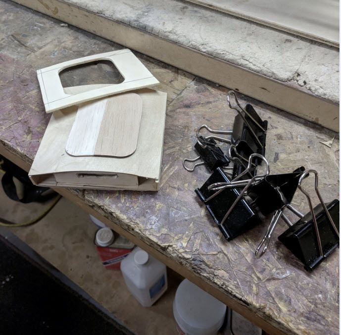

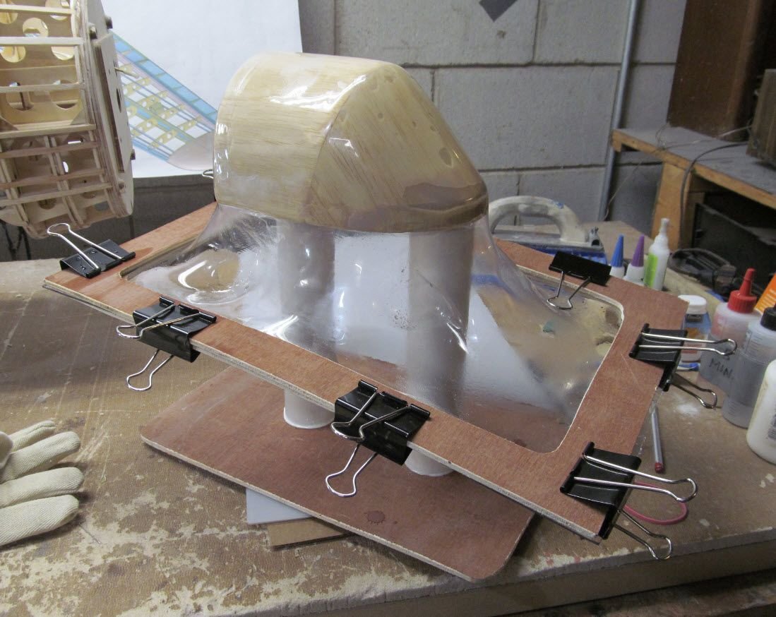

Yes. The canopy was done using a pull mold. Lots of videos online on how to do this. The trick is getting an ulta smooth mold because the PETG plastic shows every imperfection. Took me several pulls until I got a good canopy.
For the windows I made a fixture. Similar to the pull mold. Kinda. I sandwich the plastic between the frame and base using clamps all around to hold the frame over the base. Put it in the oven and wait until I see the frame collapse the plastic around the form.
The cowling is all balsa and ply. It would be difficult to mold because its round at the front and oval at the rear. Although you could do a fiberglass mold in two halves and join the halves after molding.

Cool! They all came out great!

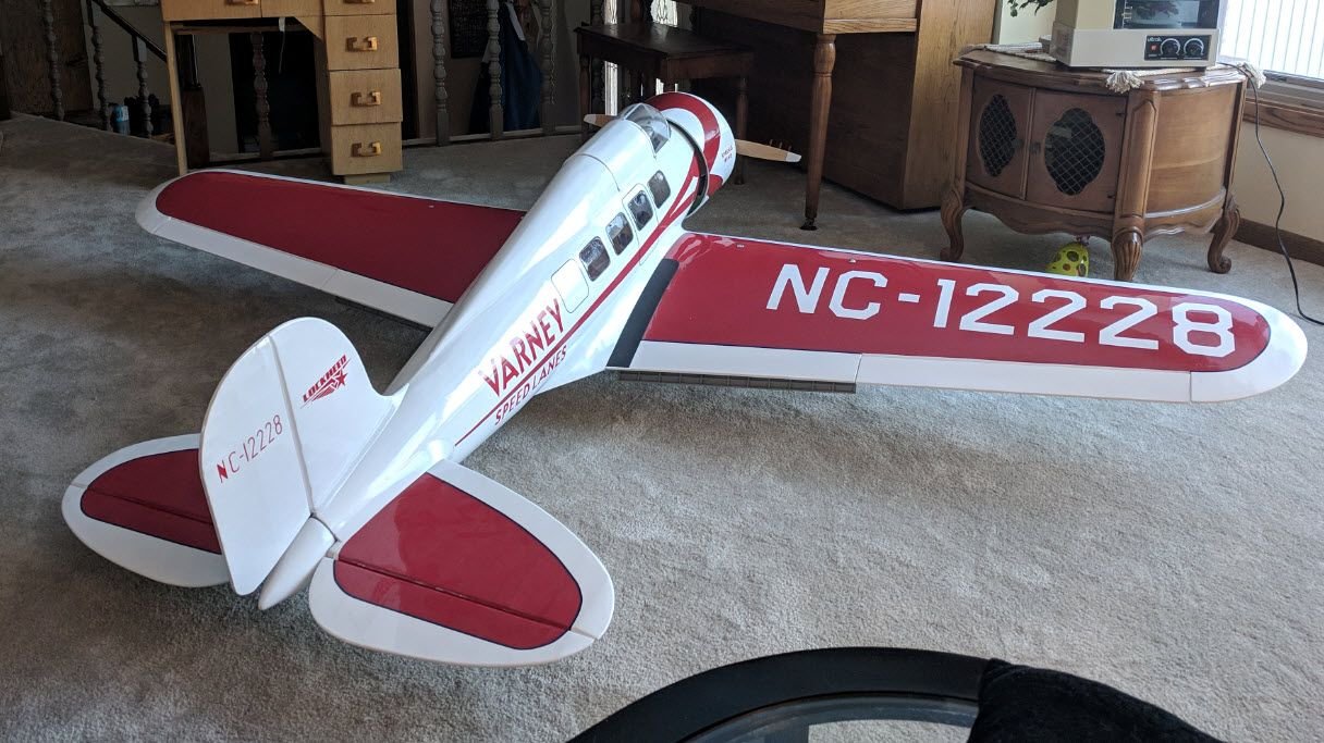

Just finished. I still have to test the engine and setup the radio. I am real happy. It looks like a Lockheed Orion!
Its hard to see, but on one side I have Katherin Hepburn and Spencer Tracy, on the other Bogart and Bacall. An airliner needs passengers.

WOW! Just WOW!
