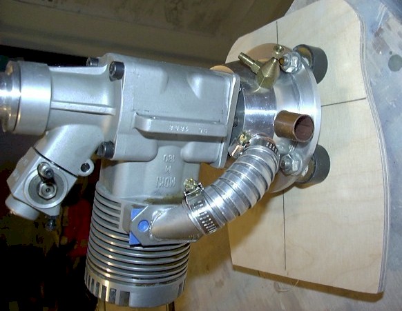

Would you be kind enough to show a couple pictures of this arrangement? I am in the process of making up something for the spitty i'm building and could use the visual assistance. cheers!
I'm planning on using a Moki 1.8 in mine with an Air Hobbies muffler/mount combo. I am debating the exiting exhaust and cooling and will proably do it per the Brian Taylor plans, but would like to see how you handled this. thanks!

Dave, I have a Moki 1.8 in my Yellow Spit. I don't have a lot of time on it (even thought its 3 years old) but when it flew the last time it flew pretty well. It's not over powered with the 1.8 but flies scale. I am using an 18x8 prop. A friend is flying the same plane with a Mustang 50 cc gas and a Bolley prop. Lots more speed and vertical performance with that set up.
I have a Slim Line pitts style muffler with My set up. I had to rotate the engine about 10 Degrees and releave the fire wall about 1/8 inch so the muffler clears it. I put a duct in the Fuse of the plane with an exit at the oil cooler on the wing bottom. Air passes in thru the cowl, across the cylinder, thru the duct via an opening in the firewall and out the bottom of the wing. I am also using an onboard igintion for the Moki to keep the plug hot when at low idle. FYI I am currently building the Yellow Bubble P47 from the 78 FG also. I am doing Frank Oiler's "Eileen" form the 84 FS. I did considerable reasearch on the paint of that FG and the defenitative word is that they were RAF Dark Green uppers and sky lowers. This was confirmed by Gary Fry who is the group historian and authored the book "Eagles of Duxford". Thanks for the reply!!! Regards BobH.

thanks for sending the picky.
that looks neat and tidy, does the manifold come from air hobbies?, would like one of those myself. i've never seen that set up so i don't know how it will perform, the muffler (silencer) seems small, or do you now attached a separate can? i'll need to borrow a digi camera from work and take some snaps of what i'am going to do, it will take a few weeks hope you can wait. i'am getting all my aircraft ready for the summer, the spit being the last on my list but let me know what you do, i'am very interested.
i think how to solve this type of problem makes a excellent article, i'll keep you in mind, readers need to see what happens in the real world and what can be brought off the shelve.

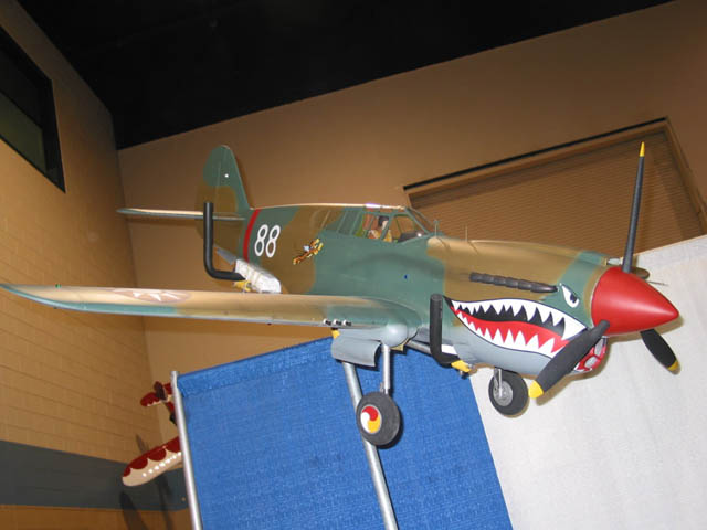

I just saw the Finished P-40 at the Toledo show last weekend. As usual its a very nice looking kit. They had the plane finished and hanging by their booth. I talked to Gary Dye (kit builder) and was told that he used a 3W 50 for power. He indicated the cowl was big enough to hide anything you might want to use. The retracts use Double Air Cycliders per each strut. I didn't ask about accessories etc. but I'm sure some will be available.

I have yet to run it with this setup but from what i have heard they work quite well. I think the volume instide is quite a bit larger than your standard muffler and air hobbies sell an internal aluminum baffle for $15 if you want to make it even quieter. I may try this as well to see the effect it has. The nipple you see in the picture on the muffler is for an optional smoke system if you want. I have this closed completly off for the spitfire.
I was hoping to route the exhaust out the scale location but this may be a bit of trouble so i may have it going out the bottom. verdict is still out on that. I'll let you know how i make out.
Hope this is helpful. Let me know if you'd like more pics, I have a digital camera and would be happy to snap more. Cheers, Sean
