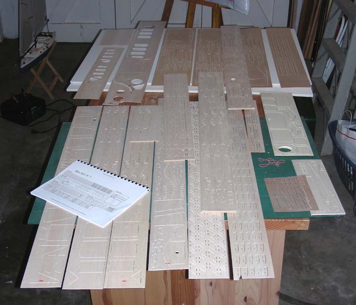

Okay... I just did an inventory of the kit contents. Took over an hour. LOTS of sheets/parts in that box. My legs are sore.
I notice all the wood is cut with a router rather than laser, which is fine. A few times I thought there were parts missing but found the parts on that sheet loose in a bag. Of course the acid etch parts are coming in a separate shipment, hopefully within the week.
This kit has a zillion wood parts but makes no attempt to provide all the metal hardware. Even the axle and some of the LG parts will have to be provided by me. I think there will be some other "builder provided" parts as well, once I get into it.
The cowl, as mentioned before is nicely done, complete with little bumps to indicate rivets. I will probably aluminum foil this part for a bright look. My photo of it looks funny because the static electricity on it picked up a lot of sawdust in my shop. Maybe it is time to vacuum?
On Weds. I will make copies of a few of the drawings to build over. The drawings, by the way, are really nicely done, not like your usual fuzzy thick-lined hand-drawn plan drawings with the wood grain shown on every shaggy part. The details are obviously very well thought out and carefully delineated. These drawings are masterpieces and I don't want to cut them up anymore than necessary. I may draw over them with some roll vellum if commercial prints are not accurate to size.
There are lots of decisions to make before I get going, like how to do the aileron servos. On the drawing they are powered by a single standard size servo mounted in the fuselage driving pushrods and bell cranks. The upper wing ailerons are connected by a thin pushrod in a tube (from side to side) and connected to the lower ones with 1mm wire rod. This is a very scale way to do it but I might consider twin mini servos in the lower wing instead. Frank Sopwith did that on the CD Scaledesigns prototype and that's how I did my VK Camel too.

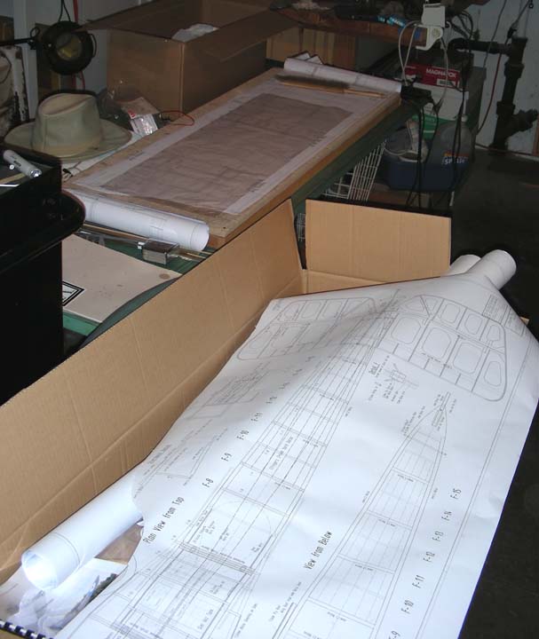

Yesterday I received a packet of information from the RAAF Museum on their replica, including a copy of a photo of the original Pup on which they based the replica (thanks, Monica Walsh, Curator of Research, RAAF Museum). It looks like I could model either one although the photo record of the original plane amounts to this one photo, vs many pictures of the replica. The original had no tail wheel, an issue which could be counted either way - ground handling vs historic interest. Other differences include the cooling holes in the cowl (the replica has a radial engine, with cooling holes on the upper half).
Today was "hit-the-hobby-shops" day, gathering brass tubing, music wire and a 10 oz Sullivan Flextank. This tank will require some modifications of the liteply tank box to allow for 1/4" more width and about 1/2" more height. The width change is no big deal but will necessitate using a mini servo rather than full size for throttle. The height modification will force the rudder and elevator servos upward about 1/2". The slightly taller Spectrum digital servos I have wouldn't have fit anyway without some modification.
Because my model will have lots of lithoplate up front, I think I will want to mount the rx behind the pilot, which raises access issues unless I make the cockpit/turtledeck part removable. This is a serious consideration because it adds some structure to support this removable part. On the other hand, the additional access opens up interesting possibilities for the elevator linkage system. I could even relocate the little jackshaft BEHIND the pilot and have a totally clear cockpit area.
... lots to think about.
I also got copies of two of the drawings. They are so good I had trouble telling which ones were which. There was a slight shrinkage (about 5mm in drawing length) so I will probably build over the kit provided drawings for better accuracy.

I have started to cut up the drawings to work over. The pix below show two of them stapled to my building boards, one for the left lower wing, the other for the fuselage - where I intend to start.
One issue for the fuselage is the tail construction, to conform to the RAAF Pup I am doing. The photo below was drawn over in Photoshop, then scaled to model size and printed out to compare the kit with the actual aircraft. I have started a rough layout of that area (also shown below). The tailwheel turns out to be 1" in 1/6th scale, which is easy to get. The tail skid has its pivot forward from the kit design so I will make that modification, setting its pivot from the rear rudder mount post rather than from the tail post. Kit design calls for 1/8" brass tubes (3mm) in the fin and fuselage - and 3/32" music wire within the brass tubes. It also calls for a 5mm brass tube for the tailpost.
I will change to a wood dowel for the tailpost. The music wire will become 1/8" wood dowels and the 1/8" brass tubes will become 5/32" aluminum tubes and be only in the fuselage, not the fin part.
I need to layout the new tailskid, its mounting and control wires - which will have to slave to the pull-pull rudder cables, probably using a floating crossbeam with the tailwheel pull-pulls coming off nearer the center to create a better steering ratio than the rudder cables would otherwise provide. The tailskid suspension must also be designed and laid out.
