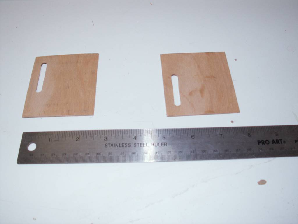

with this kit, almost everything was designed a bit oversized and you would glue the pieces in, then trim them off. This is ok but isn't precise - LOTS of fabrication.

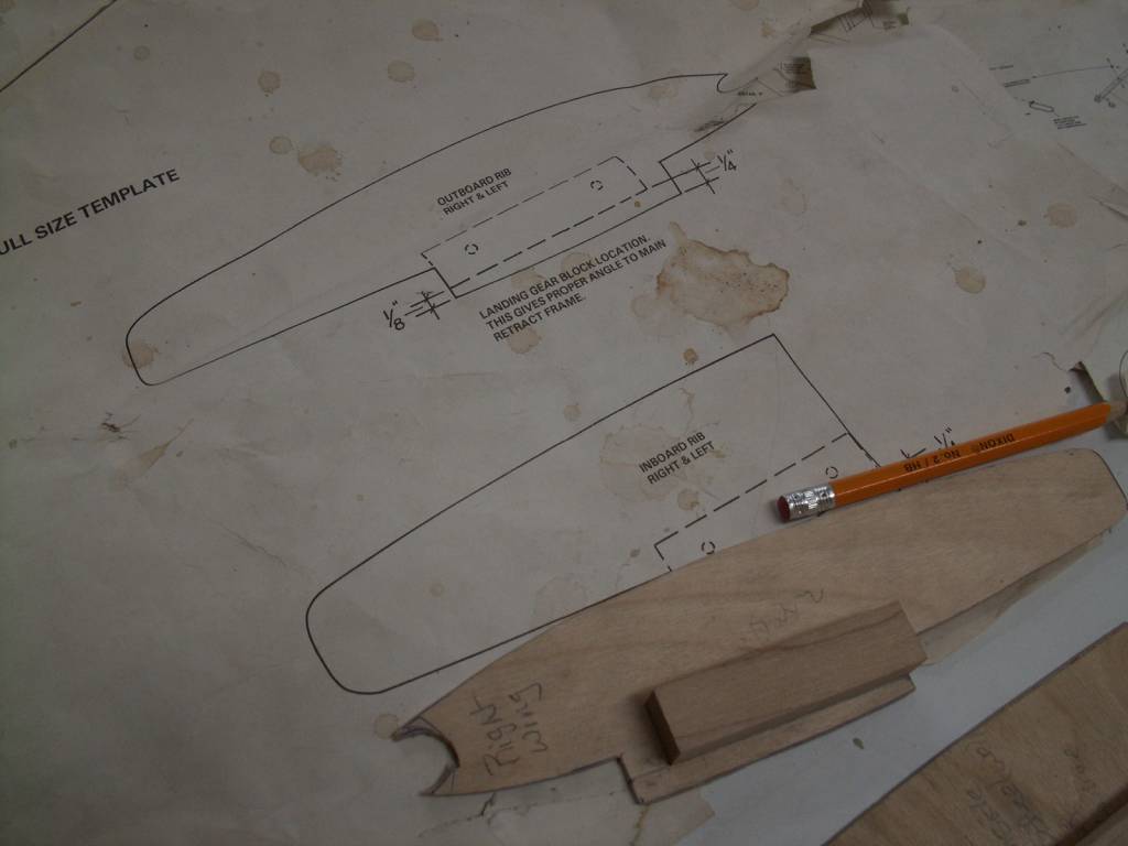

On the retractable gear mounts, I had to fabricate a couple of new ribs. It was amazing that right out of the factory, the right and left halves were not even close to the same! Oh well, that is what happened before computers and precision lazer cutters. If anyone is building one of these, the directions and the plans say where to glue in the mounting blocks on the ribs for the retracts I suggest that you glue them maybe a 1/16" deeper than suggested so that the gear mount plate will be below the skin of the wing when finished.
The front of that rib doesn't look very nice and I took a dremel with a sanding drum and made it look better before installing it in the wing. A 5/8" dowel cut to length goes there and against the front of the inside of the leading edge of the wing. Make sure to double check the fit before glueing it in!
http://www.youtube.com/watch?v=WakievP8VPc
there are several videos on this and more.
when I downloaded thes videos, I didn't really edit them because there was so much and it would have taken forever to do so. As a result, I just uploaded them in order, raw. So, if it gets boring, just fast forward them.

On those support ribs, don't forget to drill a 1/2" to 3/4" hole in the rear section of them so you can route the aileron servo extention I almost forgot to do that!
I don't really know why they designed a bolt to go through the top of the wing into the mounting block of the retract mounts. I didn't really think it was necessary but I did it anyway. Here are a couple of pics of the install.
You can see how they are installed here. Also, there are some 4-40 bolts and nuts going through them to make them stonger so you only have to use ca to glue the blocks one. The holes drilled for the aileron servo extensions are out of the camera's view. The blocks are drilled and tapped for a 10-32 nylon bolt for the retracts. Nylon bolts are a very good idea here. I would rather the bolt break on a bad landing than to tear apart that foam wing!

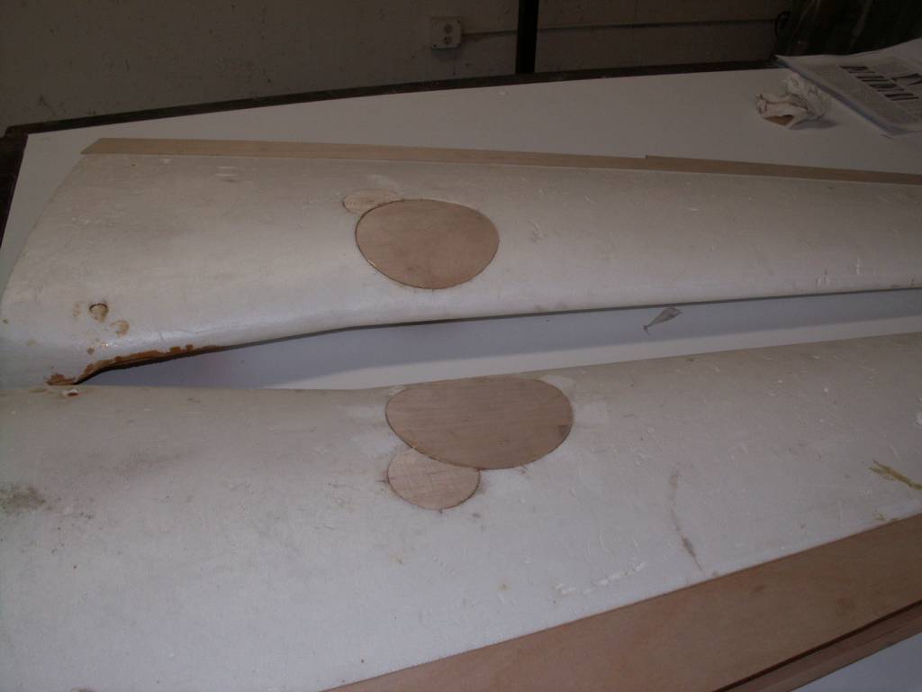

The next step was to place the inserts in the places on the wing skins. For the retractable version it says in the directions that these inside covers are not necessary and just to use the larger plywood (1/32") over it as a skin. I really wanted more strength and didn't feel that there would be enough so I installed them anyway. My wing is still very light.

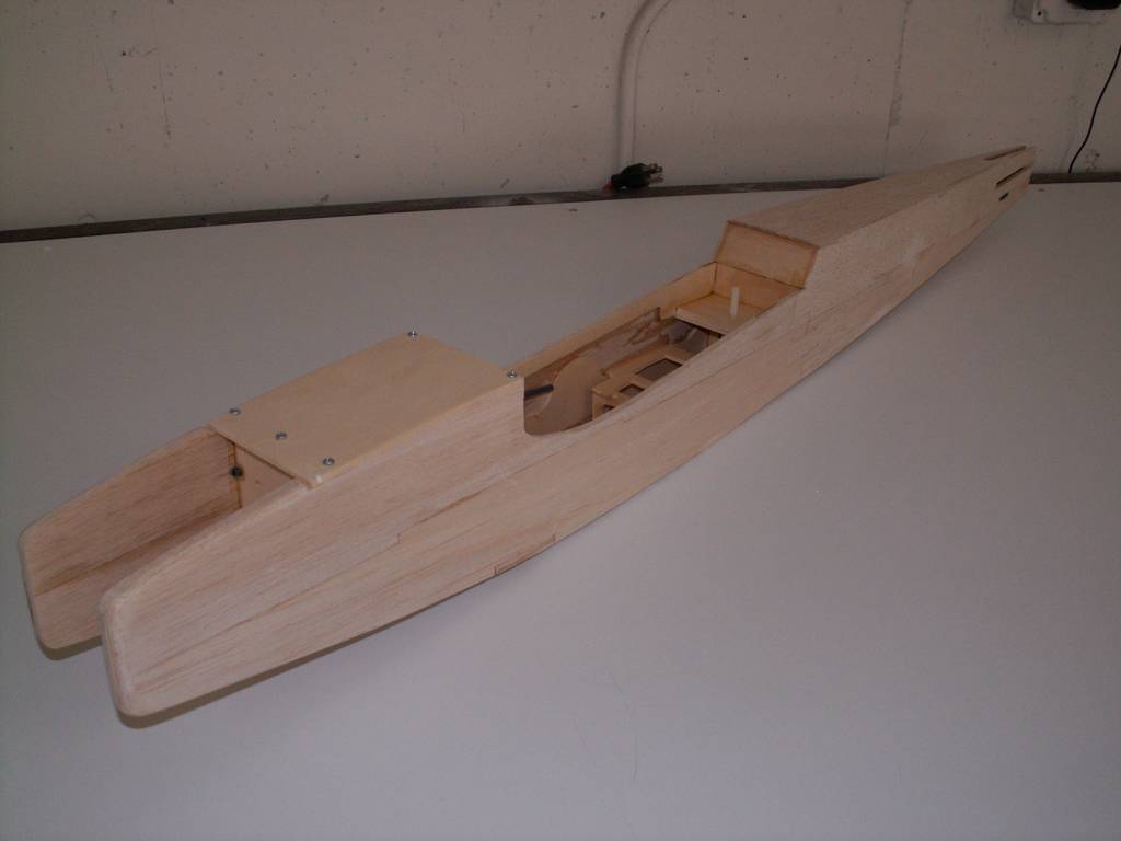

The fuselage was very heavy with the byrodrive unit in it and was very hard to manage. So a stand had to be built and the engine removed. This took a few hours but was well worth it. I made the stand out of some old heavy walled PVC pipe that I had from a stand that came with my Great Planes Seawind and some blue foam from Lowe's hardware store. I am going to pad the inside of the cutouts for the fuselage before I paint it and it seems to be tough enough to use for transportation, assembly and mechanics in the shop and at the feild.
stand part 1: http://www.youtube.com/watch?v=ad74GeK08CA
stand part 2: http://www.youtube.com/watch?v=SpK5318-yVM
stand part 3: http://www.youtube.com/watch?v=axoPltFysGQ

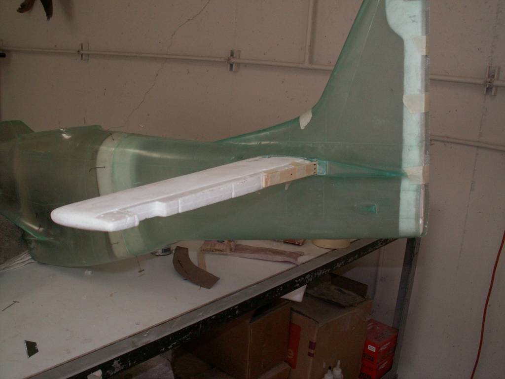

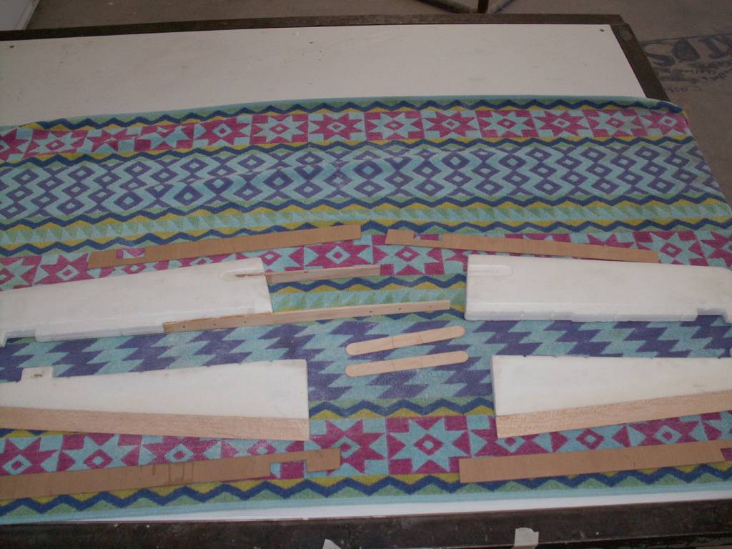

Lets jump to the contruction of the tail feathers. Here they are all layed out on a towel. At this point, all of the flight surfaces are foam and a bit delicate so I have been using a towel to protect them. The hinge covers were cut back in 2009 when I attempted to start this build.
On the original directions that I had, it never mentioned to put aileron stock on the trailing edge of the elevators. The newer direction book that I got shows that and of course, I did not have that so off to the hobby shop I went! I have glued the aileron stock on the elevators at this point.
I did not have the longer spar with this kit either but had the center, shorter one. haveing that length and a set of calipers, I was able to measure the width of the fuse at the spot of the spars and determine the length of the longer spar. It was tapered, marked and installed on one side.

The two piece fuselage has to be ready to accept the tail feathers by being temporarily set. I put the byrofoam collar in the front half of the fuse and pulled it back untill it was very tight. It was then marked with a pencil around where the edge of it was. It was then removed and that area that was inside the mark was sanded with 80 grit sandpaper. It was then installed using 15 minute epoxy. Only install the collar in the font half of the fuse!!!!
After the epoxy is cured, the aft fuselage piece is slid on. The tighter that this piece goes on, the better and tighter the seam. Mine turned out great. Then it is taped on for removal later when all of the internal things such as the retract mount, elevator horns etc are fed through and hooked up.

At the attatchment points of the horizontal stabs, there are some marks where you have to dremel out. Don't be afraid to make these oversize. Usually a tight fit is necessary but not here, it is alot easier to install and adjust when the fit is sloppy. also, dremel out a spot for the elevator control horn bracket before you permanently install the horizontal stab. I didn't do this and it was a lot harder to do then if I had done it before hand. Just read the directions and follow them to a tee on this part of your build.
I did a mock up install and tried the stab on one side, then on the other, taped them together, tweeked them here and there untill I was satisfied with the fit. This took along time, it just didn't seem to want to be straight!!! I finally got it and glued in one side, but you dont glue the spars to the fuse just yet, just the butt of the stab to the fuse.

When that one side sets, it is time for the other side. It is really important to get this right before you glue it permanently I cannot stress this enough. Normally when you set the horzontal stab to the fuse, the fuse is rigid and has very little adjustment. Here the fuse can be rotated either way on that byrofoam collar, the spars can be adjusted up or down and when the byrofoam post is installed, it can be set in there a way to tweek the upright verticle stab. Lots of little things like this that make this plane a challenge to build. I forgot to mention that I temporarily installed the byrofoam post in the verticle stab to help alignment before I started installing the horizontal stab.

I put a t pin up on top of the verticle stab and connected a string to it. Using the string and lots of tape, I was able to get the alignment I wanted both vertically and horizontally and with the canopy base, wing saddle etc. Once satisfied with the fit, I glued the other side on. It is within a 32nd difference from side to side. Like I said this took me a long time to do and I was VERY frustrated at this point. Then out of the blue, it just fit. Wow what a test on my patience.
After the glue set up on the second half, I installed the hinge covers and the spar covers.
