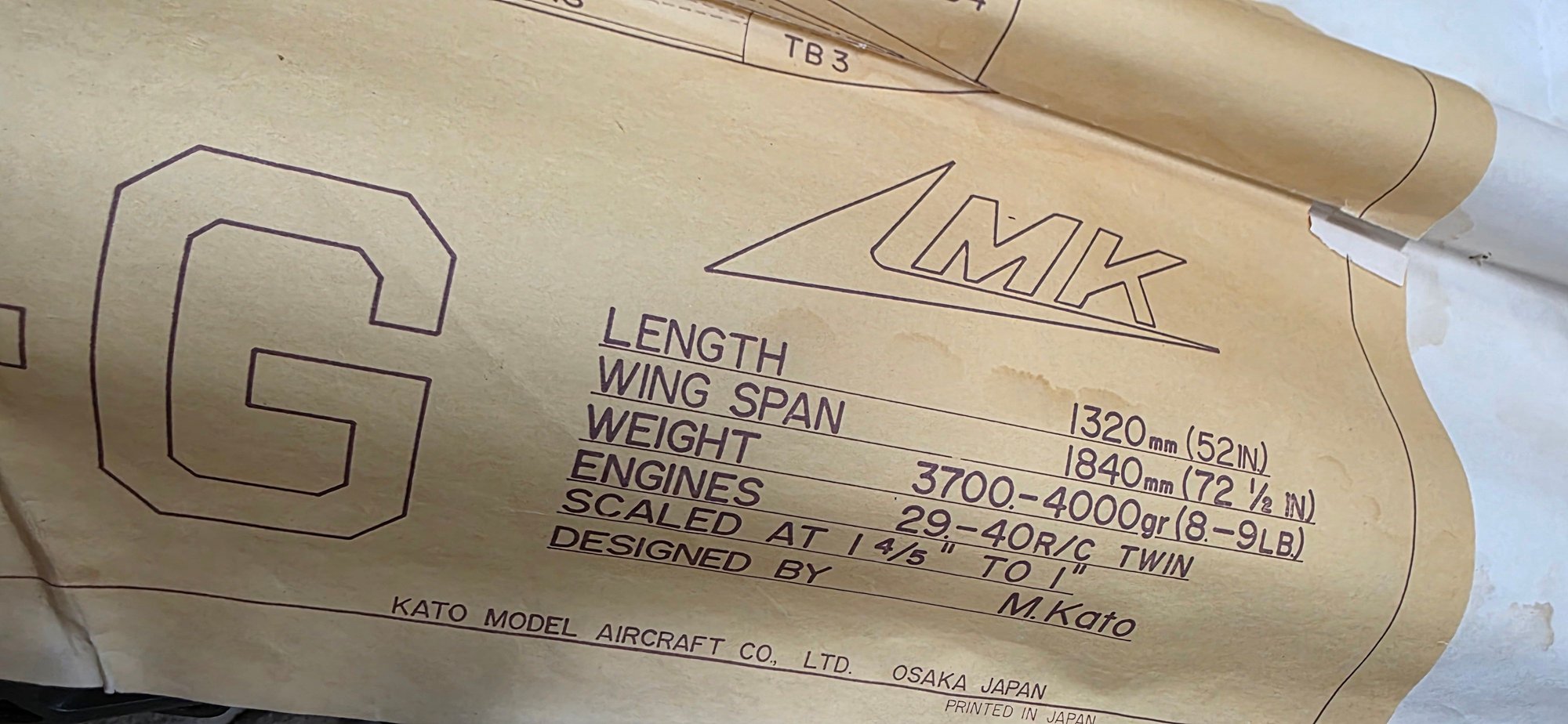

For all the builders out there any help will be appreciated. Trying to make sure I get the wing right. it says to put a center line on rib 2, 7, and 11. here Is how I have them marked so far. I just want to get it right. any help will be appreciated. Not much in the instruction or the plans.
Old 02-05-2020, 11:32 AM
  #81
I-fly-any-and-all
Join Date: Dec 2008
Location: Howell, MI
Posts: 1,276
To me the center line drawn in the ribs is so you can eyeball everything and prevent a twist, what I would do is glue ribs in place and simply check that all the trailing edges are level. You can correct a twist fairly easily.
Nope, this is wrong,,if you make all the TEs level with the table,,, that will create a twist.
Follow the instructions,, as the wing tapers and airfoil shrinks, the distance between the table and the rib trailing edge is also going to be reduced, Making sure each rib is on the same level plane like the instructions call out will create a straight wing,,, that's why newer kit designs have alignment tabs on ribs
