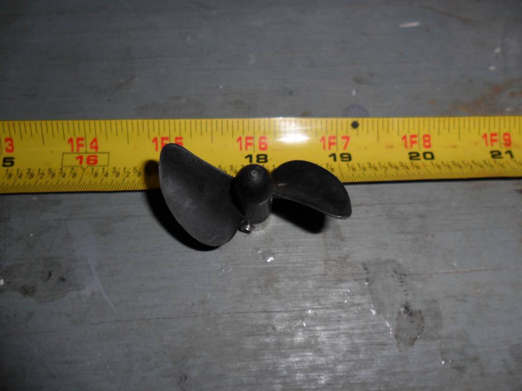

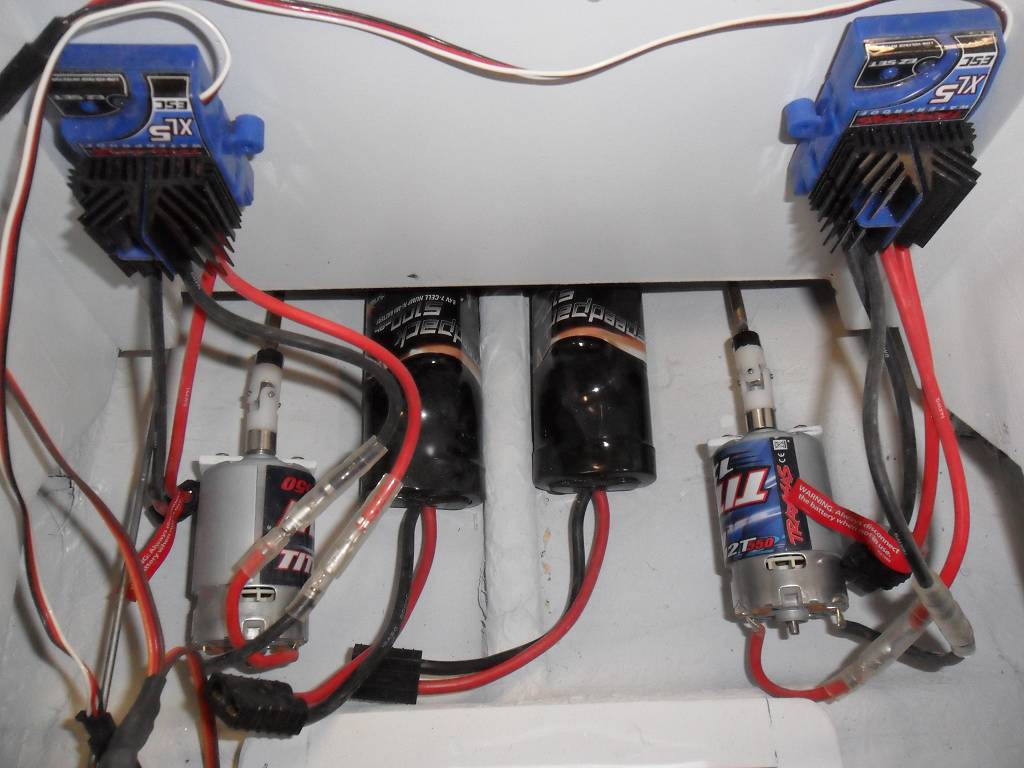

As I said before I put a couple 550's in another boat to see what would happen, its about the same size and weight. It did'nt do to good, I'm not trying to break any speed record but getting up on plane would be nice as I'm going to go ahead and keep this stuff in this boat even though its not top notch stuff. The boat I'm wanting to actually do RC for me is going to be the good stuff.
There are two Traxxas Titan 12T 550's, and two Traxxas props R and L turn. The motors are set up to turn R and L.
Right hand starboard and Left hand port.
The props i think are the problem here, 2" and not sure about the pitch but the motors do not get up to speed at all.
Any idea's what I could do with this boat just to get it moving a little, It's more for my son to play with.

Hi Nuttyd,
Beforeanyone can diagnose or make suggestionswe need to know a few more things about the boat and the motor.
1) how long is the boat?
2) How wide is the boat
3) how heavy is the boat? (Especially with batteries and ready to sail)
4) What type of hull is it?
5) How many RPM's are the motor?
6) What sizeis the motor can? (Length/width/height)
(7) what voltage and MAH are the batteries are bieng used.
BTW: That's cool that you run boats with your son. I can't wait until my boy is old enough to run them.
-Rich.

Maybe it's just the picture but the motors so not look to be aligned with the drive shaft? Maybe they are all right but there can be a loss of power there if they are very far off. Try the smaller props first and if possible realign the motors by making the base mounting holes over size in the motor mount base so the whole thing can be moved around (left or right). If necessary, you can shim up the whole mount to bring it into alignment vertically.
The better the alignment the better the motors will perform.
Next I would try 1 3/4" props; you could be loading down the motors thus reducing the RPMs of those 12T Titan 550's.
Bob

Yeh, try that.
