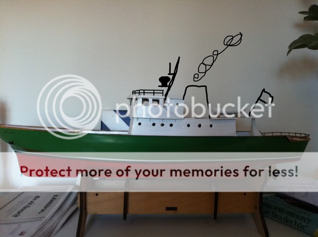

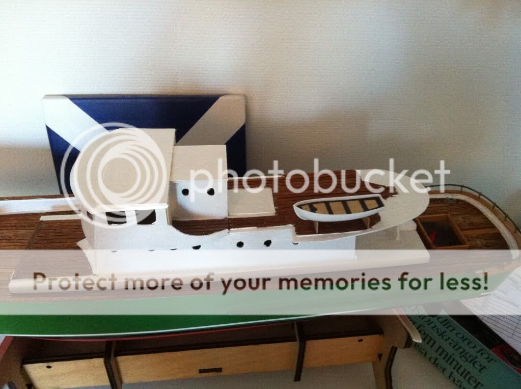

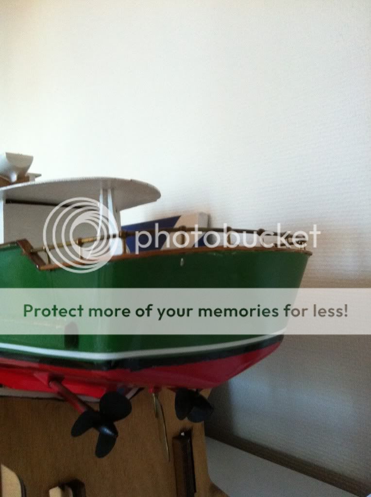

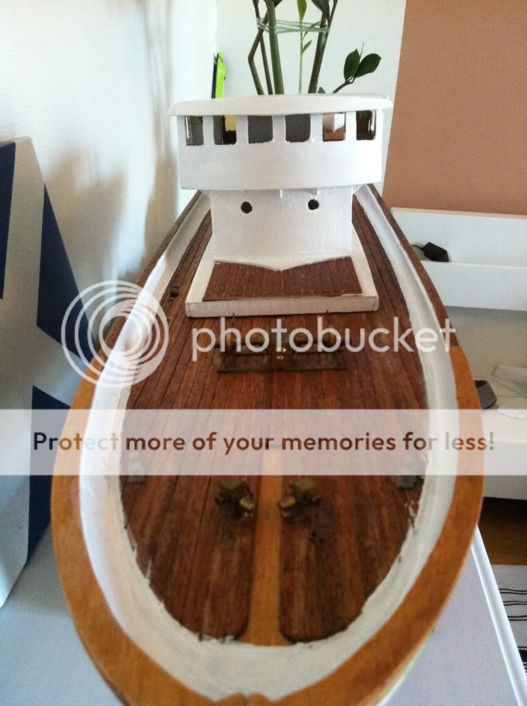

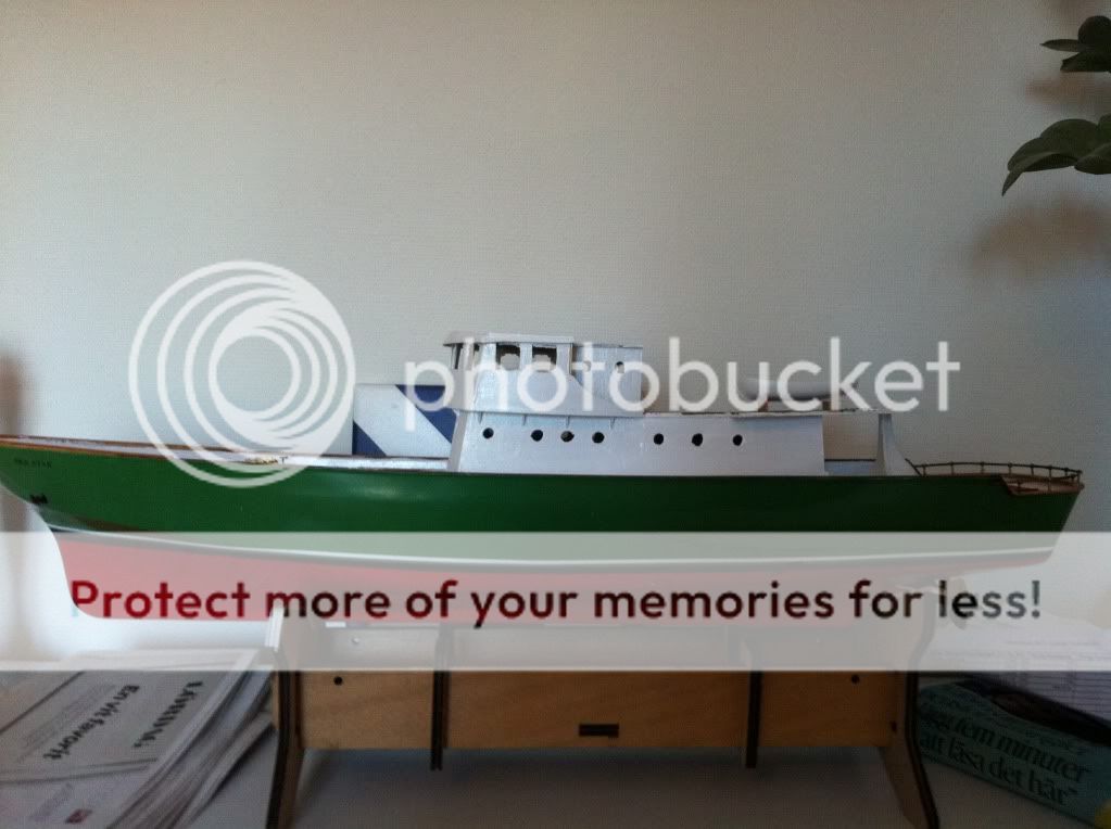

Hi there,
Brand new Scaleboat builder has arrived. As you can see that some areas on this boat are empty. I have been thinking and looking arround for suggestions to fill the empty spaces with something, but I dont know what or where to find webshops etc.
Pls help me to find radars, mast, chimney etc that would be suitable for this boat.
I have also bought this:
LED kit
Port&starboard LED
2 x Graupner Speed 400 engines.
But as I said, need to fill up the spaces on roff etc.
THX
Jamie

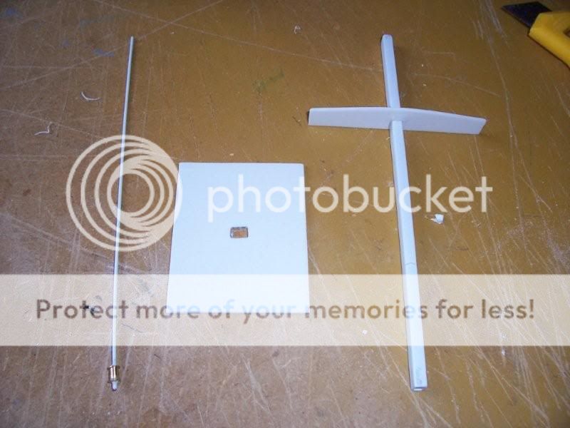

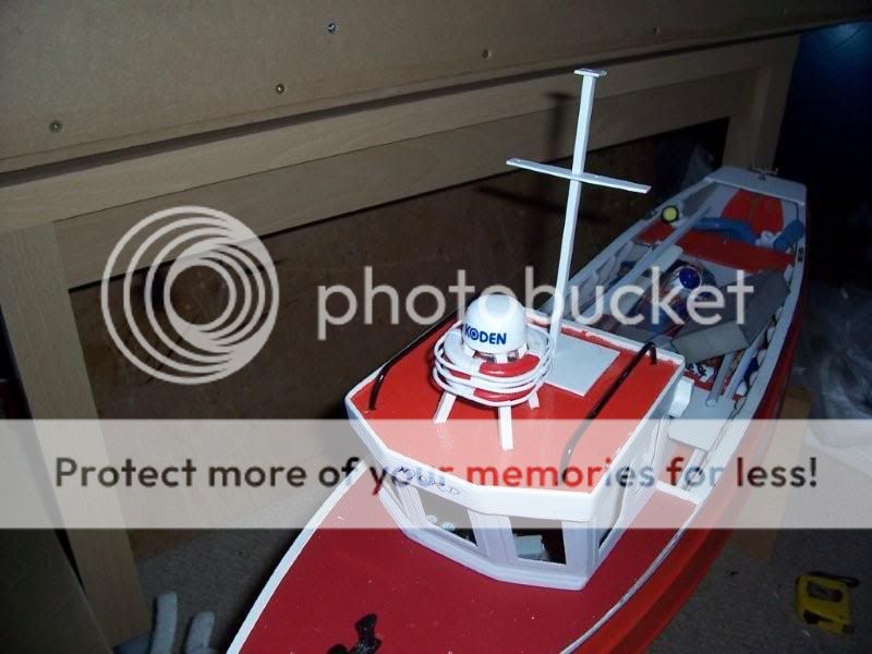

I am looking for a mast and chimney at first, very difficult to find.
Thinking of this kind of setup:
Old 03-05-2012, 08:41 AM
Rich404
Rich404's Avatar
Join Date: Jan 2007
Location: Frisco Texas NY
Posts: 2,446
Default RE: Sea Star
ORIGINAL: Jamiecroc
It will probably be best to scratch build the mast & funnel. This way you can better control the scale size to look natural on the ship.

Hi Rich, I have never done that before and I highly recommend that I dont even try. I will look around, must be somewhere

I have a Graupner Kit Neptune Mast and Chimney I found, could they fit?

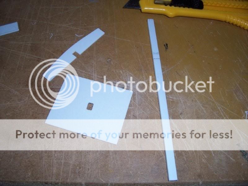

This looks simple:

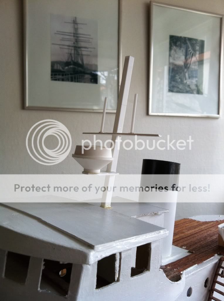

Getting there

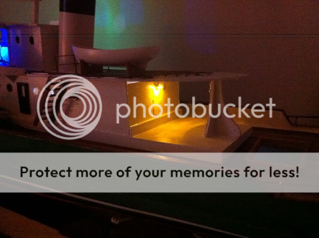

That sounds interseting, but this is at Trawler Yacht and I am looking for soffas, benches. Everthing that is suitable for this kind of vessel. I am also having problems finding a way to power on/off LED light using the Control, I am using a 3 channel Futaba and what to be able to use this control for functions. Or is there another solution? what kind of power source is needed to power all 8-12 LED light and led stripes?

Can I use 12v motorbike battery??
Old 03-18-2012, 08:10 AM
Apismelifera
Apismelifera's Avatar
Join Date: Oct 2008
Location: Schenectady, NY
Posts: 188
Use a 12 volt Sealed Lead Acid battery or SLA. Motorbike batteries have liquid electrolyte which will do a lot of damage inside a small enclosed space like a model boat if the battery tips enough some of the acid will come out.. There's no place for it to go except to stay inside the boat, which is bad. An SLA can be operated or charged in any position. In an SLA the electrolyte is contained in either a gel or in a fiberglass mat so it will not leak out unless the battery becomes physicall damaged.
Old 03-18-2012, 09:01 AM
rctugger
My Feedback: (7)
Join Date: Mar 2009
Location: Sebastian, FL
Posts: 65
for your on and off for the lites, use a Demension Engineering latching relay made to plug into your 3rd channel. Then its one psuh to turn it on and then the next push of channel 3 turns it off....assuming a pistol grip controler. If it is a stick arrangement xmtr then the relay just changes position with each movement of channel 3.

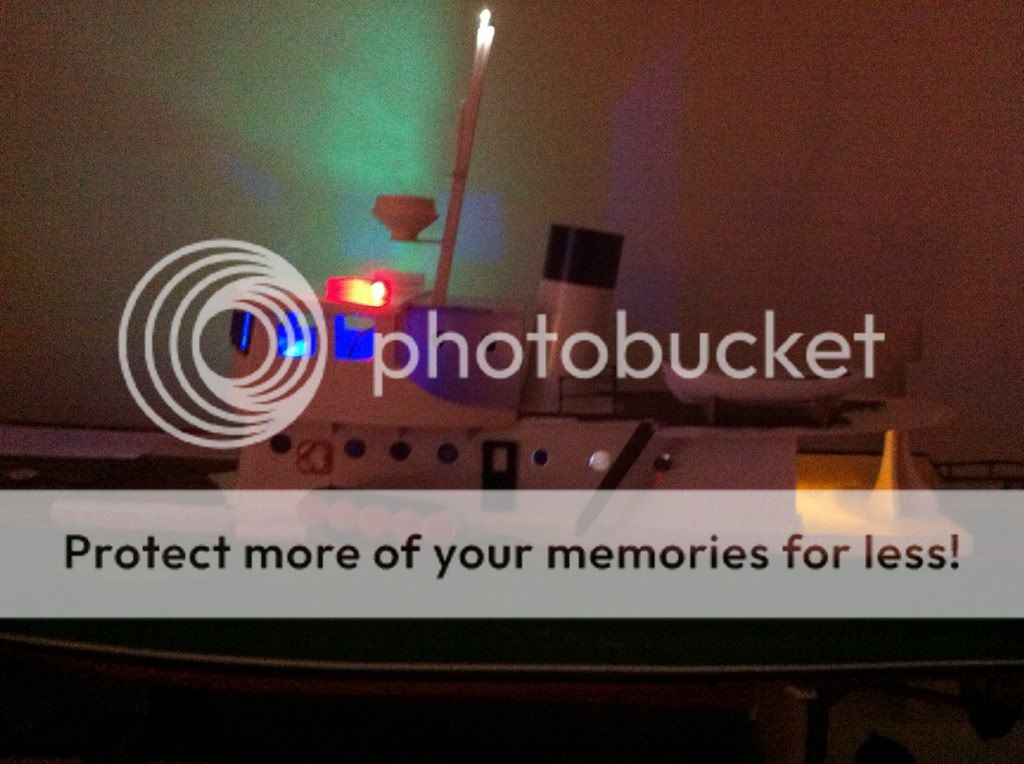

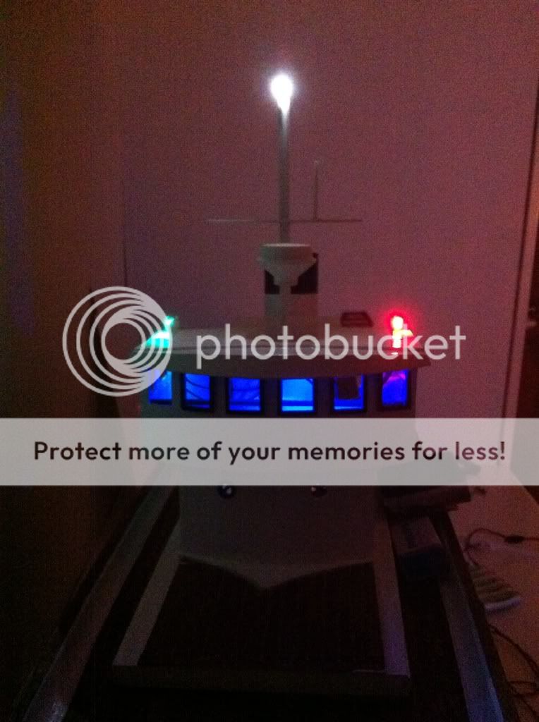

An update of todays LED:
