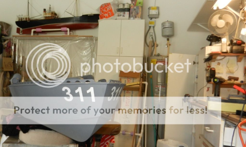

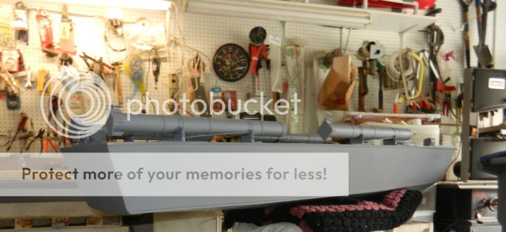

Guys!
Just acquired this beauty from SpaceShuttle1 on Sunday. Like to thank SpaceShuttle1 for this opportunity to have my very first boat Project and can't wait to finish all that needs to place this large lady in the water with "SCALE" effects so, I am not looking to break any speed records.
Any assistance with Links on where to select motor / ESC's would be greatly appreciated.
Here are some pictures of the PT-311 in my Living Room.

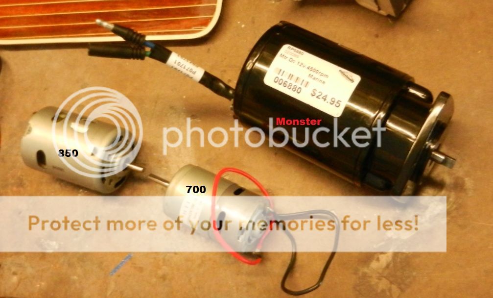

Hi Gaupoman,
For motors Ibelieve three Graupner 700's (one per shaft) would be fine to get that big girl up on plane and movin' nicely. The 700's are priced nicely for what they do.
The ultimate motors for that boat would be three Astroflight 25 motors but recently their prices skyrocketed making them unattractive to most modelers.
For speed controls look at Harbor models and findthem with at least 30 AMPS and go from there. Because you need three motors there are variations you can do as far as speed controls go. I would use at least two speed controls for the motors but one per motor would be best.
Here is the harbor models site for speed controls but there are other suppliers that offer good speed controls. http://www.harbormodels.com/site08/m...d_controls.htm

Rich, Thanks for that recommendation using ASTRO Flight Brushed motors! I have several including an ASTRO 60 direct drive and other 25 sizes. What I need to see is how to provide cooling for these types and I have been looking into Trolling Motors such that I do not want to drill any holes into that perfect looking Hull. I was brain storming a bracket to install a 30lbs. thrust Trolling motor.

If you have Astroflight 25's then just use them. If you go with Astroflight or a trolling motor either way you have to cut into the hull so why not make it scale?
Watercooling the boat is easy but it requires you cutting into the hull too.

Guys,
Mark another good friend and who has lots of Boat experience as well (Setup and Running) and not particularly modeling or Boat Building gave me a Monster Trolling motor that puts out 30-lbs. of thrust on 12-Volts. It is not pretty but, I was pleasantly surprised on the amount of water it displaced in a large laundry container!!! Mark will be making me a custom aluminum bracket and angle mount to install this large monster Trolling motor assembly. Recall that I want a scale speed so, I just could not justify the amount of $$$ for scale motor and output shaft installation with expensive Brushless motors and Brushless ESC's etc...etc....etc......
Mark will be assisting me with the boat Center-Of-Gravity (1/3 from the Stern as I understand) and other items including installing the Aluminum Bracket and mounting of the Trolling motor.
Many of you might be throwing up but, no one will be seeing the Trolling motor while the boat is in the water nor I believe they would care unless they are some of a few like those that frequent here and are scale modelers.
Here are some pictures:
Mark,
Here are the measurements
The straight line angle sides at the bottom is 6.5 inches and 2.5 Inches. (Calculate the angle )

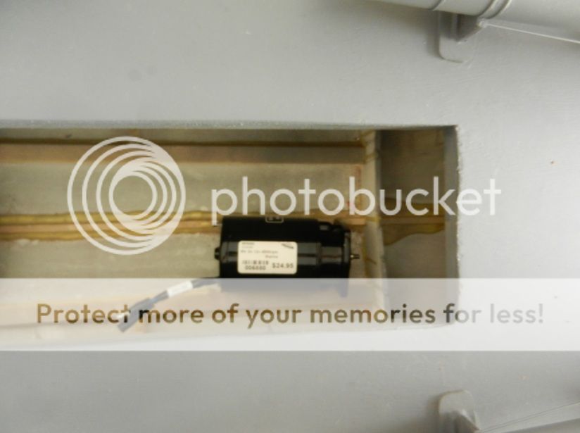

I have decided that this model is just too nice of a scale look to use the Trolling Motor with a similar Out-Board Motor look.
1. The Propeller is so large that I would need to seek out the model for Launch and Landing as it will run a-ground due to the large propeller.
2. The modification for some sort of mechanical device to lift the Trolling motor to avoid (1.) would be just too labor intensive and perhaps costly.
3. The boat's appearance will not be scale in any manner.
Summary:
Since I am not looking for fast speeds the setup inside the HULL would be ideal since I am not looking for any demanding power.
NEW PLAN:
A few pictures of what I found at the Electronic Shop Surplus Store and the Monster Motor is Brand New!
3 inch Diameter
6 inches Long Shaft (Tip to Tip)
4500 RPMs @ 12 Volts
8mm Output Shaft
The people at the Surplus Store was able to connect the motor and test it and it ran super quiet and smooth. It measured:
12 Volts @ 6.5 AMPS, NO LOAD
Pictures:
It still looks small inside the HULL

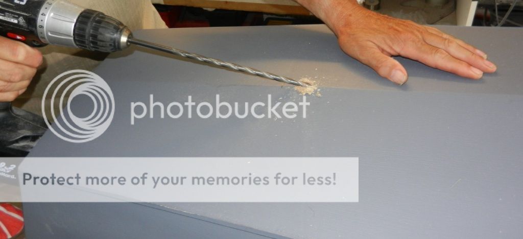

It was fantastic weather conditions (Cooler) and I took advantage of Tony Lombardo's very nice invitation to his home and home cooked meals from his wonderful wife and spent all weekend with Tony showing me the ropes of RC BOAT Modeling.
This weekend we did the Stuffing Tube hardware purchases at ACE HARDWARE (The best ACE is in Titusville, Florida ) and we were able to get all hardware that we needed.
The Tubes were cut to length after careful measurements were performed on the Hull and outside. Then the Stuffing Tubes were integrated (two different sizes sliding into another larger diameter) and to keep em put, some soldering was performed.
So far it is looking great!

We are going to try out this Old yet still running motor in the PT311 and watch what happens. Again, I am looking for scale cruise and nothing with speed so, I will test the PT311 RC Boat model with this motor and test it's ability for Current, Voltage Measurements and temperature.
I looked high and low and seems like there is no official information from Emerson-Electric on this motor anymore except to say that the Product Plate shows:
Emerson-Electric
Frame: D268W
Style: 174 0212
HP: 1/6
AMPs: 20
Volts: 12
RPM: 3800
TEMP: 75C
Duty: INT
St. Luis, MO
A few pictures:

Early morning progress allowed the completion of the Stuffing Tube and I was allowed the honors of injecting the Lithium Grease into the 90 Degree tube to insert the Grease and the motor ran much quieter and the RPMs ran up.
A few Pictures of this morning's Progress.
