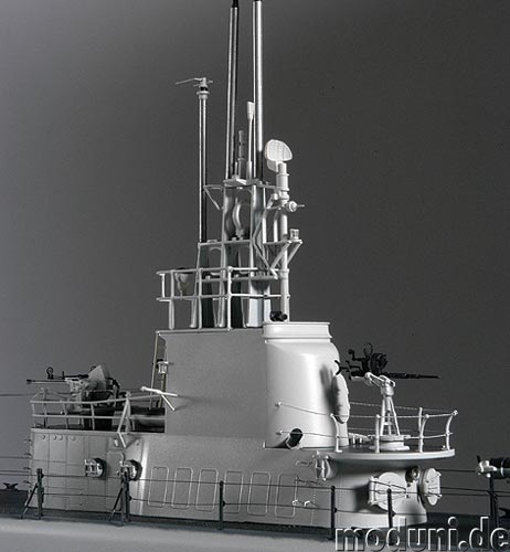

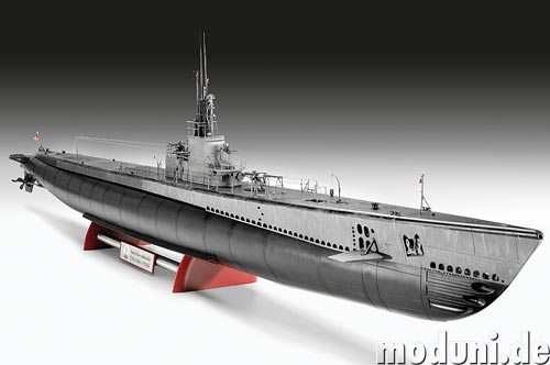

You could get the larger 1:72 Gato from Revell
1320cm or 52" long.

Oh, that is a magnificent Gato. Just beautiful. Stunning.
And my three-year-old would lay one curious hand on it, smashing those exquisitely-detailed conning-tower railings to matchsticks, and I would faint ! It'll be nukes without much gear topside for my modeling efforts.

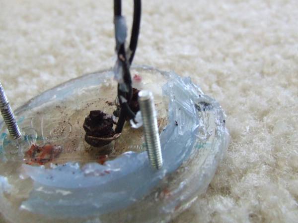

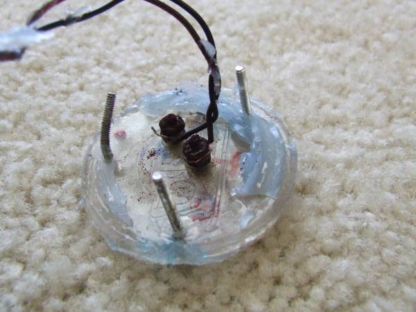

By the way, for those browsing who've thought about building but are still compiling their mental list of do and don't...here's a don't, in materials: I used zinc for electrical connectors.
See the bolt in the foreground, first photo from the inner side of the battery-box lid? Nice and shiny.
The nuts behind it, connected to the wire, had the same sheen 24 hours ago, before their first exposure to a water leak. Blecch!

They shouldn't...
But just in case, always grease them well and install a Schrader valve on your WTC cap, before going to sea, pump in air with a bicycle pump to pressurize the container. This prevents the water pressure from accidentally overcoming your seals, just in case you go deep.

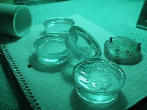

Captain, thanks once again. Pressure in the boat !
I rethought my end caps and this was a great weekend for watertightness. The prop shaft has a snug fit but spins freely.
