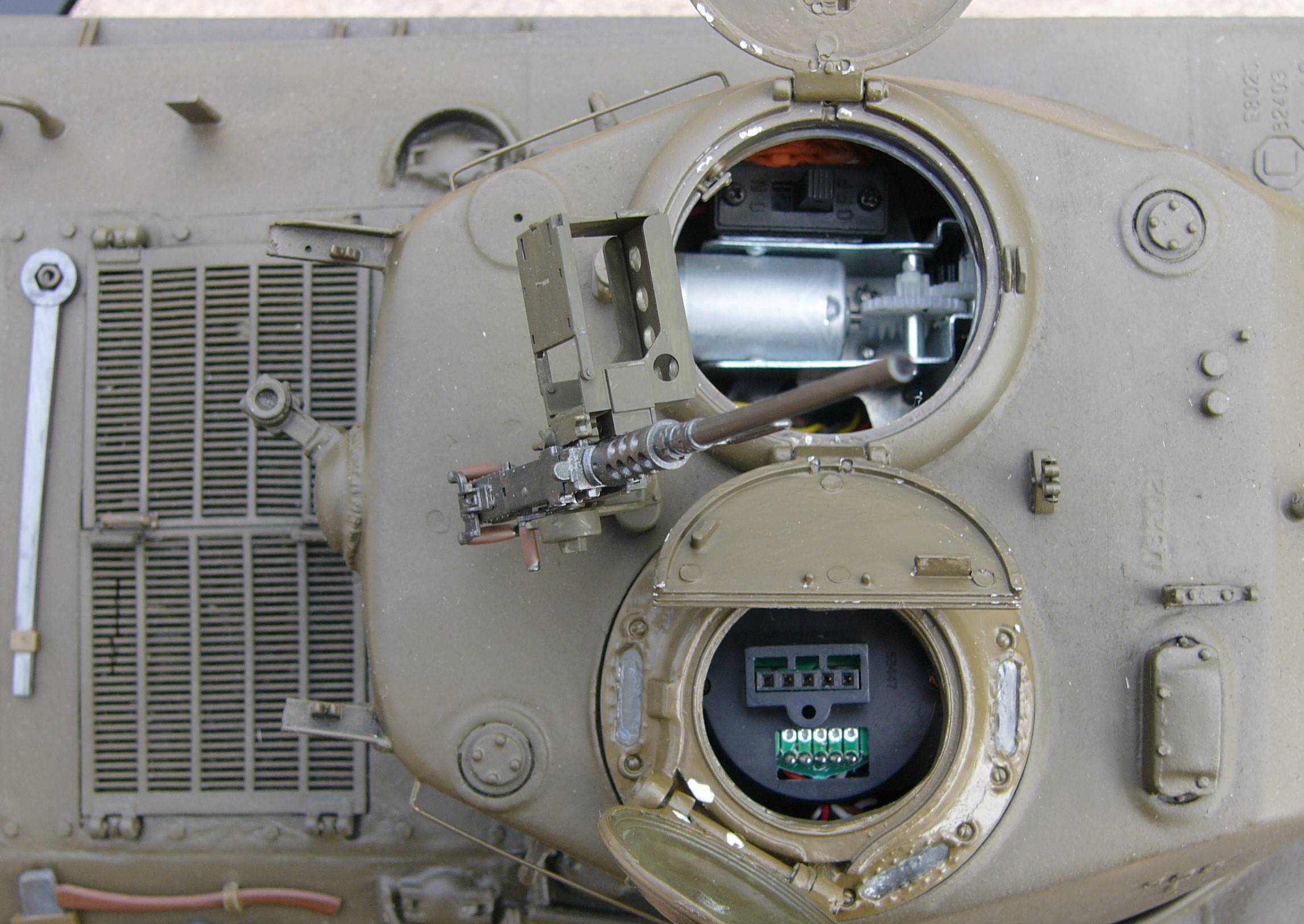

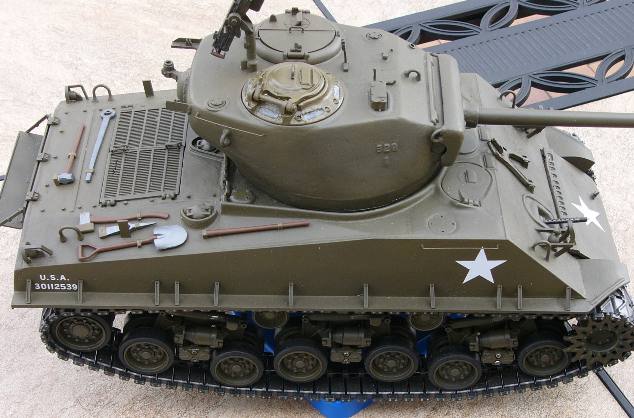

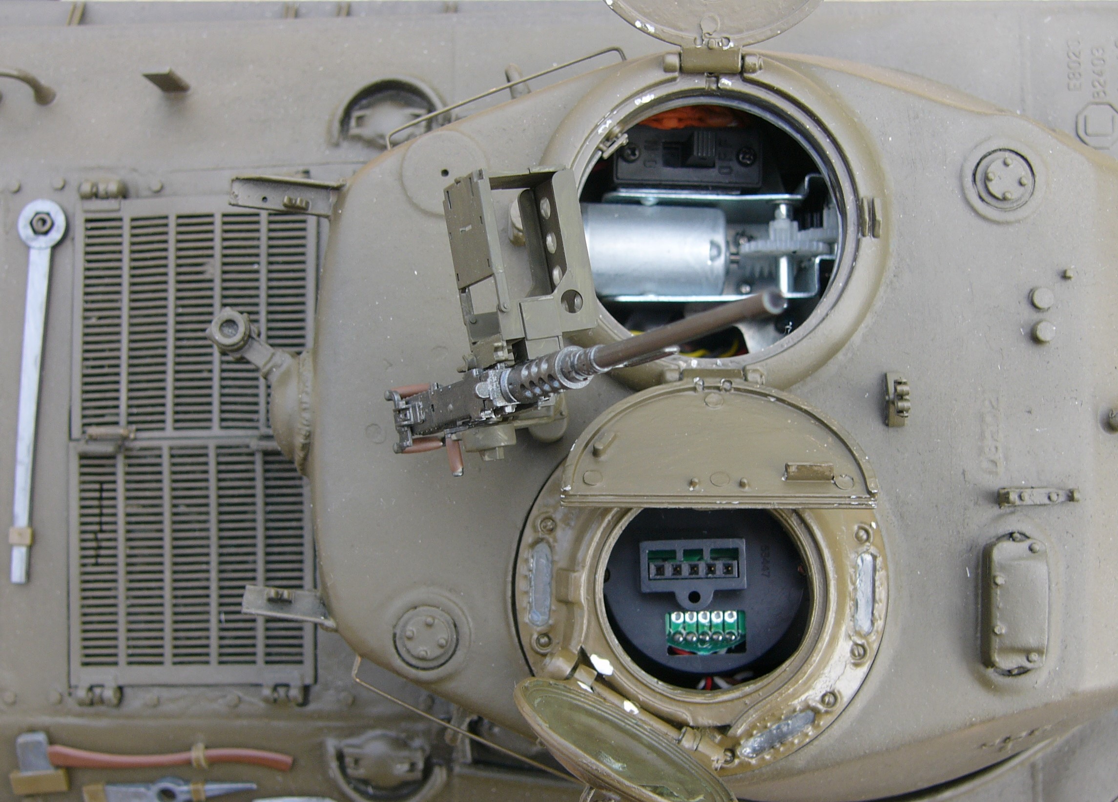

I picked up this Tamiya FO Sherman with the Nick Aguilar Easy 8 conversion set last March. The original owner had pieced it together, but gave up on the project. I gave it a complete strip down and re-build.
Nick was nice enough to help me out with a few missing parts, (twice), Thanks Nick. I also upgraded the idler mount and gearbox mount with parts supplied by Daryl Turner, Thanks Daryl. I used Crystal Clear to reproduce the glass in the commander’s copula. The split hatch is from Mato and works like a charm – I should have mounted the TBU there, but it came to the project as an afterthought. I will run this tank with the commander’s hatch off, just in case of a roll over. The TBU emitter is mounted in the gun mantlet, thanks to Bob the Commander for help with that. Lastly, thanks to Rich Johnson for the inspiration for this build, my DIDI is not close to what you have done, but it works for me..
I finally got my turret rotation problems put to bed. Got the first few coats of paint down, and added a few decals – before I get to dull coat I wanted to share some photos with you guys. I’m not happy with the commander’s copula, the paint dried very glossy, hopefully when I clear coat it will flatten out. Still have to add stowage and weathering. My only regret so far is no gun recoil, but that project can want for another day..

Thanks Rich,
I'll keep an eye on the emitter to see if i'm getting any interference. No recoil now, but its on the drawing board. I used Microscale Kristal Klear for the glass.
http://www.microscale.com/Merchant2/merchant.mvc?Screen=PROD&Product_Code=MI-9
They say its for windows up to 1/4 inch. The product goes on like paint, so you can drop a bit in one corner and "pull" it across with the paint brush, it will form a cloudy film and dry clear.
