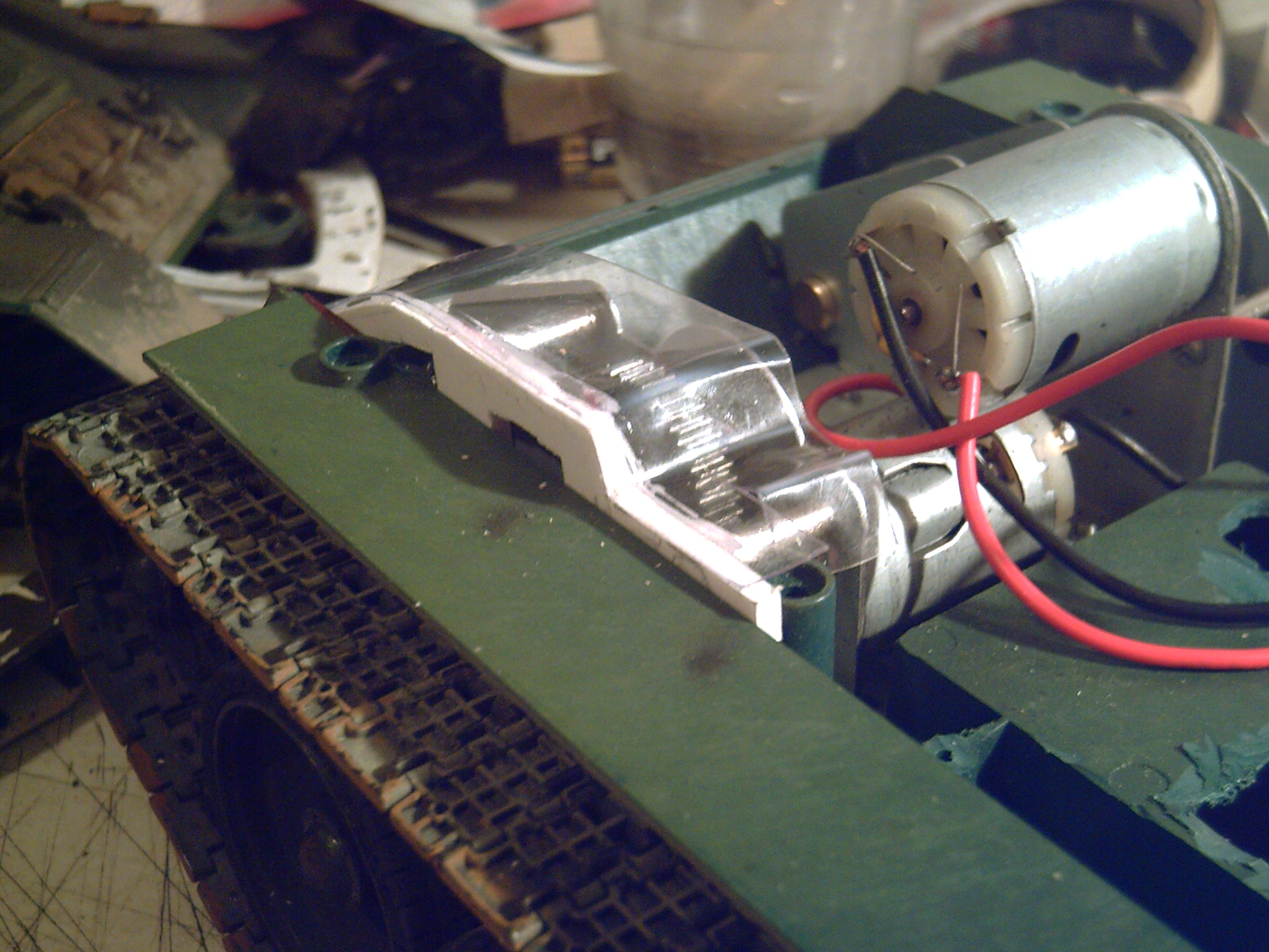

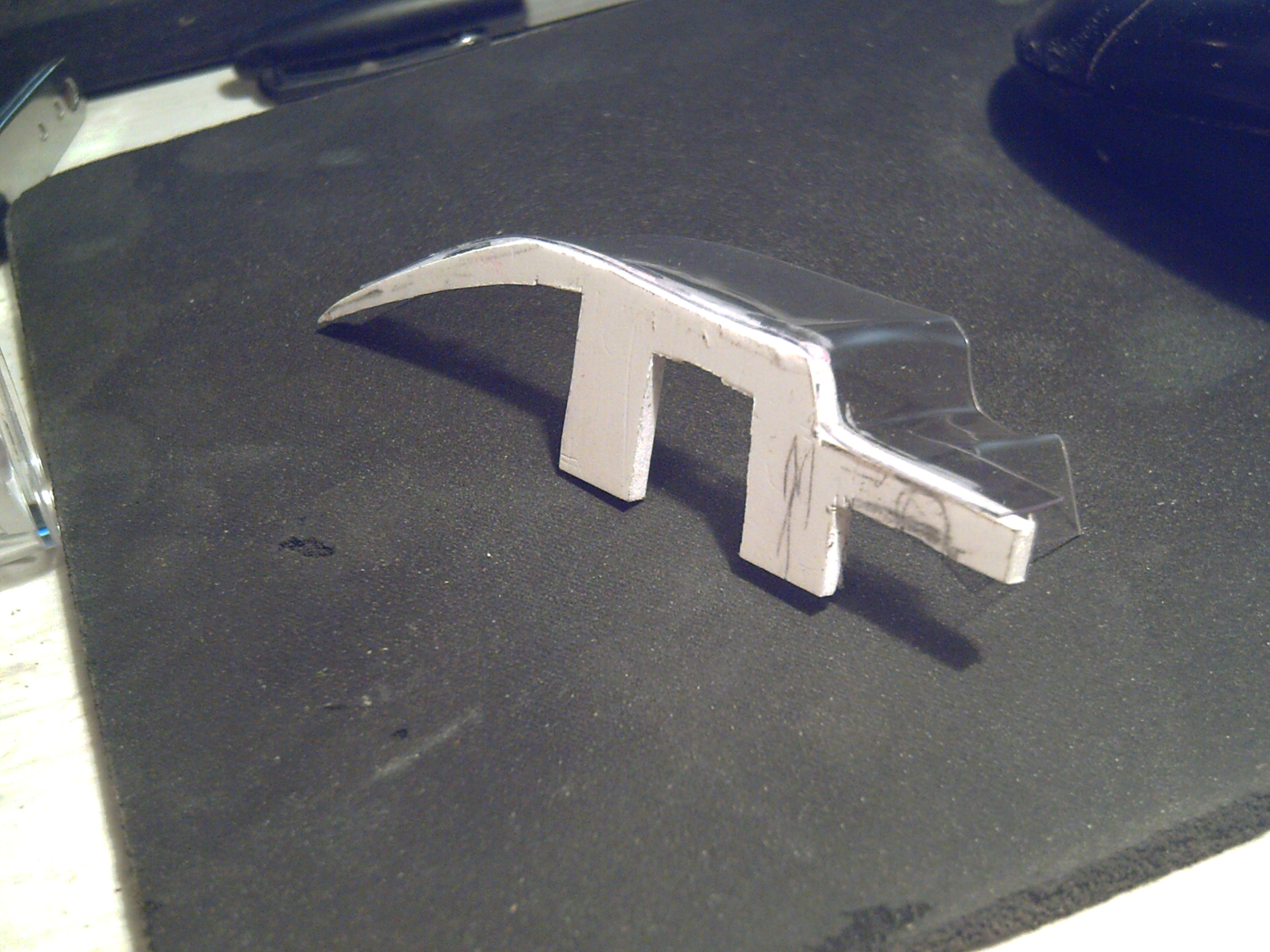

I strongly support the use of an oil that has a high temp rating and will not attack plastic.
If you can handle it, make a cover for the gearbox assembly to keep dirt and other debris off PLUS, install some sponge material at the axle hole and poke the axle shaft through it. This keep dirt from entering at that area.
Remember, grease will attract dirt and is more difficult to clean off than oil, so oiling periodically is better than one application with grease which is more suited for roadwheels and idlers where it's a sealed system.

The 'cover' over the gearbox? It's just a thin sheet of Plastruct styrene I bent and cut as a template... I have brass sheets I will use as the final material (might look better?) with weather striping foam around the edges to help seal.
Jeff

Well, I don't know how Evergreen sheets of styrene are (only have that in strips and tubes) but Plastruct sheet is bendable up to a certain thickness. Most of your typical injected molded/slide molded styrene from plastic model kits is kinda fragile. This stuff is not.
Besides... there are members here that have build covers for their gearbox assemblies out of aluminum and they look so much better than this rather crude example, but it is very effective!

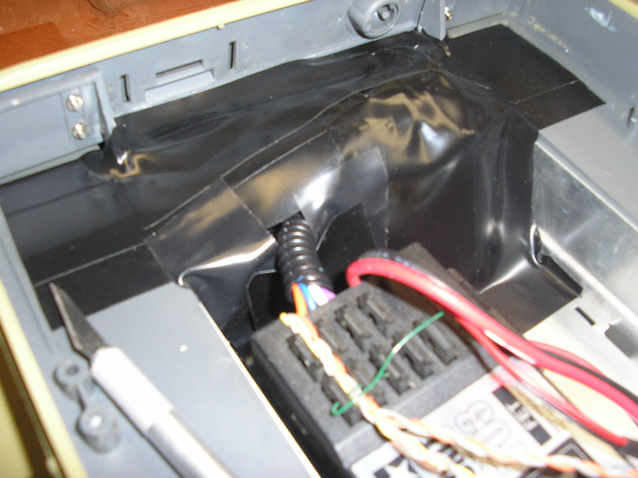

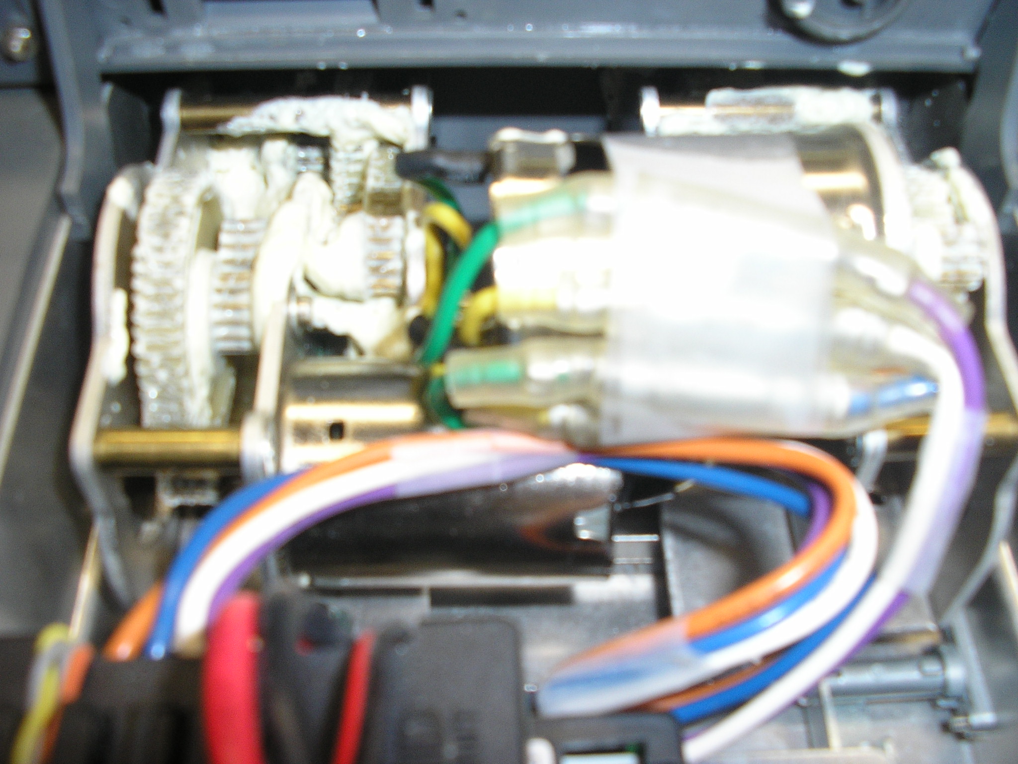

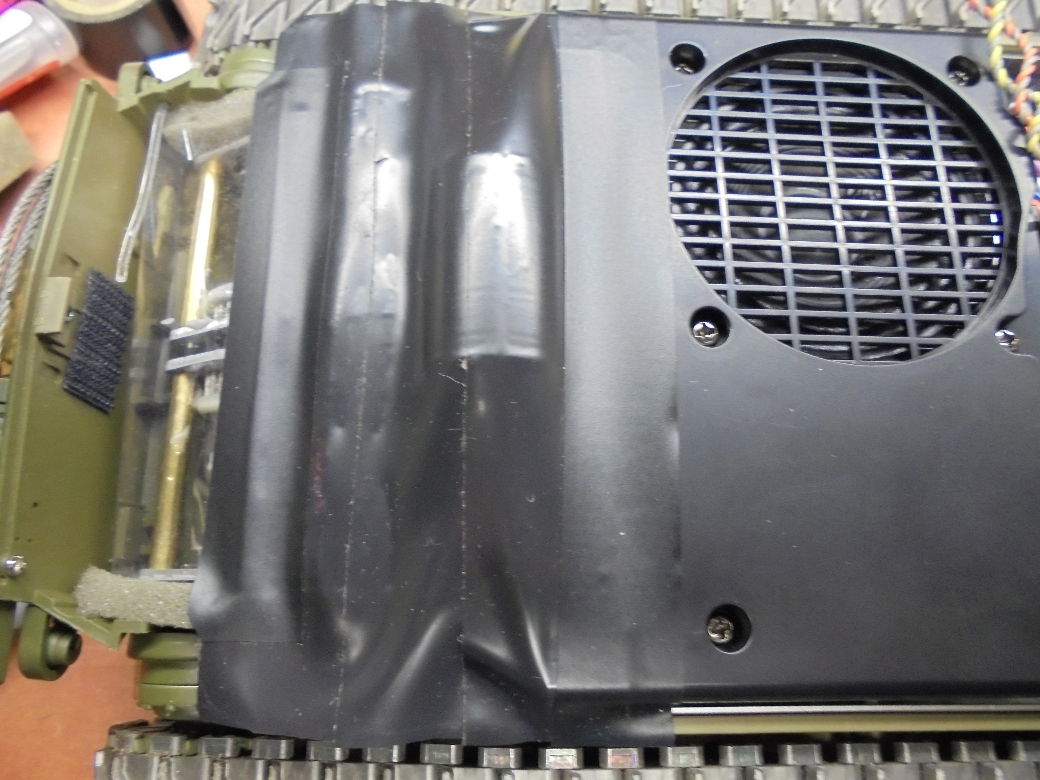

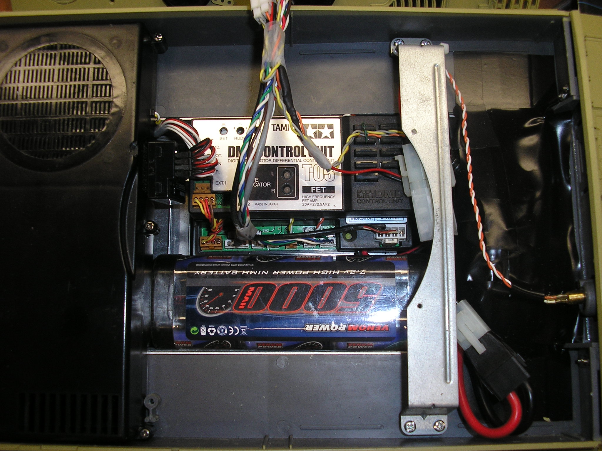

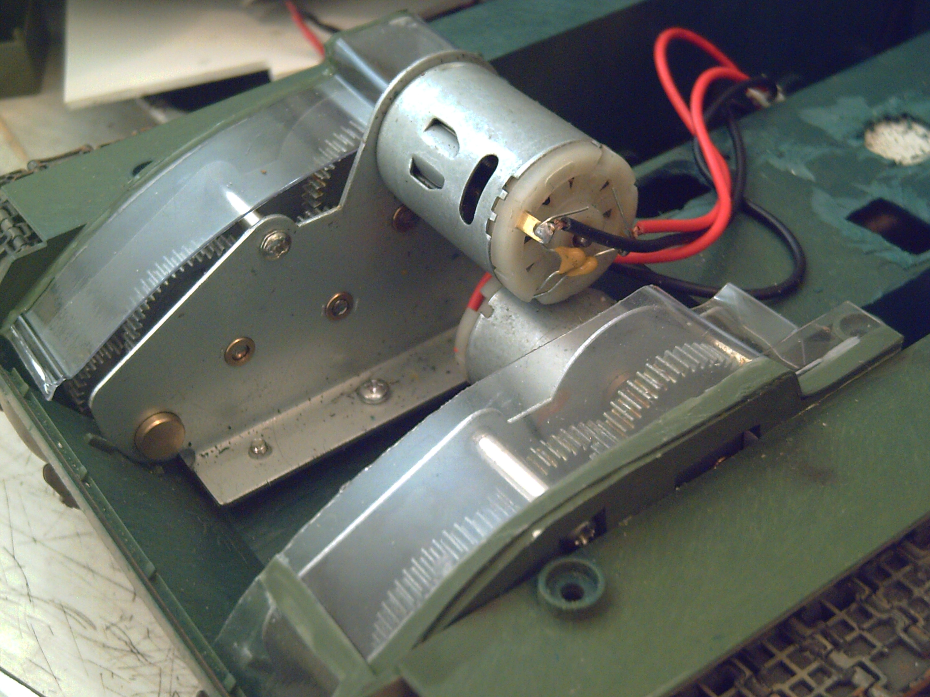

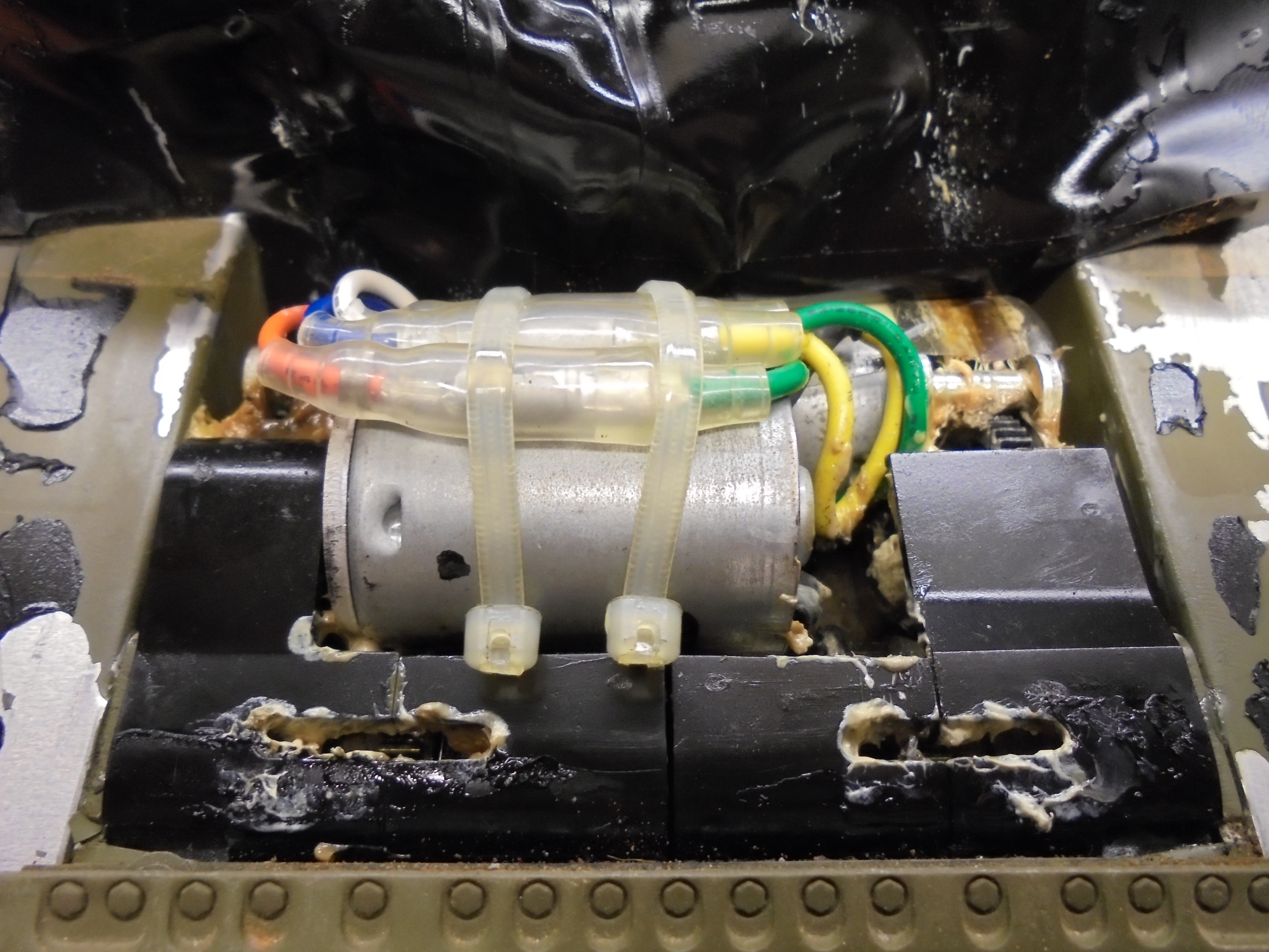

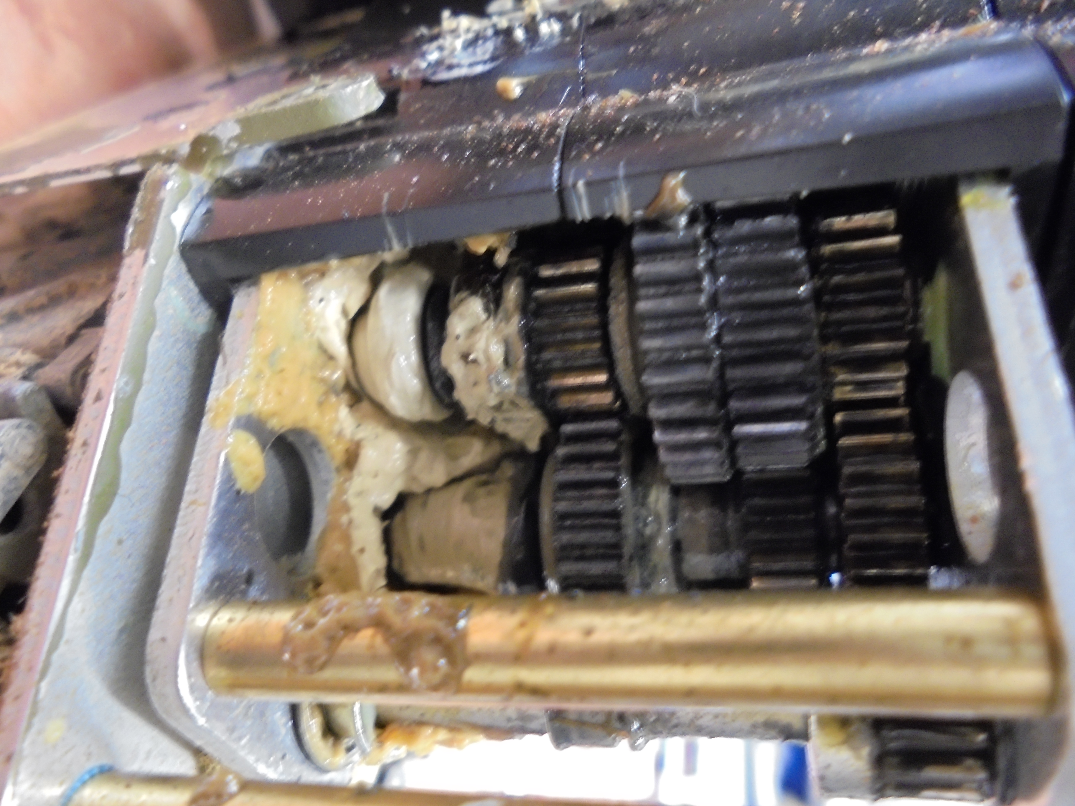

This is the best investment of PM (preventative maintenance) you can do for your tank.
It is not just one "greasing" step. All gearboxes need to be oiled, lubed and covered for proper preventative maintenance. On a used tank it is 1) Clean, 2) apply machine oil, then 3) grease/lube. The first step is to peel back my TU/gearbox cover and remove the dark old grease. Use no solvents or wire brushes. Use Q-Tips and gun cleaning patches (Hoppes)/small rags on tweezers. Clean them thoroughly at least once a year. Then use a fine machine oil (never WD40) to oil the shafts and bearings. Singer sewing machine oil is my favorite. It has good capillary action to get under the gears where grease will not. Several drops on the shafts near each gear and the end bearing/bushings. Then turn the tracks by hand (DO NOT RUN THE MOTORS...FIRE HAZZARD) to work in the oil. Then spray in (if you have aerosol can with long red applicator tip) or brush in, white lithium grease on the faces of all the gears. The white lith. grease grows darker with age & use. Then turn the motors by hand to work in the grease evenly. DO NOT RUN THE MOTORS. Then reinstall the TU covers adding extra or new tape where needed. I try in incorporate a clear piece of plastic into each TU cover whenever possible. That allows for a quick inspection without removing the TU covers. Jeff and I both seal the TUs at the out-put shafts with foam whenever possible.
Be sure the motor & other wires are neat and safely out of the way from rubbing or shorting out. If I build it they should be very secure...but things move sometimes. This should be done once or twice a year dependent upon use. Add extra grease before each battle. The large plastic gears spin fast and are under low stress/torque so they are made of plastic. The middle/intermediate gears and under more stress but rotate slower so they are made of brass. The final gear on the out-put shaft is hi stress/torque but very slow speed so it is made of iron/steel. All need BOTH oil (shafts & bushings) and grease (gear faces).
Here are some pix for your reference Shannon. The first 4 pix may be of your tank when I prepped it for you last year.
Tamiya Tiger I
Tamiya KV 1 Out-put shafts seal:
Hooben Elefant:
Tamiya Sherman:
Taigen Tiger I:
H L Stug/Pzr IV converted to Tamiya IR:
Tamiya Pershing:
Tamiya Panther:

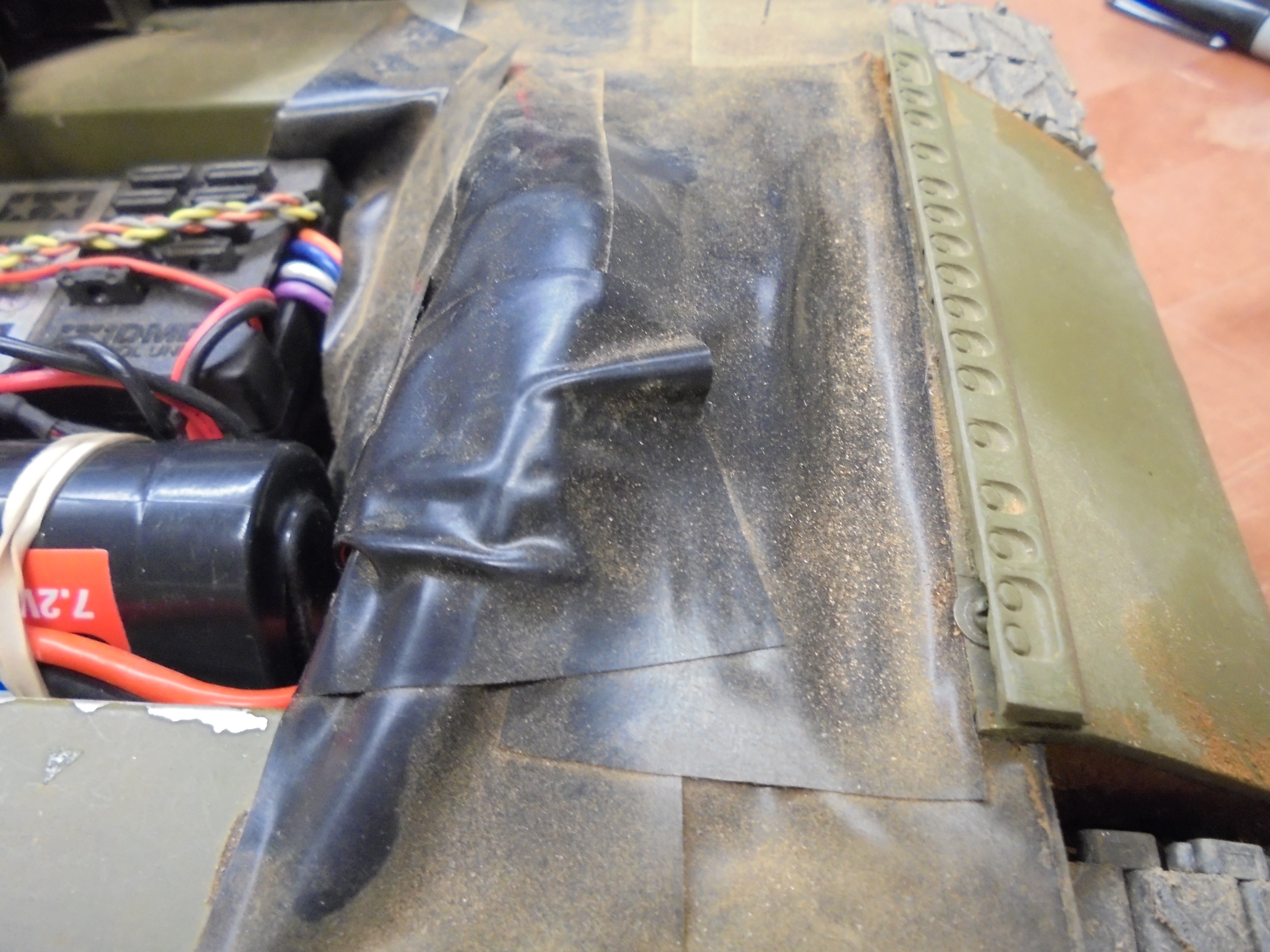

Here is how my Danville loaner M4 Sherman looks after a few months on the battlefield. You can see the accumulation of dust & dirt and how it clings to oily surfaces.
Here my covers have been pulled back and you can see how the dirt has not entered the TUs by the top or thru the out-put shafts seals that I use.
Just clean out some of the old and add some new oil then grease and you will have trouble free TUs for years to come.

The one tip I would heavily emphasize is to NOT over oil the motors. Just a simple drop, pull the shaft in and out, roll the motor over then add one more and then THAT'S IT! Both ends... the pinion and the 'com' end.
I built motors when I slot car raced and this applies here even with can motors is that oil will kill the performance and life of a motor if it gets into the brush area.

I was a mechanic before being a cop and in that 35+ years I've seen how simple PM can be. I cringe every time is see a uncovered RC Tank Gearbox/TU. Or worse... one that is not oiled & greased at all. I know we all rather spend out hard earned dollars on upgrades or new RC.... than buying parts we could have saved from senseless wear & damage. If get your battery wires or DMD motor wires going into a pinion gear and you could ignite a fire. It could even happen while sitting on a shelf or during transport. Super neat wiring like I posted above (AKA... wire hygiene) are yet another way to avoid trouble. A loose screw into a TU or pebble can also destroy them quick.
The PM time is well spent. Jeff is also on target with the over oiling. Soak up any excess oil or prop the far end up of the tank and leave it tilted on a rag overnight to drip off.
Helpful hint: Never grease or oil your turret rings, turret sliders/rollers. The benefit will be brief as the oil will attract dirt & dust and soon do more harm than good. A drop of oil on the elevation or rotation motor pinion gear is good....but do not oil and further.
I personally, weld all my slipper clutch gears solid on Tamiya tanks elevation & traverse units.
The recoils should be lubed on the barrel mount slider trolley, and the brass center bolt.
Tiger..... most other Tamiya recoils....
Oil the recoil reduction gears very lightly on all ... but NOT on the Tiger I. It is all open and best left dry.
The track idler wheels should also be lubed/greased at least once a year (white lithium or Tamiya ceramic is great) or more as needed.

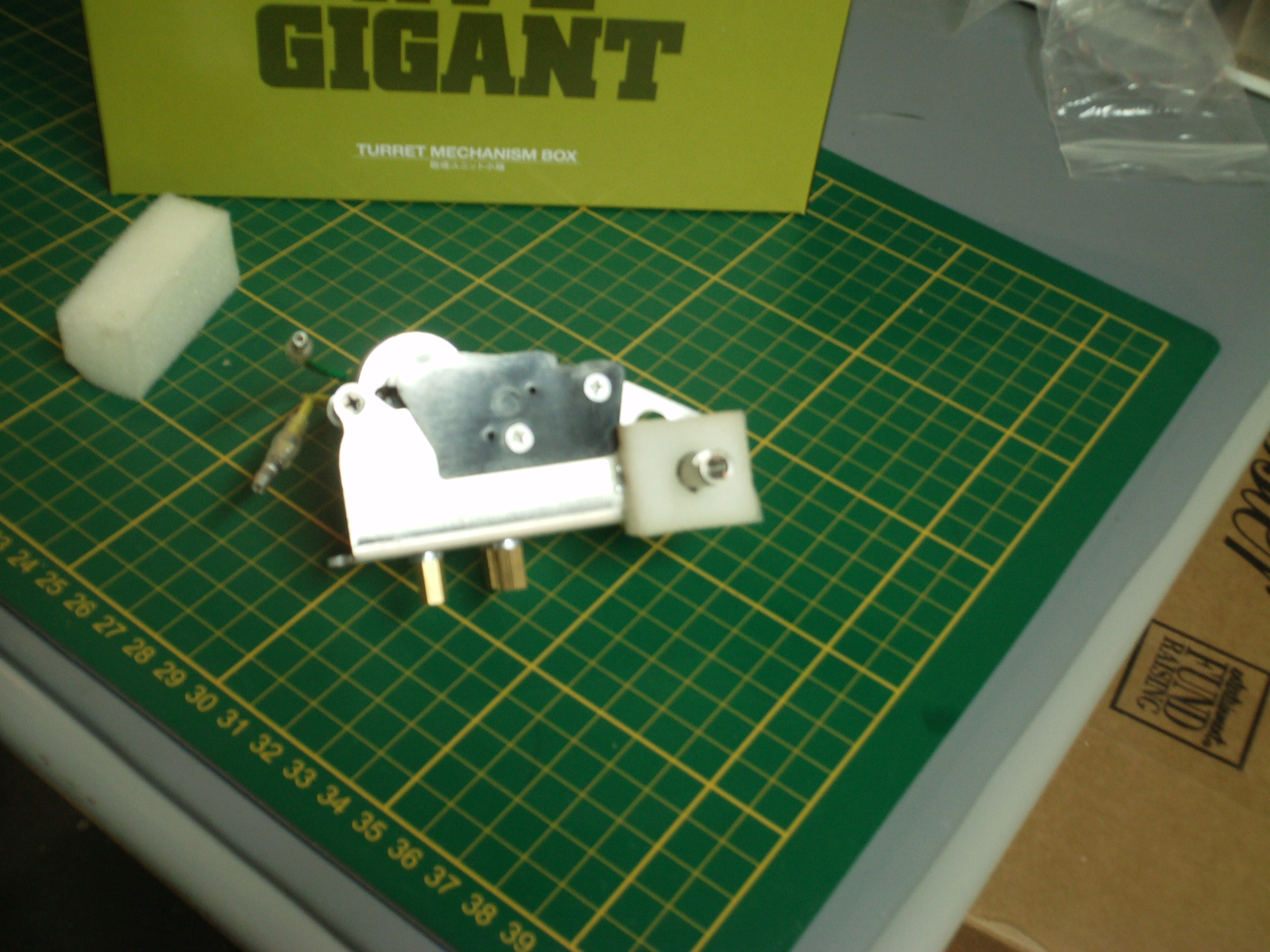

Old 04-15-2016, 07:34 PM
Airbrushler
Airbrushler's Avatar
Join Date: Apr 2011
Location: Windsor, ON, CANADA
Posts: 3,813
Received 15 Likes on 10 Posts

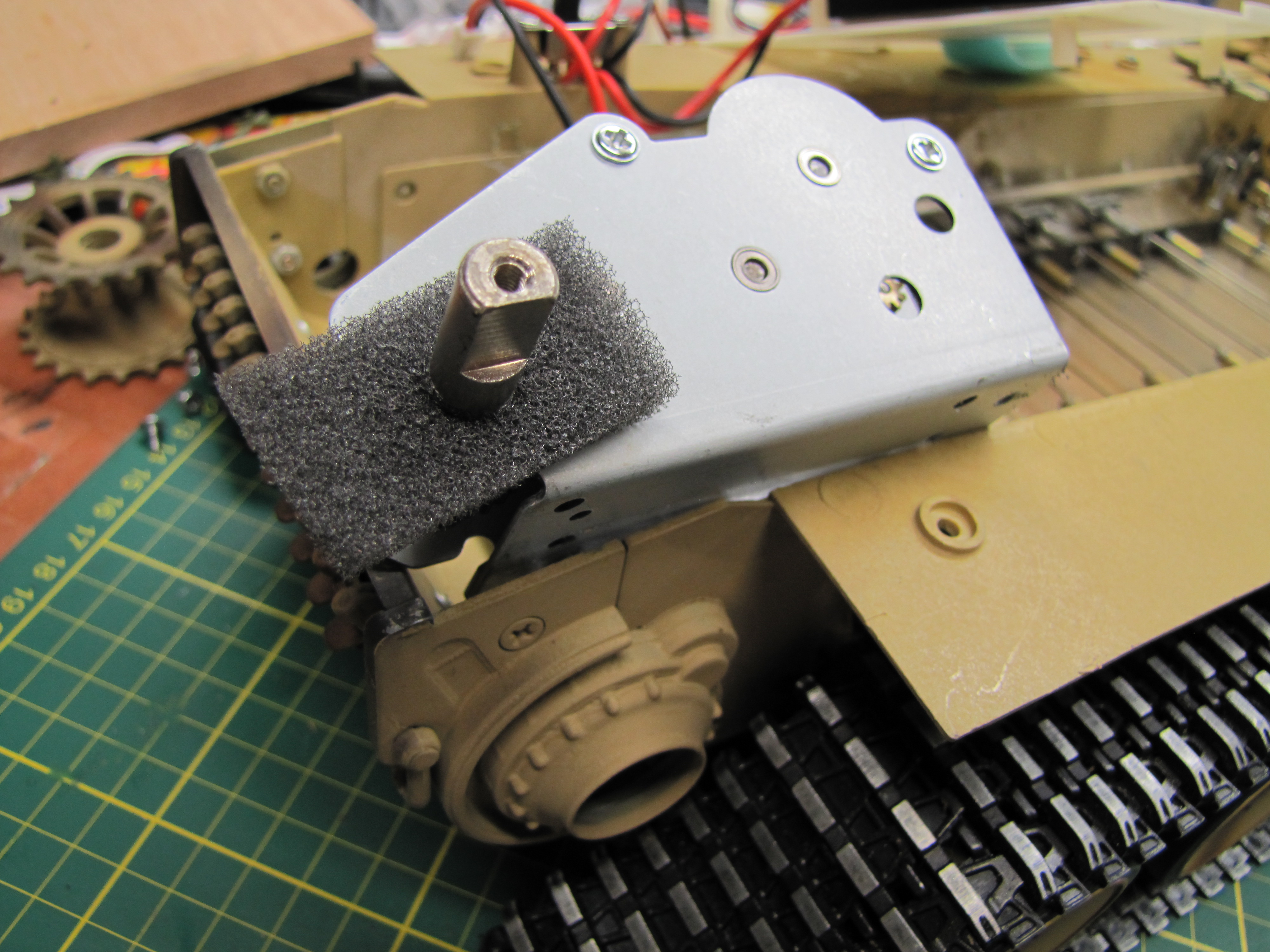

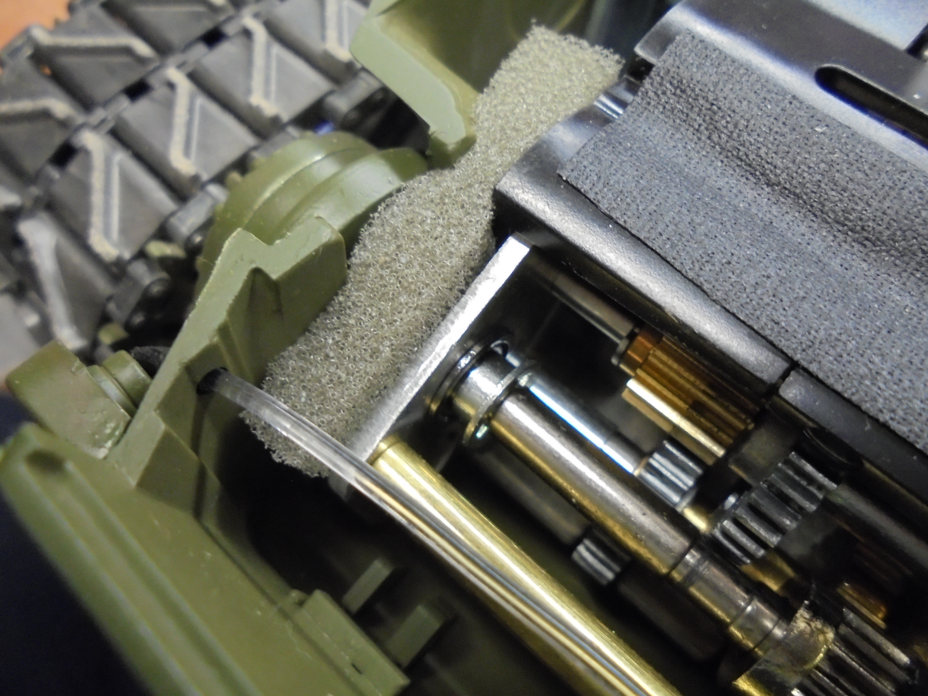

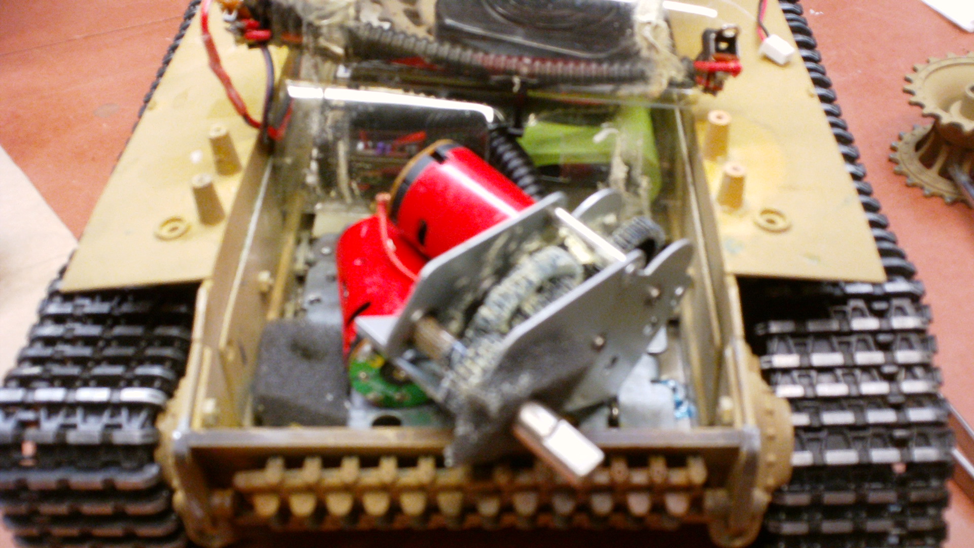

i like the foam installation around the drive shaft never thought of that but i do have some covers on the gearboxes on my T-34

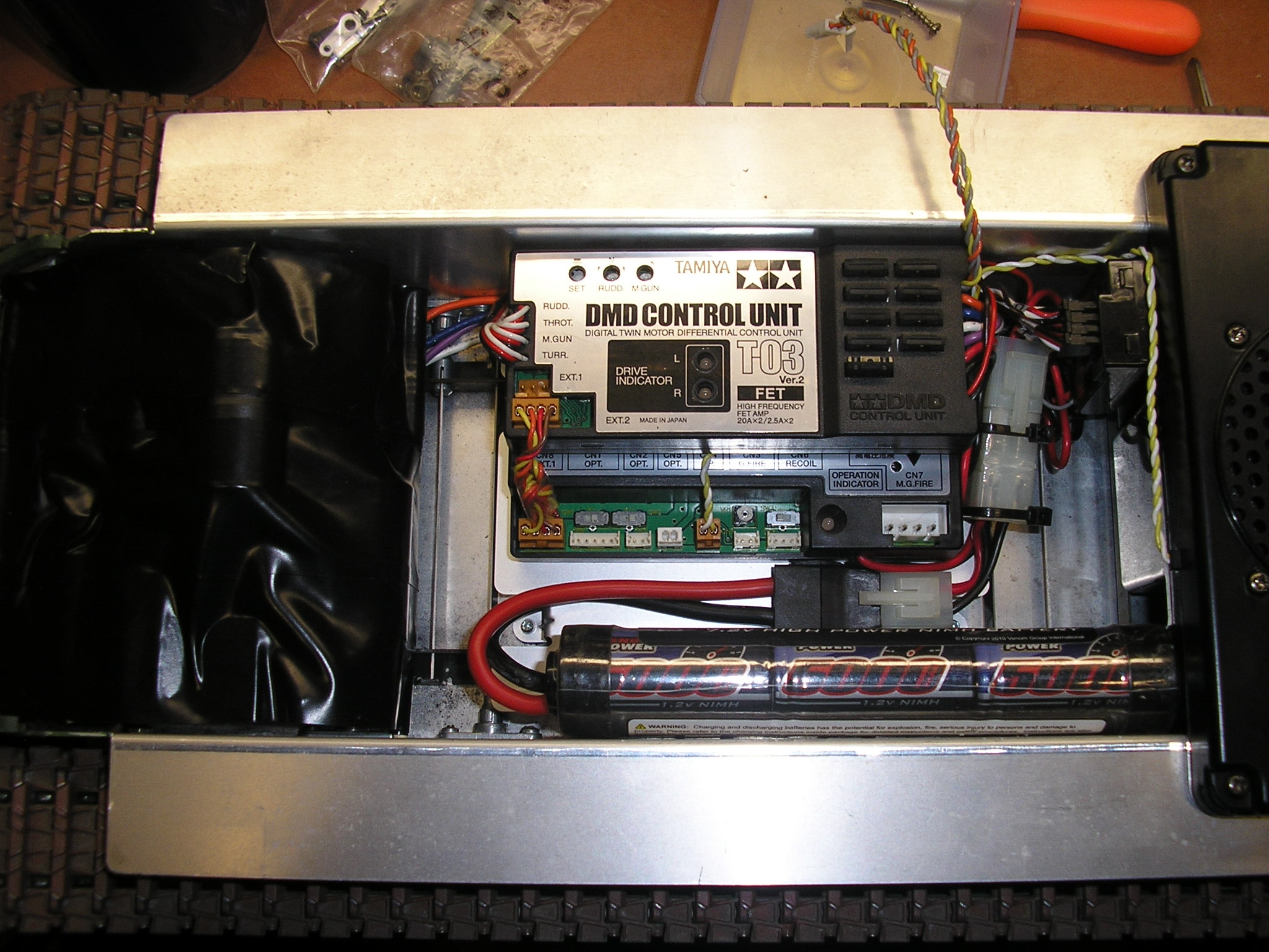

And Bob is right about wiring hygiene because when I see a wad of wiring going all over the place just waiting to get caught up in the turret mechanism or the gearbox I always ask: "Where's the marinara sauce at?", meaning it looks like a bowl of spaghetti.
Here's my Pershing right before replacing the Tamiya connectors:
Like Bob, I spent many of years in electrical troubleshooting & repair, installing customers sound systems and audio enclosures, replacing dashes in $70,000 BMW's, reupholstering 6 piece Recaro seats, fuse box work as well as A/C system analysis and repair, suspension & steering, alignments and brakes. ALL ASE Certified.

I've been sealing them off like that for many years. It is cheap simple and very effective. Make a small hole with a punch, soldering iron or Exacto. Keep it is small as possible too for a tight fit.
It is one thing that I noticed very quickly at Danville. If the field was dry and dusty.... the grit got every where in the tank.
One of the biggest holes in the hull was the out-put shaft at the drive sprocket. The grit didn't effect the electronics and such, but I knew it was a death sentence for the TUs. The guys at NEAD and Danville that did lube well, often had grease thrown about in the tank. Just look at the undersides of the hull on your HLs & Taigens tanks. And that is just grease flung off, not oil.
BRW, I have always liked your clear covers. That way you can assess the lube condition very easily. I always try to incorporate a clear plastic section into my TU covers.

Originally Posted by Panther F
Oh good! Time to get crazy with the styrene. I may leave mine with the white stuff too as I am running out of time to stop and cut brass sheeting although I do think this way will increase any gear noise because now it's more of a box by volume than an individual piece over the gearbox.
Show us your styrene results!
Jeff
I like how neatly you reduced the size of the speaker Jeff. Did you have that Pershing at Danville the last time you came? I just remember your M4 the best.... Oddball"s Sherman. Too cool.,,,LOL. See it in action here at the begining of this crude video. Video: https://www.youtube.com/watch?v=isU_GiH4qFA
A strong mechanical or automotive background is certainly a boost in this hobby.

Originally Posted by philipat
Great write-up for greasing the gearboxes. One question: with the plastic covering the the motors, have you noticed a problem at all with heat or overheating, particularly when driving outside?
No problems at all. Unlike planes, cars and boats,,, we are not running the motors continuously or for long periods. The TU framework and tank aluminum bodies also serve as a heat sink to dissipate heat. Good question!
