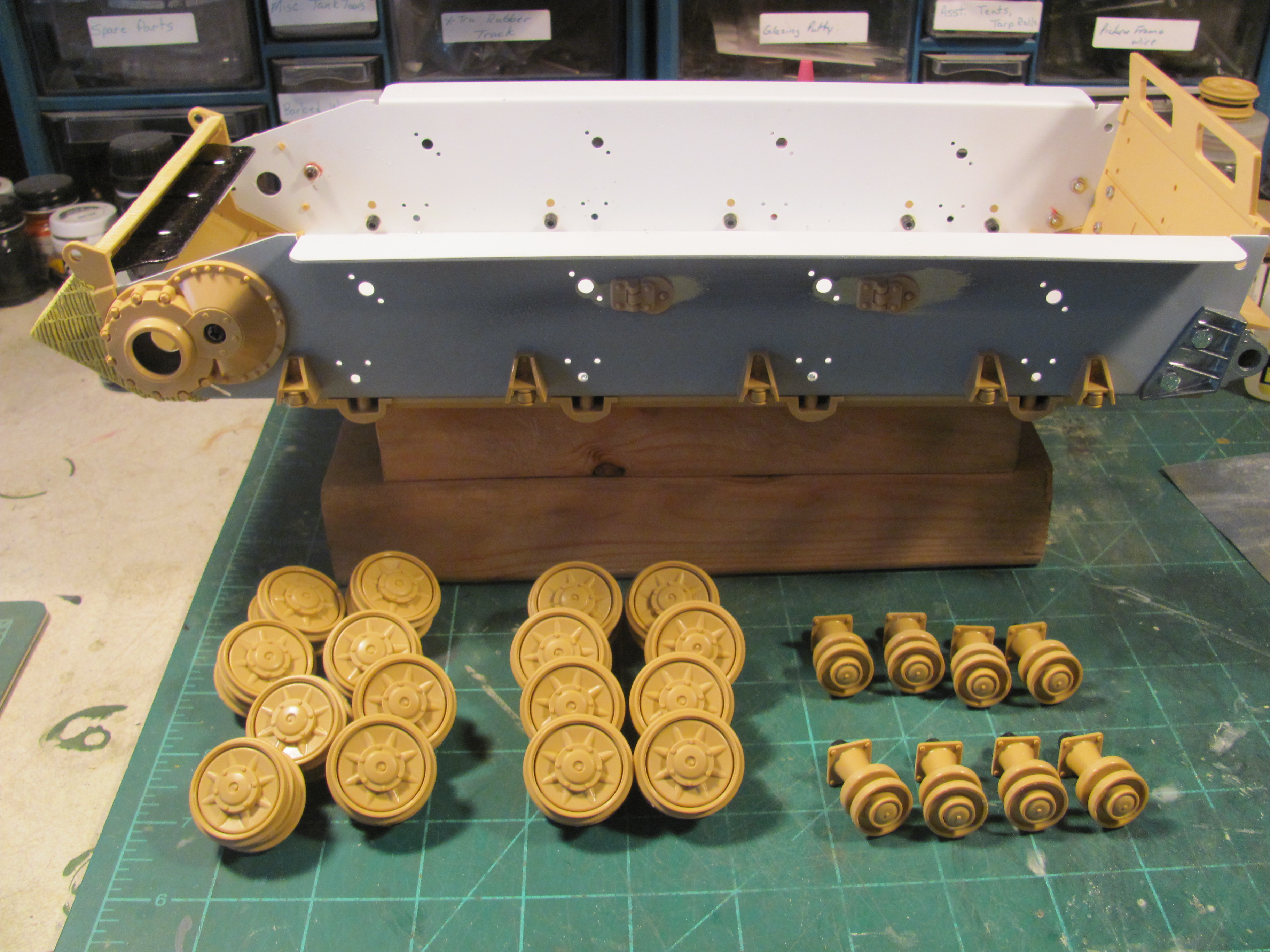

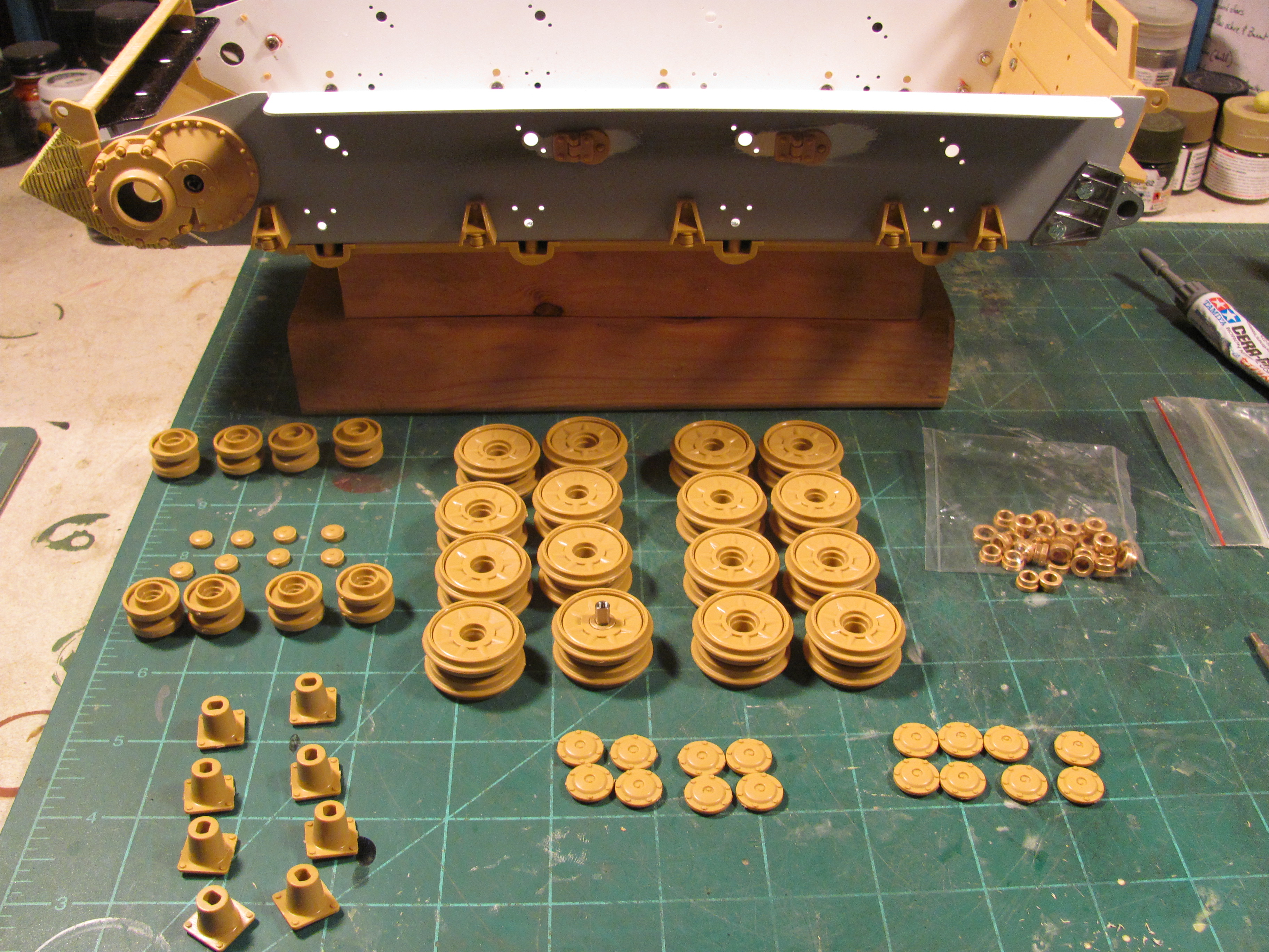

here are some pics of the road wheels and the return rollers completed

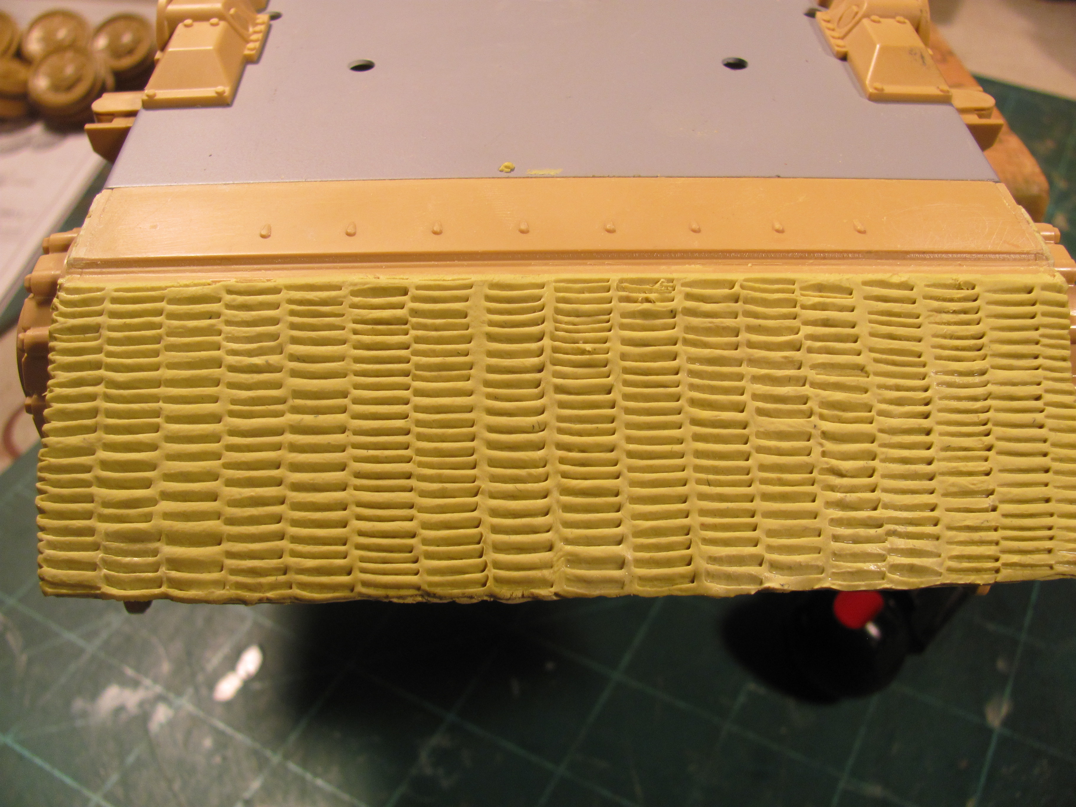

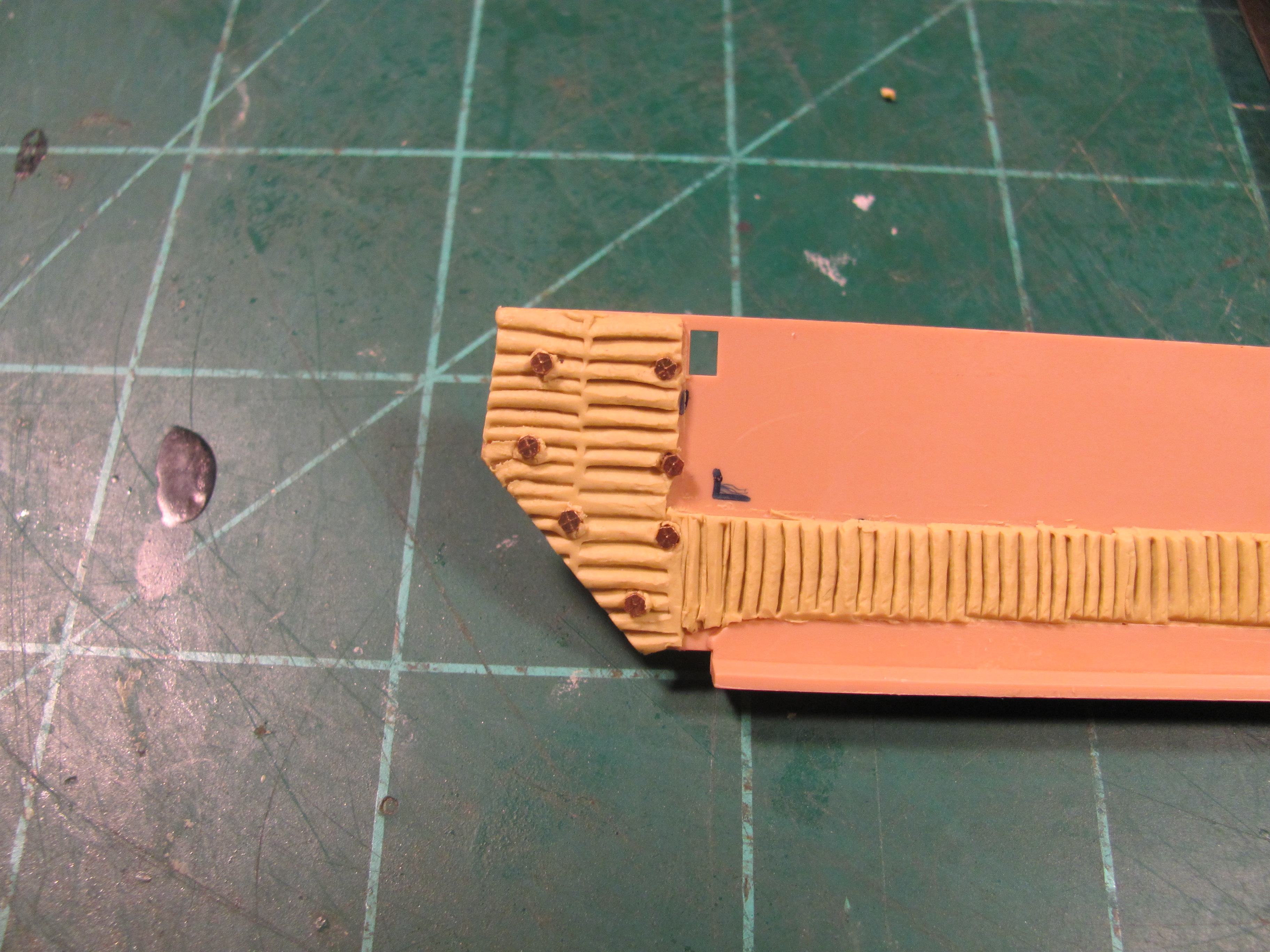

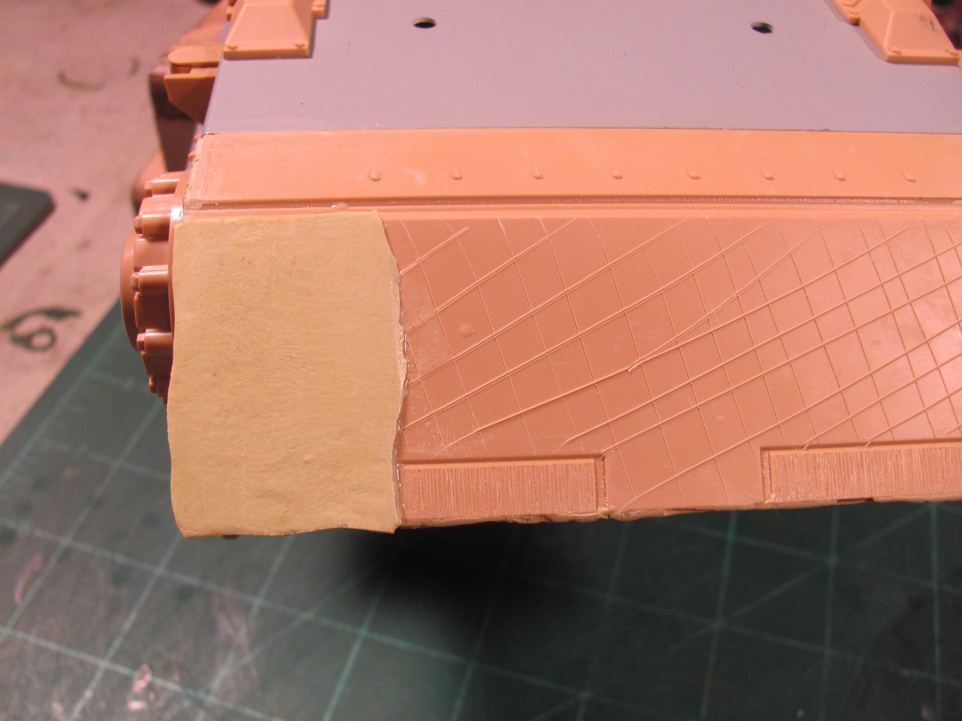

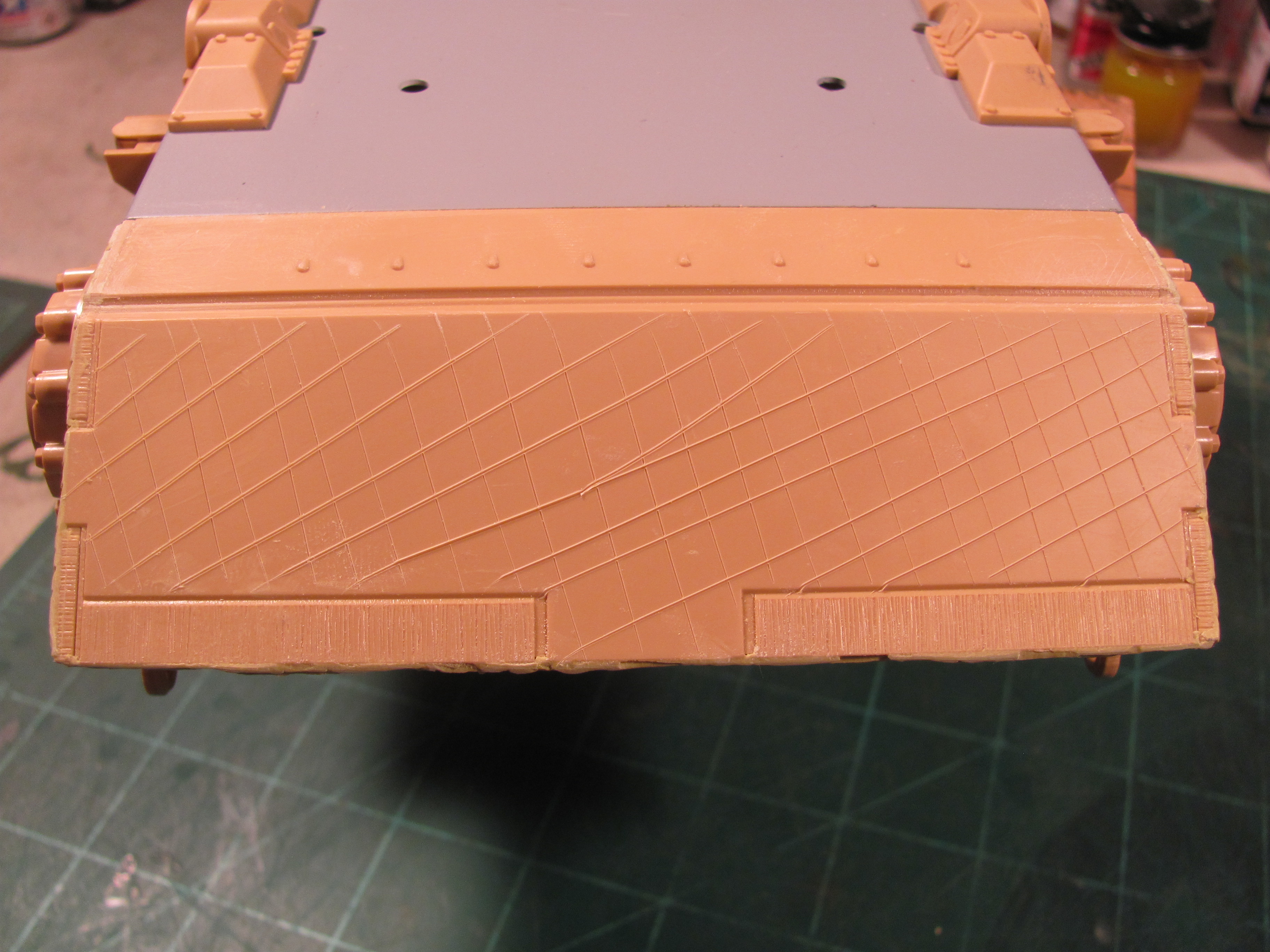

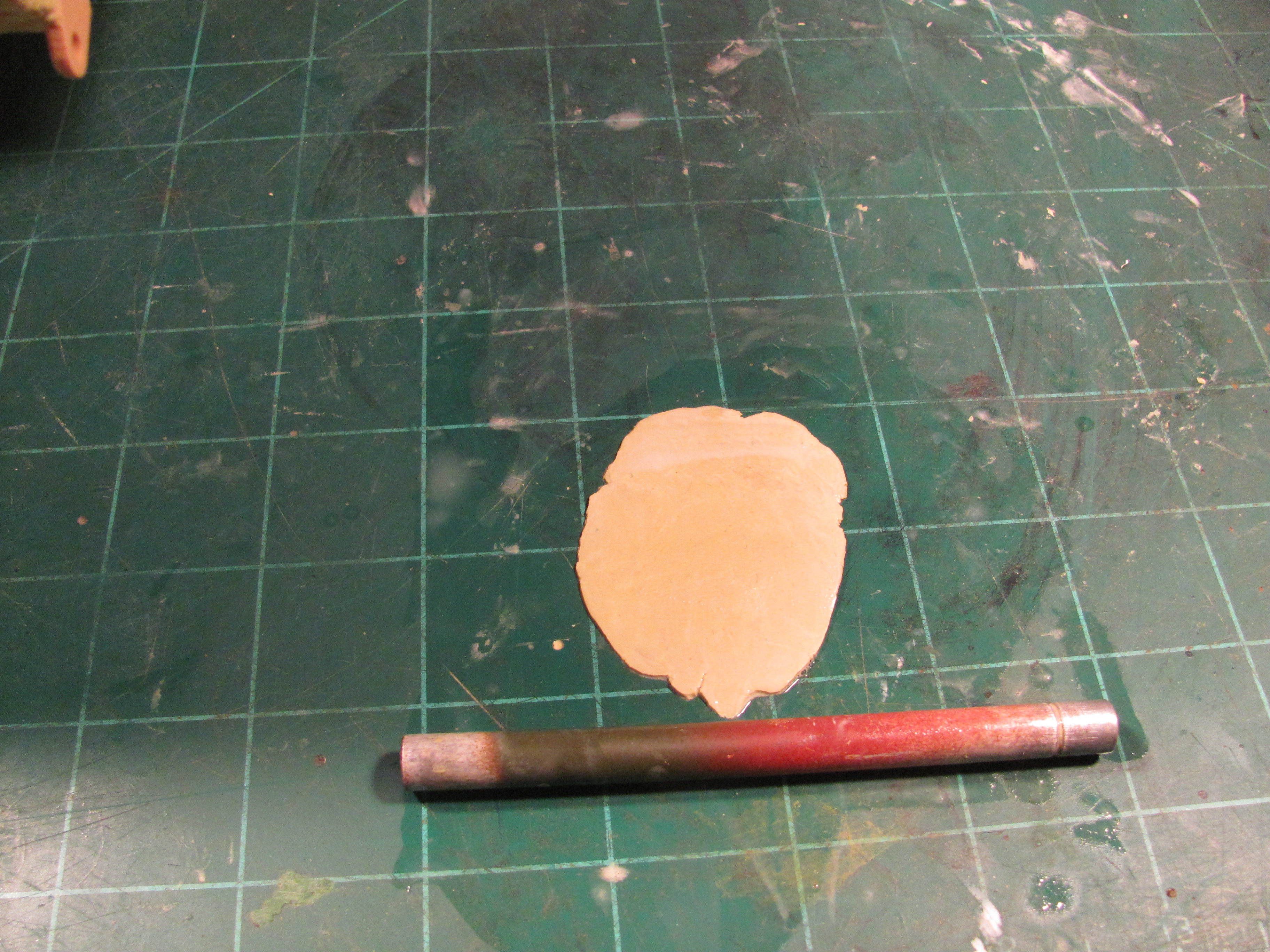

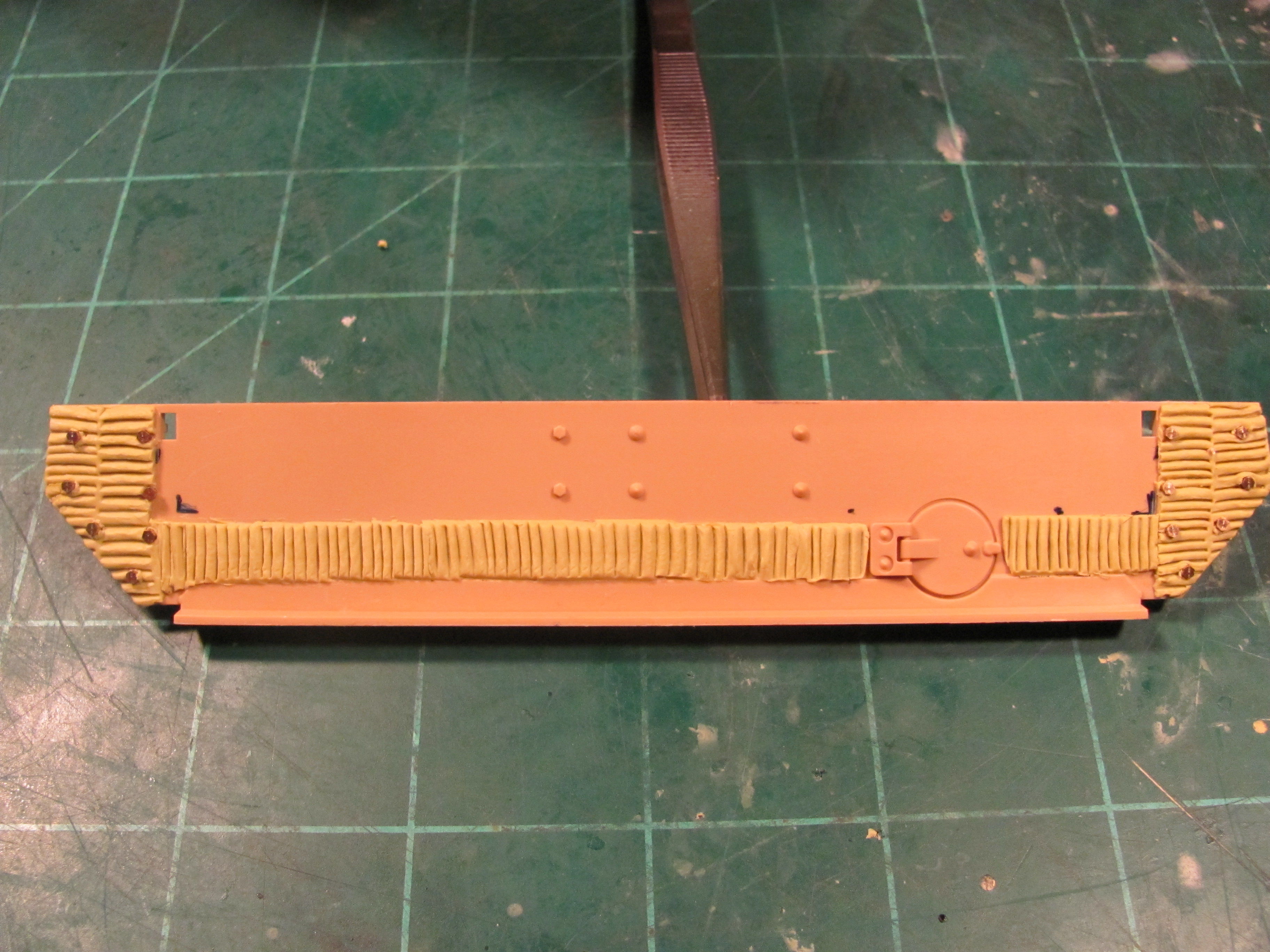

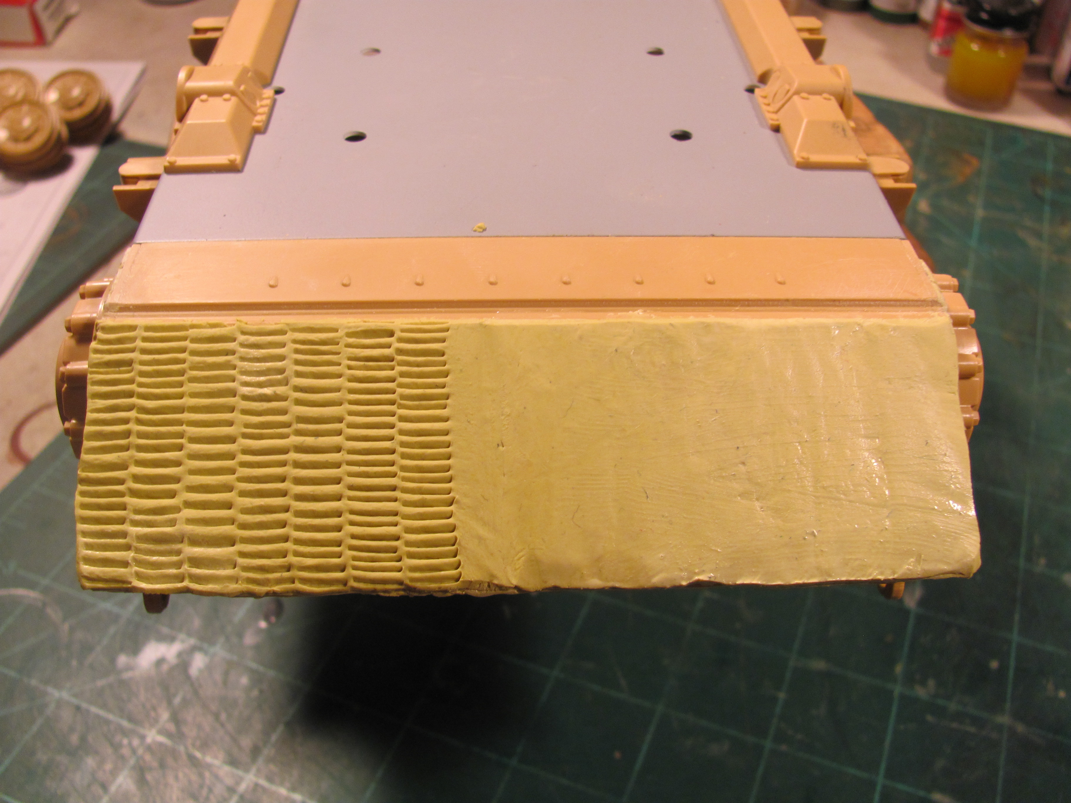

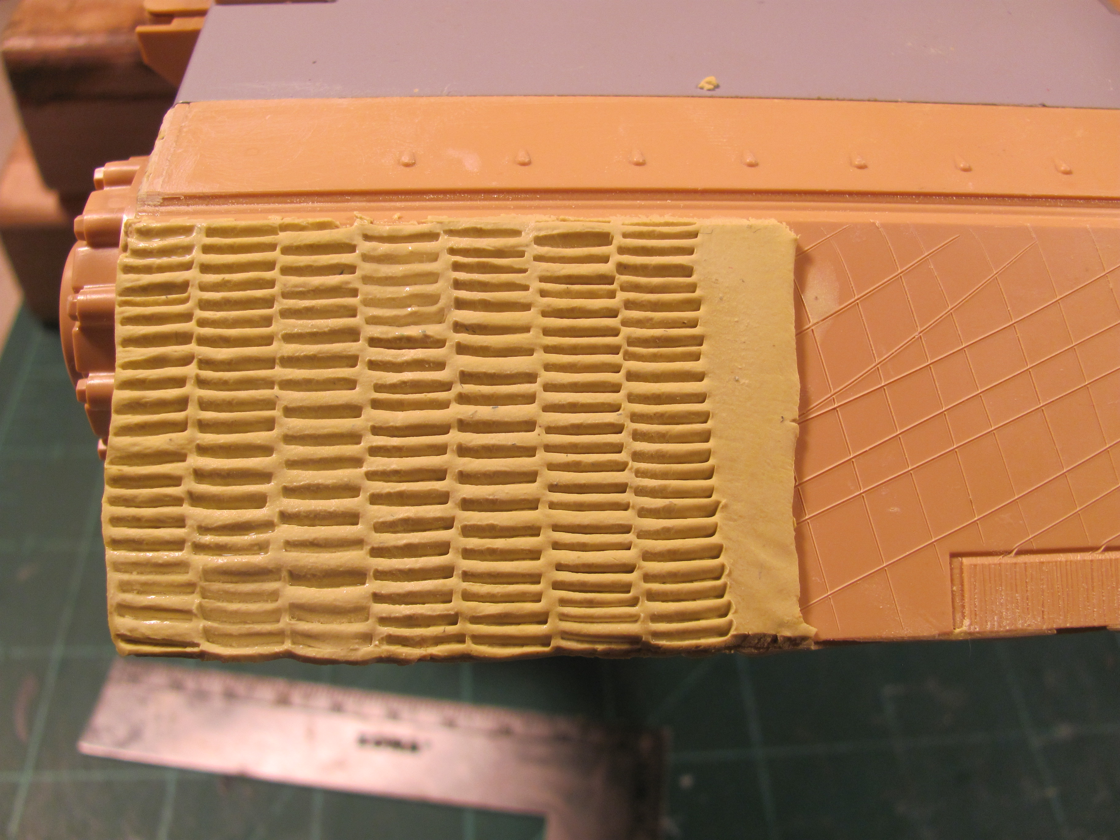

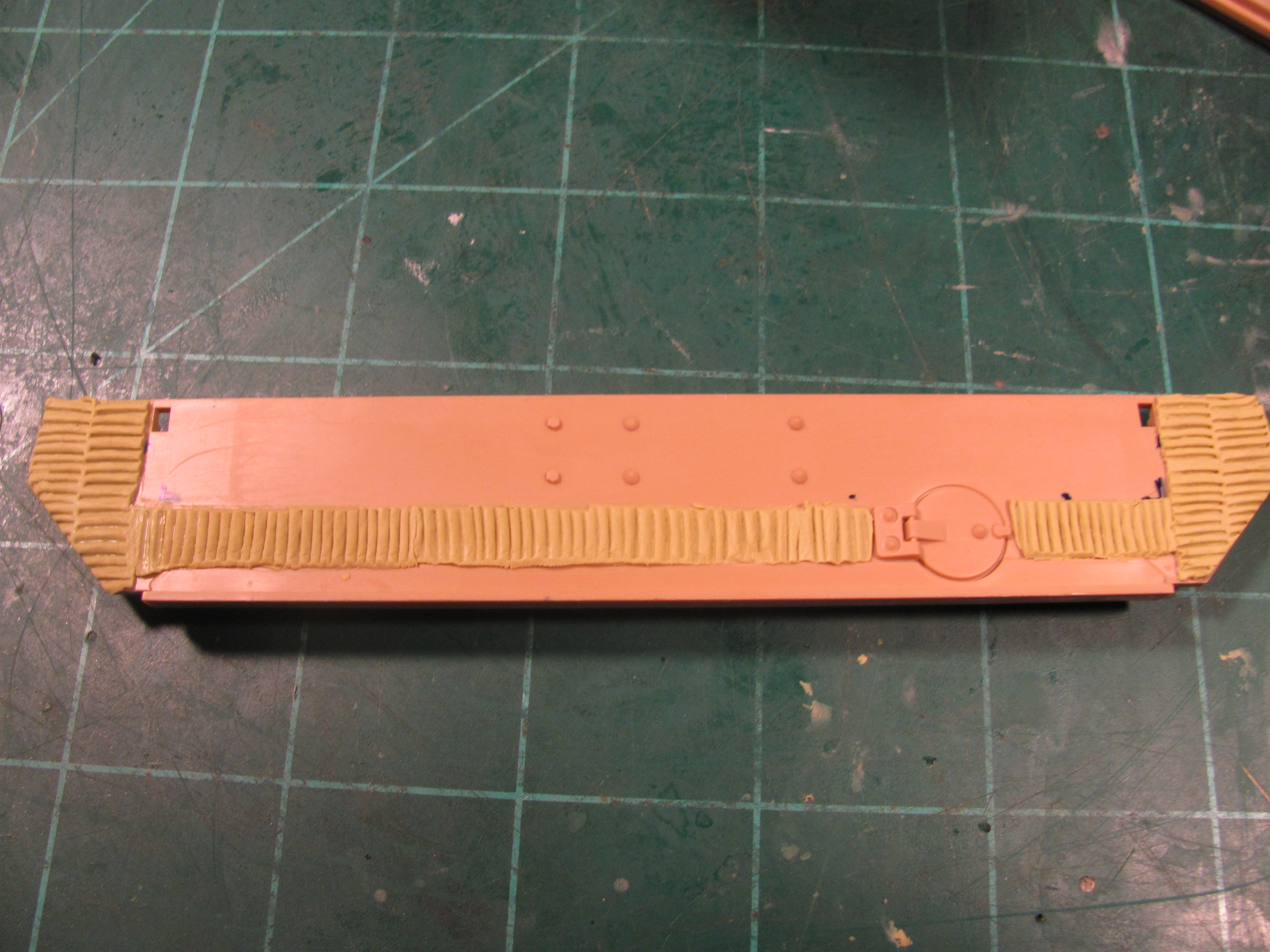

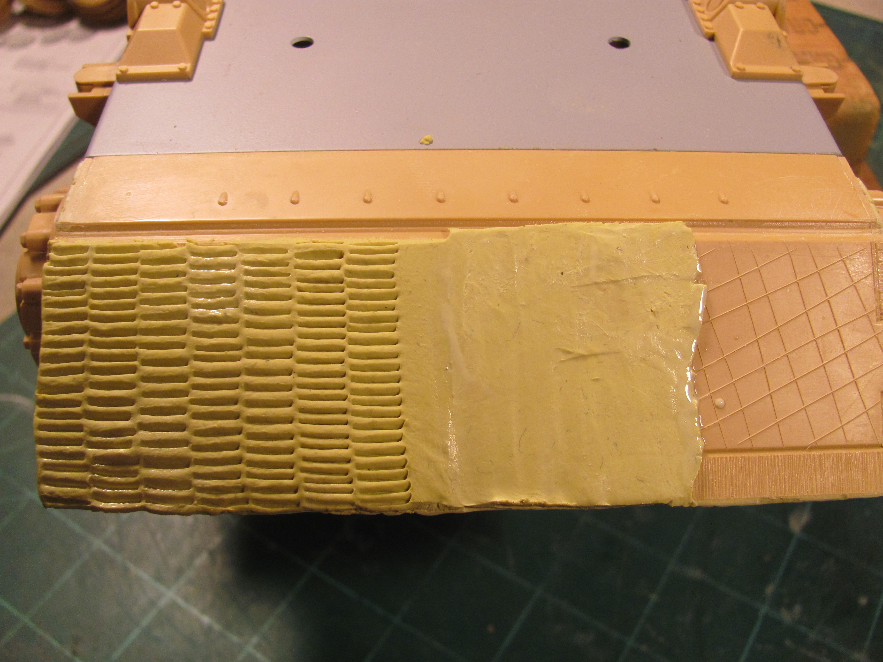

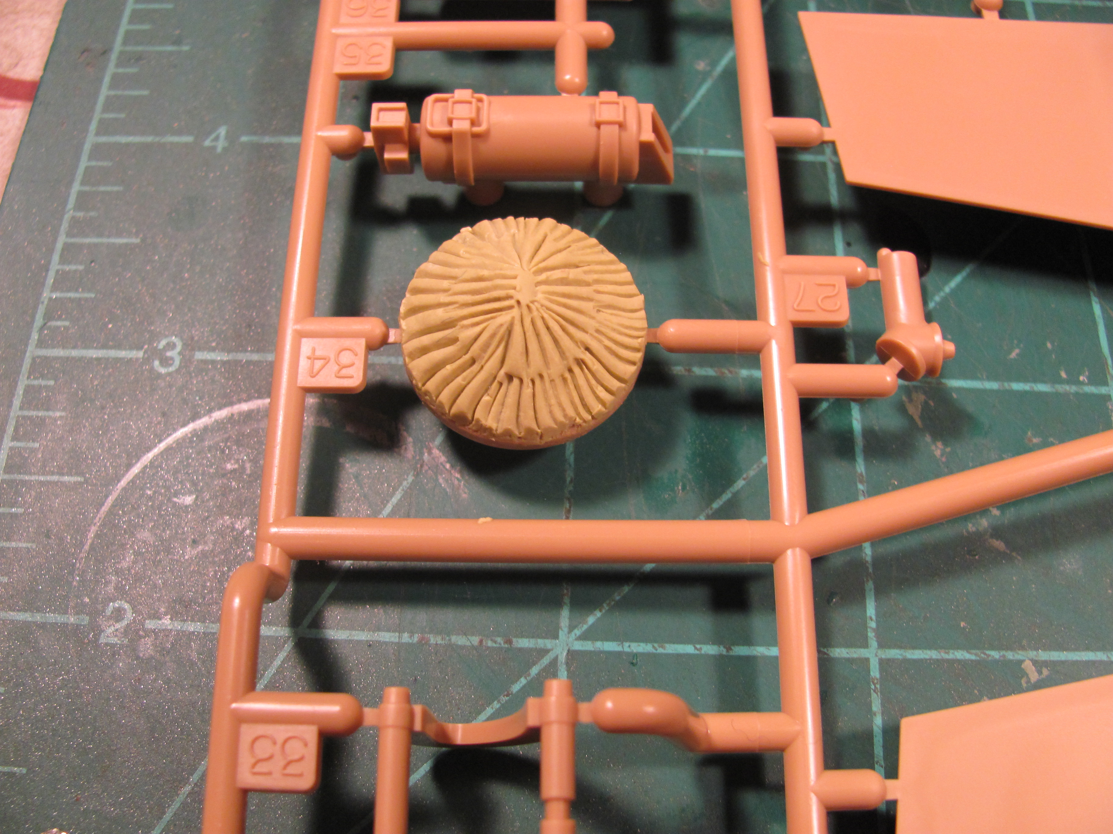

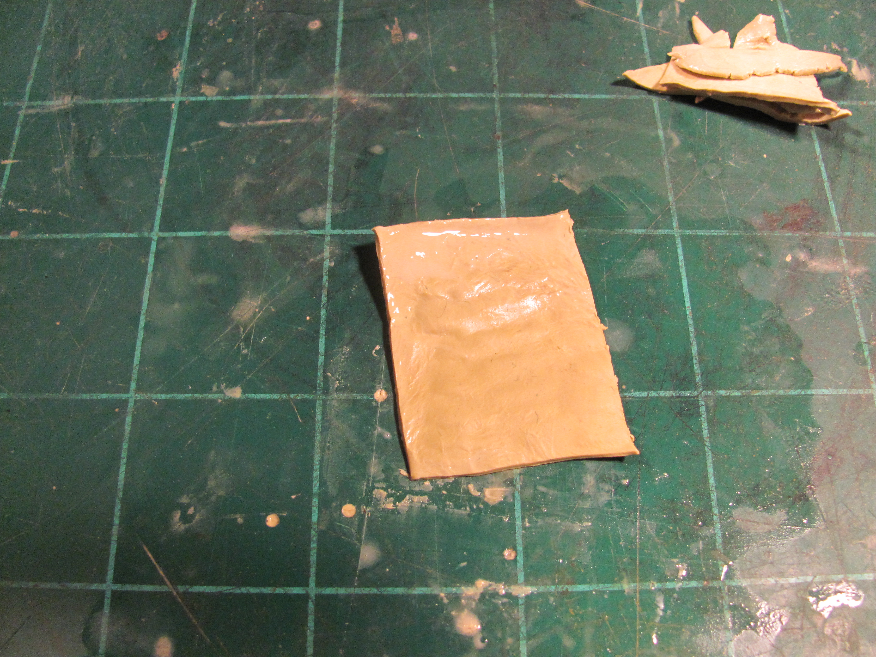

If you are interested in how i do zimmerit, here is the way that i have figured that works best for me:
I use Milliput, a hobby knife handle as a roller, a modified flat head screwdriver with the tip filed down at an angle to apply the pattern.
Step 1: scar the surface where you want the zimm, gives the milliput something to stick to
Step 2: roll the milliput flat
Step 3: Cut out the size you need
Step 4: place on model and roll it on using a roller
Step 5: Use a screwdriver to apply the pattern
Step 7: Continue until the surface you want zimmed it complete
I find this method ideal, the milliput has a long drying time to allow mistakes to be corrected, is easily sanded when fully dried, and is rock solid when completely dry and very durable. It is maybe a bit on the time consuming side, but the effects achieved i think are more than worth it.

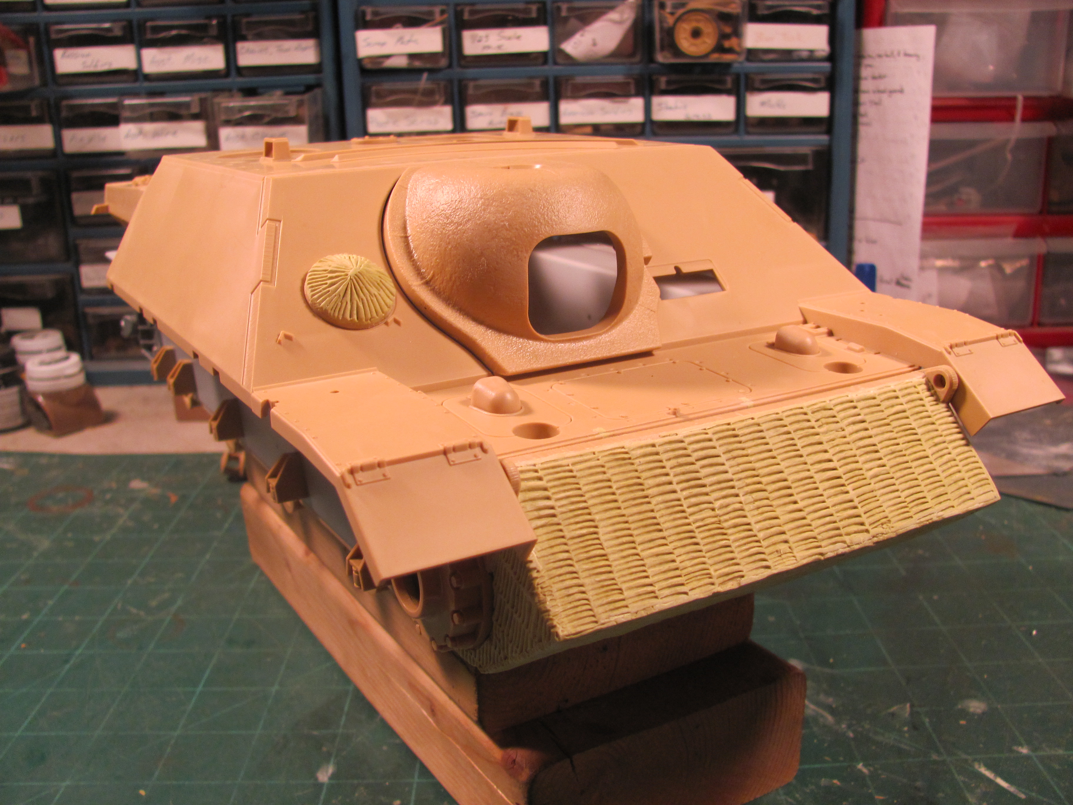

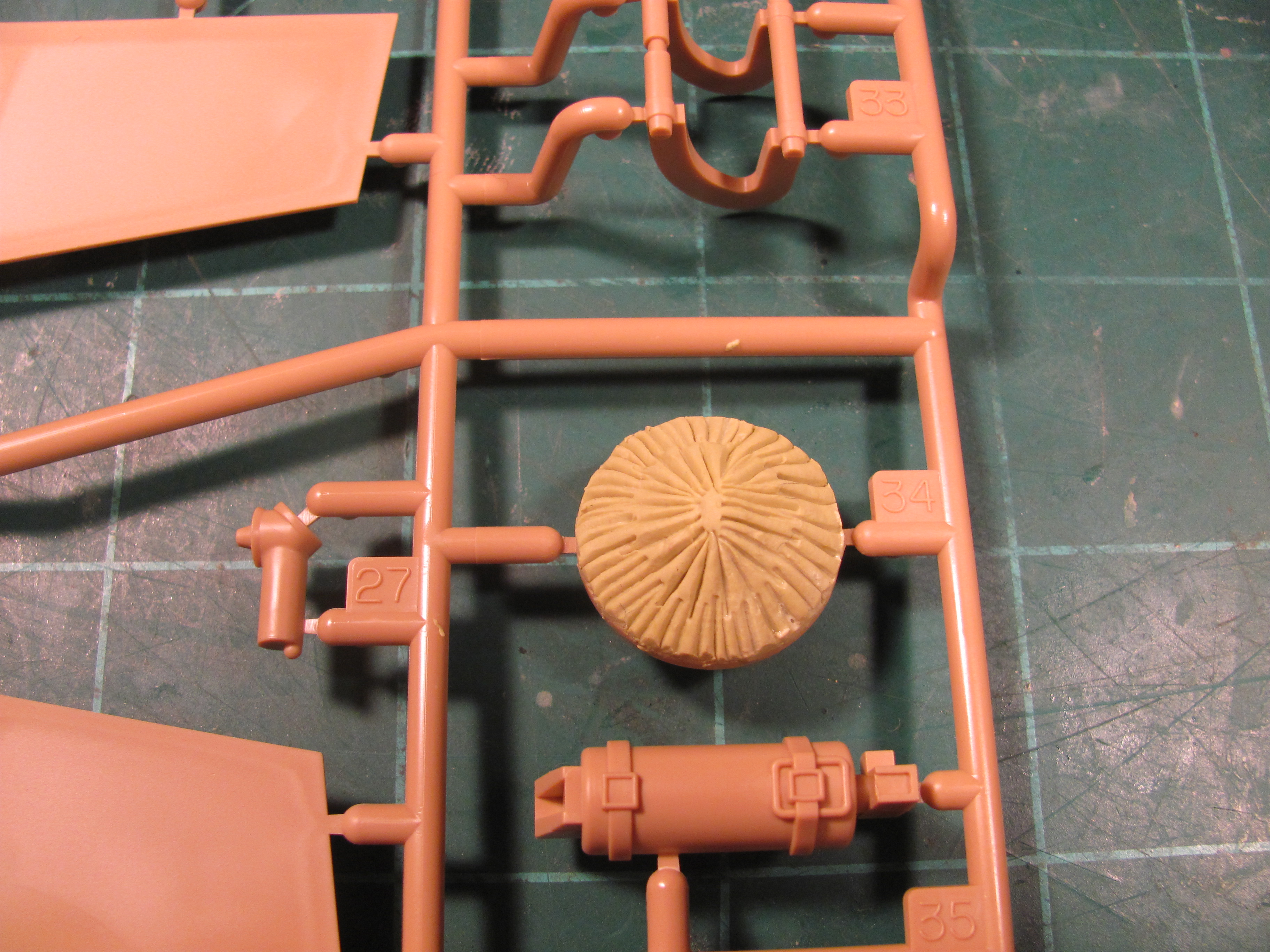

Also, with the left over millput you can use it to zimm smaller areas which i used on the hull machinegun cover

Sweet work Will! I didn't know Milliput came in sheets? How thin is it... thinner than the ATAK premade stuff?
Jeff

Sorry for any confusion, the milliput does not come in sheets, you still have to mix the 2 different components and when that is done you roll it flat like a pie crust.

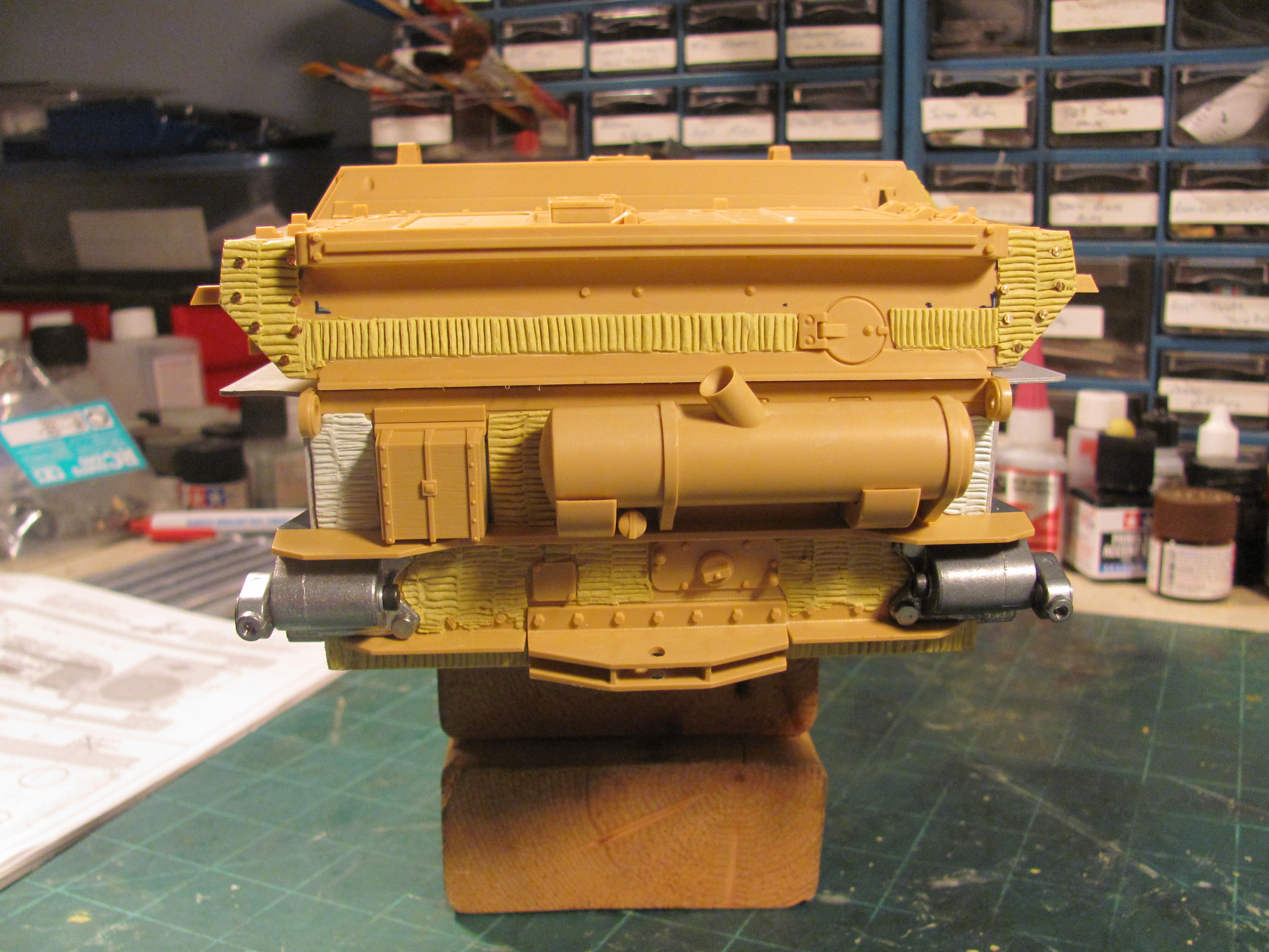

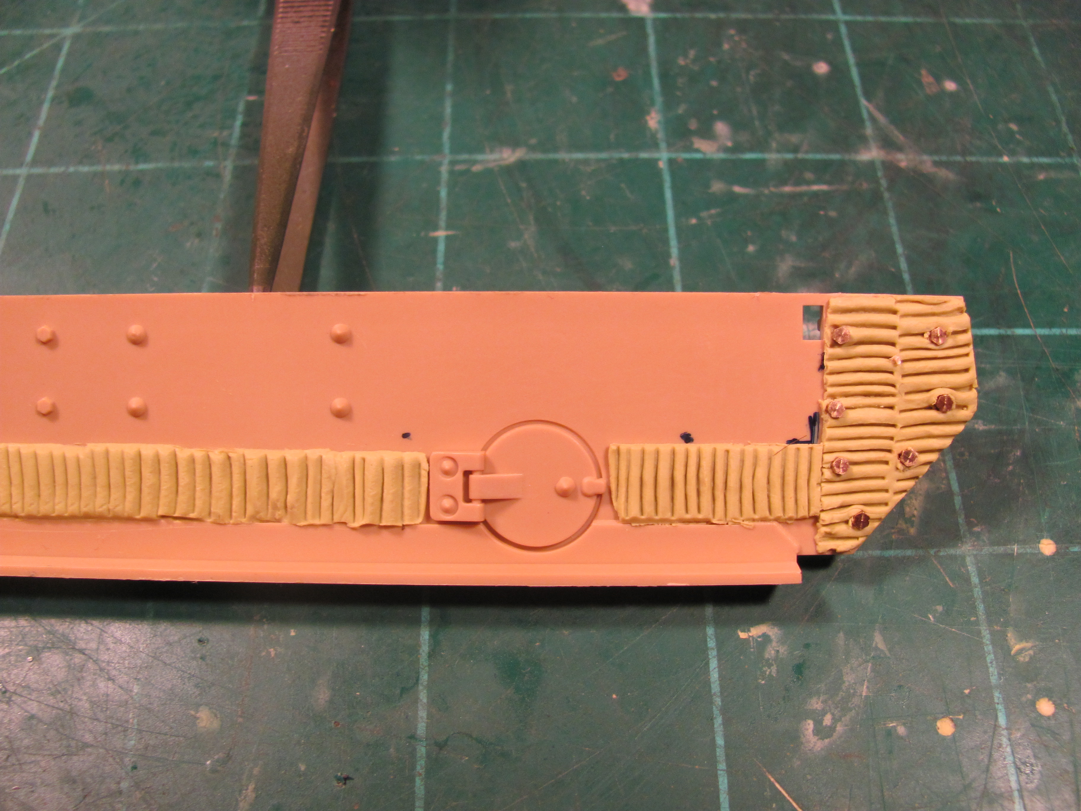

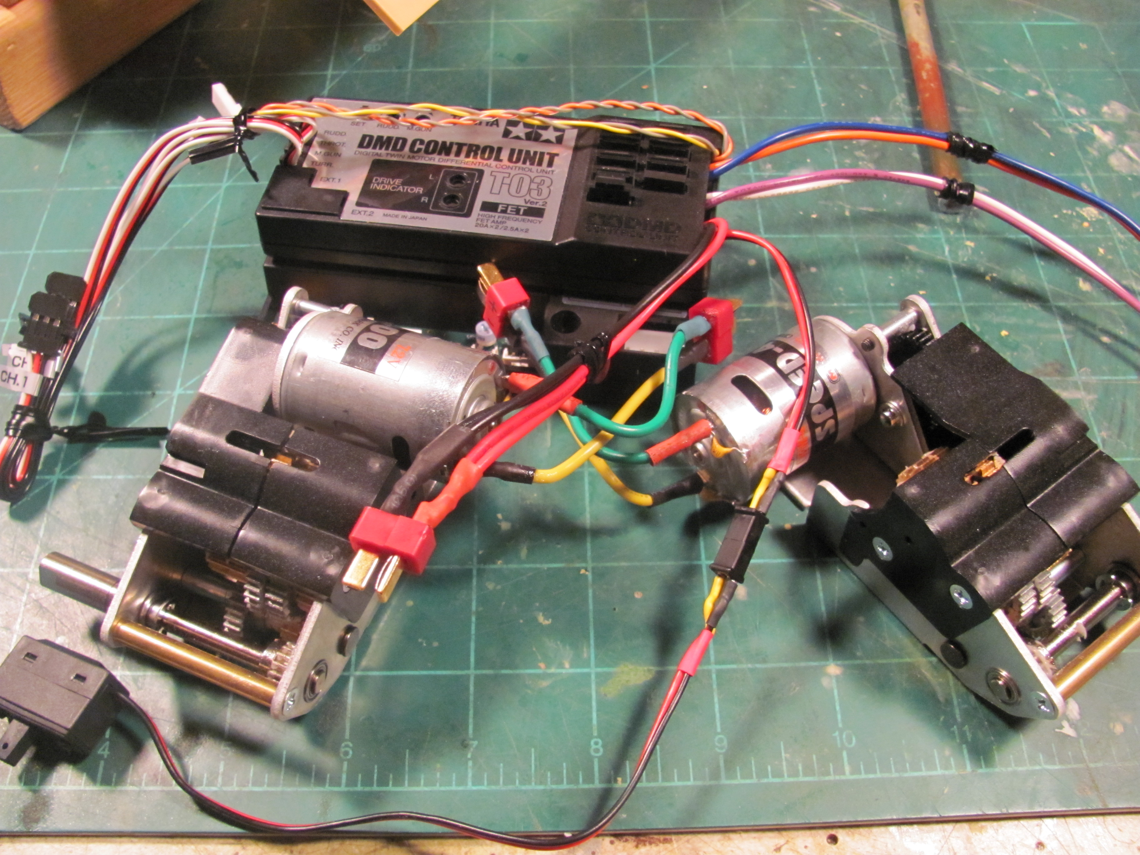

Some progress made:
soldered up the electronics with Dean connectors
the rear hull plate was zimmed and the bolt detail added using brass bolts.

Old 08-11-2016, 06:29 PM
  #44
manchu9inf
Join Date: Mar 2009
Location: Fayetteville, NC
Posts: 687
Received 13 Likes on 12 Posts

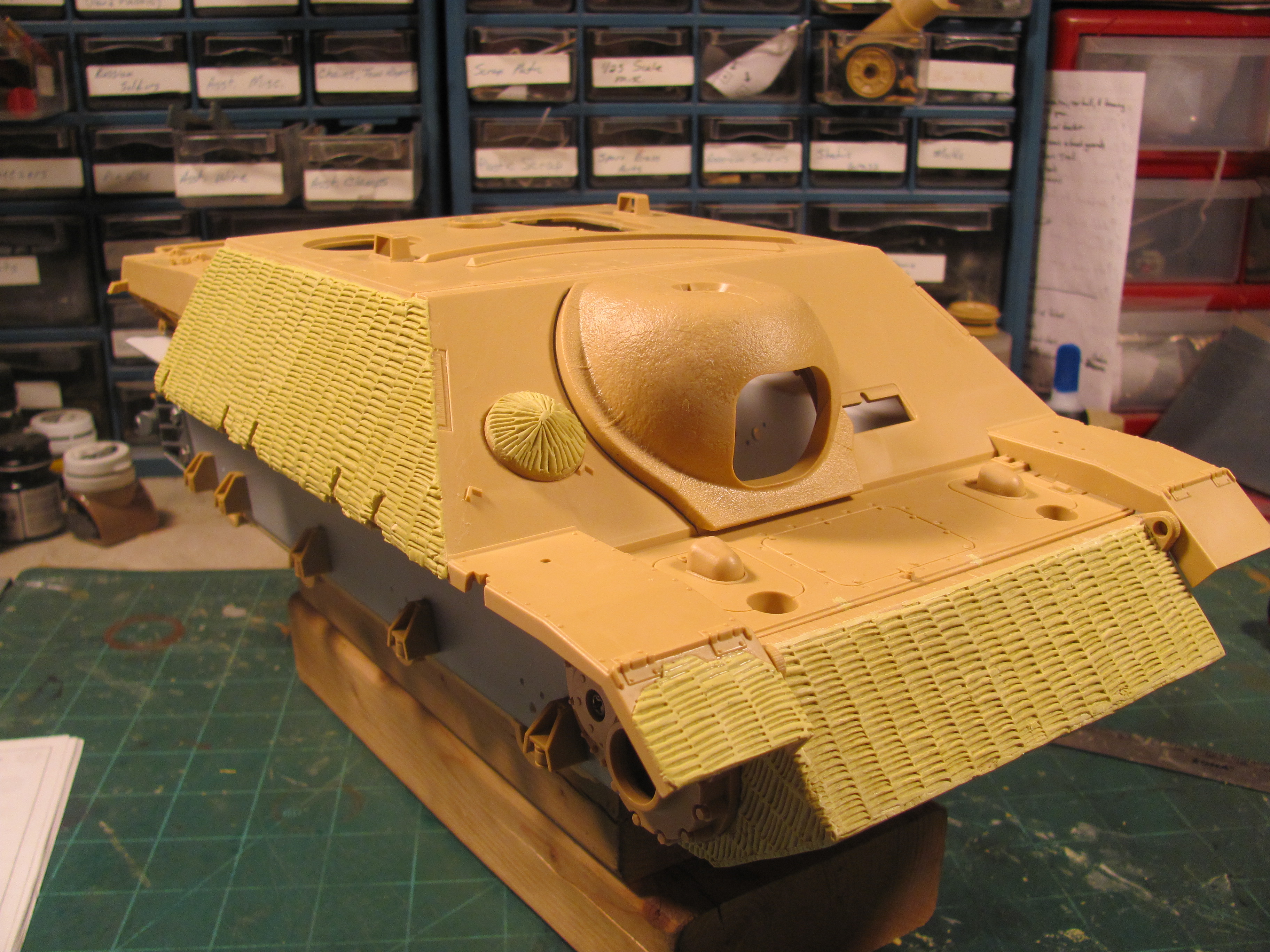

Some zimmerit got completed, its a lot of work and is time consuming, but the results will be worth it.

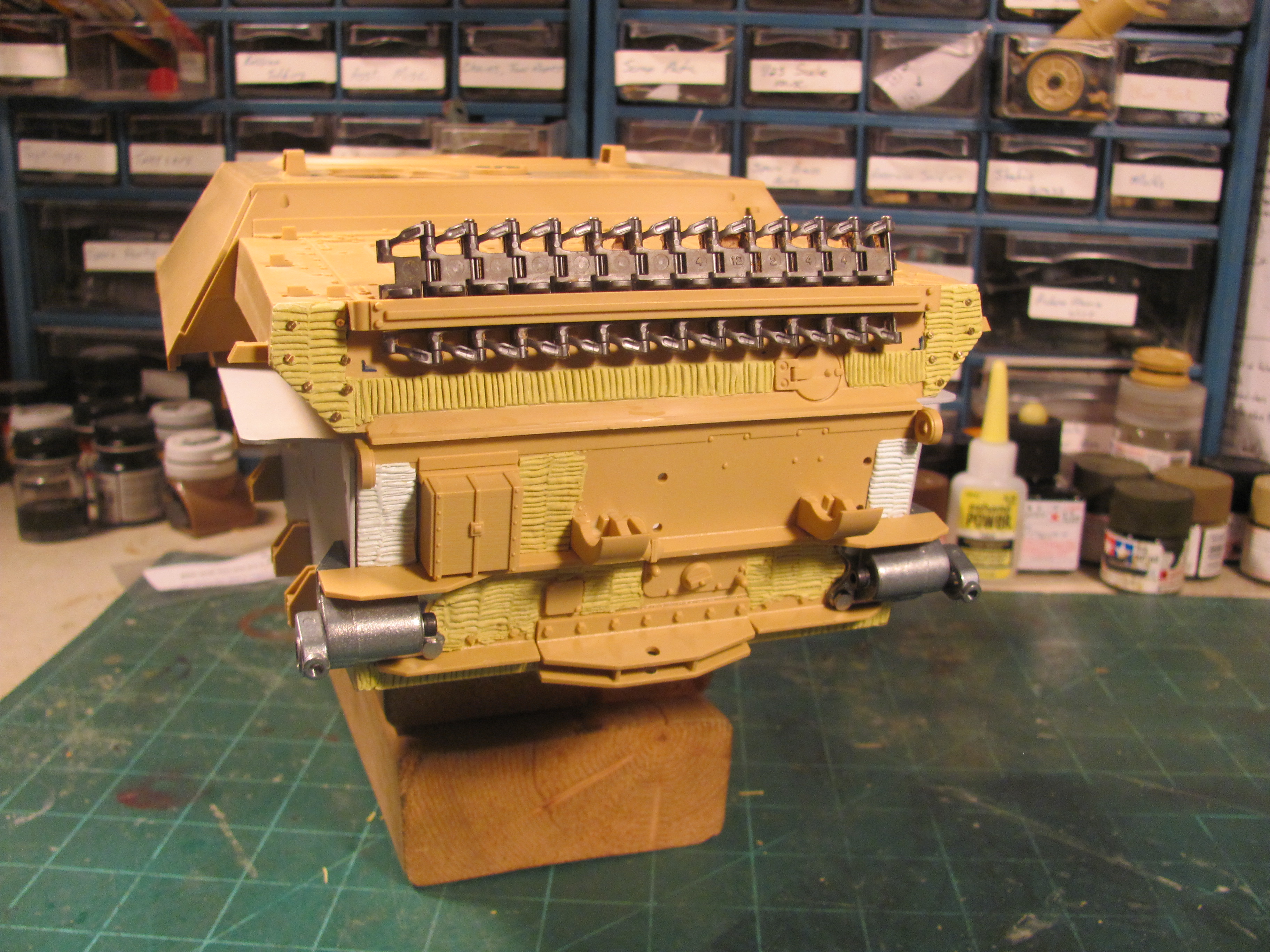

Name:	JP4 Hull Zimmerit (2).JPG
ID:	2176579   Click image for larger version
Name:	JP4 Hull Zimmerit (1).JPG
ID:	2176580   Click image for larger version
Name:	JP4 Hull Zimmerit (4).JPG
ID:	2176581   Click image for larger version
Name:	JP4 Hull Zimmerit (3).JPG

Nice build tread, good photos . I see you swopped the Stock motors to . The New ones are ?

Wow, the texture on the gun housing is really nice. Your zimmerit is looking great. I know the resin zimmerit kits save time, but the work I have seen several of the do it your self guys looks more realistic.

Yep... doing it this way keeps it from looking like aluminum siding had been added to the tank. This is a very thinly applied coating!
I know the more complicated zimm work like on the Elefant and Panther might not (and would benefit from the sheets) but these two Jagds look better with THIS kind of work.

I stated I would do a list of mods and details added, here is what I have done or will do:
1. Impact metal Panzer IV Tracks
2. Add Zimmerit
3. Change L70 canon to L48 canon
4. Replace stock motors with Speed 400 motors
5. replace motor and battery connectors with Deans Connectors
6, Add bearings to rear idlers
7. Delete the gun travel lock
8. add the trailer hitch
9. Add Daryl's Hull brace
10. add armored cable to headlight
11. replace clutch gears in the gun elevation with the blue gear
Not a long list and all easily doable, if there is anything that I add to the list I will note in the build thread. I hope this helps for any future builds.
