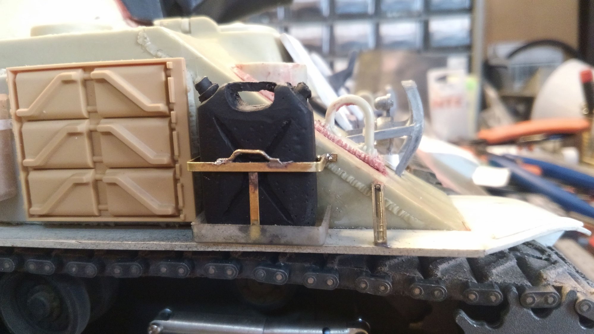

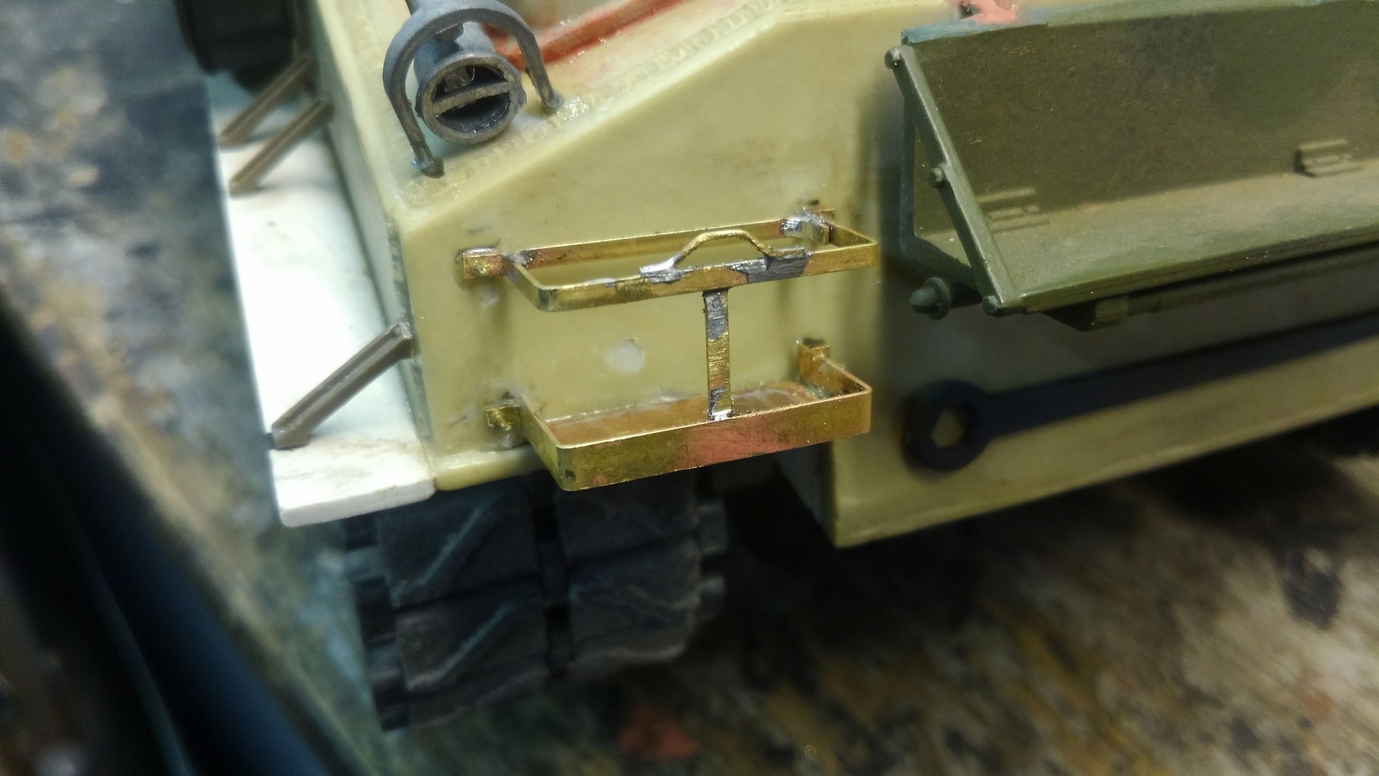

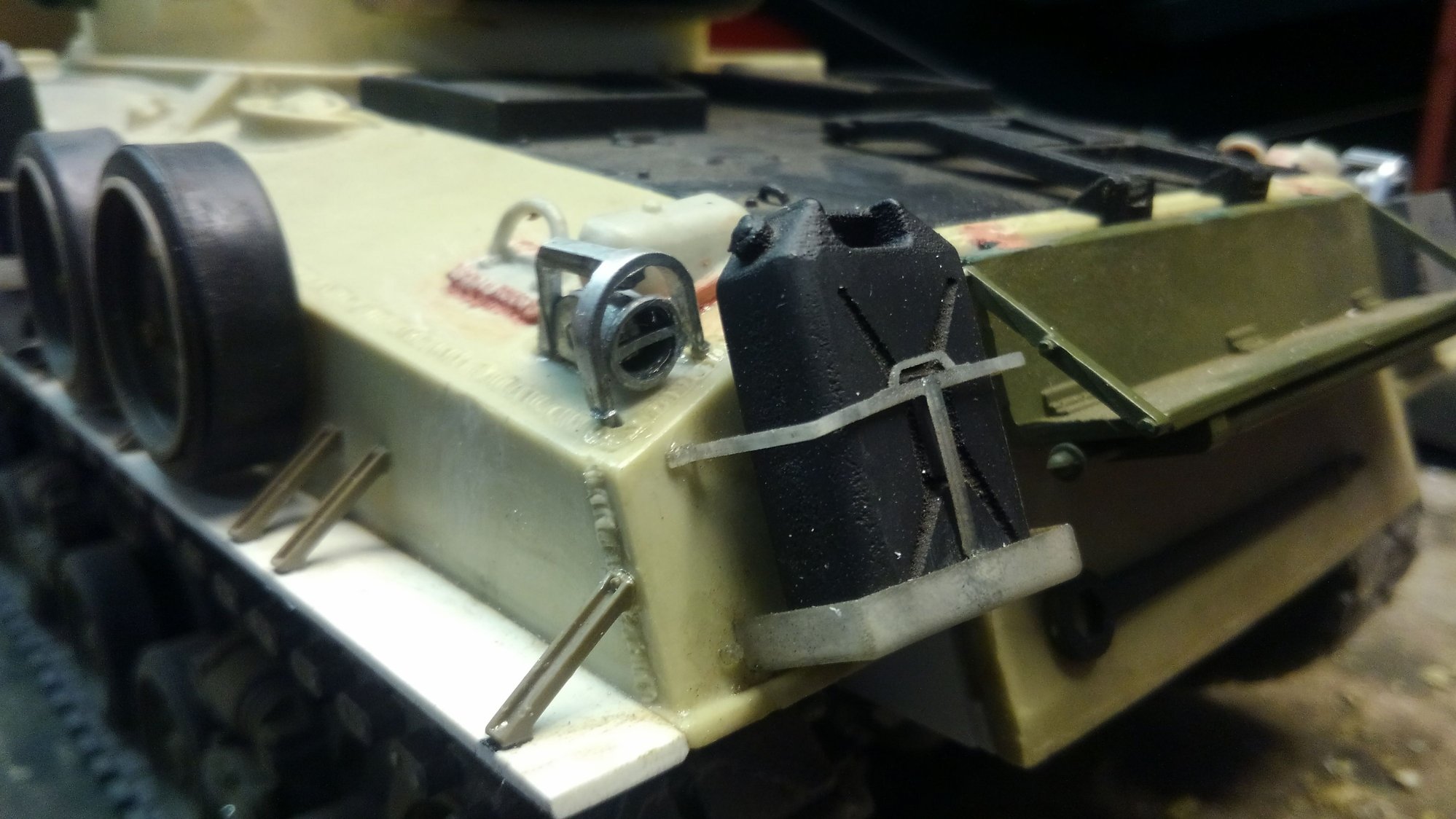

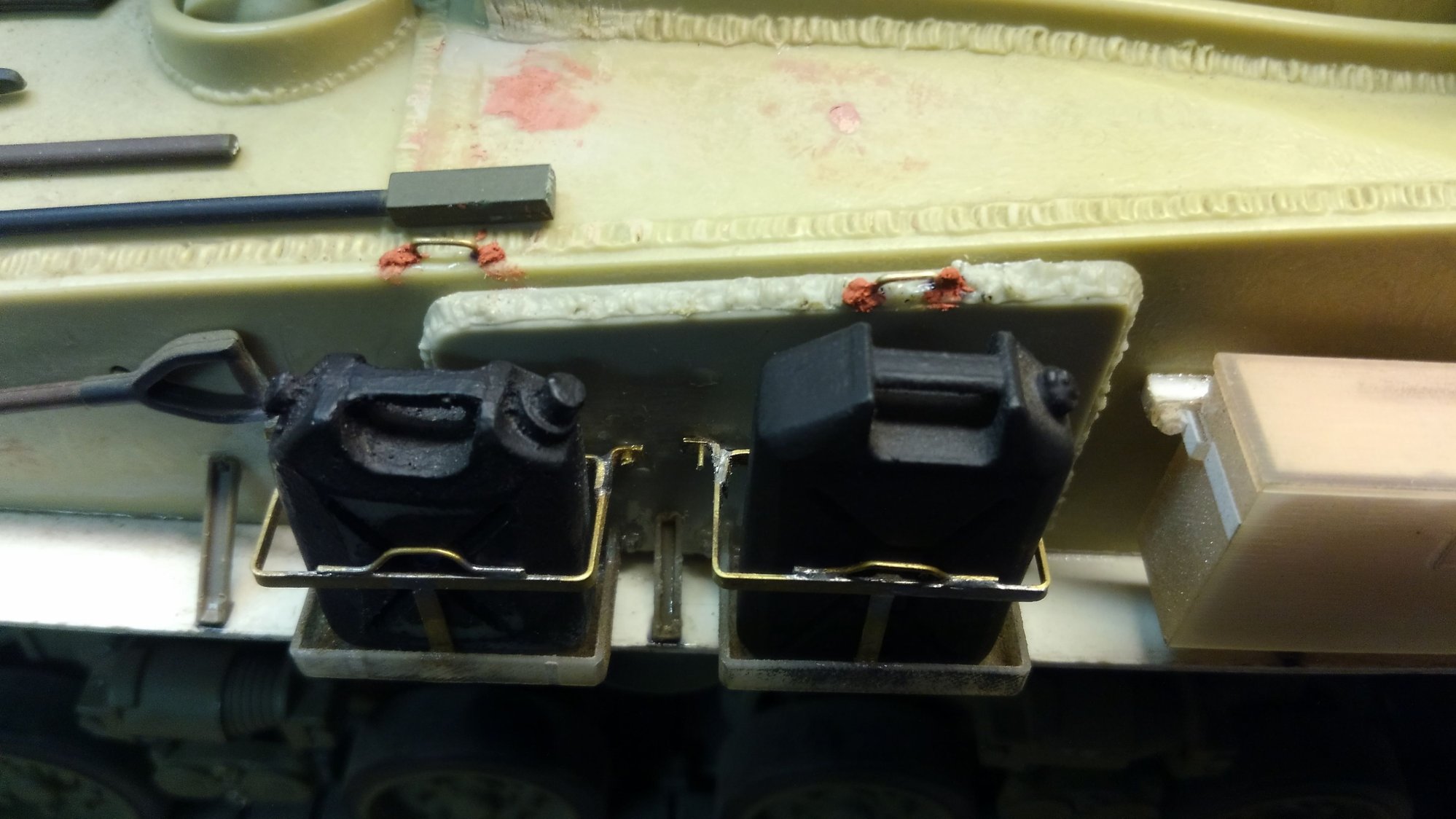

Well, I knew the 3d printed jerry can holders were gonna break, the front one didn't even last till I painted the tank. I decided I would try and make them from brass and drill and pin them to the hull. This is the first one I made so far, man is it sturdy. Its amazing how strong it is. I think on my next tank I might just use brass to bend and fold the can plate at the bottom too. Oh the challenges I make for myself.
RichJohnson is offline

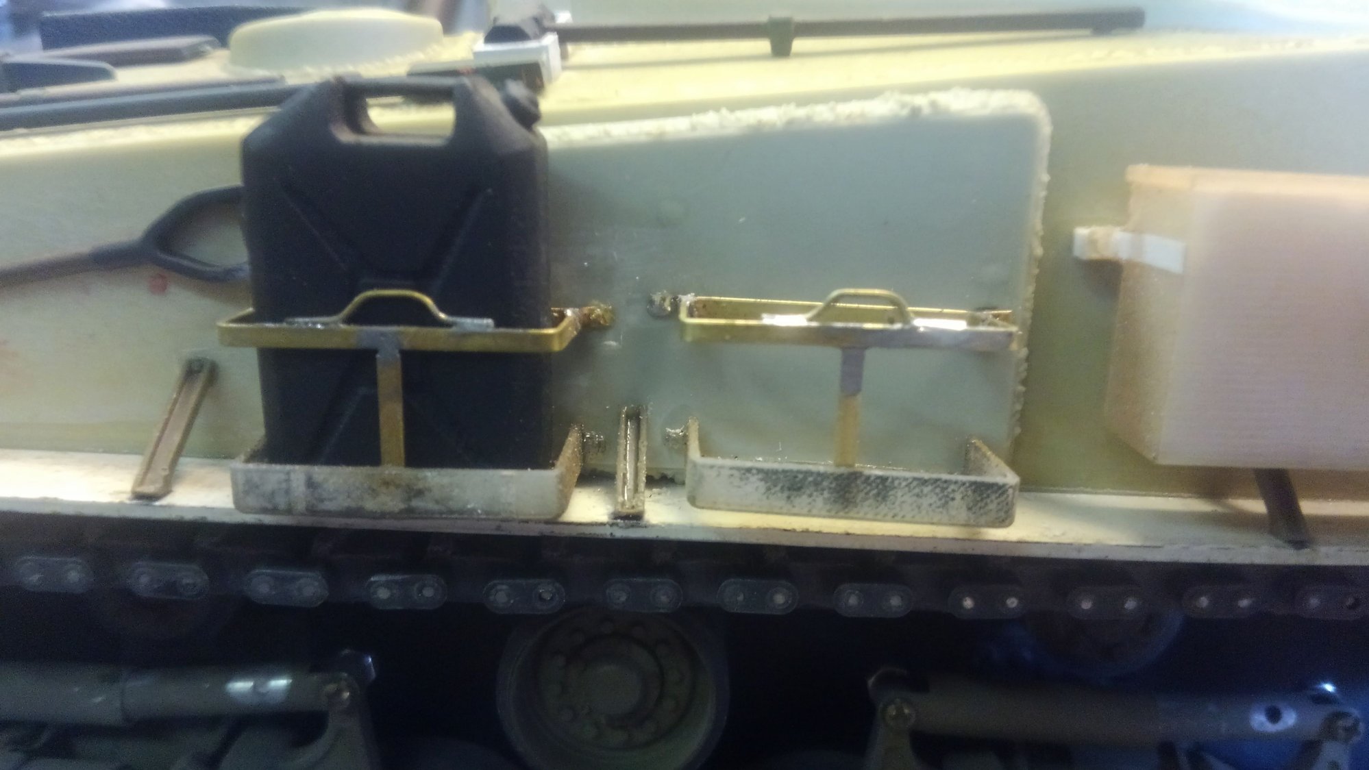

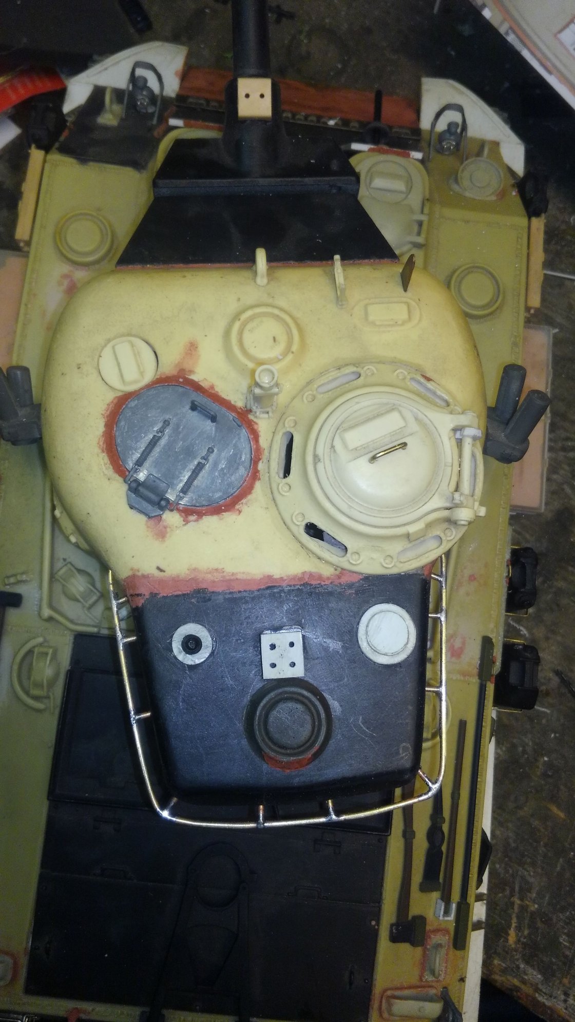

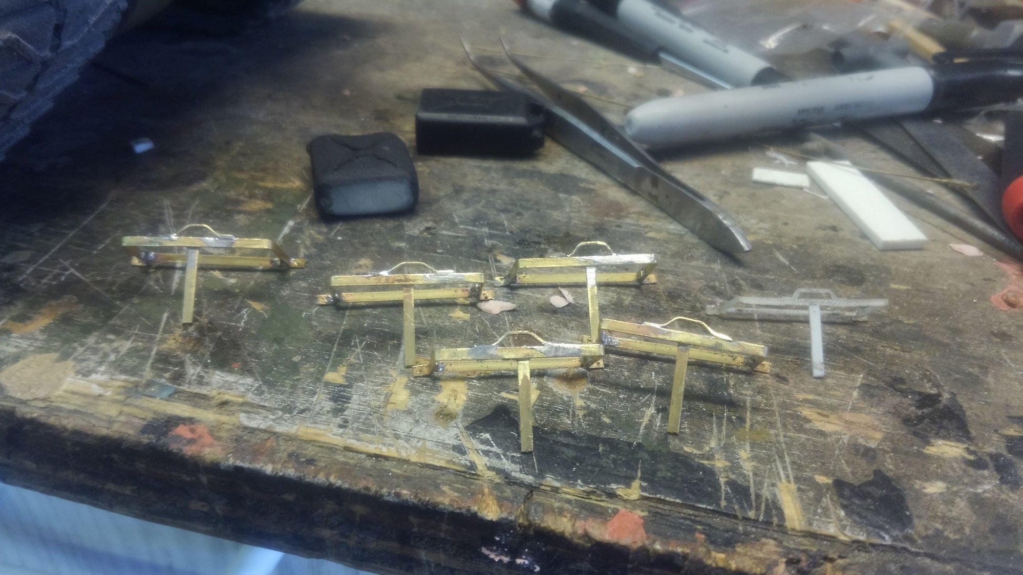

Time to get back to working on this project too. Been loathing having to rebuild the jerry can holders with brass because they kept breaking before the tank was even done. The rear one even the plastic printed pan holder got broken in half so I decided to make the pan in brass too, just for the rear since it sticks out so much and is vulnerable.
Two more to install,, then the turret hand grab bar on the bustle and some other small stuff and she will be done I think. Unless I decide to put all the footman loops on it, which I may do.

Nice additions in brass

I recently started to work with soldering brass and PE on my KV-2 build. I bought an Aber PE detail kit with some very small items to be soldered. Even though I have been taught how to solder I was having one hell of a time. Most of the time it's because your either get too much heat from a torch (other areas de-solder while trying to solder another area) or too little from a soldering iron (cold joints that don't bond). With solder in one hand and the iron in the other the parts would still move around even with my 3rd hand stand. So I had an idea to order some liquid flux and solder paste. I have a heating gun with multiple tips and a temperature control on it. I've cranked the heat up to 450 degrees F at a medium airflow and the solder paste will melt. Using the hot air allows me to heat up the entire piece and concentrate heat in a small area to get the solder melting. Once the air leaves the soldered area it stays bonded while I solder the other part of the piece. It's been working extremely well. Solder paste is designed to basically wick up when heated so the joints are really clean looking with very little clean up afterwards. Applying the liquid flux with a small brush means creates a great deal of control as to where the solder paste bonds.

Wow, nice metal work on the jerry can holders!!!

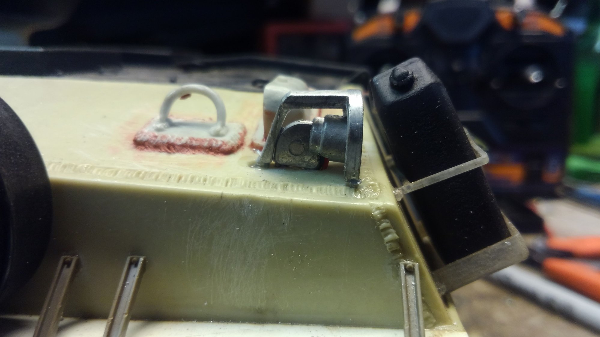

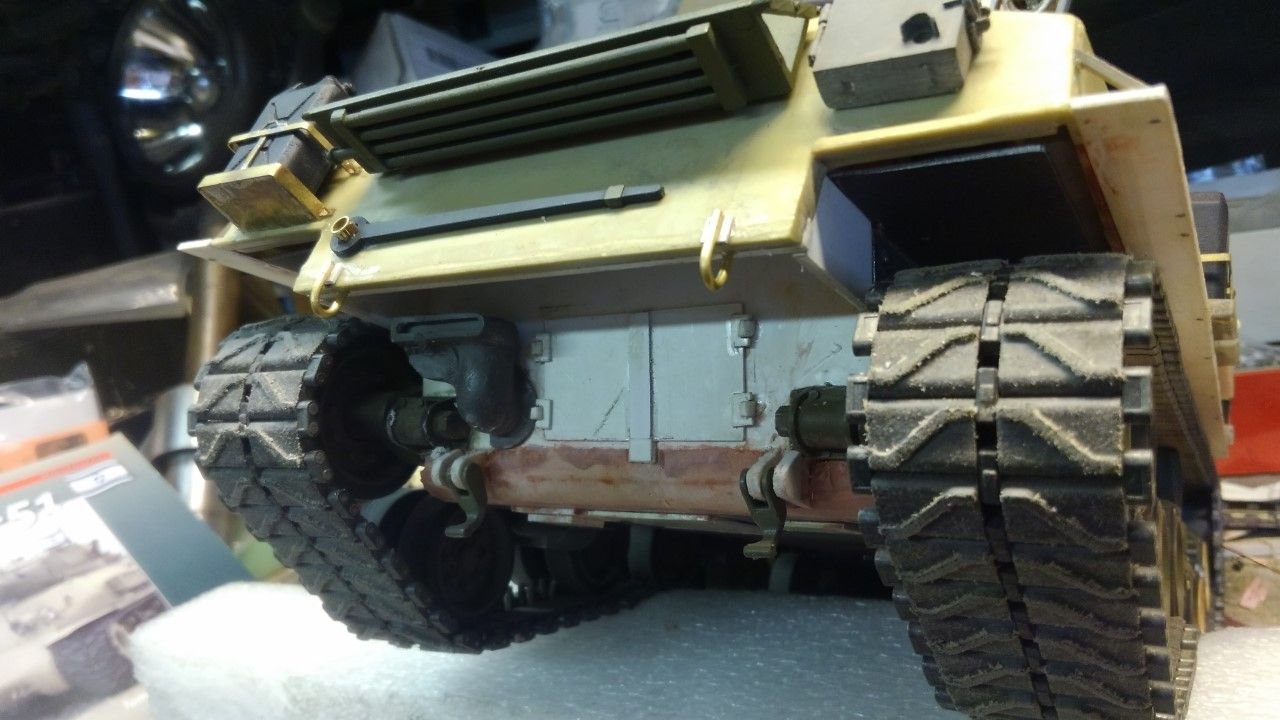

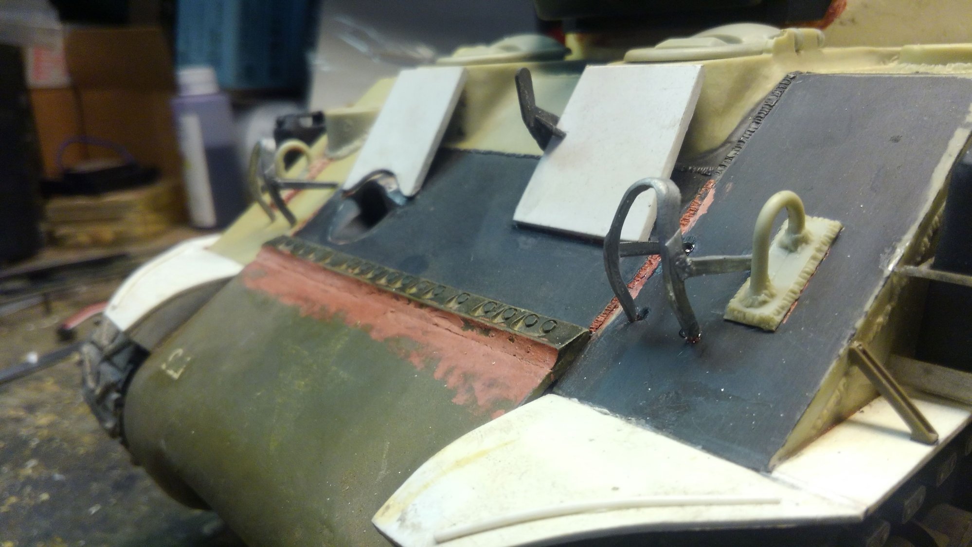

I added the footman loops on the hull to strap the jerry cans down, to finish off the can bracket project.

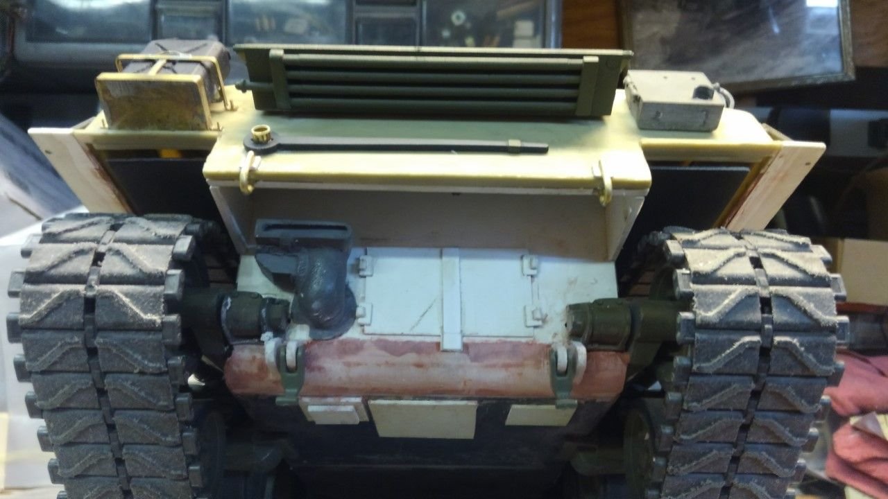

I finally finished the rear of the hull. I realized the thick cast door I bought was used on all the m50s except the m4a4 since it was already longer and didnt need clearance for the crank pully assembly. Thank God for good books.
I rounded off the bottom of the hull as well with bondo, that was actually more work than I expected. As well as got the lift ring mounts installed in the bondo mess. Also decided to add the access plates on the bottom of the hull back there. I though they looked cool in the real photo so they might add some zing to my model. Also completed the rear slope tow rings, not sure what they were for, and it seems many of the m50/51 tanks had them cut off right across the bottom if they lasted in service long enough.
Moving along, this tank is so close to being done, Im over it and want to move on to other things already sheesh. Need to get the turret rear grab bar installed and make up a mount for the spot light too. Its almost there....

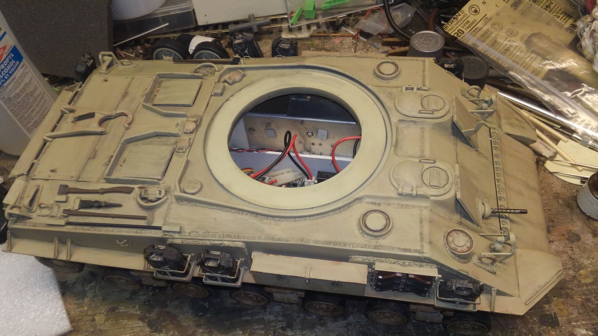

Well, I am nearly there guys. I got the hand railing along the bustle finally done. Ive been dredding doing this for some reason but its done now. I also got my bullet splash done around the gunners hatch. I think all I have left to do is to get the bracket for the sledge made from brass and then make the couple footman loops that hold the shovel in place on the side. Then its paint time. I gotta hurry because our October War Arab Israeli themed battle is later this month. We are hoping for a good turn out of Super Shermans and tan panzers and russian tanks. As far as we can tell this will be a first ever for themed events to have and IDF event.

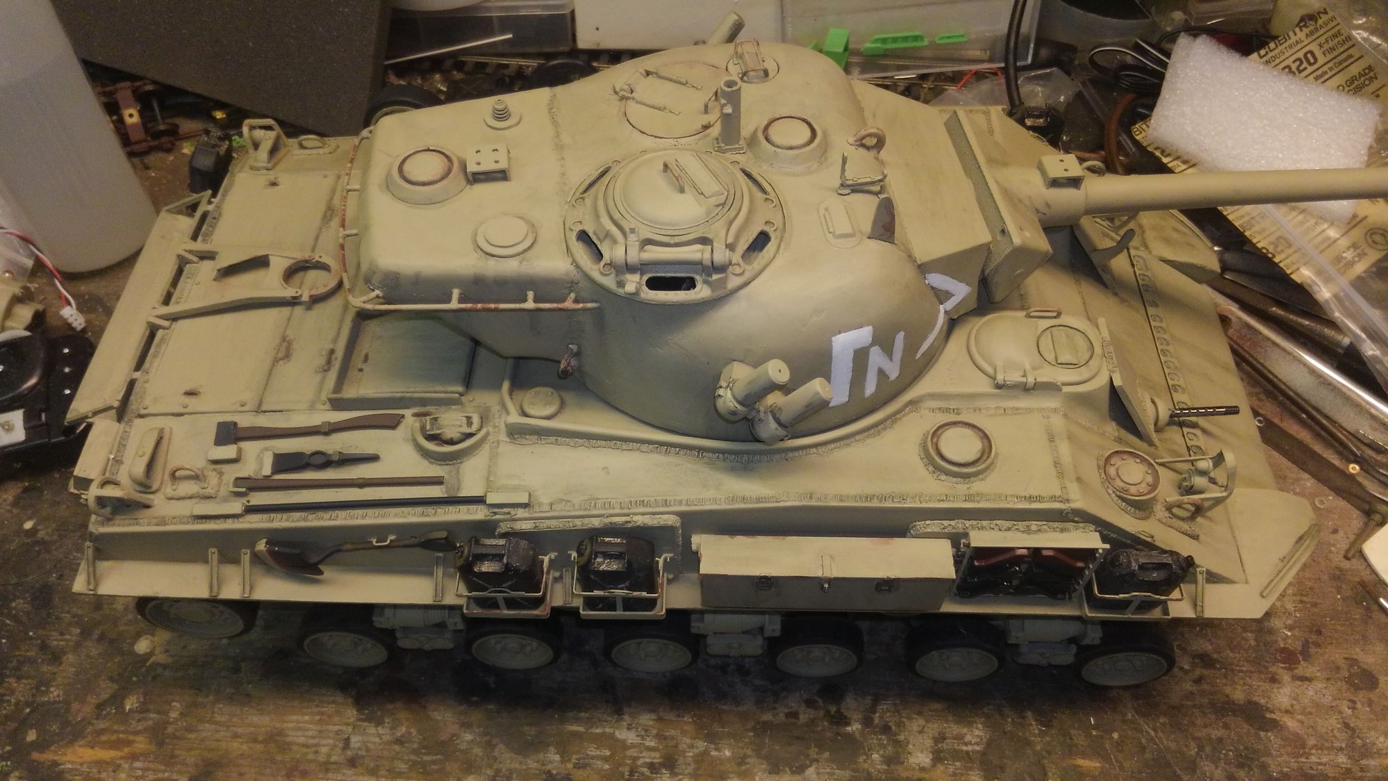

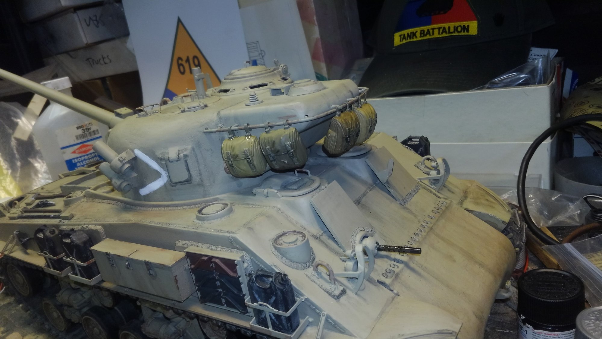

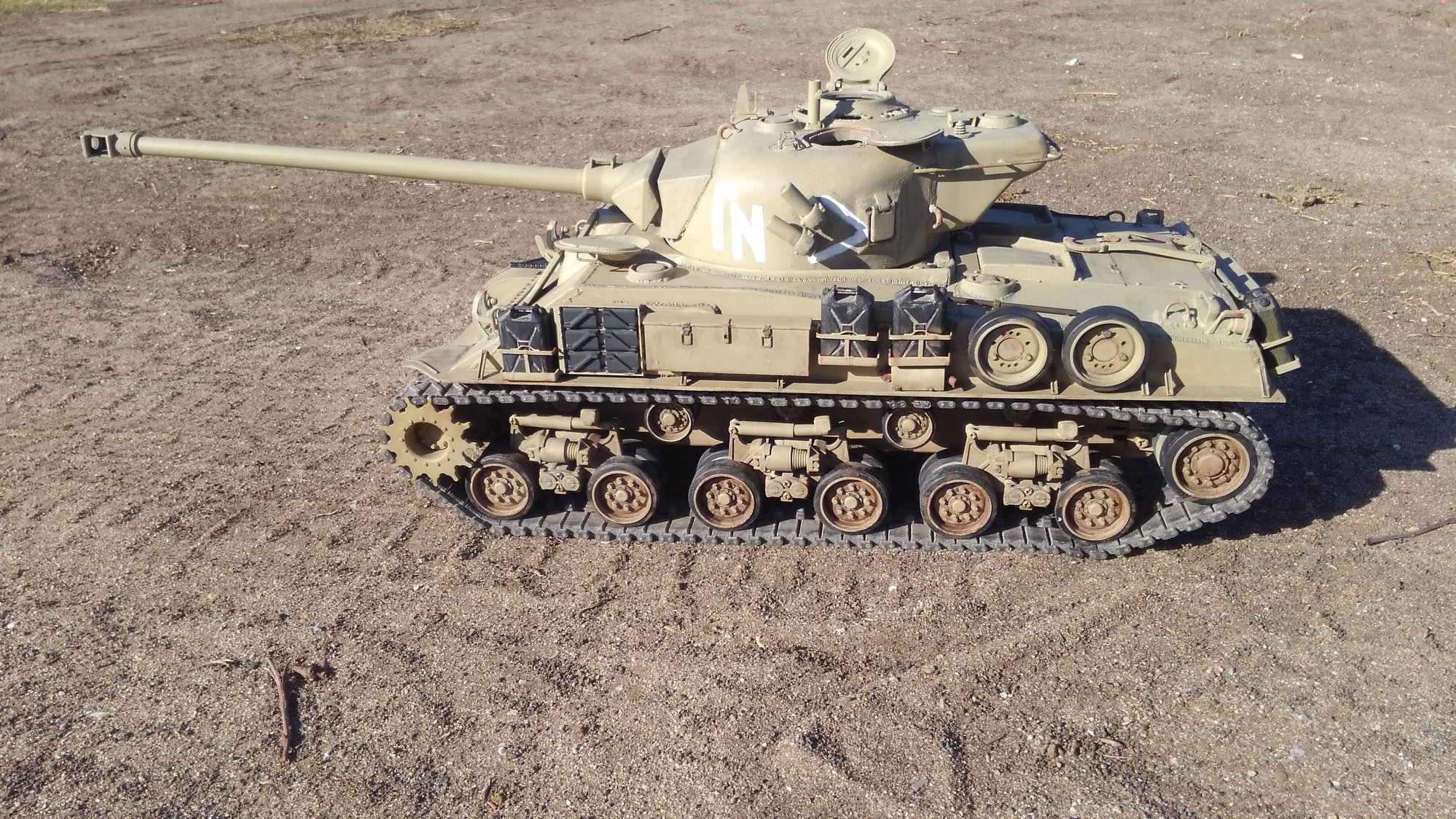

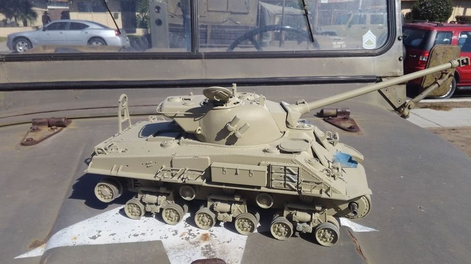

Ok here is the finished paint job. I dabbed a tad of paint after these photos were taken you might notice later on. Any way. This is it. The weathering shows up real good in the garage lighting but not in the outdoors. Natural light tends to wash the shading and weathering out.
I normally prefer clean fresh looking tanks. I only weathered a few of my builds. Not all. Some were just light shading of the OD some were a little more with the dirt and grime. This tank looked really good in fresh sand and it likely would have weathered well naturally like the 686 sand on current US vehicles does, it seems to absorb dirt and grime. But I was trying to match a stock photo of a particular tank so I went all out and came very close to the photo that I wanted. I am very happy with how it came to the photo, do I like it, well yes but I do prefer cleaner tanks. When i do an m51 it will be a little fresher looking.....
I still want to go back and finish a few things on this model but I needed to have it done for out October war IDF themed battle sunday so its done for now.
Follow up items are the spot light, jerry can straps, possibly wire up all the lights. Also might cut up a tamiya m4 intake hatch and make better doors. The 3d ones are just blah. My buddy inadvertantly ordered intake door castings from ECA and had them when I put all the equipment on his bare hull on his m51 last saturday and so I put them on his over the 3d printed ones. They looked good I just did not have the time to do the modeling and fuss with modding the tamiya part so I can follow that up later.
Colors are Testors model master Armor Sand Acrylic washed with tamiya nato black and redbrown. hull red testors rust were used for detail and highlights

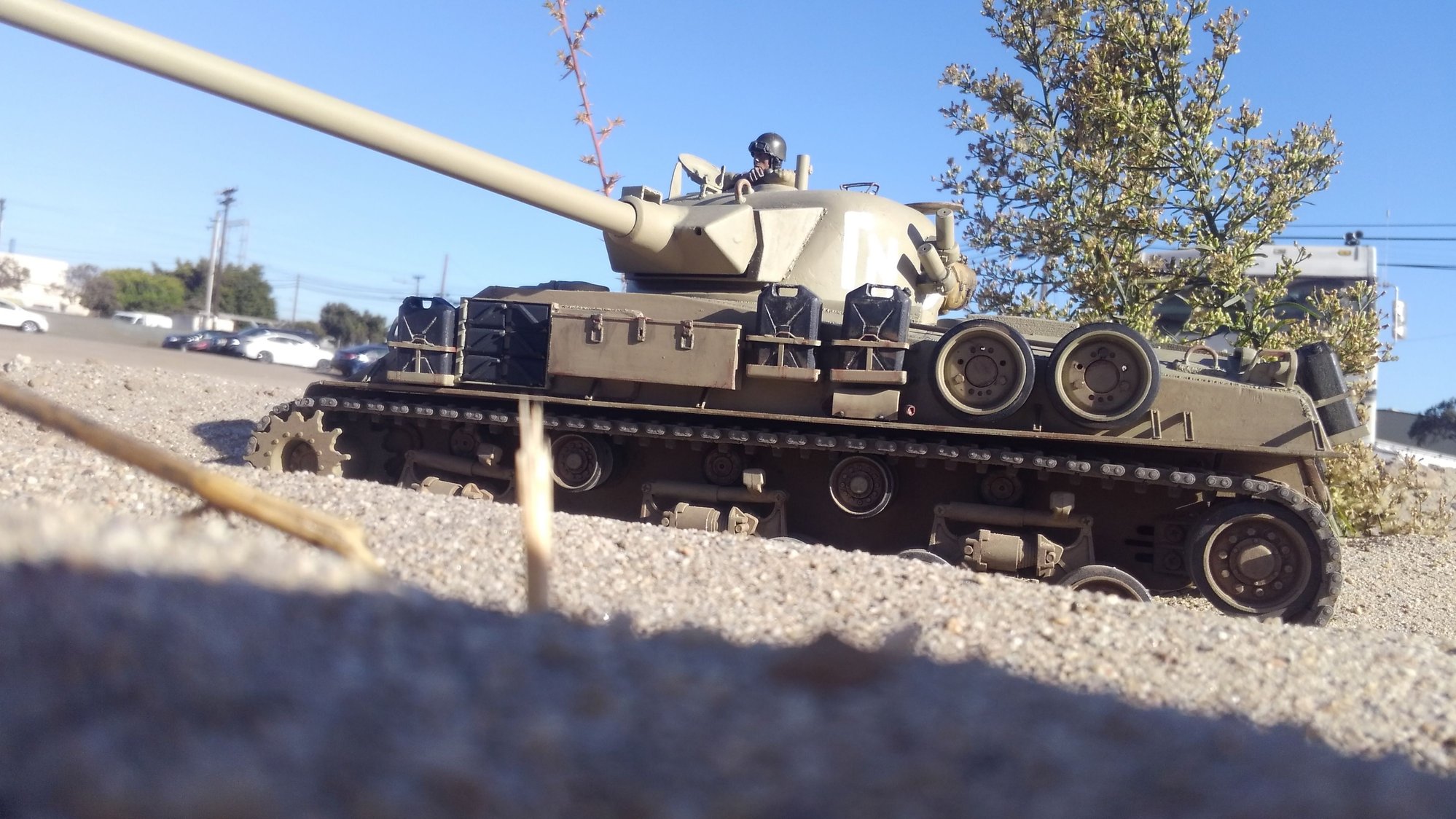

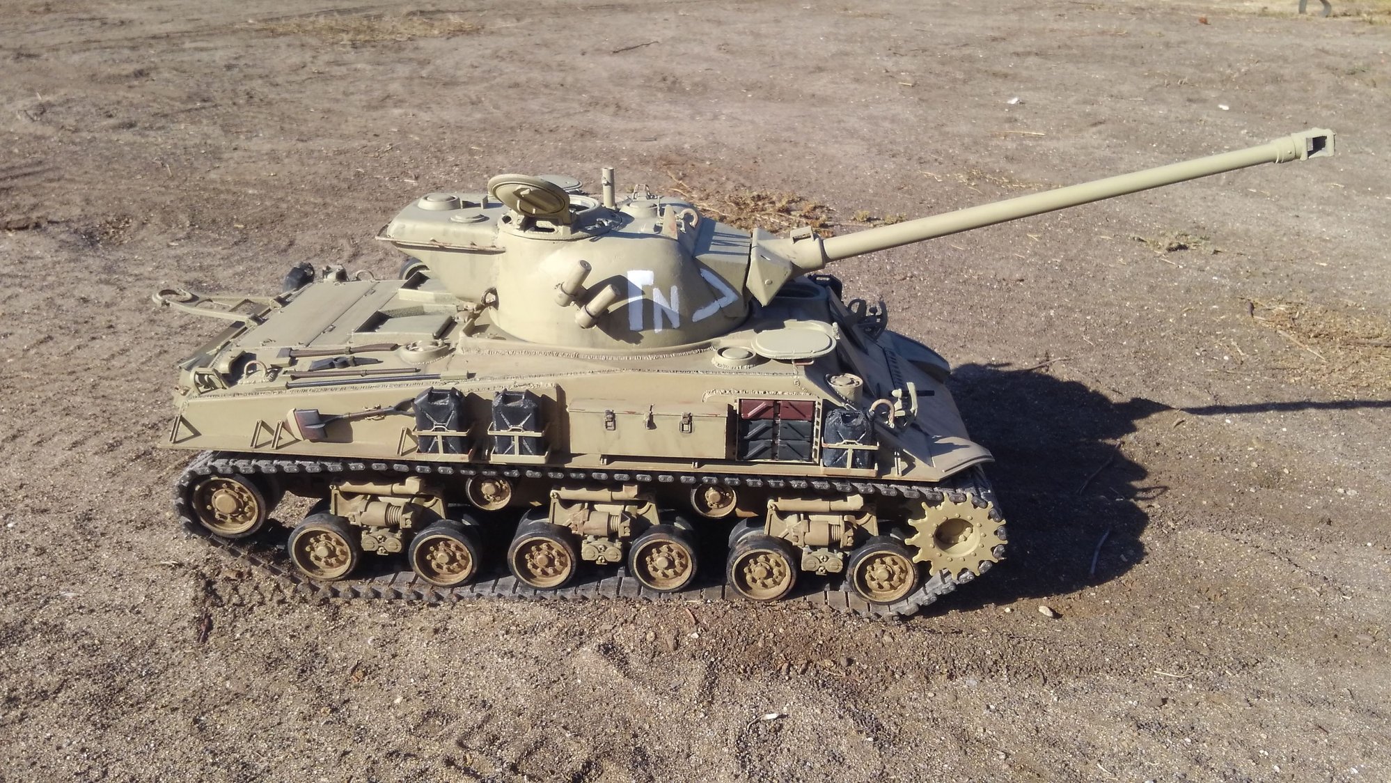

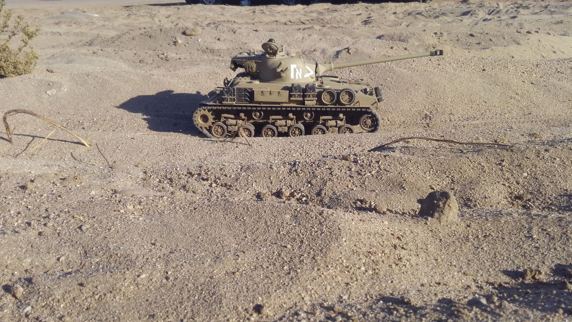

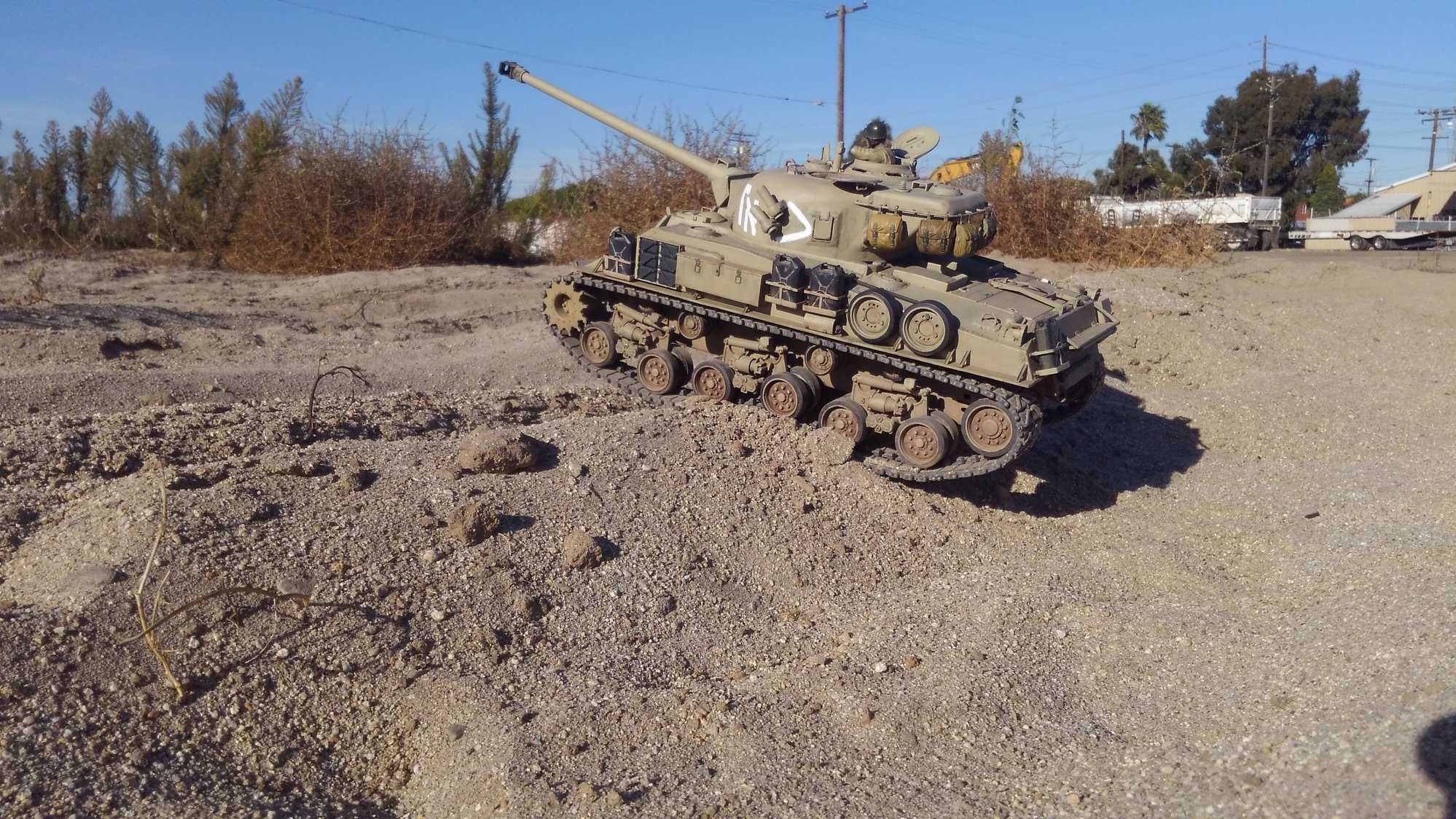

Here are a few more pictures that illustrate the weathering better and then a few out in the natural habitat. Fresh dunes are fun to drive in/over and they are very very soft but there is some tiny gravel that gets caught in idlers causing fouling and esc stalls. Got to drive carfull but litterally topping dunes one after another with no other prints in the sand is so much fun and then dropping into big holes where cars got stuck and actually driving out. My ez8 gets stuck it has T66 tracks and jams up every time. This tank is an excellent runner.
Oh if you were wondering what tank I painted it after just browse back to the top of the thread and see the prototype tank photos I posted, its the only one with the same turret symbol.

Fantastic! You don't see many m4a4 with hvss so this makes a nice change!

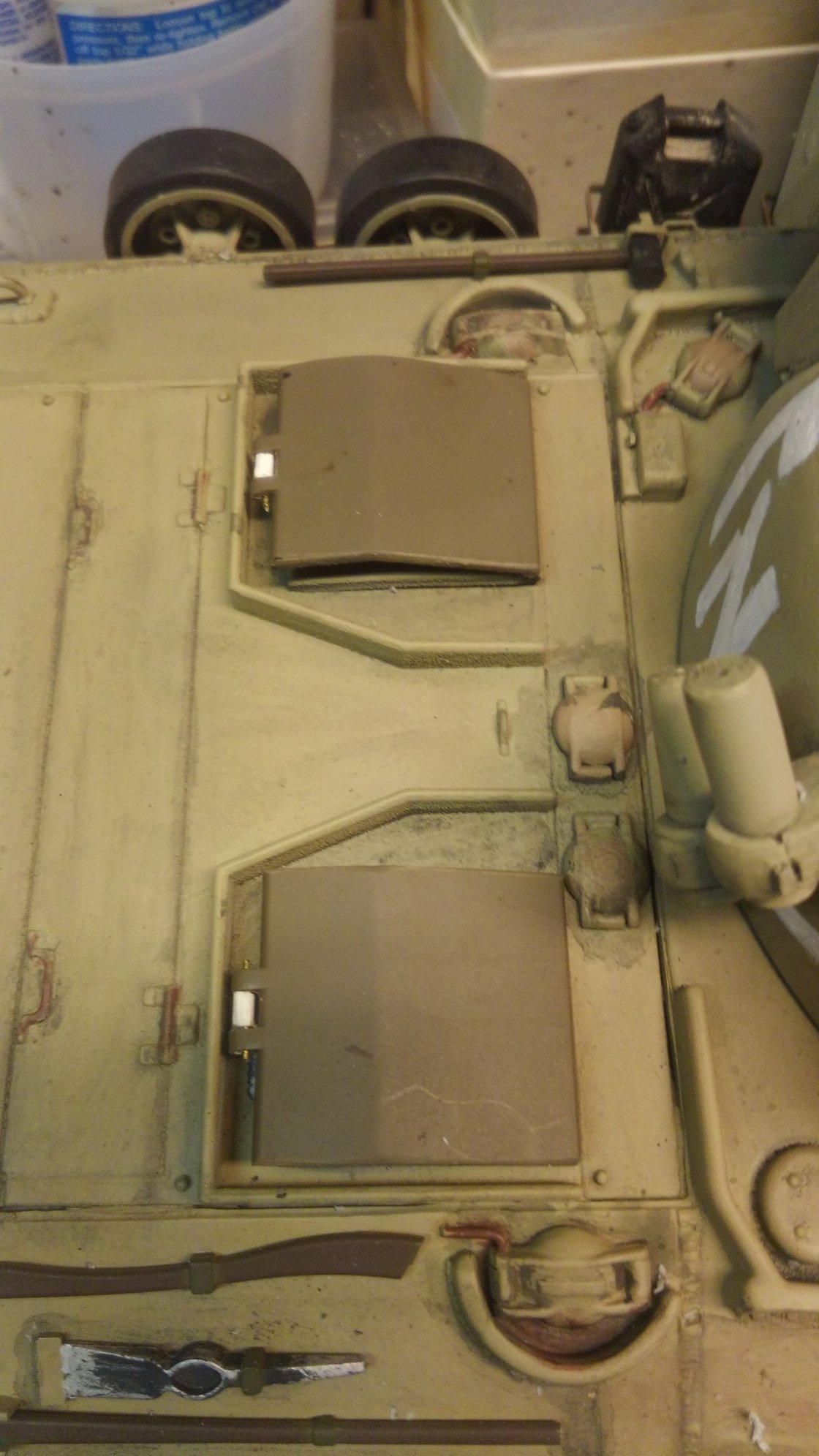

Well, I spent a good part of the day doing my self fulfillment detailing work.
First last night I decided to cut up a tamiya engine access lid and make it into the two air filter doors just like how the IDF did in the first variant design.
They are hinged and I drilled holes for the speaker noise in the pads that are on the 3d printed deck that were supposed to represent the air filter doors but really were just too low, which prompted me to do what I did and I really like how it tricked out the deck.
I also got out the spot light and found some bracket photos on line to make it. Apparantly it had a hinge on the bottom rear so it could fold back, or at least some variants did. Some had short brackets and some had taller brackets. Aslo, if you look at my rear turret bustle top you see a square bracket reminiscent of the spot light bracket on the mantlet so I surmise that it is likely a spot light stowage bracket for when it is not mounted on the mantlet. Further, I hypothesize that they could have mounted the spot light backwards on the bustle to facilitate driving light since they spent more time driving with the turret turned backwards than forward.
So I hid a magnet in the bottom of my spot light and I have a tiny magnet that I slip under each bracket when I want to mount the spot light there. It looks really cool and is quite tight and sturdy.
For now, I think Im done. Eventyually I want to hook up the lights and pull the spot lense and put an LED in it and rig up the MG and its fiber optic. But no time for that now....Ille come back to it later on..
