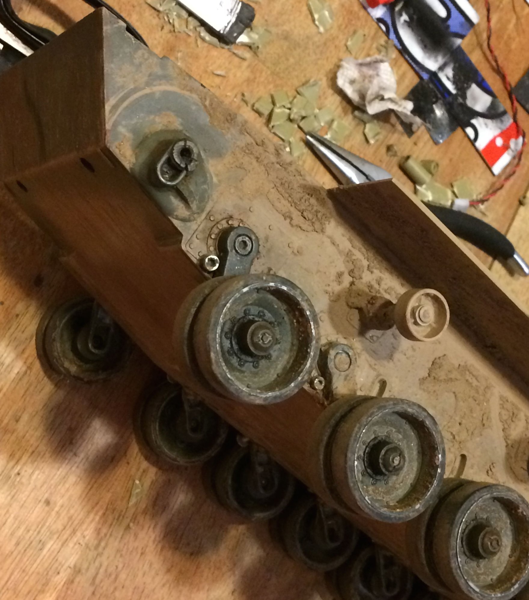

The following photos show samples of the wear, gouges, broken parts and new replacement hull.
Lower hull set to be replaced.
Close up of broken idler wheel mount.
Lower hull scratches and deep gouges caused by rocks and concrete obstacles.
Rear lower hull with deep gouges cause by the metal tracks slipping off sprocket while running only one retainer ring during some recent testing. Also shows the remainder of the axle hull bearing support.
Worn out and damaged track pads.
New replacement hull show next to worn hull.

Progress on overhaul this week. Still waiting on a few small parts and new DKLM track to arrive.
New hull with suspension down travel limiters installed and ready for parts install.
Installing modified suspension arms.
Installing clean (internally) and inspected road wheels.
Old motor and gearbox.
New motors assembled onto cleaned and inspected gearboxes.
New hull bearing support and return roller installed on hull.
New hull bearing support and return rollers installed on hull. Using M41/26 rollers mounted slightly higher to aid in additional track retention and tensioning.
Close up of new hull bearing support.
Motors and gearboxes installed in new hull. Yes, the gearbox one on the left is a mid mount not the normal high mount.
Electronics going in. Note the new cooling fan to help reduce high electronic temps that come with 9+ volts. Also added a grease/oil splash shield over the gearboxes and a metal hull support strut.

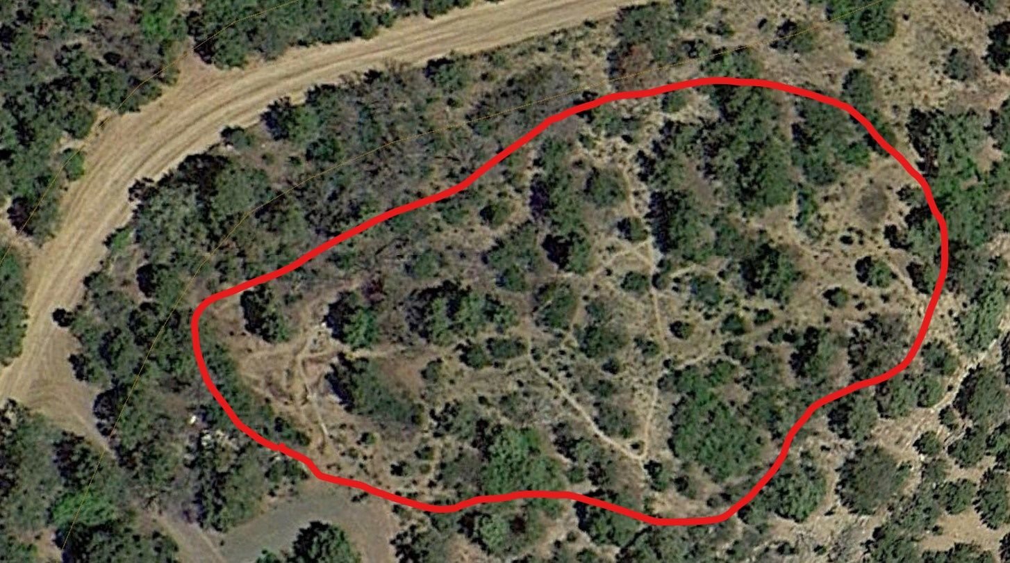

Tankland is in western Colorado. It's the place where 99% of my tank pix and movies are made. It's about 13 miles NW of the RGS headquarters. The area inside the red line is Tankland.
Last edited by Pah co chu puk; 03-12-2019 at 11:56 AM. Reason: added picture of tankland
and I do get down that way in the summer to get my beach fix, so please keep me posted on your battle dates. I can bring tanks to California. I took tanks to Arizona.
You probably wantbto come to our modern battle. Back channel me your email and i will bet you on the list.
If your on facebook we post everything there. https://www.facebook.com/groups/SanDiegoRCTankBattles/
PM sent.
You can see from the Google Earth image that Tankland would be a good place for Fsttanks to kick up some dust. It would be fun to check out his high performance tanknology first hand. If I can work out the timing, it would be fun to meet you guys San Diego next summer.
