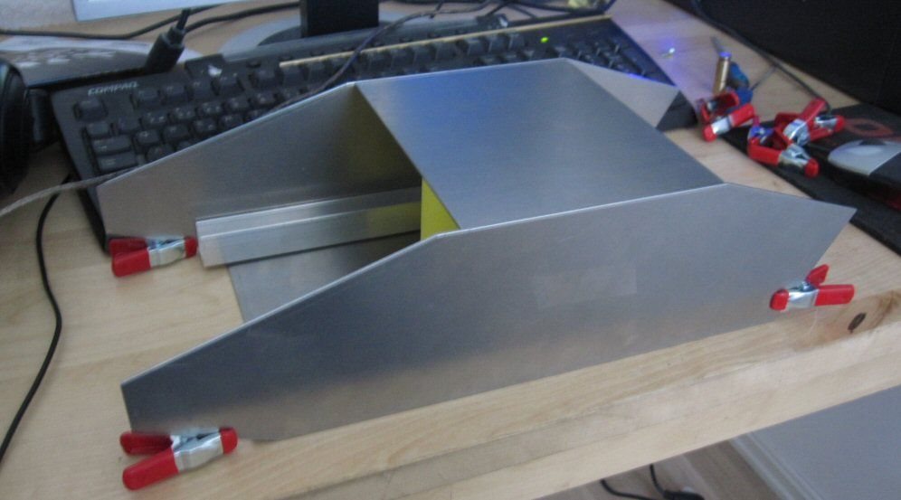

This was the start - steel sheet and some bits and pieces. Tracks were motorbike chain. Running gear was simply cobbled together.
I dont know if it will ever be RC as sound cards are very expensive.

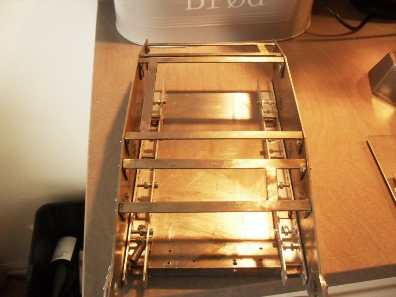

The suspension is just springs on a pair of aluminium u-channels. Its worked for me before and allows adjustments of sorts.

Ive always wanted a T-60 as there were thousands of them and they saved the day to some extent outside Moscow even if they were total crap.
Its a bit crude in places but so were the real ones so its hardly a problem.
I wasnt so happy with bits a pieces so they were reworked at various periods.
The top hull is a press fit and Im happy with that as attaching hulls has always been a problem for me. The bracing that was visible in the earlier picture of the lower hull was eventually discarded as it just wasnt needed.

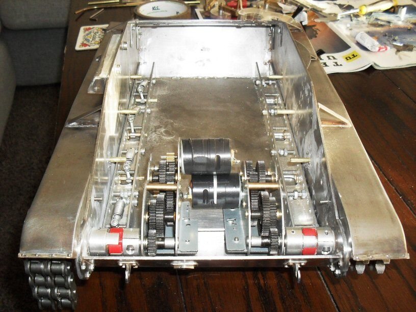

The suspension unit can come out as a unit - I did this as my hnads are too big for messing with springs inside teh hull. This way I could simply simulate different masses on the two suspension bars and figure out the adjustment for the ride height I wanted.
The gear boxes are standard HL. This was an issue as the fit is excrutiatingly tight given the narrow front end. I used flexible couplings as I like them and it cuts out some fiddling.
As it was, after teh boxes were fitted, my measurements had been out and the hull top was hitting the uppermost gear on teh left (front facing) box. This was because I had measured off teh right gearbox which is actually lower. Being mightily pissed about it with no soultion in sight, I mothballed the whole thing until I figured out a way out.

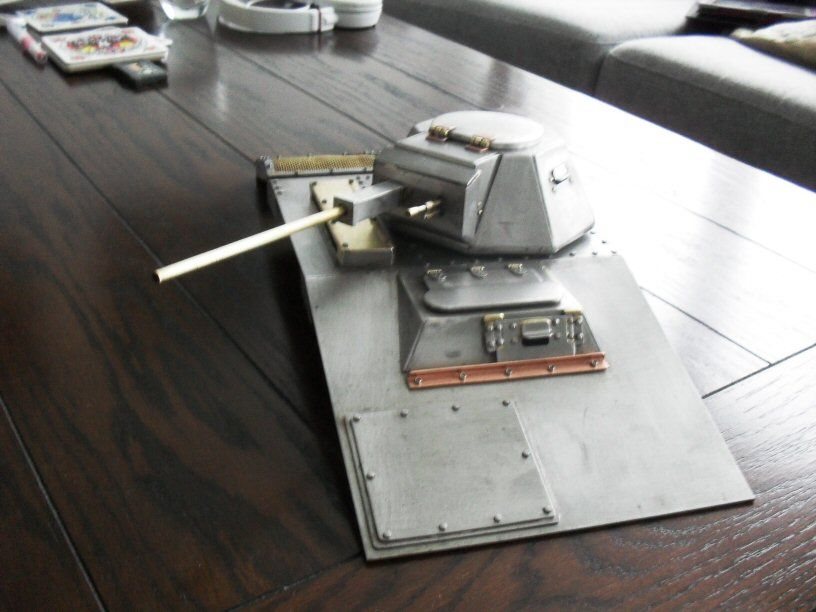

Bits like tow hitches are the sort of stuff 1:16 is good for - you can but them off the shelf. Making them is a pain in the rear as you solder them up and then try and solder them to the hull without them falling apart. Different solder temperatures help but they are not so easy to buy anymore.
You can actually se the problem caused by the gearbox in this picture...the hull is not flush with the glacis at all. That really toasted my flakes.

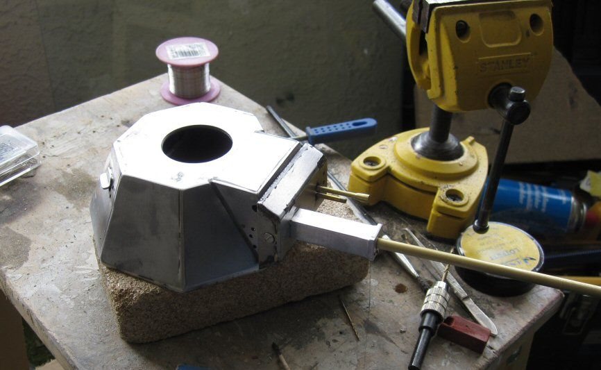

The turret was also a headache...its a sort of hexagon with a slope and getting the individual plates to line up for soldering is a job for an octopus. In the end a frame was built inside and the bits leaned up against that.

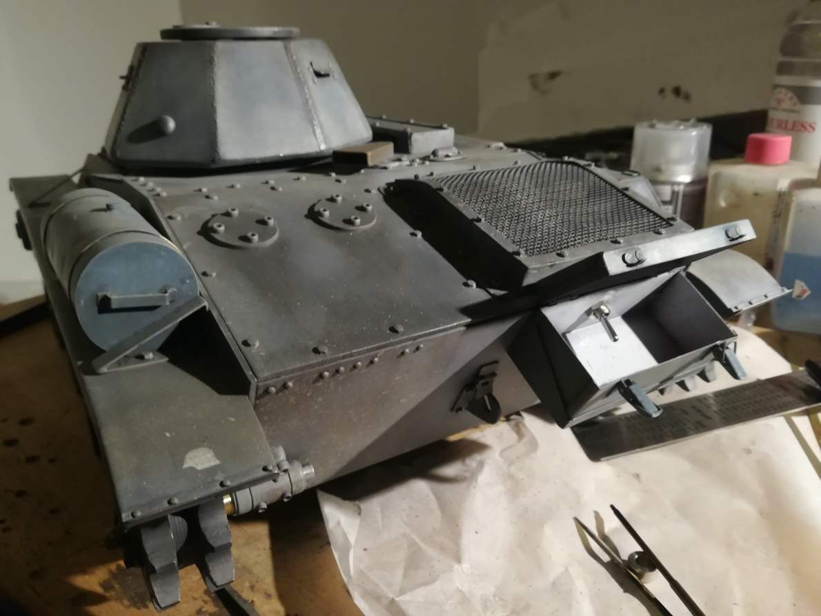

And this is pretty much where it got to before it got to me. That glacis plate issue, one of teh stowage boxes that simply wouldnt close right and just the sight of it were sufficient to stick it in a box for over a year and start on something else.
But I took it out recently and solved the glacis/gearbox issue once and for all. The stowage box was removed and replaced with a brass external fuel tank. Once I get that soldered on and find the expensive shovel I bought from Giesseweks.de....I will get it ready for painting. I even bought decals!
I was going to do a partisan fighting beutepanzer but now think I will just go winter soviet.

Ive been slowly tipping away at the T-60 as Im desperate now to get it off my desk, into a box and out of the way. Finished off some fabrication jobs and other small things and then set about sloshing some paint on it.
I don't like painting but it had to be done. I went for a Beutepanzer as I had some spare decals that I just stuck on. Plus, Germans modified the T-60 heavily and that allowed me to add a box on the back which could hide the on-off switch and get rid of the Soviet stowage box which just wouldn't behave.
Its been assembled now but without tracks as I want to clear coat it to protect it. I may rc it but its most likely to go back in a box as I have a couple of other tanks to finish. Im also sick of having different systems in different tanks and trying to remember whats what. In addition sound cards are a horrible price. So Im thinking of building a module containing the open panzer board, the receiver, a sound card and the three ESC's which I can then just lift out and put in whatever tank I want to drive without having to remember controls, switches etc etc.
The photos below are not good quality but I may take better ones when the tracks go on.
