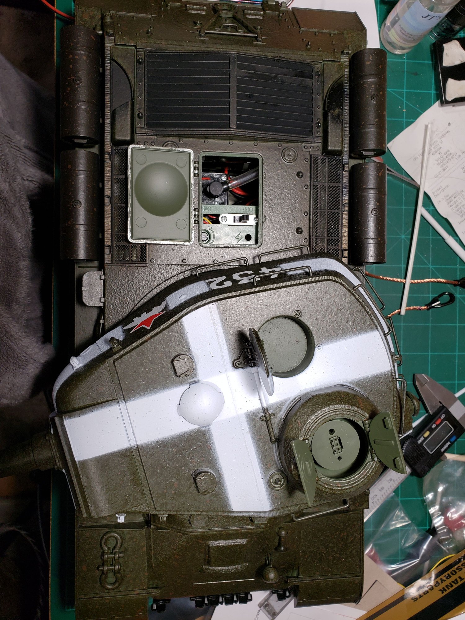

I am not affiliated with Taigen in any way, shape, or form. I am just another that suffers from the addiction of rc tanks.
I had preordered this back in February and recently received it. Here are my first impressions.
This thing is a beast. It weighs in at 14.2 lbs and it came extremely well packaged, probably in an attempt to protect it from the gorillas that handle it during shipment. That being said there was some slight damage to one of the sides of the box as if it had been dropped. Upon opening the box I did note some minor damage. The fender mounted tool box was no longer attached, one of the exterior fuel tank mounts was cracked, and the machinegun on the turret rear was broken. The fuel tank and tool box were easily repaired with some glue.
The machineguns are a clear plastic that are installed prior to shipping. I used a sharpie to give them a darker color. If they came as separate parts that the customer could install there would be less of a chance of damage during shipment.

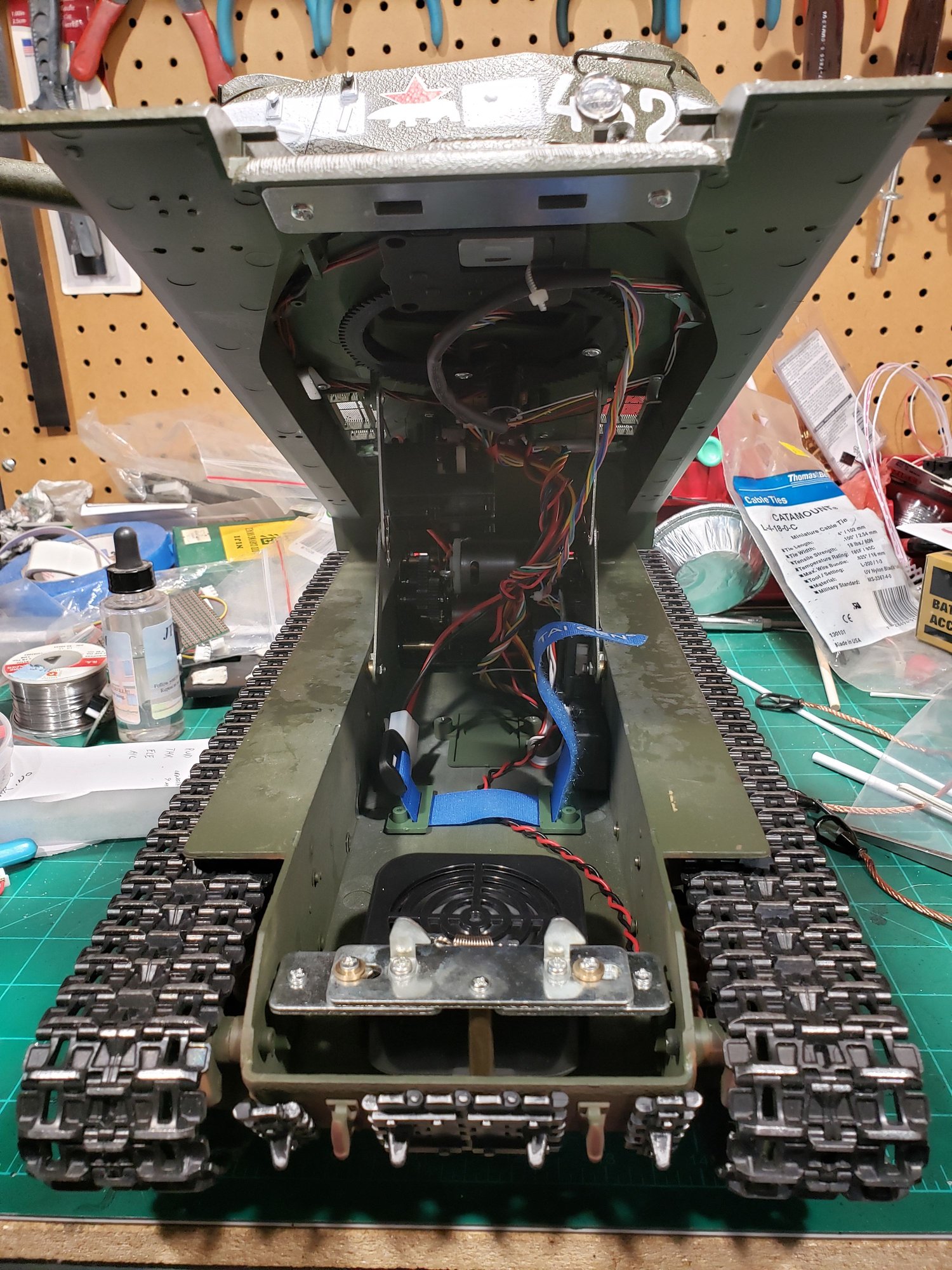

The internal space is extremely narrow and the motors are almost touching. I would recommend inspecting the wiring and capacitors on the the transmissions for clearance from the gears prior to running as I did find one of the capacitors was physically touching one of the gears. This was easily addressed by gently bending it up but I will be checking this on a regular basis as preventative maintenance.
The power switch is in a poor location. It is located under the engine deck hatch and is inaccessible unless you manually rotate the turret which causes an awful noise as the clutch slips.
The smoker works great on this. I am not a fan of smokers but this thing is proportional and when filled with megasteam fluid it really produces. I usually discard the smoker but I am contemplating keeping this one.
The mfu has a switch to disable the track recoil.
The latch for holding the hull open is a definite plus but hinge pin on the back of the hull would look better if it was blackened.
The road wheels and idlers appear to have bearings.
The paint job is pretty good but I am not a fan of the weathering.
The suspension responds extremely well and appears to support the tank but I will be storing this on a raised block due to its weight.
The gun elevation was a slightly jerking when the cannon elevated but I remedied that by adding a drop of lubrication to each side of the mantle and cycling the barrel up and down. I did notice a small spot on the top of mantle became bare metal after doing this.
There are some some excellent details on the hull and it runs extremely well.
Overall I am very pleased with this. Taigen has definitely stepped up their game with this tank.

I wonder though, why does the flat rolled armor have casting texture? I know nothing of soviet armor so maybe they cast flat armor for the tank. Or is it just really thick paint? If its supposed to be smooth rolled armor, bummer. If its supposed to be cast armor, good for them for replicating it.

Yeah thats juat roled plate armor. Sad. If your a detail and asthetics person, probably go for the tamiya for this tank.
That texture jumped right out at me in your photos. I would not buy a sherman model if it had that texture all over the plate armor.

I agree with you on the armor. I am not a rivet counter. I am satisfied as long as a model is a close facsimile of the real thing, runs well and easy to maintain.
Here's a video of a later model JS-2 and the armor is similar to the first video although it appears to be equipped with KV tracks.

Yes they did. Russian Tanks 1900-1970 ISBN: 0-88365-052-5 states on page 123 John Milson describes how the JS series differed from the KV series that they were developed from. "The hull nose was made in a single casting, and the upper and lower tail plates were made from single plates, each sloped at approximately 45°. Previous tanks of this type had the armour at the front of the driver made of a flat, slanted plate running from side to side, but on this tank a shaped casting was used."

It did come with leads and a jumper for using a hobby grade radio. The instructions describe 6 channels
1 steering
2 throttle
3 firing/elevation
4 turret rotation
5 engine on/off
6 main mother trim
Nothing is listed about the machineguns or smoker on/off. If these require another two channels there is no way to connect them and if these are done with channel mixing there is no mention of it.
If connectivity is required why is it not provided and if mixing is needed what channel mixing gives you the results are questions that need to be answered.
The sounds are a vast improvement over the earlier sounds that Taigen used. I would say the quality is pretty close to, if not as good as a TK22.
I do strongly recommend inspecting the transmissions to make sure no wires or components are touching the gears and that power leads on the motors are not shorted against the neighboring transmission. It is a very tight fit in the rear of the tank.

Thank Daryl Turner for the great idea on the hinge
Remember, if you have a problem send me an email and I make sure you are taken care of. To answer your questions: yes it doe come with a hobby wiring kit and does have JS-2 sounds
Don't have that one on the radar but It wouldn't be too terrible to do.... There are a few others being worked on now, this next one I'm hoping will be done asap....
Yea unfortunately you do lose MG control and the ability to turn on/off the smoke unit with an aftermarket TX. If you need a bypass cable for the smoker so you can add the switch again I've included a picture below. This will still give you the proportional on/off from the motherboard but will give you back the switch for a manual on/off control of the unit if you use your own TX. The MG however is lost on a hobby TX. Just out of curiosity how important is the MG to you guys?

Test run outdoors revealed a gap between the upper and lower hull that allowed debris that is prone to being grabbed by the rear drive sprockets to enter the tank in the area of the transmissions. The white line above the track is actually light being reflected through the tank.
