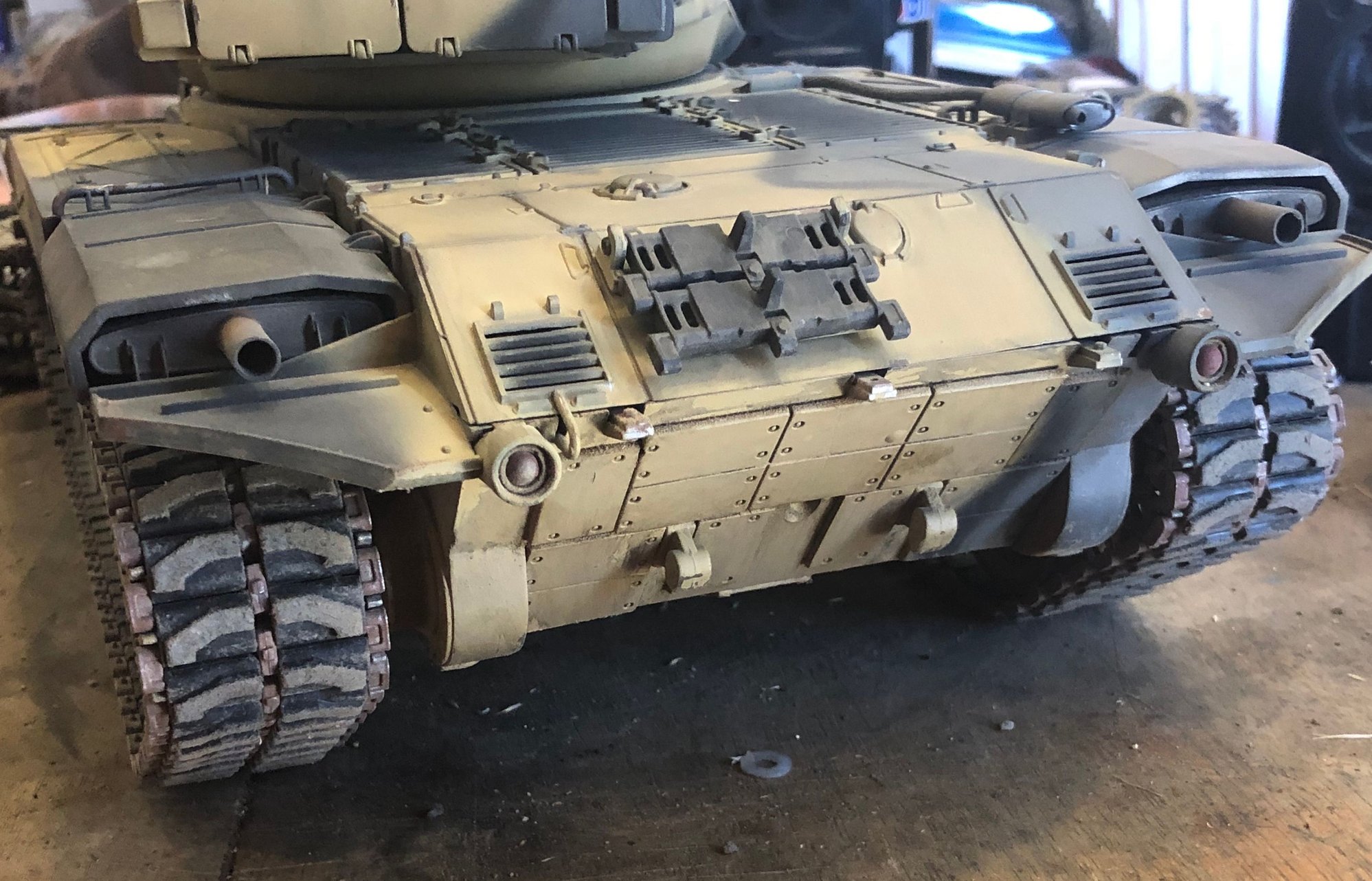

IMPACT tracks arrived early today and are ready to see combat this weekend in San Diego!!! For those of you that emailed me with information and asking to see the finished (?) application here it is. The tracks were intended for use on my "close contact" M41 IR battle tank as seen in another topic posting earlier in July. I needed something more aggressive then Tamiya M26/M4 tracks, but not as aggressive as the DKLM Abrams tracks it had been running.
I did some initial side by side rough terrain testing running the IMPACT tracks against the Tamiya tracks swapping them between both my M41s and was pleased to see that the IMPACT tracks are not just all show. They handily outperformed the Tamiya tracks on climbing and soft sand obstacles and were easily a match in all other aspects. Like Tamiya though the IMPACT tracks show signs that they will wear down fast under my hard use style of driving.
So here is what they look like on my M41. Your constructive input is welcome.

Back end. Going to have to change out the spare tracks to match.

That IS sharp looking with the new shoes.
His are complete track sets with the metal center guides. He told me they are a little bit heavier than tamiya sets. I have the pads that I plan to put into tamiya sherman tracks for one tank and then on my m47 build as well.
As Rich said above I did purchase the complete tracks. I needed them to have metal center guide teeth as the plastic ones Tamiya's M26 track use tend to break easily under higher power loads (390s at 9.6v through 3:1 gearbox) when clogging of the sprocket occurs by sandy/rocky dirt or mud.
