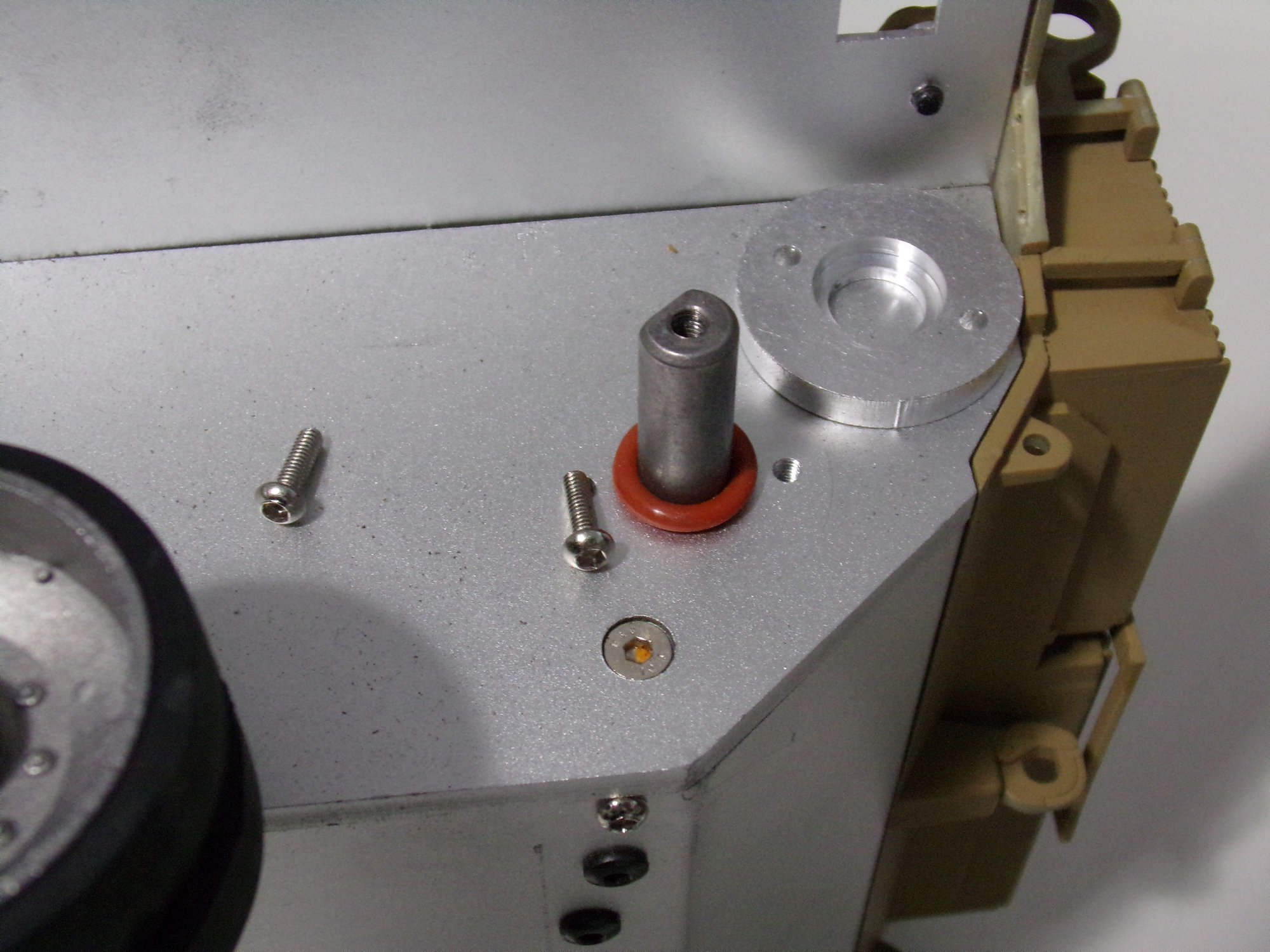

I was going to include this in my build thread, but I thought it was nice enough to stand on its own. I said I was going to be the guinea pig for this thing and this guinea pig has a big grin on his face. This thing is awesome in my opinion. All torsion bar suspension, built in track tensioner, CNC sealed gearboxes, and thick metal plate with almost zero flex. Also has a screwless mounting system to mount the upper hull to the lower hull and came fully assembled as shown. It came packed in a 1" walled styrofoam container. Can't wait to get it wired up and take it for a spin. Yes it was expensive ($538 shipped) and took 2 weeks to get here.

For attaching the upper HL hull.

Fsttanks, the wheels look like the standard HL wheels, but they have bearings installed. Bearings are in the road wheels, idler wheels, and the return rollers. Took some more pics of some of the sub-assemblies.
Bearings shown in road wheel and sprocket has a guide to help with track retention.
The silver plate in the pic comes off to reveal an O-Ring to keep water/dirt out.
