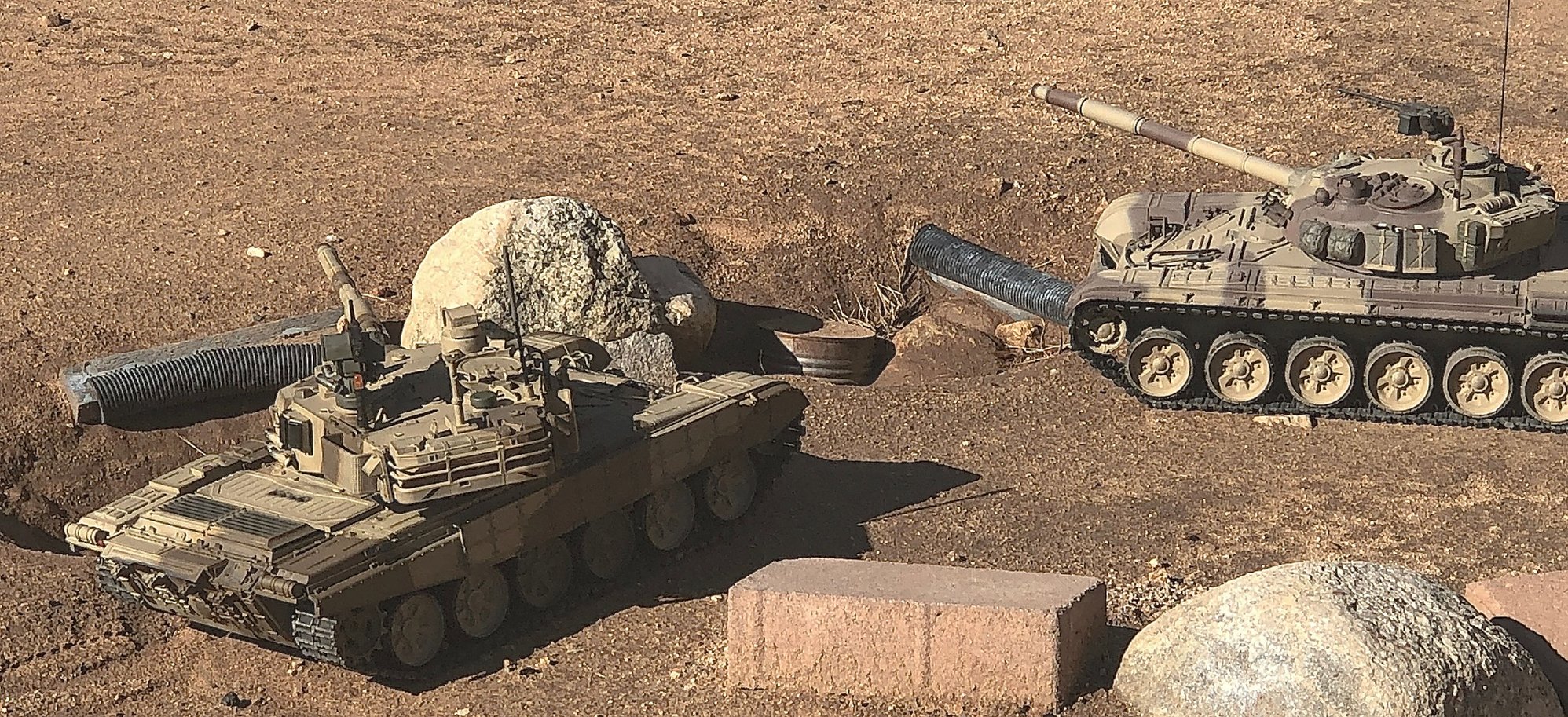

Since I have been having so much fun with my Heng Long T72 testing the battle system, fighting it and just plain off road driving, I decided to buy another. But having two of the same tank that look similar is not really my thing. Knowing that there is a rather large "real world market" for upgrading and modernizing of old T72s, I thought it would be fun to try my hand at a theoretical modernization build of a T72. I would be using mostly "off the shelf" parts that represent fairly well what is being done by countries and companies worldwide.
This Heng Long T72 modernization build focused mainly on the turret (just as in the real world) with minor lower hull modifications to represent changes to side armor protection and improvement to the engine. The turret was completely replaced with an updated design, new main gun profile, new coaxial MG, both gunner and commander day/night/thermal viewers, automated MG station, increased stowage, cross wind sensor and APS (active protection system).
Mechanical upgrades to the HL T72 have also been made to enhance its overall performance both as a fun SUPER FAST 55mph+ scale tank to drive and to IR battler at much slower speeds of course. Externally these include all metal suspension, road wheels, idlers, bearings, sprockets and tracks. Internally I "massaged" the stock gearboxes to run smoother, added 390 motors, upgraded all the power lines including dumping Tamiya connectors, added QD plugs to the HL 6.0 MFU wiring so I can quickly and easily swap out the HL 6.0 for a Tamiya MFU (as needed for those more regulated IR battlefields). Lastly added a "engine bay" bulkhead to seal off the motor heat from the rest of the tank and engine bay heat exhaust/cooling fan. The later was done due to extremely high motor heat (enough to melt plastic) I have had with my first T72. Being that this tank will be running at even higher volts up to a 11.4v (12v) Lipo, I wanted to make sure the battery would not experience overheating cause by high motor temps.
I am posting this build in reverse and showing the finished "Modernized" T72 first and will then later post the actual photos of the build in progress. Hope you enjoy and your constructive input is welcome.
Old T72 on left new "Modernized" T72 on right.
"Modernized" T72 showing new turret layout, engine deck and cooling exhaust vent.
"Modernized" T72 rear turret view.
Old T72 vs "Modernized" T72 comparison.

I was asked if I could show the "Modernized" T72 next to another modern tank for comparison. So below it is shown in relation to my Tamiya Abrams and basic HL T72. The "Modernized" Heng Long T72 with its new turret and side armor is a slightly larger T72, as can be seen in the photos below.
Tamiya Abrams above, Modernized Heng Long T72 below.
Modernized T72, Abrams and basic T72.

Moving on to the start of the photo build log.
DAY 1: Brand new T72 just out of the box parked next to my other Heng Long T72. I ordered it with the all metal options and 360 turret knowing I would be needing the metal road wheels, sprockets, idlers and suspension arms. The stock track will be used during testing of the build but is being replace with the DKLM T90/72 dual pin track in short order.
New blank slate HL T72 right out of the box in front & next to my other T72 for comparison.

Nice work, looks like a T90Ms.
heng long cheated us about the tracks and sprocket wheels.
Here pictures from my T90 vs T72 1/16 as you can see they are absolutely different and can't be permuted.
