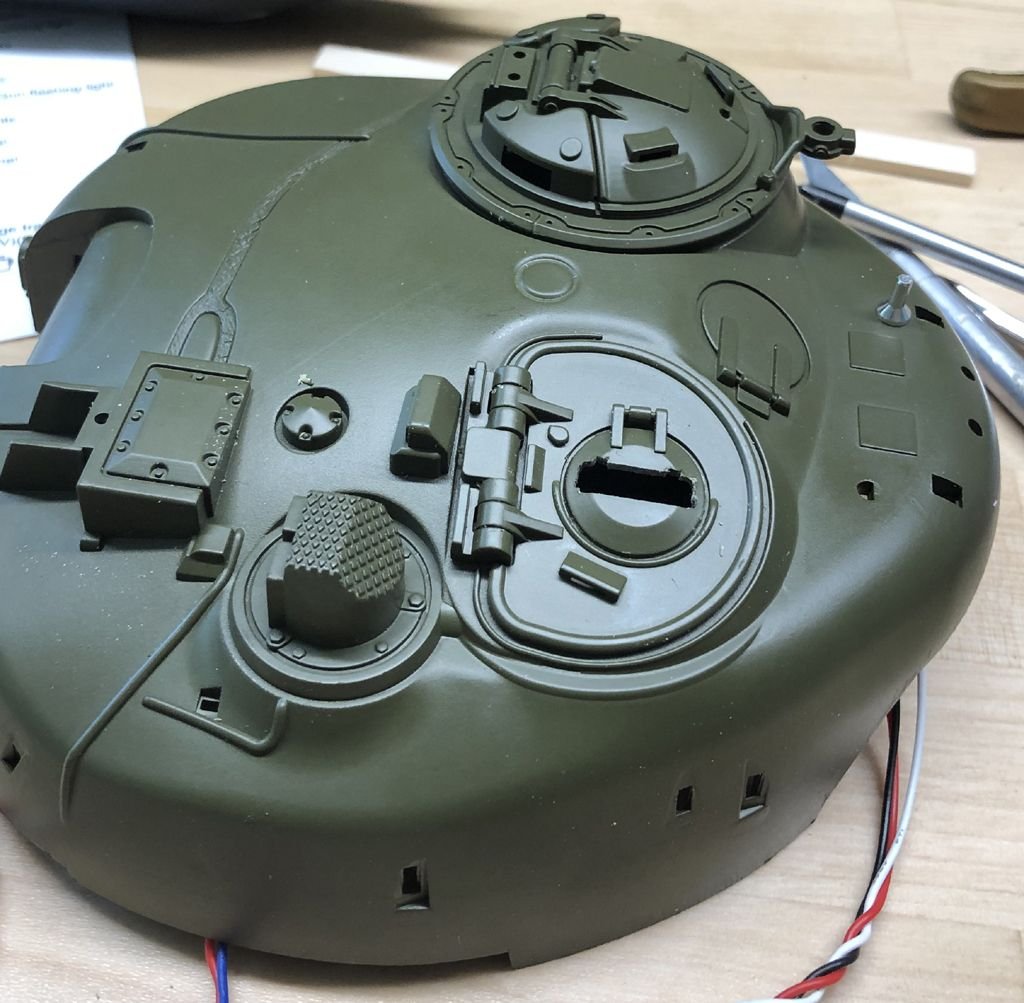

This is my first RC tank and recent LegoDEI IR install for my HL Sherman. Many thanks to fsttanks for his advice.
Just cut off one of the screw pillers and reshaped the slot for JST-XH, 5-pin plug.
Pushed it all the way up and a little superglue.
Height ended up perfect just clearing the hatch hinge.
A little sanding and a little paint and I think it looks pretty good.
