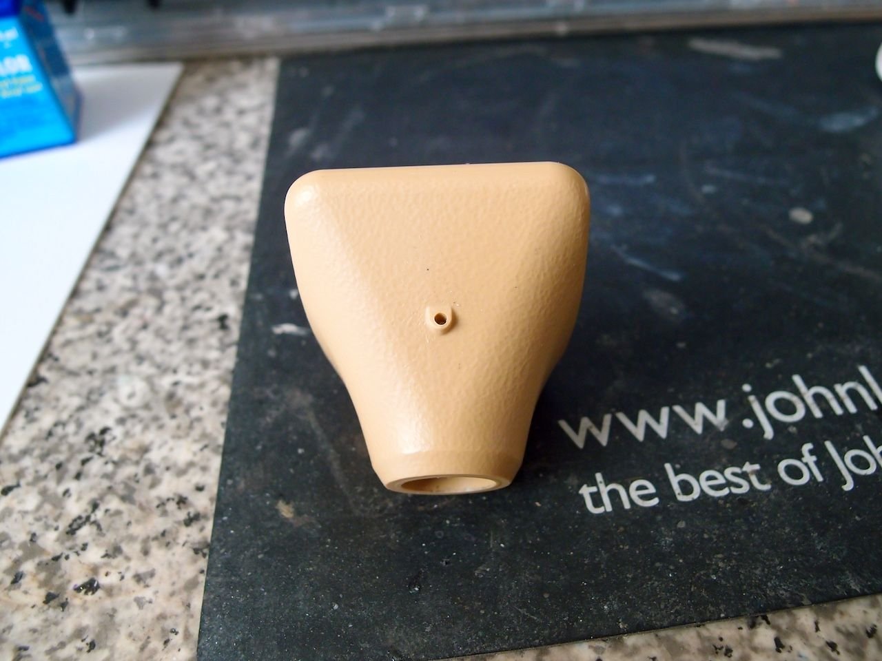

As the front of the Tamiya jagdpanther is a late G2 going for the easy option. Pigs snout has the raised detail for the lifting eye , will drill out for the hook and make a lifting eye
Eye fitted , thin wire with insulation off a thin copper cable
