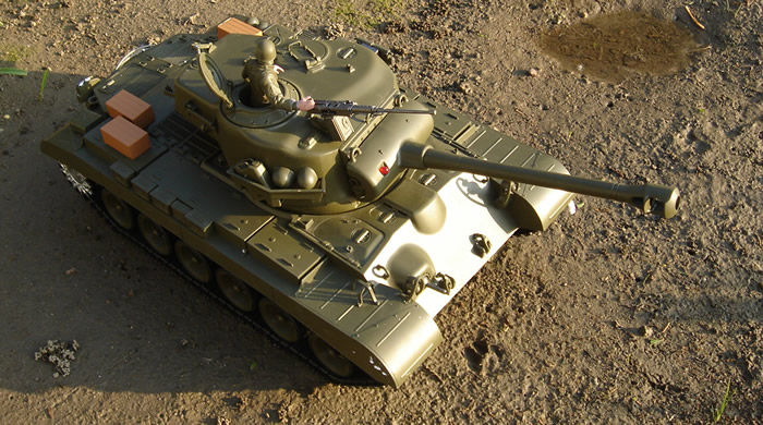

RE: Heng Long Tiger
My Personal Modifications
As a person who enjoys tinkering with model RC tanks, I found the job of correcting and personalizing the Hen Long Tiger 1 to be very satisfying. Some of the modifications that I chose to make to the model were:
paint (Tamiya German Gray with Tamiya white primer and Model Master “Rustâ€)
3 gray $15.00, 1 white $5.00, 1 rust $6.00, 1 full day of painting
added spare tracks to turret
free (had them already) 15 minutes to paint, 2 minutes to glue
inverted mantle to correct position
free, 30 minutes to do correctly
made vision slits
free, 5 minutes
rotated pistol port 45° counterclockwise
free, 10 minutes
opened and hinged loader's hatch
free, 1 hour
corrected commander's copula
free, 30 seconds
replaced plastic hatch handles with wire
free (had wire), 15 minutes
removed cannon on/off switch and plate
free, 30 minutes
relocated and trimmed antennae
free, 20 minutes
added metal cables
$20.00, 30 minutes
added metal lights
$15.00, 30 minutes
removed false tools and repaired and sanded hull
free, 1 full day (total)
added hand-painted, metal tools
$15.00, 30 minutes
replaced plastic crate with wood
free, 10 minutes
added two Ultimate Soldier Figures and one Dragon figure
$20.00, 5 minutes
added Ultimate Soldier and Dragon equipment (helmet, binocular case, grenades etc.)
$N/A, 5 minutes
added German recognition flag
free (had it already), 2 minutes
removed bulbs in mantle (after these pictures were taken)
free, 15 minutes
replaced plastic machine gun with metal Tamiya LED flashing unit
free (had it already), 5 minutes
Total Price: $96.00 in addition to cost of tank
Total Time: 2 days, 4 hours, 47 minutes
Having the tank just the way I want it......priceless.
Jason

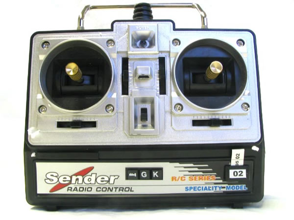

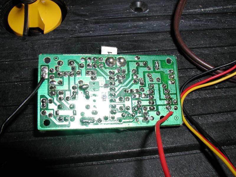

Hello Everybody,
I have had a Heng Long Tiger since last Xmas and have now aquired a new receiver board, smoke unit,speaker and lights for it. But i have come across a small problem with the wiring!!! Does anyone have a wiring diagram or know where the various motor wires and bettery wires go on the new TK-RX13 receiver board?
Any help would be appreciated as my tank is sitting in bits in my model workshop at the moment!!!

RE: Heng Long Tiger
ORIGINAL: swathdiver
It's "Snow Leopard", unless they changed the names of the new ones?
Yep your right.
See what happens when I try to think before I've had my morning cuppa.
RE: Heng Long Tiger
ORIGINAL: gadget98
Hello Everybody,
Regards
Gadget98 [&:][sm=bananahead.gif]
Hello Everybody,
Regards
RE: Heng Long Tiger
ORIGINAL: gadget98
Excellent, you are a life saver!! I dont suppose you know where the antennae attaches on the board?

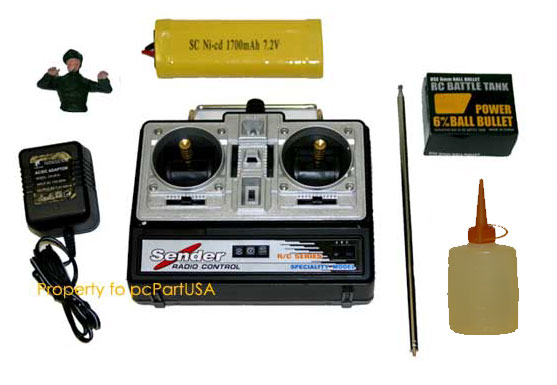

RE: Heng Long Tiger
My pleasure.
Yes you are correct about the Heng Long M26 Pershing being known otherwise as the "Snow Leopard". That is what the actual box says on it and is not just what a hobby distributor decided to call it. I believe that name was derived so that there wouldn't be any confusion with the Tamiya Pershing. Be certain that the tank you are looking to buy is 1/16 scale as there is a 1/30 scale one also made by Heng Long that is very similar looking. It is powered by a 4.8V battery pack and has a push-button controller.
A lot if not all the sites do not name the manufacturer as Heng Long. I'm not sure why this is. [sm=72_72.gif]
The HL Pershing tank should always come with the following items (included in the pic): a two-stick transmitter named "Sender", an often yellow 7.2V battery pack, a wall charger, a tank commander, a bottle of smoke oil and a package of cheap 6mm BB's.
