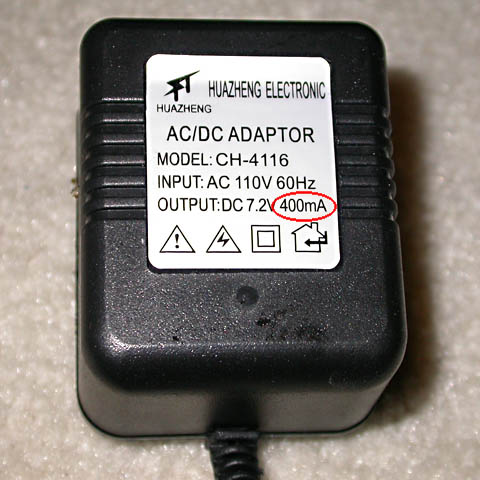

Q: How long should I charge my battery pack with the supplied wall charger?
A: Add 15% to the battery pack's rated capacity, then divide the sum by the charger's output amperage to get charge time. For example, if you have a 2000mAh battery pack and a 400mAh charger, then the charge time is (2000 + 0.15*2000)/400 = 5.75 hours or 5 hours 45 minutes. If your charger's output is 500mAh, then the charge time is 4.6 hours or 4 hours 36 minutes. However, you can charge the battery pack for 5 hours initially.

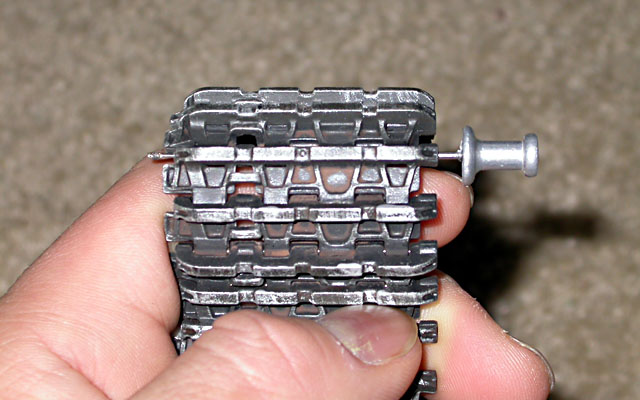

Q: How do I remove a track connecting pin?
A: Push the pin out from one end with a small push pin. Note that most connecting pins have serrated end and can only be pushed out one way.

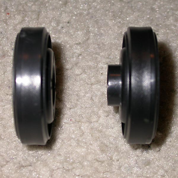

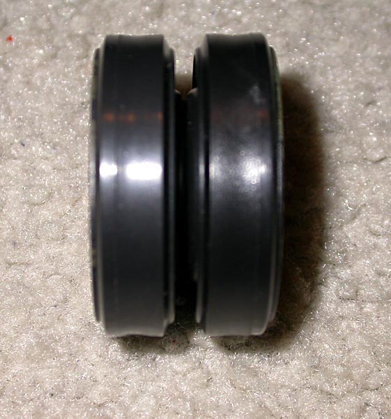

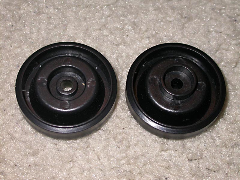

Default RE: RC Tank F.A.Q.
Those road wheels are pretty tough to split apart. They are not just butt glued together. One half of each road wheel is inserted into the other half, which resulted in more surface area for the glue to grab. I'm still looking for a way to split the road wheel without damaging it.

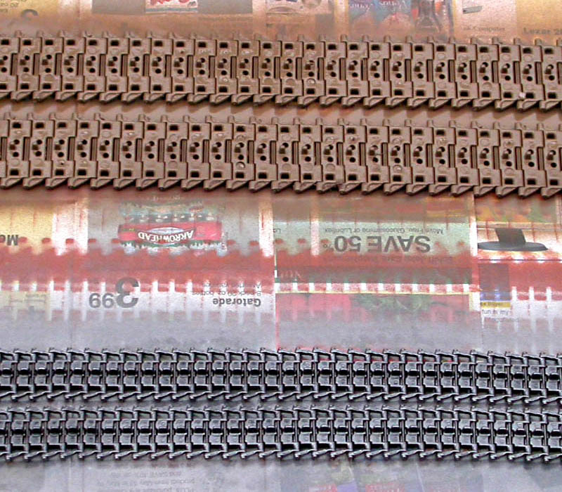

Q: How do I prevent the track connecting pins from sliding out?
A: Here is a quick and easy way. For plastic tracks, get a can of spray primer designed for both plastic and metal. For metal tracks, get a can of spray automotive or self etching primer for metal. I use Krylon red brown primer for plastic tracks and Krylon Rust Tough red oxide enamel primer for metal tracks. Apply a coat of primer, followed by a coat of color of your choice. The primer will adhere to the exposed side of each metal connecting pin, preventing it from working its way out. Note that paint by itself does not stick well to the smooth metal connecting pins.

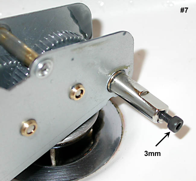

Q: What is the best way to break in the metal gears in my Heng Long tank?
A: Here is the method I use:
1) Remove the gearboxes from the tank. It's not necessary to desolder the motors from the board.
2) Spray strong commercial cleaner/degreaser onto the gears.
3) Use a brush to clean off grease and cleaner.
4) Rinse and dry.
5) Obtain a can of medium grit lapping and grinding compound. If you can't find one, then use a good non-gel, tartar control toothpaste. However, the toothpaste will take longer and won't do as good of a job as the grinding compound.
6) Apply the grinding compound or toothpaste to all gear teeth.
7) Screw a 3mm allen bolt into the drive shaft for the drill chuck to grab onto.
8) Insert the allen bolt/drive shaft into an electric drill and run the drill at low to medium speed. Be sure to wear eye and mouth protection.
9) Grinding compound and metal shavings will spray everywhere, so be prepared. After an hour or so, use a degreaser to clean the gears. Then rinse and dry. Give the drive shaft a quick spin with your fingers. The gears should continue to spin freely and smoothly for at least two seconds. If not, repeat from step #6 above.
10) Repack the gear teeth with grease suitable for gears, such as molybdenum, and reinstall the gearboxes back into the tank.
