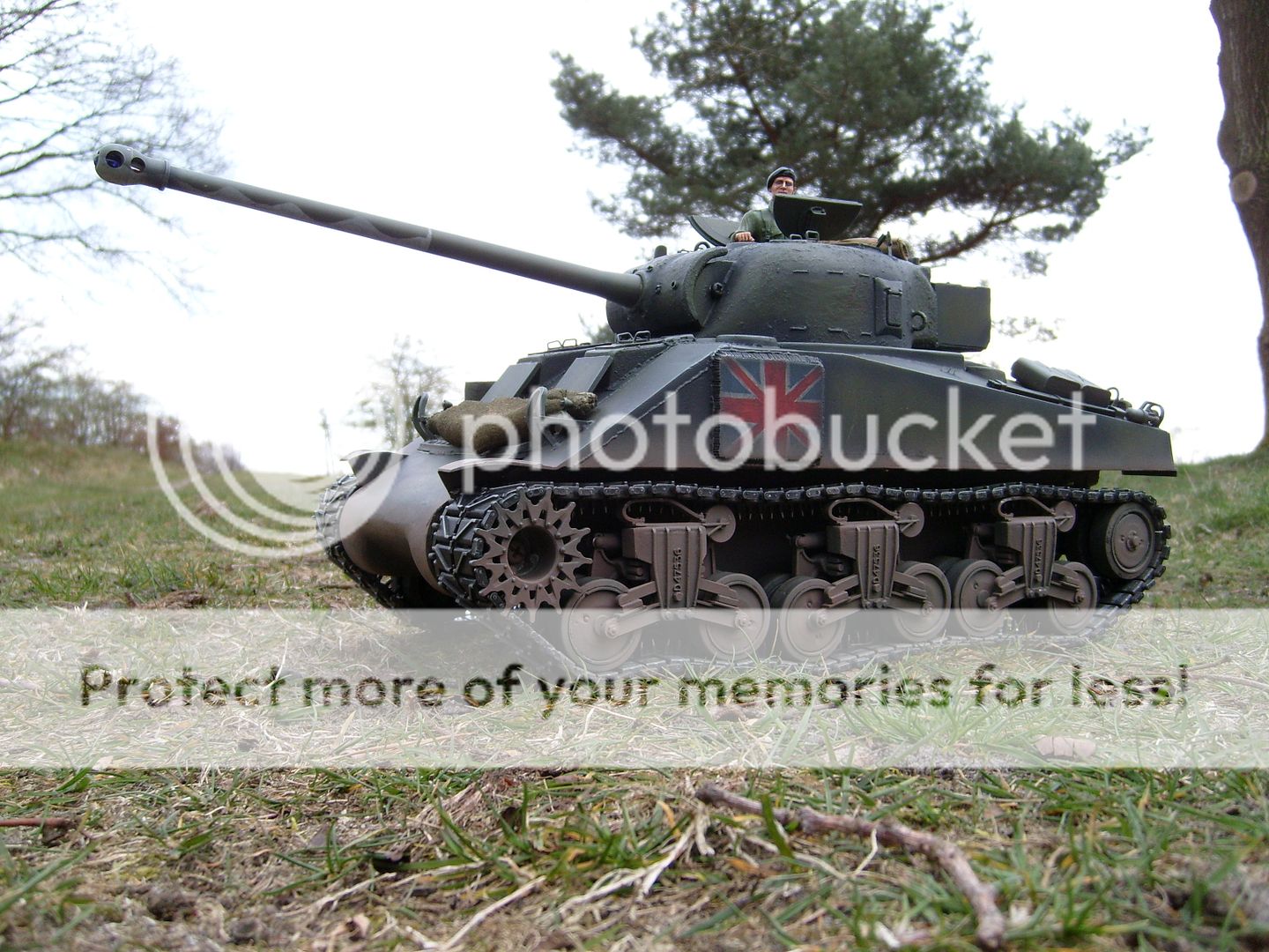

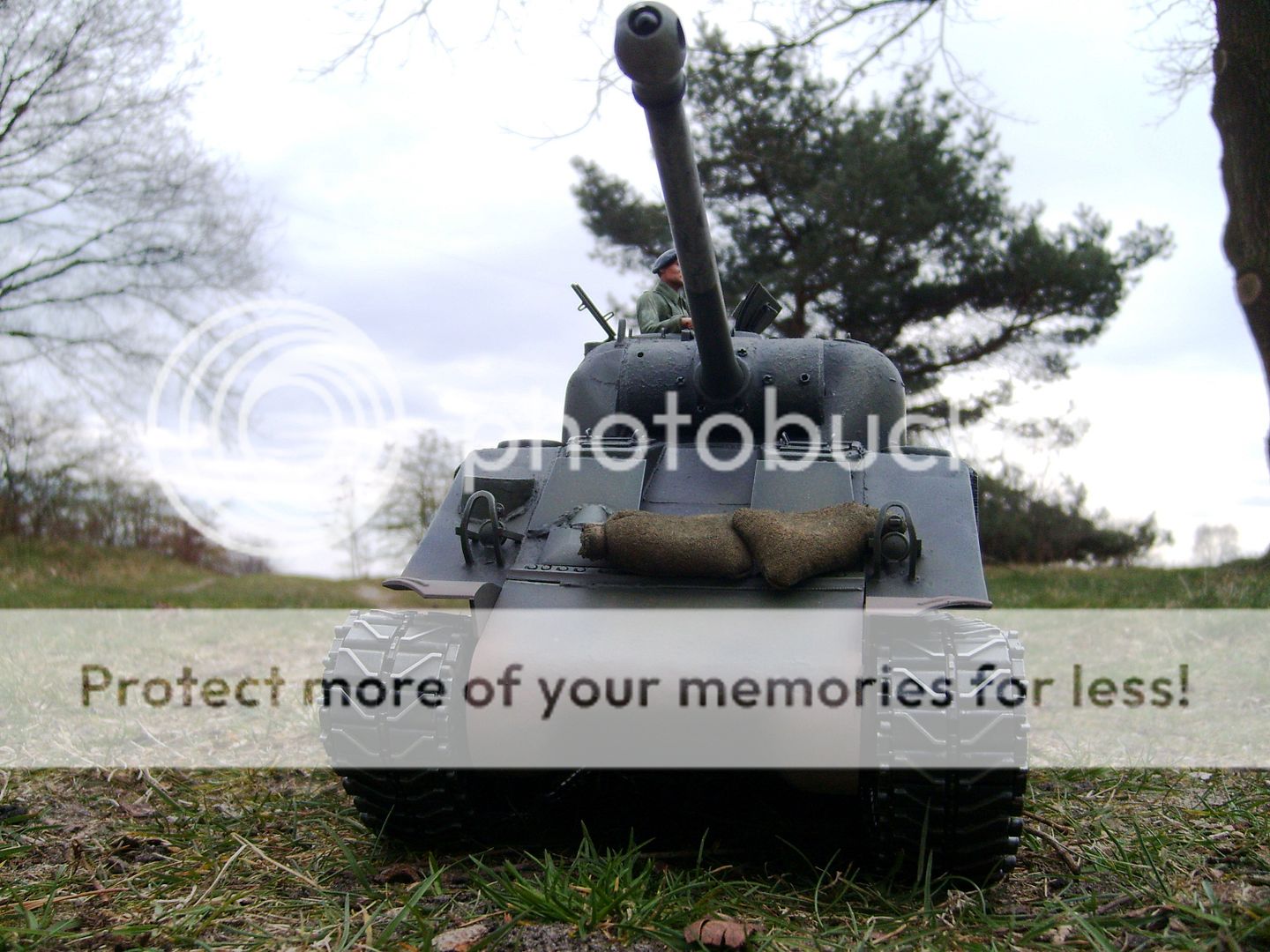

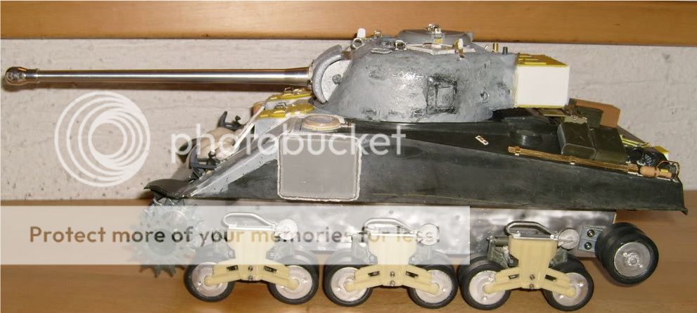

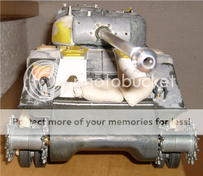

Today I pretty well finished my Sherman Firefly project, though a model is never really finished and will be improved and repaired as time goes on. But for the moment the Firefly is fresh off the work bench.
As a master reference I used the Tamiya 1/48th scale Sherman 1C as a reference and scratch built from there.

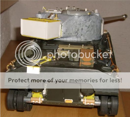

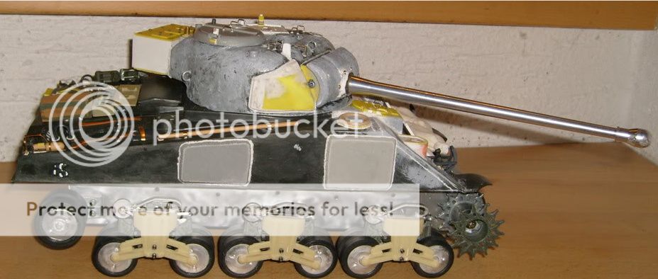

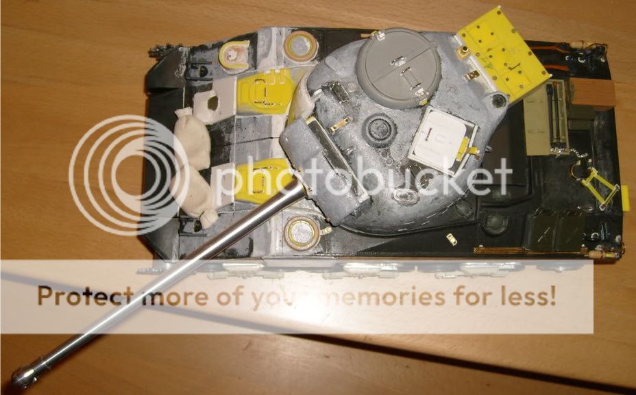

Here are pics of how it looked with all the bits on shortly before painting:
The really dark green is the original Tamiya Sherman plastic, the multi coloured bits are scratch built additions. The turret is grey as it has a coating of putty and glue to simulate the rough look of cast steel armour.

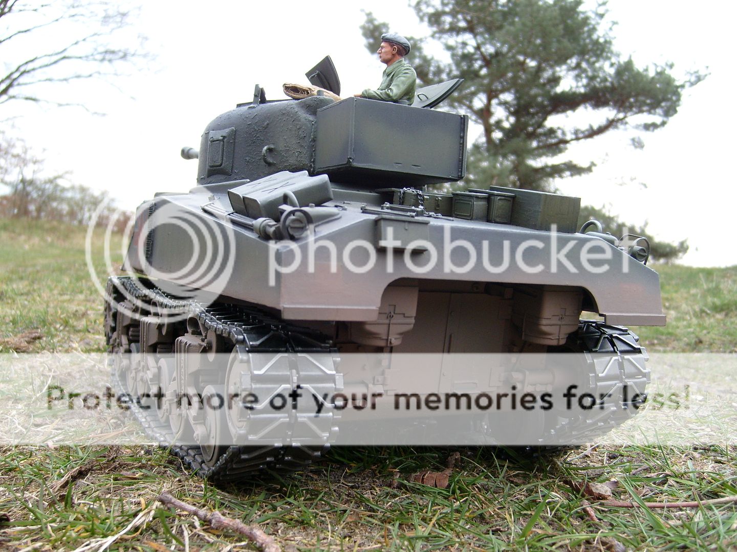

This is how the Sherman looked today at its first tank meeting:
This is a pic of the line drawing from the Tamiya kit instructions:
You can see here how similar the hull is to the Sherman M4.

To turn a Tamiya M4 105mm Sherman into a Sherman Firefly 1C you do not have to do that much. The 1C hybrid Fireflies were based on the M4 Sherman chassis, the same one as the Tamiya Sherman. The later type Firefly VC is more complicated to model as it has a longer hull and that brings with it all sorts of model building complications.
Anyway here are the main points to note:
The Hull.
Glacis plate must be re angled to 35 degrees, simply cut it out and a reset it.
New driver and MG gunner positions.
Remove the mudguards around the lower edge of the hull.
Make a travel lock for the gun and relocate it to the corner of the engine deck.
Many tiny details to tools, light fittings, fuel caps etc that are best referenced from real pictures and plans and that I am not going to list here.
The Turret.
Most of the work is in the turret.
Over the original Sherman 105mm gun mantlet I made a Sherman firefly mantlet out of putty and plastic card.
Tamiya alu 17 pounder gun.
The back of the turret has to be altered. First, the back most portion has to be shortened a bit and the roof angled down more to 35 degrees. After doing that the box is mounted onto the back. This box held the radio in the real tank as there was no more room for it in the turret or hull due to the size if the 17 pounder and its requisite ammo. The hull MG was also sacrificed for ammo storage too.

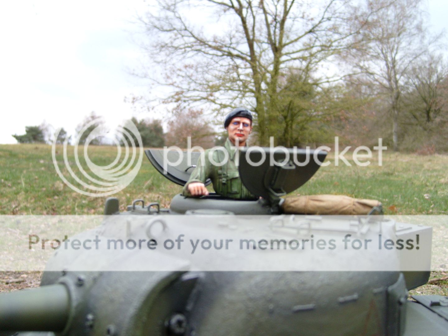

New commanders cupola.
New loaders hatch. A big square one for handing down big 17 pounder shells into.
Lots of little details such as hooks, clamps, antenna mounts, brackets etc that are best made, as above for the hull details, by working from real photos and plans.
Pershing recoil unit inside.
Heng long gun elevation unit inside.
Tamiya battle unit inside.
In trials everything worked, despite being homemade, and after another month of tinkering it still all works but more reliably. The only complaint I have is that the old style gearboxes are not geared down enough and the model runs much too fast. This I will solve with a reduction gear or new gearboxes when they surface on ebay for a song.
With the Pershing DMD/MF combination the engine sound is not truly that of a Sherman but close enough. If I had used the Sherman DMD/MF combination then I would not have had the nice recoil that the Pershing DMD/MF combo offers.
This Sherman is representative of a Firefly from the elite 4/7th Royal Dragoon Guards, 8th Armoured Brigade, British 21st Army Group. This armoured formation fought their way across Europe from Normandy east just past Bremen in Northern Germany. On their way they passed through my home town of Wilstedt and now they are here again in 1/16th scale.
I hope you found this report interesting and that it leads to lots more Fireflies being built.

Sherman Firefly IC - Radio controlled with sound and recoil etc.
Pics after painting
The Hull.
The Turret.
